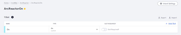

6. Creating Intents for Your Arc Reactor App on Snips.ai
Click on the ArcReactor app you just created on the Snips.ai console, then the click Edit app button.
Under the Intents tab, click Create New Intent. Name your intent "ArcReactorOn" and add a description.
Go into your intent and create a custom slot as shown below with NAME "On."
Add a new slot TYPE "On" from the drop-down menu by selecting "New Slot Type" and entering "On" for the "Slot Type Name."

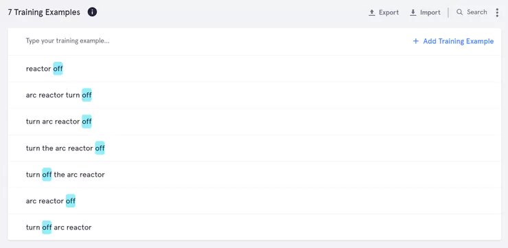

Then begin adding as many training examples as you can think of. This improves the chances of your intent being recognized.
Once you've added training examples, double click on each instance of the word "on" and select the slot "On" from the drop-down.
Make sure to save your intent by hitting the Savebutton on the bottom right of your screen.
Repeat the process for the ArcReactorOff Intent as shown below.

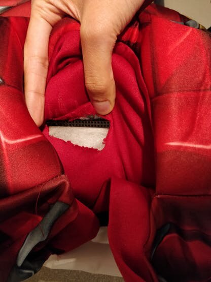

10. Finally, Embedding Your MATRIX Device into an Iron Man Suit
You can purchase a polyester iron man suit from Amazon or from a local store.
Make a horizontal slit near the top of the Arc Reactor print on the suit with an X-ACTO knife to make room for your MATRIX device's GPIO pins to poke through.
{gallery}
Use double-sided tape on the back of your MATRIX device to secure it to the suit. Make sure to leave the mics exposed as shown in the image below*.
*Be careful not to tape onto any of the small components!
Attach the Raspberry Pi from the inside of your suit to your MATRIX device's GPIO pins.
Don't forget to attach a speaker with an audio jack and a portable battery pack to power your Raspberry Pi.
Comfortably tuck away your speaker and batter pack in your pockets.
