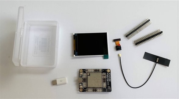

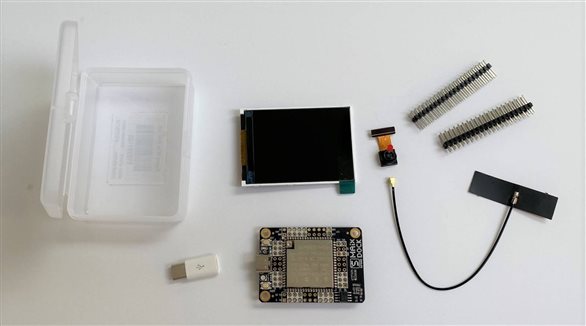

The kit includes:
  1. Maix (M1W) Dock board
  2. 2.4" LCD Panel
  3. OV2640 Camera
  4. USB C to micro USB adapter
  5. WiFi antenna
  6. Header strips

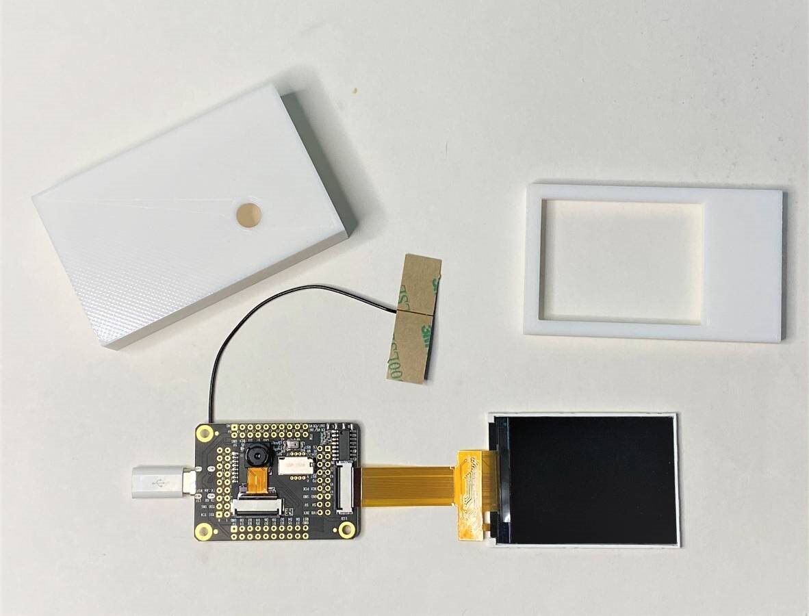

I printed a case for it similar to the one I did for the Maixduino.  It helps that the LCD and camera are the same.
I've been preparing to add a laser module to my CNC router and I've installed an IP camera in my workroom so that I can monitor activity (it has pan and tilt so I can watch my 3D printer and the CNC router and everything else).  Just for fun I thought I'd include a few seconds of the case printing.  It is a low resolution capture from my iPad.  I'll blog more about my laser prep later.
Here are the components assembled outside of the case:
