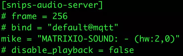

4. Configuring Snips.ai (Raspberry Pi)
With Snips.ai properly installed, the next step is to edit the snips.toml file for configuring the mics.
On your Raspberry Pi's terminal, run the following:
sudo nano /etc/snips.toml
Scroll down to where you see [snips-audio-server] and replace
# mike = "Built-in Microphone"
with the following:
mike = "MATRIXIO-SOUND: - (hw:2,0)"
Press ctrl+x, press y, and then press the enter key to save your changes.
   Snips.ai Microphone Configuration
