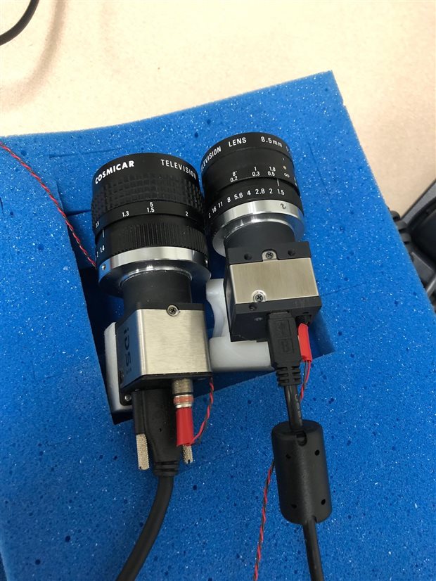

Solved an interesting problem last week using an Arduino UNO.  We needed to sync two IDS Particle Image Velocimetry (PIV) cameras using a hardware trigger.
https://en.wikipedia.org/wiki/Particle_image_velocimetry

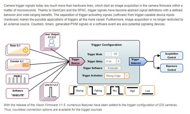

The two cameras were different models and had different connectors.  There are many ways to trigger the system depending on what action you want to capture.
https://en.ids-imaging.com/tl_files/downloads/techtip/TechTip_GEV_TriggerCtl_EN.pdf

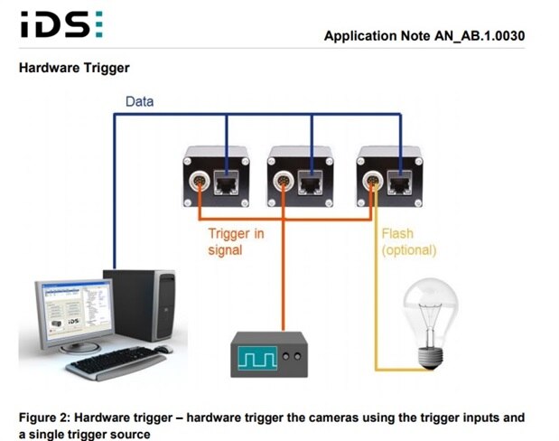

The hardware trigger inputs to these cameras are opto-isolated, so the output from the UNO can be used directly.
https://en.ids-imaging.com/tl_files/downloads/support_notes/AN_AB.1.0030_Synchronizing-Image-Acquisition-uEye-Cameras_EN…

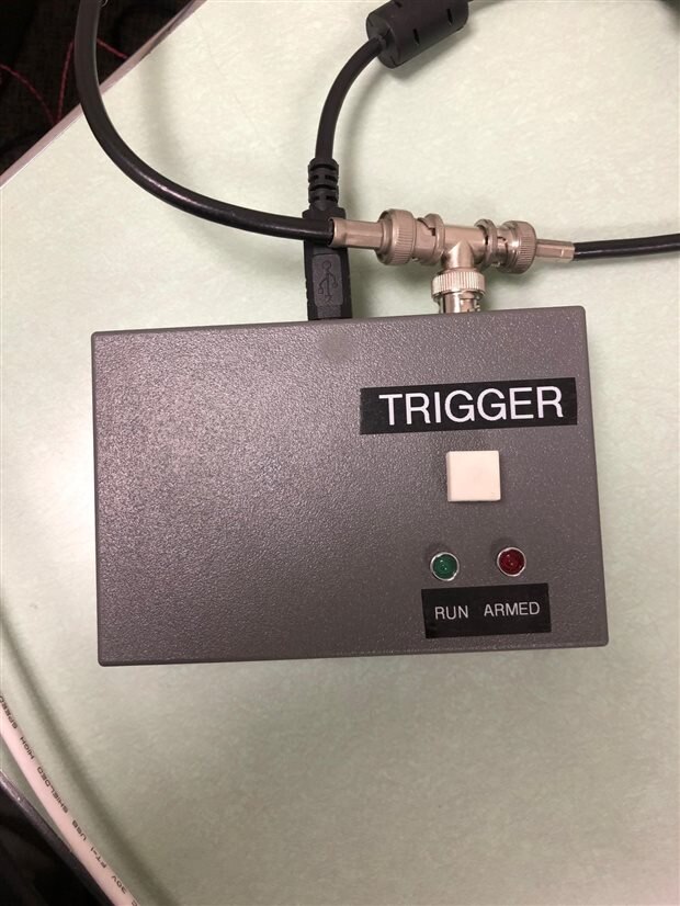

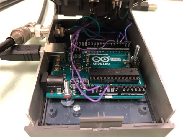

So I mounted an Arduino in a box, powered from the USB, added a couple of LEDS and a pushbutton, and a BNC connector for the output.
