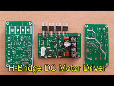

An H-Bridge (Full-Bridge) driver is quite popular in driving loads such as brushed DC motors and it is widely used in robotics and industry. The main advantages of using an H-Bridge driver are: high efficiency, rotation direction change, and braking the motor. In this article/video, I have introduced a complete H-Bridge DC motor driver using four IR3205 power MOSFETs and two IR2104 MOSFET drivers. Theoretically, the above-mentioned MOSFET can handle currents up to 80A, however, in practice we can expect to get currents up to 40A if the MOSFET temperature is kept as low as possible, using a big heatsink or even a fan.

Figure 8 shows the assembled unit and figure 9 shows the testing environment. I have programmed the Arduino Uno to control the motor driver board. Also, I have built a simple keypad on a prototyping board to be able to change the speed (using PWM) and rotation direction of the motor.
Figure 8
The assembled H-Bridge DC motor driver
Figure 9
The DC motor driver board, Arduino Uno, and the test bench!
