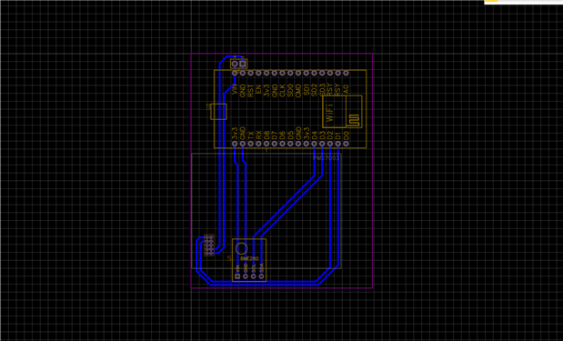

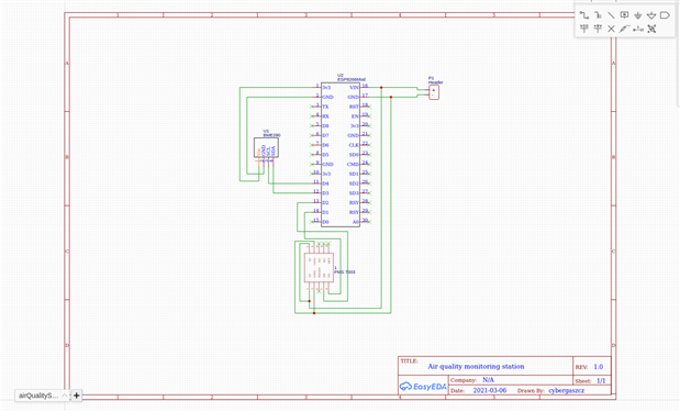

First stage was to create schematic and PCB for these devices. I used a online version of EasyEDA were I was able to quickly design PCB. Below are schematic and designed PCB:

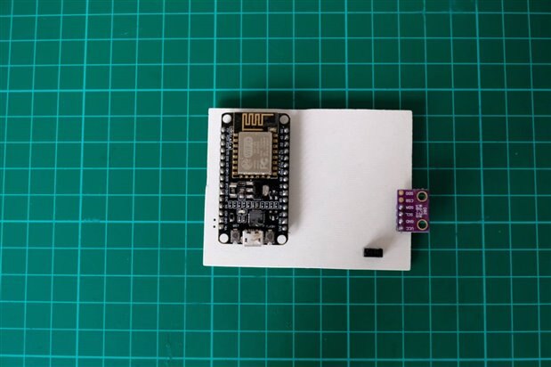

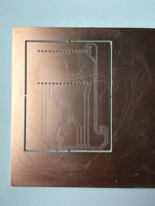

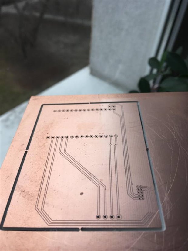

Next step was to made of PCB. I have decided to use my 3 in 1 convertible device and made PCB with CNC. I have used FlatCAM to generate proper g-code and AutollevlerEA tool to add corrections caused by irregularity of copper surface. Due that my CNC device do not had Z-axis probe in mean time I was forced to create it. I posted here about it: Z probe for the CNC machine [part 1]  Z probe for the CNC machine [part 2] . Below photos of PCB after milling process:

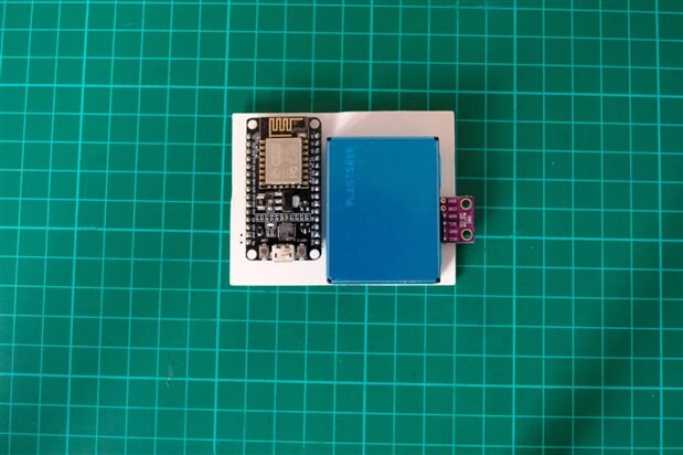

Next step was to solder everything together. At this stage I found that in future is better to add more spacing between solder pads. After soldering, I used PCB varnish to paint all surface and some upper electronic to achieve better protection from external environment. Below photos of soldered PCB:

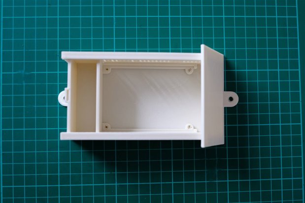

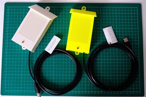

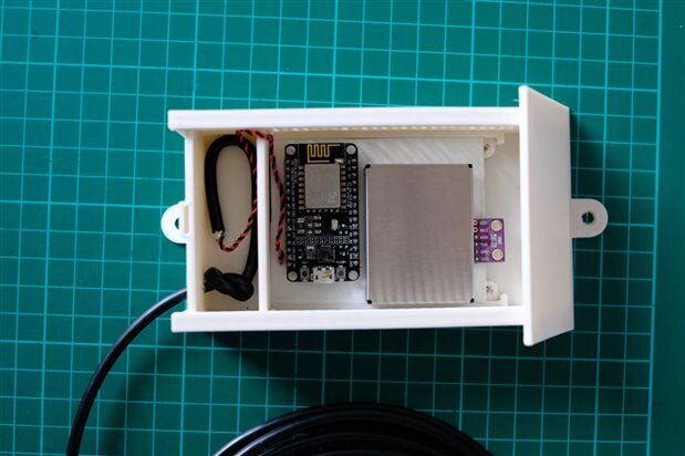

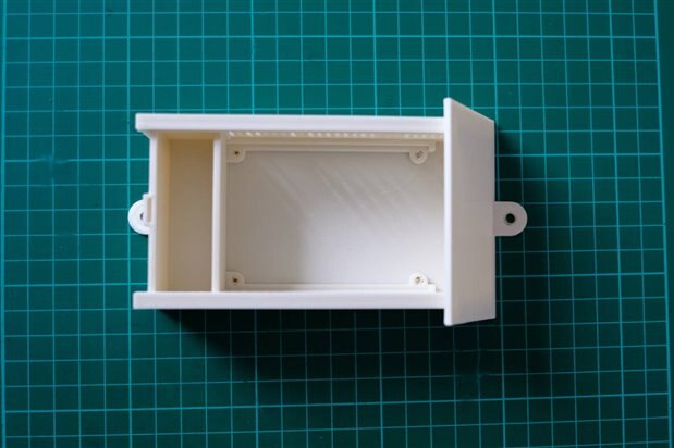

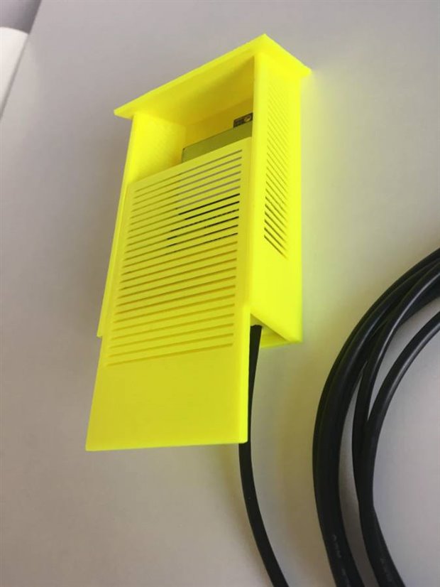

Next stage was to create a enclosure. I am at stage of learning and getting familiar with 3D printing, so I decided to print an enclosure. I found here: MySensors Mini Weather Station really nice project (quite similar to Stevenson screen) which I decided to use. I used the Cura firmware to resize and slice this case. Below are final results:

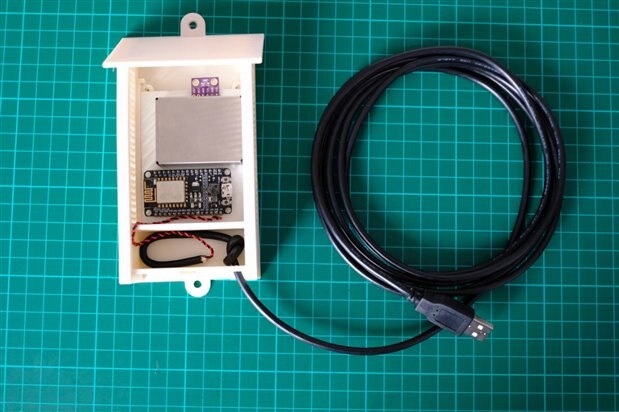

Case was printed with PLA and 30% infill and resolution of 0.2. After printing I painted this case with varnish, to get better protection from external environment. Last step was to add power supply and fit the electronics inside. For supply I have used 3 m wire from USB extension cord. Here are photos from assembly:

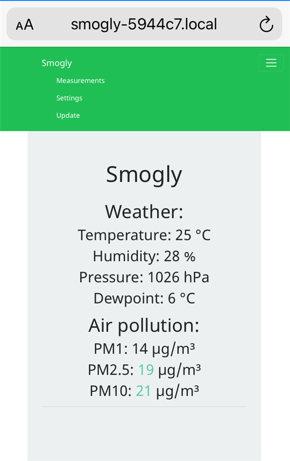

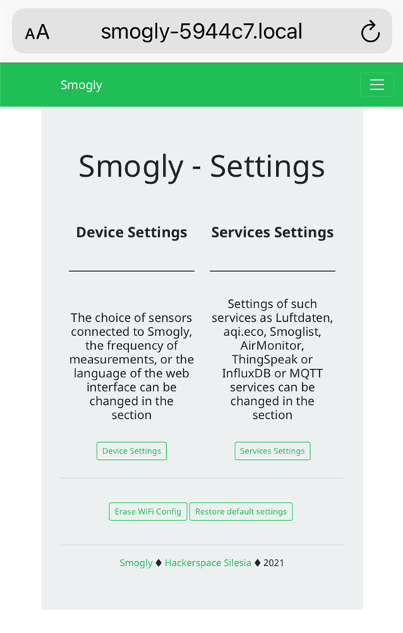

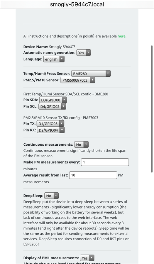

Last stage was to perform 24 hour test. I have initially configured these devices:
- set proper pinouts for dust sensor,
- set proper pinouts for BMP280 sensor.
Generally this firmware after adding the devices to local Wi-Fi network allow to access them via following address: http://smogly-XXXXXX.local. There is option to configure that these devices would send data to remote services like thingspeak.com etc. Below photos from initial configuration:
It will be nice experiment to check how these sensors performs in outdoor environment. The plan is to mount it on covered balcony.
