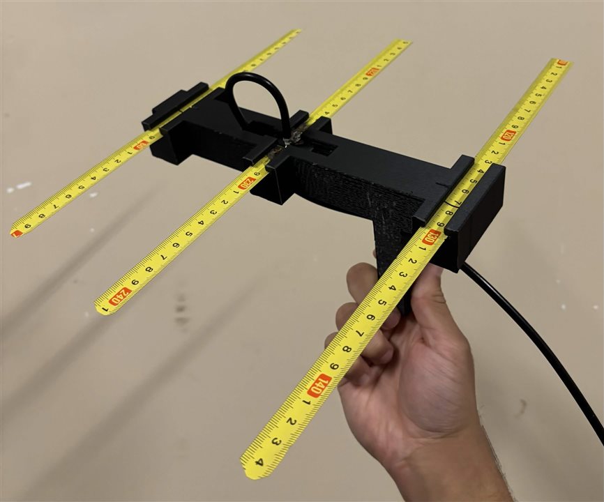

To solve the durability and cost issues, I used standard 16mm steel tape measure blades for the RF elements. Tape measure steel has a brilliant mechanical advantage: it holds its shape perfectly to direct the RF signal, but if it hits an obstacle or gets dropped, it safely folds and instantly snaps back into place without permanent damage.

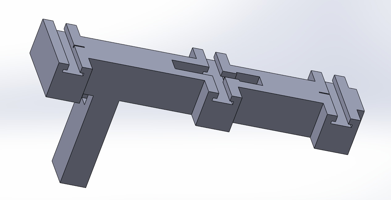

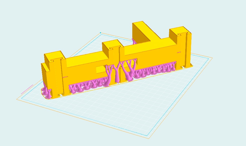

To mount the elements, I opened up SolidWorks and designed a custom, completely fastener-free frame printed in PLA. The entire frame is designed around friction-fit slots. This allows the antenna to be rapidly assembled for a deployment and quickly pulled apart for storage.
Challenge: Friction-Fit Tolerances Getting a friction-fit right in CAD is tricky because every 3D printer extrudes slightly differently. If the slots were too tight, the tape measure wouldn't slide in; if they were too loose, the elements would rattle and ruin the RF coupling. I had to prototype the center block multiple times, tweaking the slot width by fractions of a millimeter to account for the slight curvature of the tape measure blade.

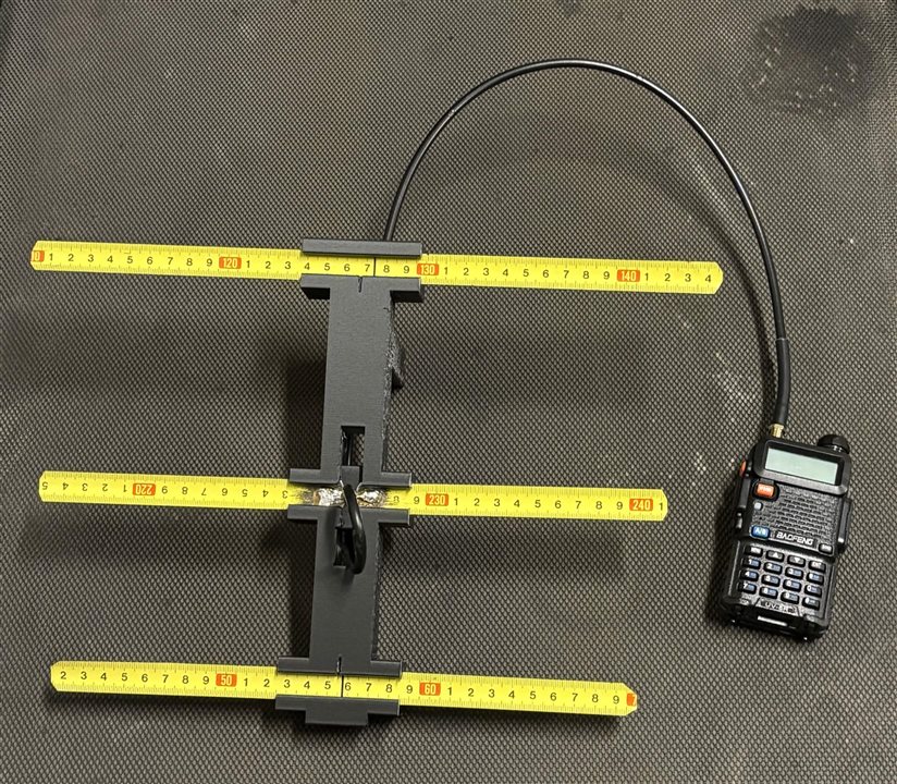

Designing a Yagi requires precise spacing to ensure the elements properly couple and direct the RF energy. I utilized the 3G-Aerial calculator (DL6WU / G3SEK optimization) to determine the exact geometry for 446.000 MHz:
  • Active Boom Length: 208 mm
  • Reflector to Driven Element Spacing: 116 mm
  • Driven Element to Director Spacing: 92 mm
Challenge: Avoiding a Matching Network Many Yagi antennas require a complex matching network (like a Gamma match or a Hairpin match) at the feed point to convert the antenna's natural impedance to 50 ohms. As a student without immediate access to a Vector Network Analyzer (VNA) at home, tuning a Gamma match would have been a nightmare. Instead, I carefully chose element lengths and spacing that naturally resulted in a feed point impedance of ~50 Ohms. This allowed me to directly connect a 50-ohm RG-58 coaxial cable without any extra matching hardware.
Instead of relying on a ruler during assembly, I baked the exact 116 mm and 92 mm dimensions directly into the 3D-printed CAD geometry. You simply mark the center of the cut tape measure blades and slide them into the slots until they align with the center-marks on the print. It bridges the gap between RF calculations and foolproof mechanical assembly.

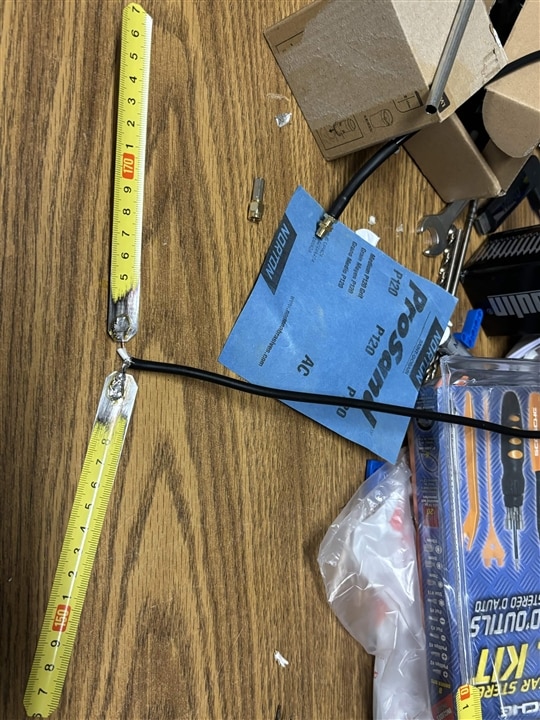

Challenge: Soldering to Steel Tape
Another physical hurdle in the build was creating a reliable electrical connection between the copper RG-58 coaxial cable and the steel driven elements. Tape measures are coated in paint and a durable clear coat, which completely rejects standard rosin-core solder.
The Solution:
  1. Mounted the two driven element halves into the printed frame with a precise 8 mm air gap in the center.
  2. Used sandpaper to aggressively strip the inner edges down to the bare steel.
  3. Soldered the coax center conductor to one side of the 8mm gap, and the twisted copper shield pigtail to the other.

I took the completed build out to the field and connected it to my handheld transceiver (Baofeng UV-5R). Tested on a high power setting, the directional gain (estimated at ~7.3 dBi) makes a considerable difference in establishing a clear line-of-sight simplex connection compared to a standard omnidirectional rubber duck antenna.
It was incredibly rewarding to see the math from a calculator turned into CAD, printed in plastic, and successfully firing RF energy downrange.

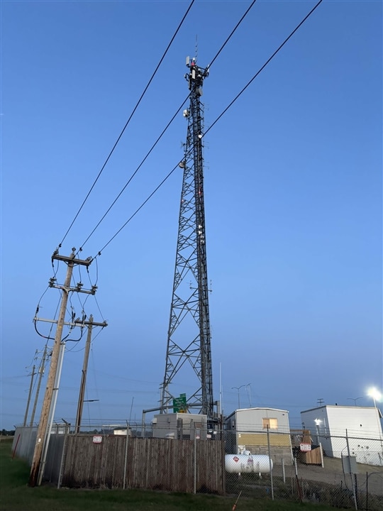

    shreaypatel2 2 months ago in reply to VK2EJH
    Thanks for checking out the build! I don't have hard SWR sweeps to share just yet, as I haven't purchased an SWR meter or VNA yet. However, because the steel tape measure blades are 16mm wide, they act as fat elements which helps give the antenna a broader usable bandwidth Even without formal tuning, the design seems to perform alright across a small spectrum. I was actually able to pull in the downlink of a local repeater operating at 441.100 MHz with moderate clarity from about 7 km away. If I manage to get my hands on an analyzer down the line and can map the actual resonance curve across the 70cm band, I’ll definitely update the GitHub repository with the charts!
