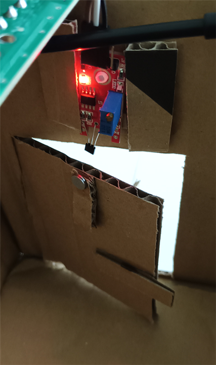

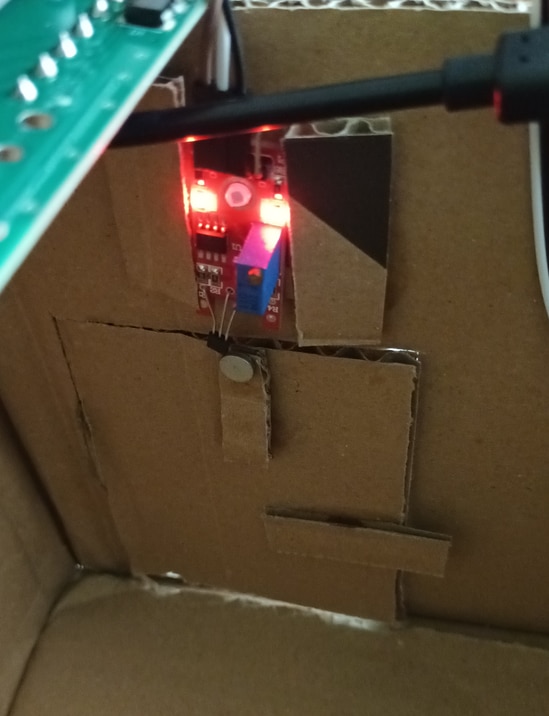

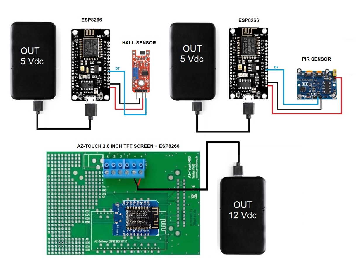

   In this project we are going to develop an alarm that detects when a door is opened and the presence of a person or animal in a room due to movement. For its realization we have the AZ-Touch kit with 2.8-inch TFT touch screen, linear magnetic hall sensor, passive motion sensor (commonly called PIR sensor) and 3 microcontrollers ESP8266, for communication between the microcontrollers we will use the ESP-NOW communications protocol, which avoids using wiring between the modules.
   The ESP-NOW protocol is very versatile, we can use it to communicate several transmitter modules to a single receiver module (the one we are going to use in this project), communicate a transmitter module with several receiver modules and a transmitter to a receiver both in a single direction and bidirectionally and we can also know if the information we have sent has reached the destination. Let's get started.

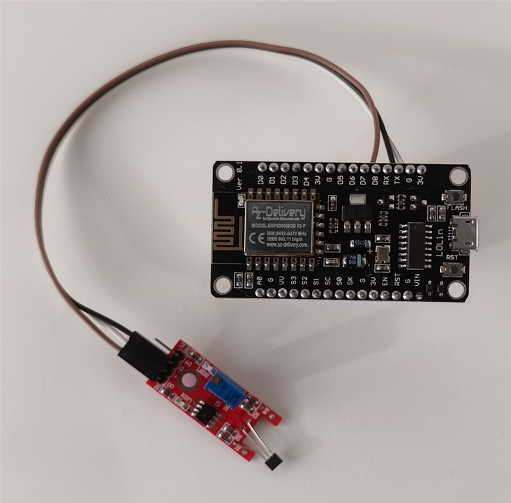

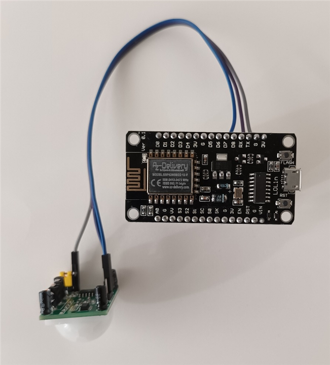

Electronic circuit
   If we analyze the component schematic, we see that we will use two sets of NodeMCU Lolin ESP8266 microcontroller  and sensors as emitters and the D1 Mini NodeMCU microcontroller ESP8266  together with the ZIHATEC AZ-Touch kit will be the receiver. The transmitter modules are powered through the micro usb port.

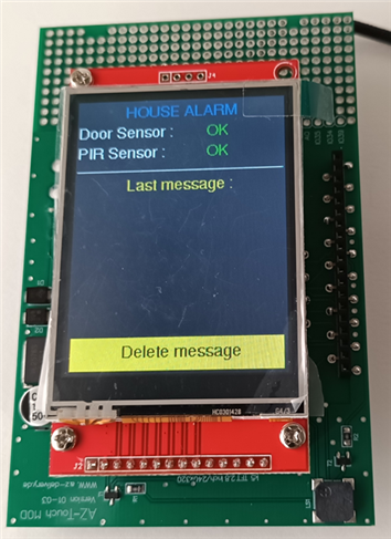

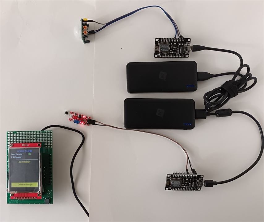

Project and sketchs performance description
   The operation of this project is as follows, the two ESP82266 of the sensors send the information with the data of the number assigned to their sensor and the status (high or low) of the digital pin. The linear magnetic hall sensor will be installed in the upper frame of a door and on the door we will stick a small magnet that is as close as possible to the sensor, the sensor will be at high level with the door closed, since the magnet will be close to the sensor so the situation will be normal and the OK message will appear  on the TFT screen next to the name of the sensor,  when the door is opened, the small magnet will be removed from the sensor and it will go to low level, then it will change the message on the TFT screen to Alarm and a warning line will appear with the message Door Alarm Detected. The presence sensor (PIR) will be placed in an upper corner of any room, it is at low level as long as it does not detect anything, so the OK message will appear  until it detects some presence, go to high level and the Alarm message  will appear on the TFT screen, as in the other sensor, a line will appear informing us of PIR Alarm Detected. In both cases when it changes to Alarm, the buzzer will sound until we press on the screen in the Delete message area. In the AZ-Touch kit we have installed the D1 Mini NodeMcu microcontroller that will receive the sensor id data and the status of the digital pin and will manage the display of the messages on the TFT screen and the buzzer sound.
   In order to have communication between the microcontrollers ESP8266 we will need the MAC address of the microcontroller that we will use as a receiver, to obtain this address we will connect the microcontroller to the Arduino IDE, select the port to which it is connected, open the Serial Monitor and execute the sketch get_mac_address.ino, the MAC address of the microcontroller will appear in the Serial Monitor, we must save this information because we will need it.

   The sketch is very simple, first check the ESP32 or ESP8266 microcontroller model and load the appropriate library to know the MAC address.
   This alarm project consists of three sketches: hall_sensor_module_1.ino, pir_sensor_module_2.ino and az_touch_receiver_esp8266.ino, the names are quite clarifying and reflect the circuits they belong to. The two sketches of the sensors are practically the same, just change the sensor identification number and add a line with a delay in the sketch of the presence sensor for optimal operation. Let's move on to describing the sketch of the presence sensor and the AZ-Touch module.

   To display the information on the TFT screen we must take into account that there is static text (the title, the names of the sensors and the line to delete the messages) and dynamic text (the status of the sensors and the line with the information of the sensor that has detected the intrusion); as the static text does not change, we have programmed it in the setup() method,  while for the dynamic one we have programmed it within the OnDataRecv function  which is the one that will be continuously executed. We will now describe how dynamic text is displayed.
   As the digital pin status of the sensors can be in HIGH or LOW state and we have two sensors, we have programmed a double conditional to first check the received value of the digital pin status and once inside each condition, we have programmed a multiple conditional with SWITCH to know which of the sensors has sent the value.
   Then, the first condition is to check that the state of the digital pin of the received data is in HIGH state (if(state.value == HIGH)), if this condition is met, the instructions of the if block are executed, in case it is LOW the else block will be executed.
   In the if  block we find a multiple conditional, where it is checked with  a switch (state.id-1) which of the sensors has sent the value, in case it is the sensor in position 0 of the array, it will mean that it has been the linear hall sensor and the instructions that are inside case 0 will be executed. If it is connected to the Arduino IDE, it will present the message "Hall sensor normal situation" through the Serial Monitor. The following instructions display the dynamic text across the TFT screen:
  • Set the font of the text with tft_screen.setFont(&FreeSans9pt7b).
  • Set the text size to 1 with tft_screen.setTextSize(1).
  • Place the cursor at the x=180 and y=45 coordinates with tft_screen.setCursor(180, 45).
  • Set the text color to black tft_screen.setTextColor(ILI9341_BLACK).
  • Type the Alarm text with tft_screen.println("Alarm"), delete the Alarm text at those coordinates if it exists, since the background color of the screen is black like the text.
  • Place the cursor at the coordinates x=150 and y=45 with tft_screen.setCursor(150, 45).
  • Set the text color to green tft_screen.setTextColor(ILI9341_GREEN).
  • Type the OK text with tft_screen.println("OK") in green.
   And he comes out of the conditional.
   If, on the other hand, when the sensor is checked, the resulting id is 1, it means that the data information has been sent by the motion sensor and the instructions of case 1 will be executed, and these are:
  • It will display the message "PIR Sensor Intrusion Detected" on the Serial Monitor.
  • Place the cursor at the coordinates x=150 and y=70 with tft_screen.setCursor(150, 70).
  • Type the OK text with tft_screen.println("OK") to erase the text at those coordinates if it exists, as the background color of the screen is black just like the text.
  • Place the cursor at the x=180 and y=70 coordinates with tft_screen.setCursor(180, 70).
  • Set the text color to red tft_screen.setTextColor(ILI9341_RED).
  • Write the text Alarm in red with tft_screen.println("Alarm").
  • Place the cursor at the x=2 and y=145 coordinates with tft_screen.setCursor(2, 145).
  • Type the Door Alarm Detected text with tft_screen.println("Door Alarm Detected") to erase the text in those coordinates if it exists, since the background color of the screen is black.
  • Type the text PIR Alamr Detected with tft_screen.println("PIR Alarm Detected").

void setup() {
      Serial.begin(115200);						                                    // Serial Monitor initialization
      WiFi.mode(WIFI_STA);						                                    // Configuration of the ESP8266 module as a wifi station
      WiFi.disconnect();						                                      // Disconnect the ESP8266 module from the router's wifi network
      if (esp_now_init() != 0) {					                                // If the ESP-NOW protocol does not initialize,
            Serial.println("Error initializing ESP-NOW");		              // the information is displayed by the Serial Monitor
            return;
      esp_now_set_self_role(ESP_NOW_ROLE_SLAVE);			                    // We configure the ESP8266 as a slave, so that it can receive the information
      esp_now_register_recv_cb(OnDataRecv);				                        // When data is received, the OnDataRecv method is called with the data it receives
      pinMode(TFT_LED, OUTPUT);						                                // Configuration of the microcontroller port as output for TFT display backlighting
      /*--  Initialization of tft screen, touch screen and graphical environment application  --*/
      Serial.println("Init TFT and Touch ...");				                    // Information that tft screen and touch screen will be initializate
      tft_screen.begin();						                                      // TFT screen initialization
      touch_screen.begin();						                                    // Touch screen initialization
      Serial.print("TFT x = ");						                                // Message on the Serial Monitor
      Serial.print(tft_screen.width());					                          // Serial Monitor show the width data TFT screen
      Serial.print("TFT y = ");						                                // Message on the Serial Monitor
      Serial.print(tft_screen.height());				                          // Serial Monitor show the height data TFT screen
      tft_screen.fillScreen(ILI9341_BLACK);				                        // TFT color display with black fill
      digitalWrite(TFT_LED, HIGH);					                              // TFT display backlighting is turned on
      tft_screen.setFont(&FreeSans9pt7b);				                          // Set font type text to write in the TFT screen
      tft_screen.setTextSize(1);					                                // Text size configuration
      tft_screen.setCursor(56, 20);					                              // Coordinates to positionate the cursor on the TFT screen
      tft_screen.setTextColor(ILI9341_BLUE);				                      // Text color configuration to write text
      tft_screen.println("HOUSE ALARM");				                          // Write the text in the TFT screen
      tft_screen.setCursor(2, 45);					                              // Coordinates to positionate the cursor on the TFT screen
      tft_screen.setTextColor(ILI9341_WHITE);				                      // Text color configuration to write text
      tft_screen.print("Door Sensor : ");				                          // Write the text in the TFT screen
      tft_screen.setCursor(2, 70);					                              // Coordinates to positionate the cursor on the TFT screen
      tft_screen.print("PIR Sensor : ");				                          // Write the text in the TFT screen
      tft_screen.drawFastHLine(2, 87, 236, ILI9341_WHITE);		            // Draws a line with the coordinates and color of the passed parameters
      tft_screen.setCursor(60, 110);					                            // Coordinates to positionate the cursor on the TFT screen
      tft_screen.setTextColor(ILI9341_YELLOW);				                    // Text color configuration to write text
      tft_screen.print("Last message :");				                          // Write the text in the TFT screen
      tft_screen.fillRect (4, 280, 232, 36, ILI9341_YELLOW);		          // Draws a rectangle with the coordinates and color of the passed parameters
      tft_screen.setCursor(60, 301);					                            // Coordinates to positionate the cursor on the TFT screen
      tft_screen.setTextColor(ILI9341_BLACK);				                      // Text color configuration to write text
      tft_screen.print("Delete message");				                          // Write the text in the TFT screen
