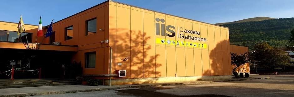

The CWbeacon project started at the IoT Lab of IIS Cassata Gattapone in Gubbio, Italy, where students build real-world embedded systems that blend classical radio techniques with modern connectivity. The lab operates under the special call sign IA/IU0SZS, which appears at the start of every Morse transmission this beacon makes.
The project has six hardware and software sub-projects: an RF signal generator board (Si5351A), a 3 W RF power amplifier, a 20 m low-pass filter, a NodeMCU controller board, the firmware described in this post, and a compact 14 MHz antenna. Together they form a self-contained HF station that can be placed anywhere with a power source and a network connection.
The most remarkable deployment so far: Concordia Station, Antarctica. A unit was installed there, where it transmitted its authenticated Morse messages from 75° South — about as far from Gubbio as a radio wave can travel.

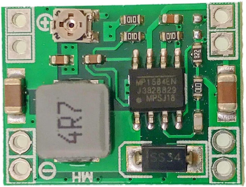

3.1. Power Supply: DC/DC Step-Down Converter (12V to 5V)
Converts the incoming main supply voltage (12V) down to a clean 5V line required by the main microcontroller and onboard sub-circuits, ensuring high conversion efficiency and low thermal output.
It is based on a small step-down voltage regulator, the MP1584 from MPS, operating at 1.5 MHz, placed on a very small PCB (17 x 22 mm), capable of providing up to 3A of current.

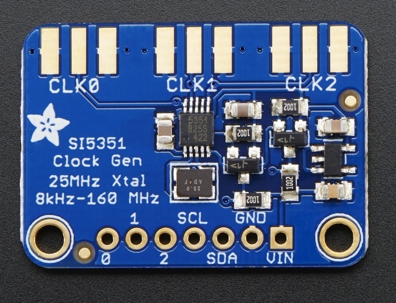

3.2. RF Signal Generator — Si5351A Clock Module
The carrier frequency is generated by an Etherkit Si5351A breakout board, a triple-output programmable clock IC driven over I²C (SDA on GPIO4/D2, SCL on GPIO5/D1).
The CLK0 output is set to 14.097 MHz at startup and can be trimmed via a correction factor stored in EEPROM.
The Si5351A gives excellent frequency stability for a few dollars — far better than a simple crystal oscillator — and its output can be gated on/off in microseconds, which is exactly what Morse keying requires.

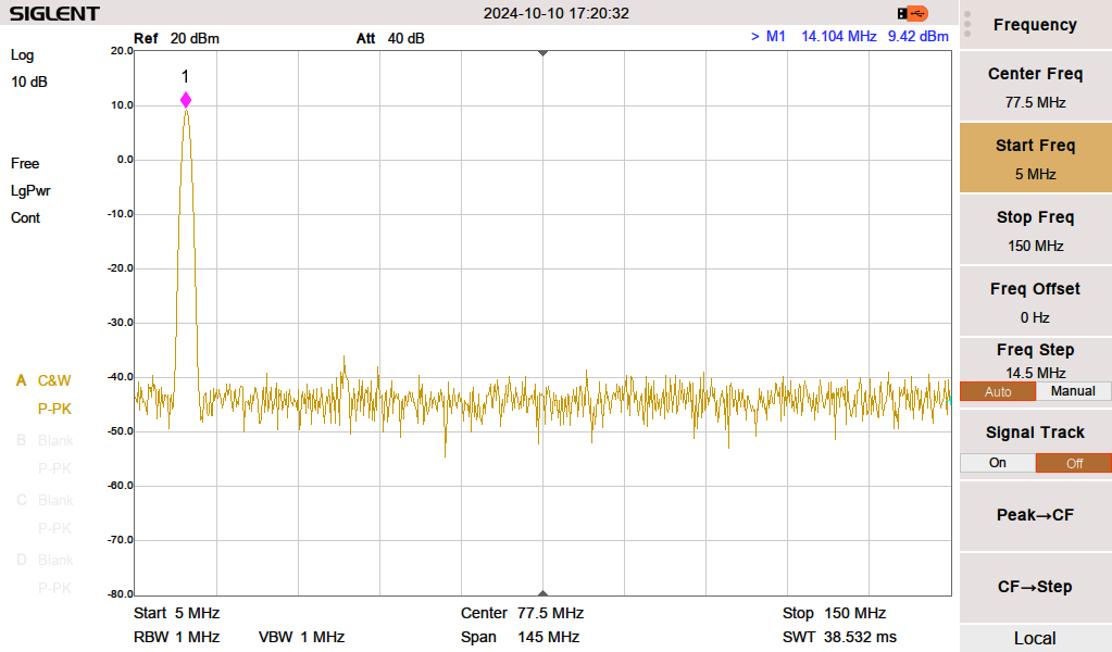

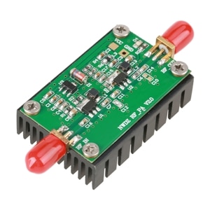

3.3. RF Power Amplifier — 3 W Linear Stage
The Si5351A output level (a few milliwatts) is amplified by a small class-AB linear amplifier to approximately 3 W continuous power.
The stage uses a pair of RF transistors in cascade configuration and is biased for good linearity — important for CW (low harmonic distortion; spectral purity matters also for amateur radio regulations).
Here below the RF spectrum of the amplified signal.

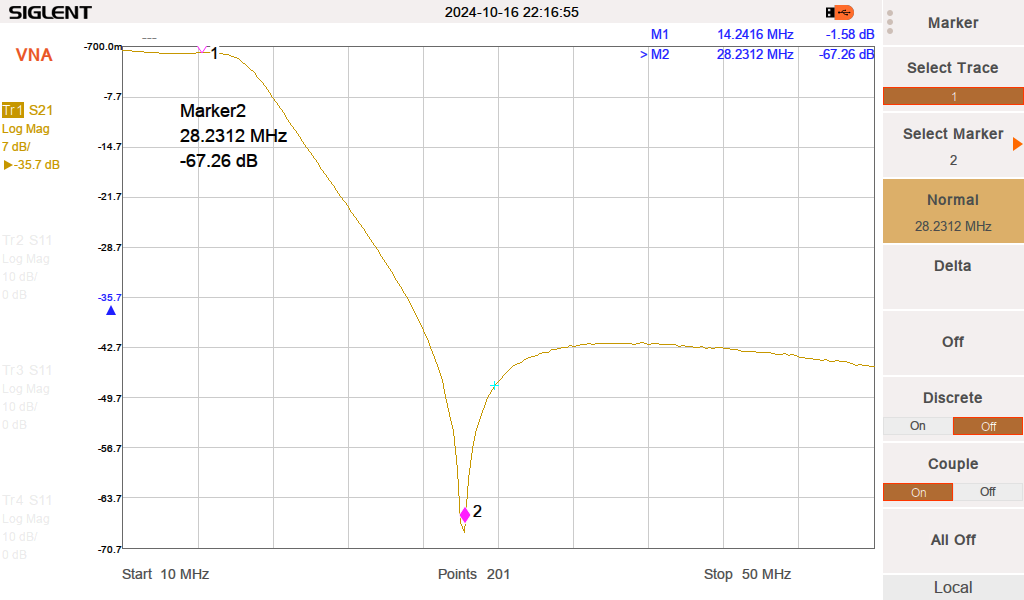

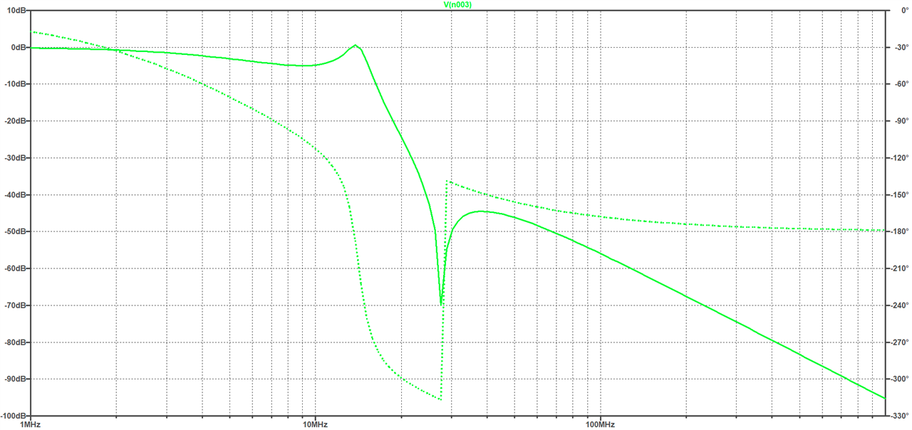

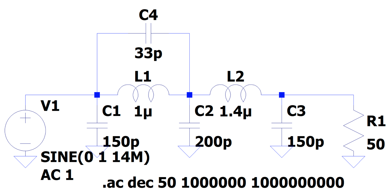

3.4. Filtering: LC Low-Pass and Notch Filter
An LC low-pass filter and a notch filter have been added to ensure the signal is emitted only on the desired frequency. They are essential for spectral purity and regulatory compliance.
The circuit is depicted below.
The simulation of the frequency response of the filter has been done with the software LTspice.
From the image below. we can clearly see the 0 dB attenuation at 14 MHz and the strong effect of the notch filter at 28 MHz, the second harmonic.
Suppresses unwanted harmonics and spurious emissions generated during signal generation and power amplification, outputting a clean sine wave to the antenna is mandatory.

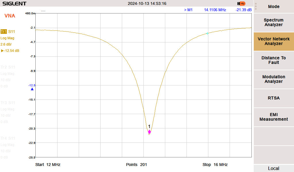

The image below depicts the frequency response of the combined LPF and NOTCH filter as measured with a Siglent SVA1032X vector network analyzer

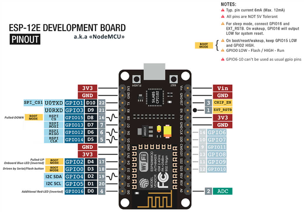

3.5. Controller Board — NodeMCU v2 (ESP8266)
The brain of the system is a NodeMCU v2 module carrying an ESP8266 with 4 MB of SPI flash.
It handles the I²C bus to the Si5351A, drives a status LED on GPIO14 that blinks in sync with the Morse carrier, manages Wi-Fi in dual STA/AP mode, and runs the web server, Telegram bot, and NTP client simultaneously.
The firmware is described later in this article.

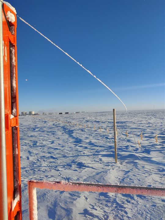

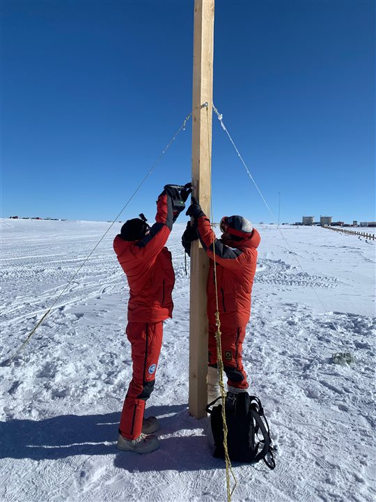

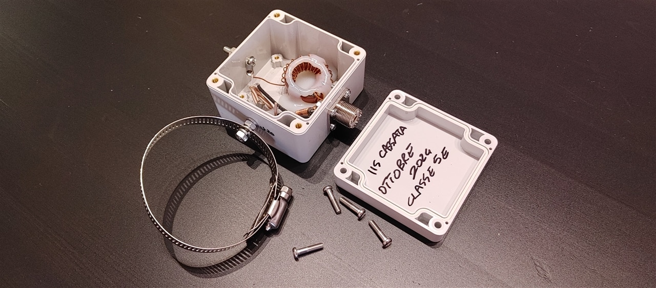

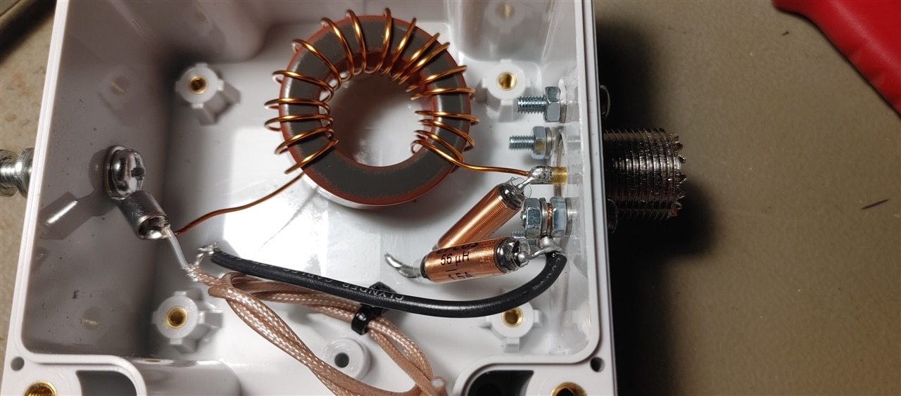

3.6. Antenna System: End-Fed 20-Meter Band Antenna
A half-wave end-fed antenna tuned specifically for the 14 MHz band, providing efficient radiation in harsh Antarctic conditions with a straightforward installation footprint.

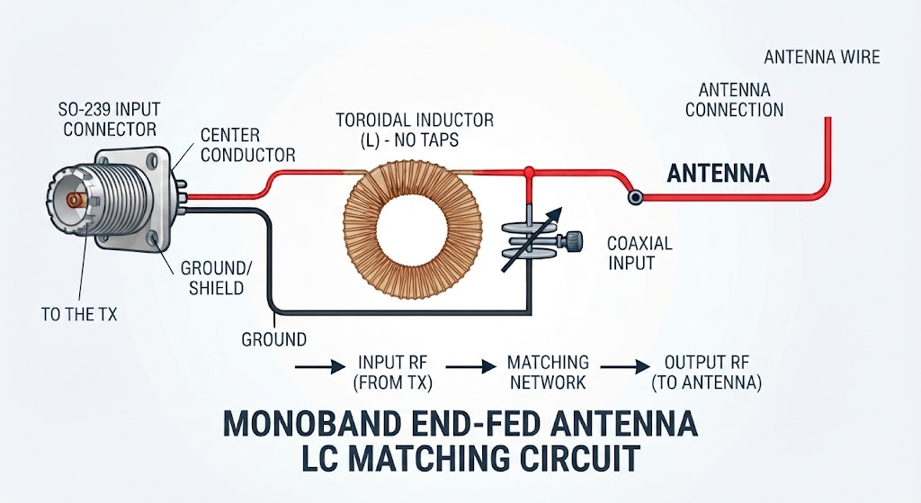

An end-fed antenna is essentially a half-wave dipole fed at one end by appropriate matching circuitry, depicted below.
The circuitry of the matching electronics is shown in the following image. It comprises an inductor and a capacitor, opportunely calculated to obtain an impedance of 50 Ohm at the input connector.
The values of the inductor and the capacitor are, respectively, 4.5 uH and 28 pF. The inductor is obtained with 16 turns of the wire on a T130-2 toroid core, while the capacitor is obtained with 27 cm of a RG316 coaxial cable. The antenna wire length is around 10.14 m. The capacitor and antenna wire length have to be adjusted during the installation to obtain the best resonance possible. The image below shows the very good tuning of the antenna with a very good value of the S11 parameter.
Two more inductors (2 x 56 uH) are connected directly on the coaxial connector: they act as a DC short for electrostatic discharges, very common in very dry environments.
The two images below show the moment the antenna was installed (at around -35°C) at Concordia Station, Dome C, Antarctica.
The wire of the antenna is covered with ice. Given the extreme weather conditions, a special cable has to be used with insulation made of PTFE or FEP; common PVC or other plastics are not suitable for temperatures below -40°C
image image
The antenna is connected to the transmitter with a very good quality coaxial cable, provided for free by one of our sponsors, Messi & Paoloni. We thank them very much for the excellent cable.

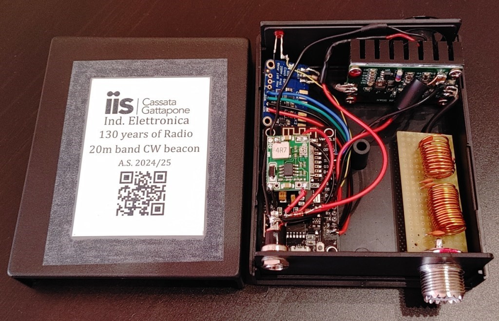

4. Final Assembly & Integration Test
All six modules are housed in a compact enclosure. Power-on sequence: the NodeMCU boots, loads all settings from emulated EEPROM, attempts Wi-Fi in STA mode, falls back to AP mode if the network is unreachable, fetches the current time from NTP, composes the beacon message with its embedded CRC, and begins the first Morse transmission within seconds of power-up.
In the following image, from the bottom right to the left: input power connector, DC/DC converter, the NodeMCU, the Si5351 signal generator, and an LED.
In the upper portion of the image, from left to right, we have: a small fan, the RF power amplifier with its heat sink, the LC filter, the SO-239 RF connector.

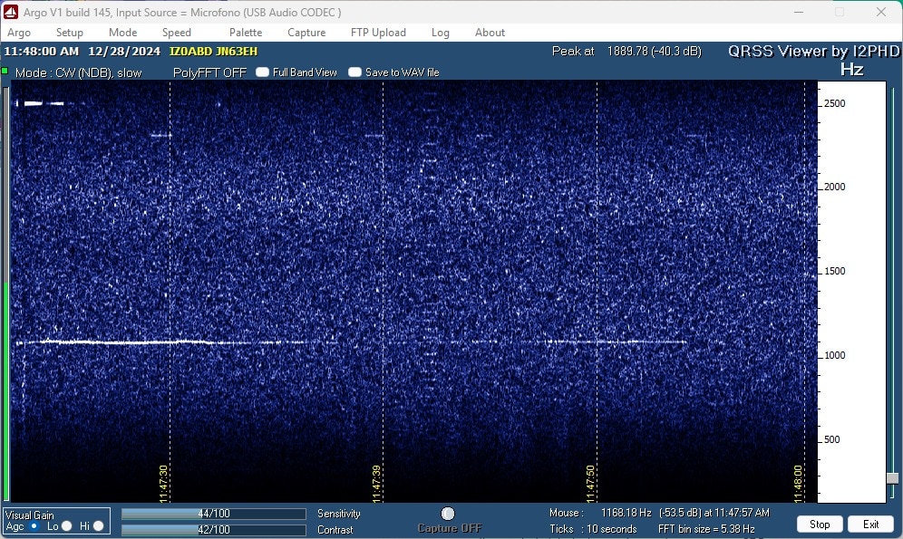

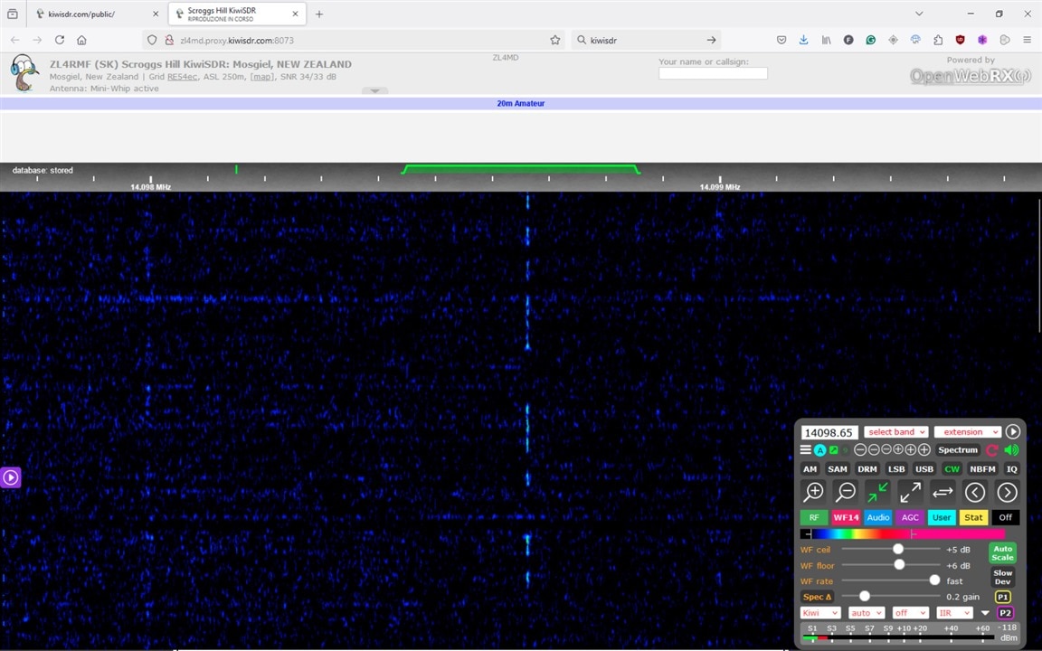

7. Real-World Results & Propagation Testing
Operating a beacon on the 20-meter band from the Antarctic interior allows radio amateurs and automated tracking networks worldwide to log beacon receptions. This provides practical insights into HF ionospheric propagation, solar activity effects, and signal attenuation in polar conditions.
In any case, receiving the weak signal is not easy; the transmit power is only 3W, and the antenna is a single-band end-fed for the 20m band.
Shown below is the spectrogram of the signal received in New Zealand via a web SDR.
The following image, however, shows the signal received in Italy, over 15,000 km away. A faint trace is visible—one that can only be detected using software designed for receiving slow signals.
