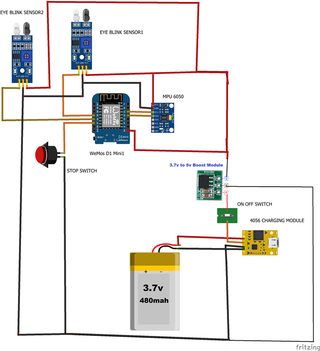

2. Hardware
Wearable Transmitter
The glasses contain:

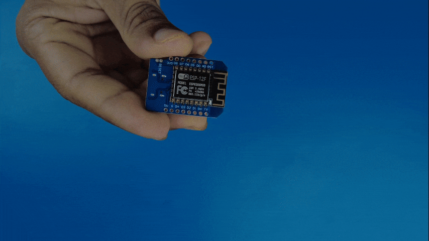

  • WeMos D1 Mini / ESP8266
  • 2 × IR reflective blink sensors

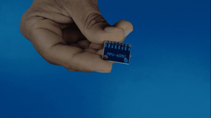

  • MPU-6050
  • Push button
  • LiPo battery
  • TP4056 charging module
  • 3.7 V → 5 V boost converter
  • Safety-glasses frame
The MPU-6050 detects the orientation of the user's head, while the two IR sensors detect deliberate blink patterns.

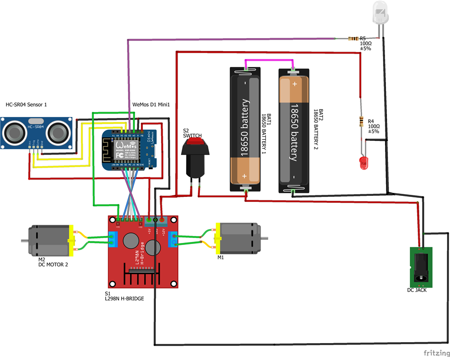

Wheelchair Receiver
The receiver contains:
  • L298N motor driver
  • DC geared motors
  • HC-SR04 ultrasonic sensor
  • 2 × 18650 cells
  • Power LED
  • Status LED
  • Power switch
  • Activation button
  • PVC foam-board chassis

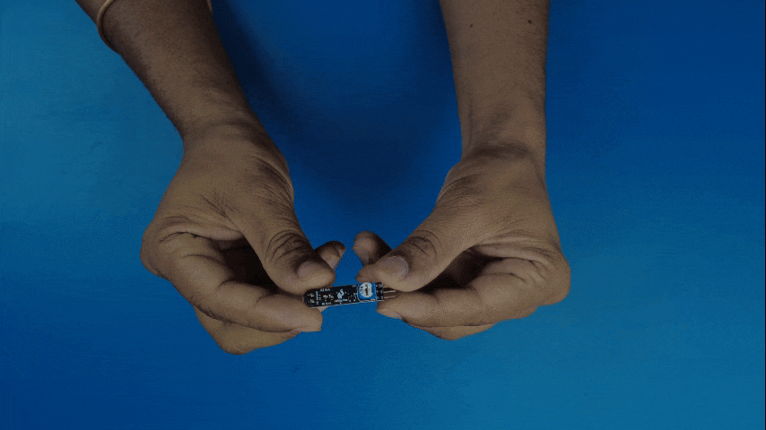

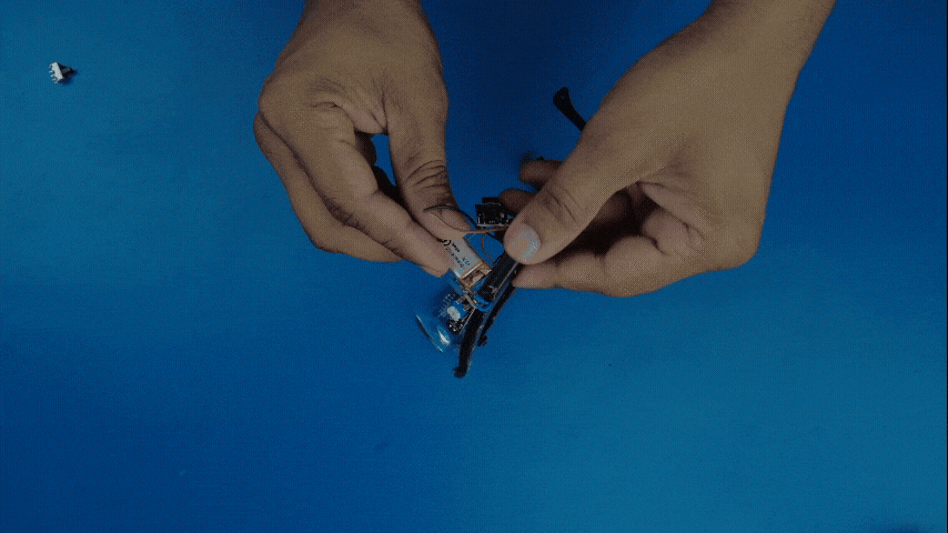

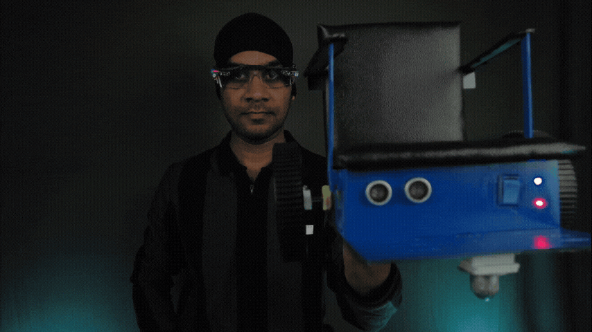

3. Building the Wearable Controller
I started with a lightweight pair of safety glasses and mounted two IR blink sensors inside the frame.
The sensor position is important because the distance and angle relative to the eyelids affect the detection response.
During testing, I also found that strong ambient infrared, especially direct sunlight, can affect the sensors. This is one of the limitations I plan to address in a future version.
I then added the ESP8266 and MPU-6050.
The MPU-6050 is mounted on the glasses and is used to detect:
  • Forward
  • Backward
  • Left
  • Right
eyeblink sensor
esp tx
mpu
4. Improving the Power System
During early testing, the blink sensors and MPU-6050 were not responding as reliably as expected.
After investigating the problem, I found that the available battery voltage was not suitable for stable sensor operation.
I added a small boost converter to provide approximately 5 V to the sensor/control section.
After this change, the sensor response became much more stable.
This was one of the practical lessons from building the prototype:
theoretical component specifications are not enough — the complete power system has to work reliably together.
battery

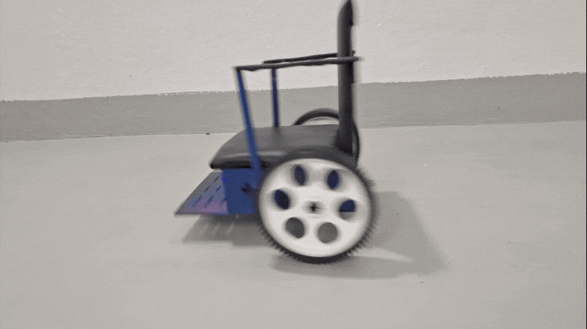

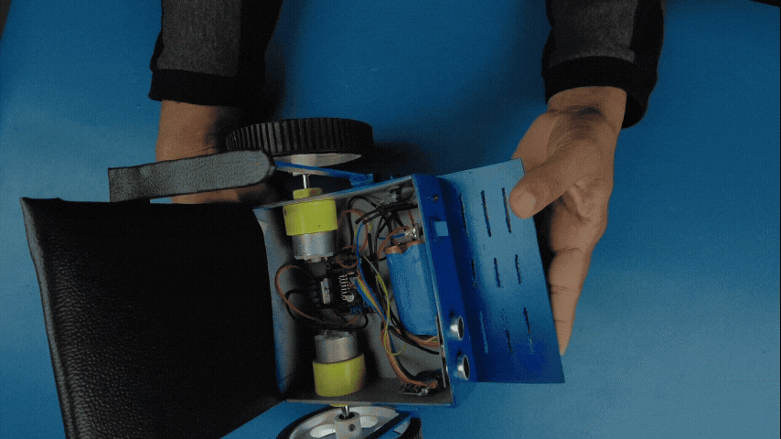

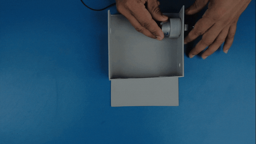

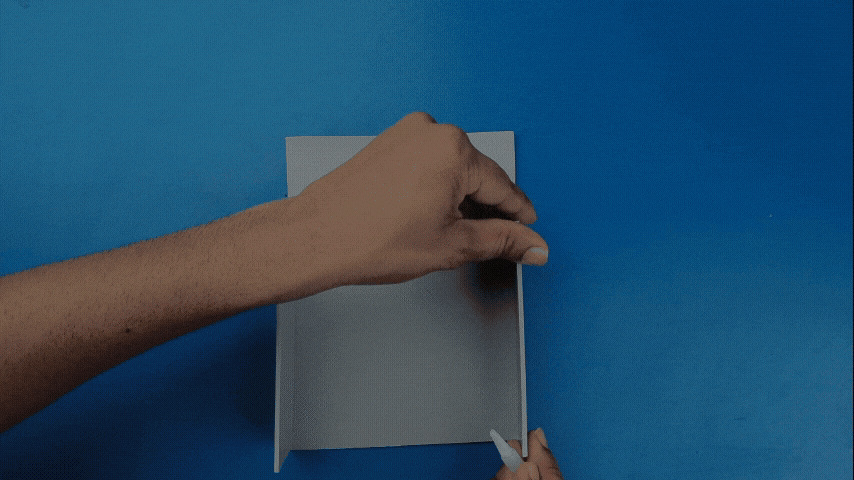

5. Building the Wheelchair Platform
I built the drive base using PVC foam board and installed four geared DC motors.
Initially I tested 300 RPM motors, but they were too fast for the small prototype.
The movement was abrupt and turning/stopping was difficult to control.
I changed to 100 RPM geared motors, which produced much more controllable movement.
This was an important design decision made from actual testing rather than simply choosing motors from their specifications.chasis
motors and driver

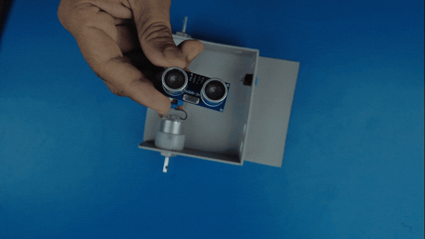

6. Obstacle Detection
The user's head and eye signals tell the system what movement is intended, but they do not tell the wheelchair whether an obstacle is physically in front of it.
So I added an HC-SR04 ultrasonic sensor to the front.
In the current implementation, forward movement is blocked when an obstacle is detected within approximately 20 cm.
The current implementation uses a hard stop rather than gradual speed reduction, so this is an area I want to improve in the next version.
ultrasonic

The glasses and wheelchair communicate using ESP-NOW.
The communication path is:
Eye/Head Sensors → ESP8266 TX → ESP-NOW → ESP8266 RX → Motor Driver → Motors
ESP-NOW allows the two ESP8266 devices to communicate directly without:
  • Wi-Fi router
  • Internet connection
  • Smartphone application
  • Cloud service
The wearable unit creates a command, and that command is transmitted as a wireless signal to the wheelchair receiver.
So the project is not simply detecting a gesture — it is detecting, confirming and transmitting a control message wirelessly

Get RX MAC Address → Calibrate MPU-6050 → Configure TX → Upload RX Firmware
First, I obtain the receiver ESP8266's MAC address.

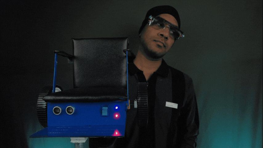

9. The Core Control Logic
This is the most important part of EyeLink.
I did not want one sensor event to directly control the motors.
Instead, the firmware works in two stages.
Stage 1 — Select
The user tilts their head in a particular direction.
The system checks that the movement remains in the required position and locks the selected direction.
Stage 2 — Confirm
Only after the direction has been locked does the system look for the correct blink pattern.
The logic is:
Head Tilt → Direction Lock → Blink Confirmation → Movement Command
Both conditions must agree before the command is accepted.
This is the central control concept behind EyeLink.

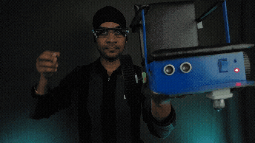

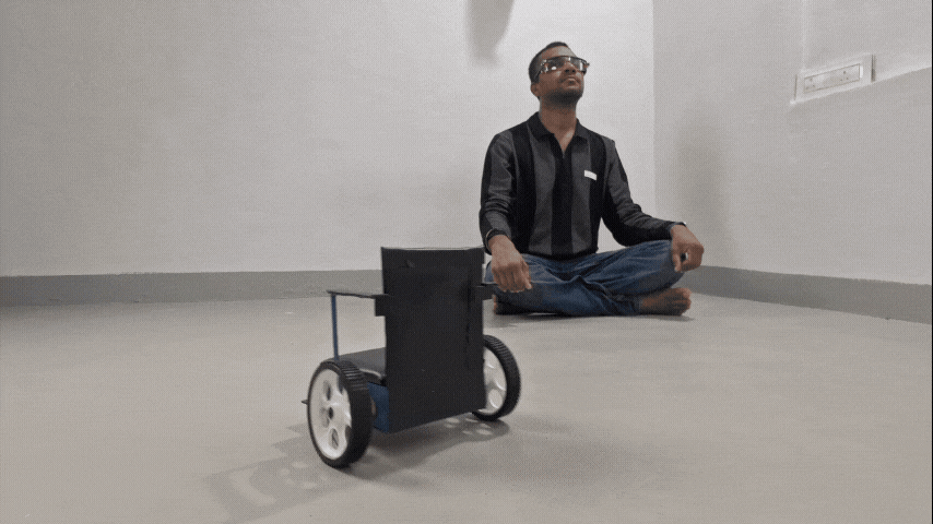

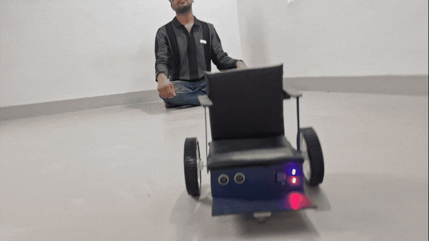

10. Movement Commands
Forward
Tilt head forward + double blink with both eyes
forword
Backward
Tilt head backward + double blink with both eyes
Forward and backward can continue moving after the command has been confirmed, making longer movements more practical.
backword
Left
Tilt left + double blink with the left eye
Right
Tilt right + double blink with the right eye
Left and right are handled as shorter movement pulses rather than continuous rotation, giving better control during directional changes.
left

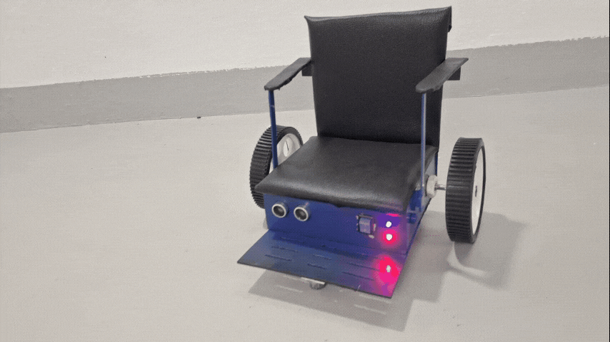

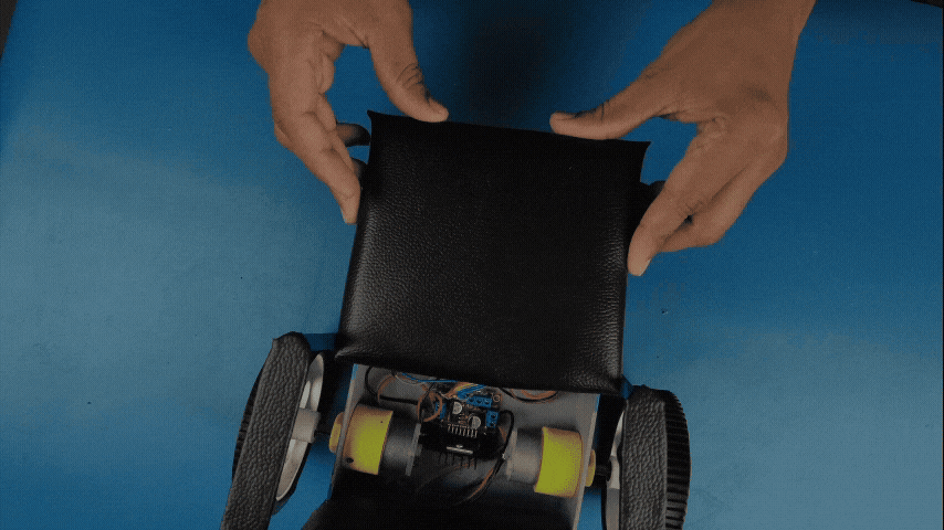

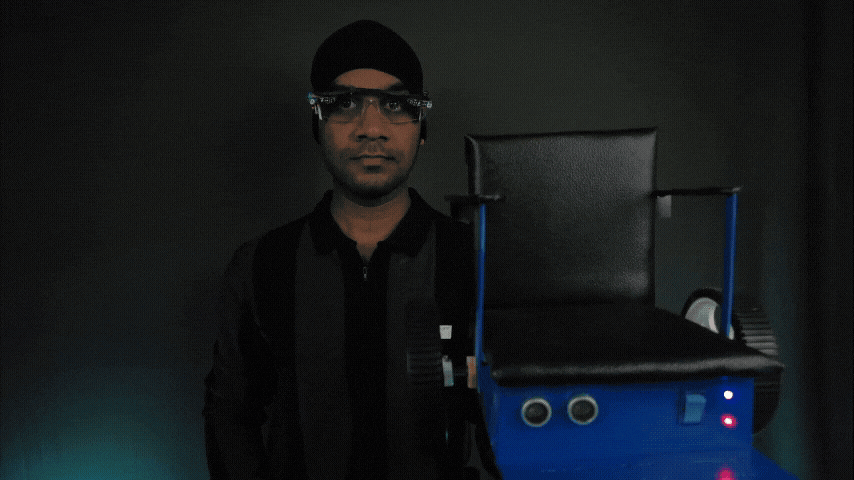

12. Final Prototype
After the electronics and control system were working, I finished the physical appearance of the prototype.
I used:
  • PVC foam board
  • Sponge/foam
  • Bike-seat-cover material
  • Spray paint
This doesn't change the electronics, but it makes the prototype much easier to understand visually and gives the final build a more finished appearance
open case.
seat cover

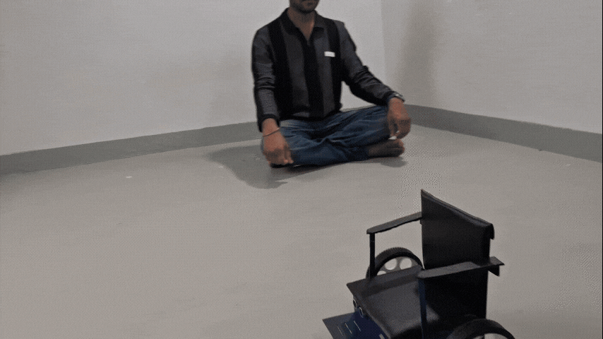

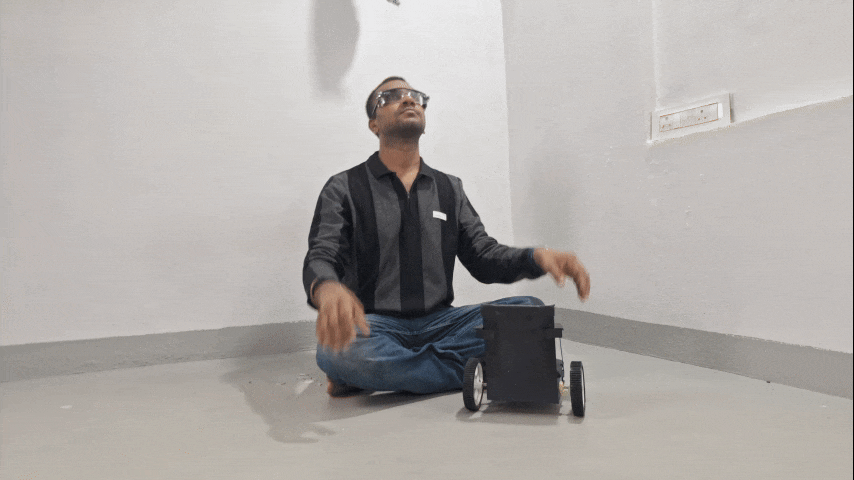

13. Testing the System
I deliberately tested incorrect inputs as well as normal commands.
Examples included:
  • Blinking while the head was centered
  • Using the wrong blink pattern
  • A single blink instead of the required pattern
  • Moving the head without confirmation
  • Communication loss
  • Obstacle detection
  • Forward movement
  • Backward movement
  • Left movement
  • Right movement
The expected result for an incorrect gesture is that the wheelchair remains stationary.
The basic successful sequence is:
Tilt → Hold → Blink → Command Confirmed → Wheelchair Moves
I then tested the complete system with the glasses, wireless communication, motor control and obstacle detection working together.
