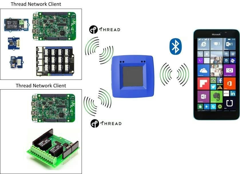

Architecture and Network Topology
A key element of the project is the use of the Thread wireless mesh network (based on the IEEE 802.15.4 standard), which ensures secure, low-power, and self-healing communication between all nodes distributed throughout the greenhouse.
The system architecture can be divided into two main layers:
  1. Thread Network Clients: Responsible for collecting data from sensors and executing local control of physical devices.
  2. Hybrid Router: Receives data from the entire sensor network and makes it available to the end-user via a Bluetooth Low Energy (BLE) interface.
The concept is illustrated in the diagram above. The system's components communicate with each other using the Thread wireless networking protocol.

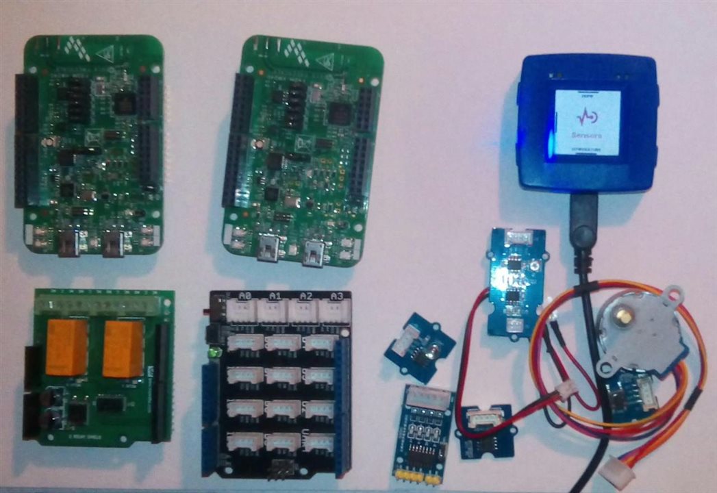

The prototype was built using dedicated NXP microcontrollers, evaluation boards, and universal expansion modules:

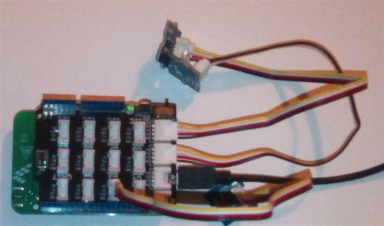

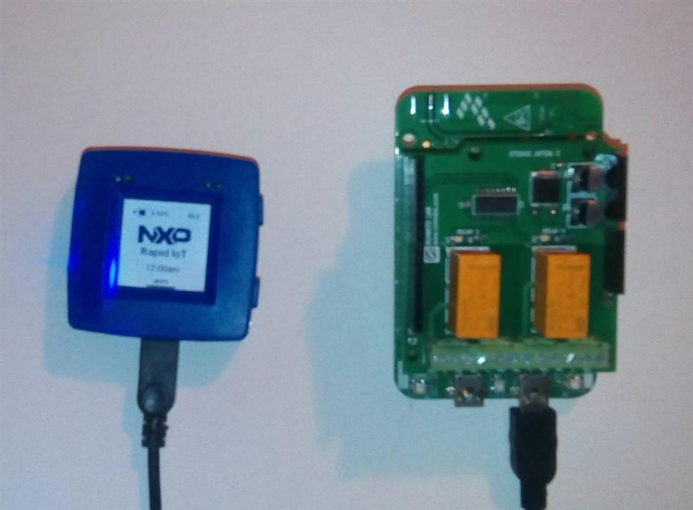

  • NXP Rapid IoT Prototyping Kit – acts as a hybrid border router and central control point.
  • FRDM-KW24D – ARM Freedom Development Board for Kinetis KW24D MCU  – basic client nodes for the Thread network.
  • Seeed Studio Grove Starter Kit – a kit containing a light sensor, temperature sensor, mini servo, and a smart relay module. The pin connectors of the FRDM-KW24D boards are fully compatible with Arduino Headers, facilitating shield and sensor mounting.
  • Numato Relay Shield – 2 Channel – an additional two-channel relay module to handle higher electrical loads (such as heaters and pumps).

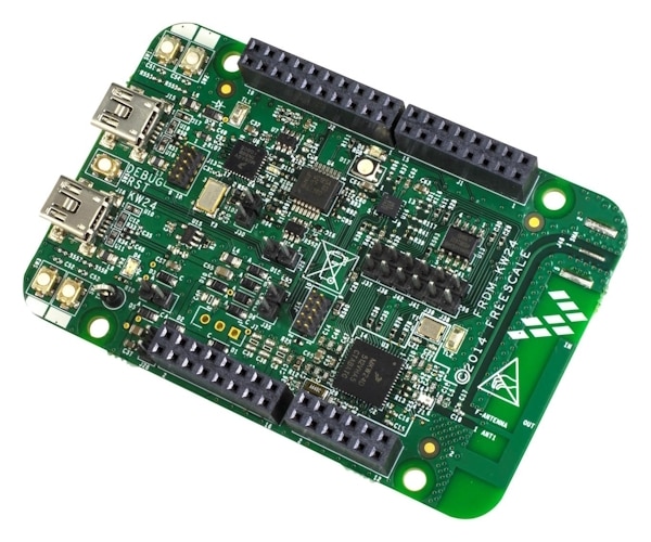

Each monitoring node in the mesh network is based on the NXP MKW24D512 Kinetis Wireless MCU.
  • The NXP FRDM-KW24D evaluation boards were used to test firmware and radio communication stability.
  • A wide range of compatible sensors (temperature, light) and actuators (relays, servos) were attached to the boards using universal Arduino Headers and the Grove system.
  • The program, written using Kinetis MKW2xD and MCR20A Connectivity Software and compiled in Kinetis Design Studio IDE, handles cyclical environmental data reading and native control of relay outputs based on predefined threshold logic (Edge Computing).

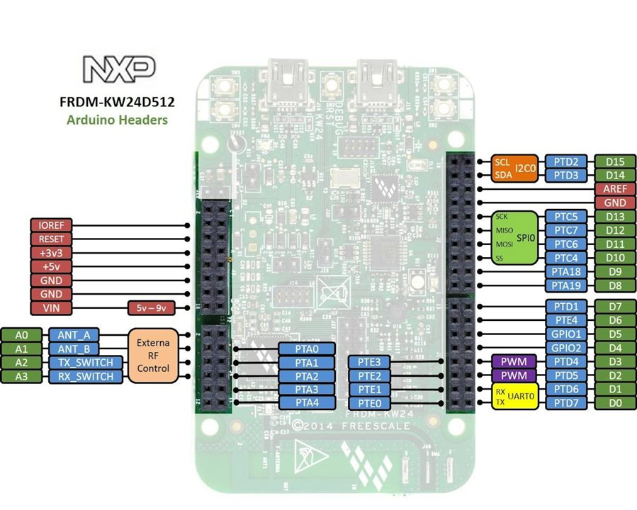

The FRDM-KW24D board connectors are compatible with Arduino Headers.

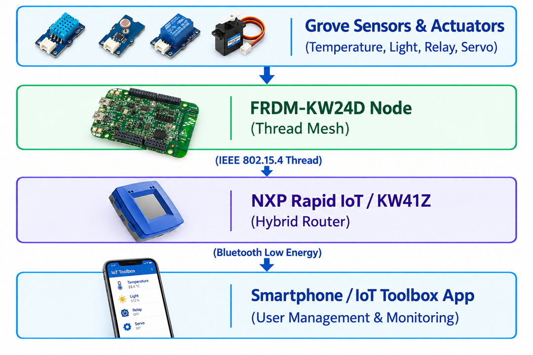

System Architecture & Topology
The system is structured into a three-tier architecture designed for scalability, low power consumption, and local autonomy:
1. Sensor & Actuator Layer (Edge Nodes)
Each greenhouse zone features an FRDM-KW24D board connected to Grove sensors. The board samples physical quantities periodically. Crucially, it runs local automation rules (Edge Computing): if the temperature exceeds a predefined safety threshold, the MCU activates the relay or servo instantly, bypassing network latency or dependency on the cloud.
2. Mesh Network Layer (Thread Protocol)
Nodes communicate using the Thread network protocol, an IPv6-based, low-power mesh networking standard built on IEEE 802.15.4. Thread provides self-healing properties—if one node loses power or signal, surrounding nodes automatically reroute data packets to maintain continuous connectivity across the greenhouse structure.
3. Gateway & Mobile Management Layer
The NXP Rapid IoT Prototyping Kit acts as a hybrid router. It maintains a foot in both worlds: participating in the Thread mesh network to receive sensor telemetry, and broadcasting a Bluetooth Low Energy (BLE) GATT profile. Greenhouse owners can walk into the facility with a smartphone, open the NXP IoT Toolbox, and read real-time parameters or override automation settings manually.

  1. Connect the Seeed Studio Grove Shield directly onto the Arduino-compatible headers of the FRDM-KW24D board.
  2. Plug the Grove Light Sensor into an analog input port (e.g., ADC0).
  3. Plug the Grove Temperature Sensor into an alternate analog or digital interface.
  4. Connect the Grove Smart Relay or Numato 2-Channel Relay Shield to designated digital output GPIO pins (e.g., GPIOD, Pin 1) to control external 12V/230V devices like irrigation valves or heating coils.

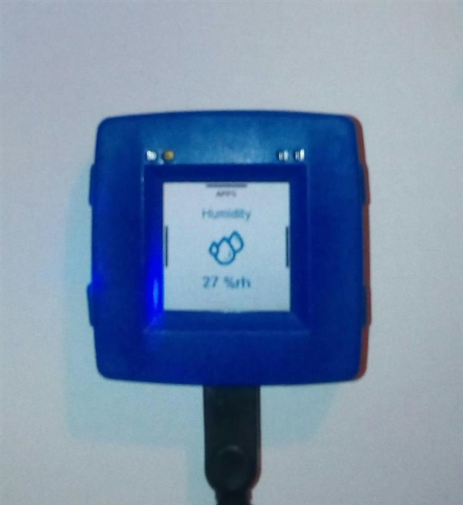

  1. Bench Testing: Power the FRDM-KW24D board via USB and verify serial output through a terminal emulator (such as PuTTY or TeraTerm at 115200 baud). Confirm that sensor simulation values update correctly.
  2. Mesh Pairing: Power up the NXP Rapid IoT kit and ensure it successfully establishes a Thread commissioning session with the KW24D nodes.
  3. Mobile Verification: Launch the NXP IoT Toolbox application on your smartphone, connect to the Rapid IoT device via BLE, and verify that incoming environmental telemetry appears in the BLE Terminal screen.

Bill of Materials (Hardware Components)
To successfully replicate or scale this project, gather the following hardware components:
    • Role: Acts as the central hybrid router, bridging the IEEE 802.15.4 Thread mesh network with Bluetooth Low Energy (BLE) for mobile connectivity.
  • FRDM-KW24D - ARM Freedom Development Board for Kinetis KW24D MCU
    • Role: Functions as the Thread mesh network client / sensor node. Powered by the Kinetis MKW24D512 wireless microcontroller with integrated 2.4 GHz transceiver.
    • Role: Provides modular plug-and-play sensors and actuators, including:
      • Grove Light Sensor (for solar radiation tracking)
      • Grove Temperature Sensor (thermistor-based climate monitoring)
      • Mini Servo (for micro-actuation, such as adjusting small vent flaps)
      • Grove Smart Relay (for switching low-power auxiliary loads)
  • Numato Relay Shield - 2 Channel
    • Role: Handles heavier electrical loads like irrigation water pumps, heating elements, and greenhouse exhaust fans.
