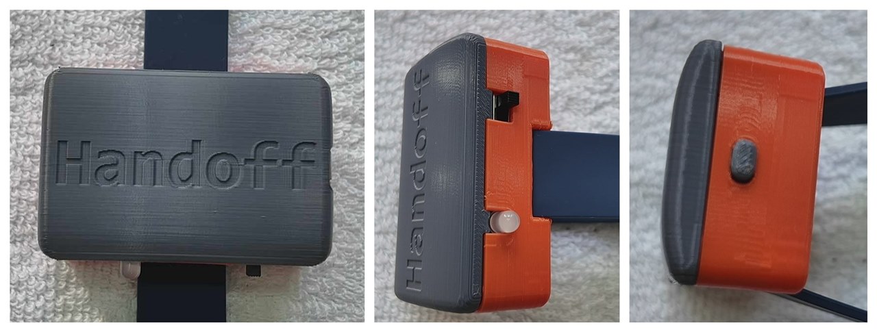

Figure 2.1. A finished band on its strap. The lid, then the side with the power switch and the light, then the end with the single button.
Figure 2.2. The same band in section. The skin plate at the bottom is the one that meets the wrist, and the whole of this post is about getting a signal from that plate, through a person, into the plate on someone else's band.

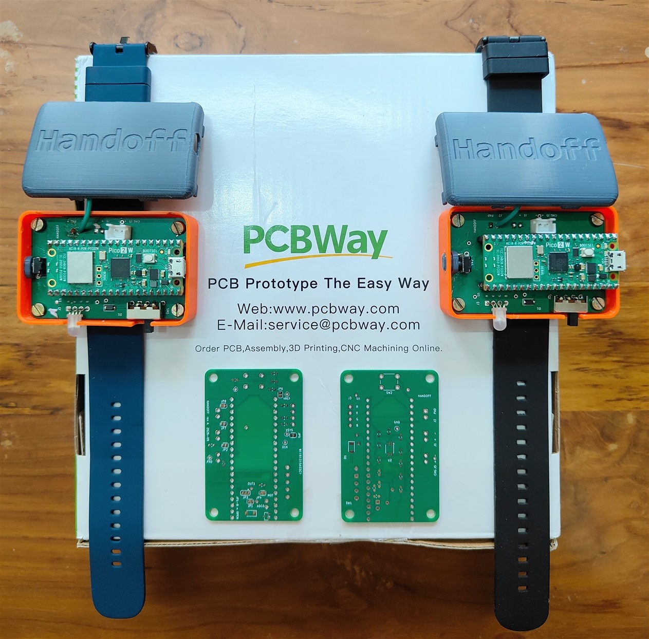

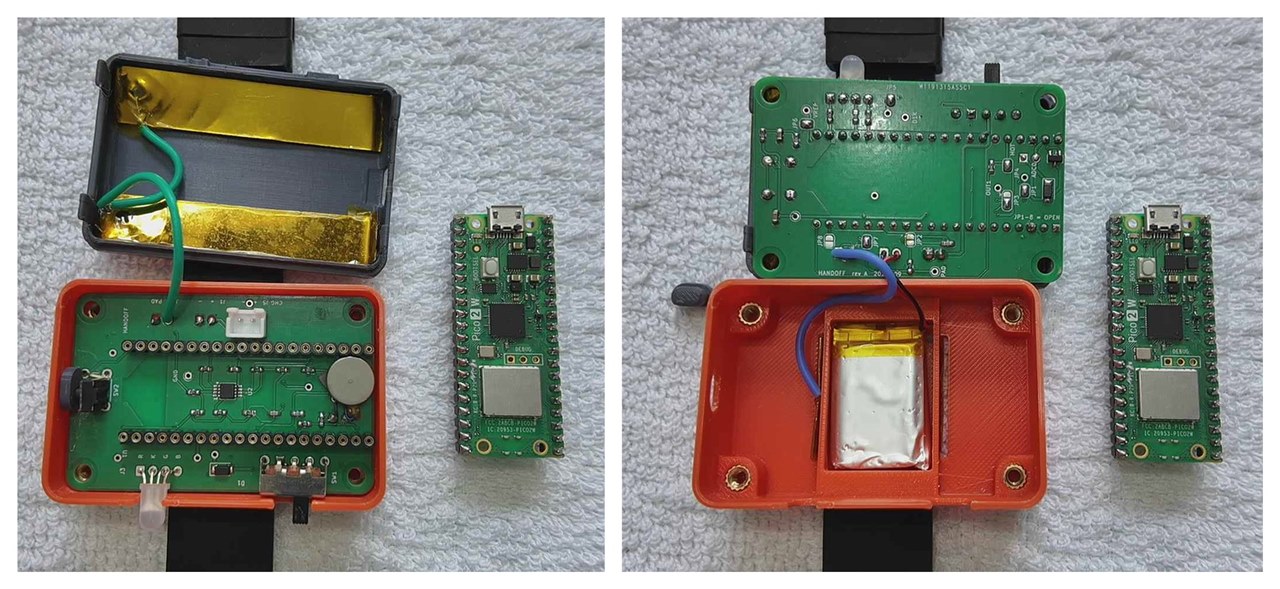

Figure 2.3. Opened up. Left: the Pico lifted out of its socket, leaving the band's own board with the amplifier, the motor, the switch, the button and the light on it. Right: the board out as well, turned over, and the cell in its pocket.

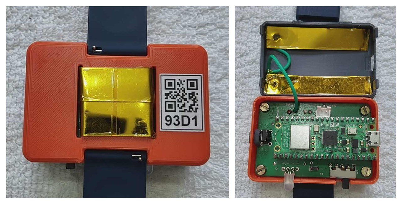

Figure 2.4. There are two plates, not one. Left: the skin plate, taped over and recessed into the back, with the band's label beside it. Right: the same band opened, and the second plate inside the lid. Section 6.4 is why the second one matters.

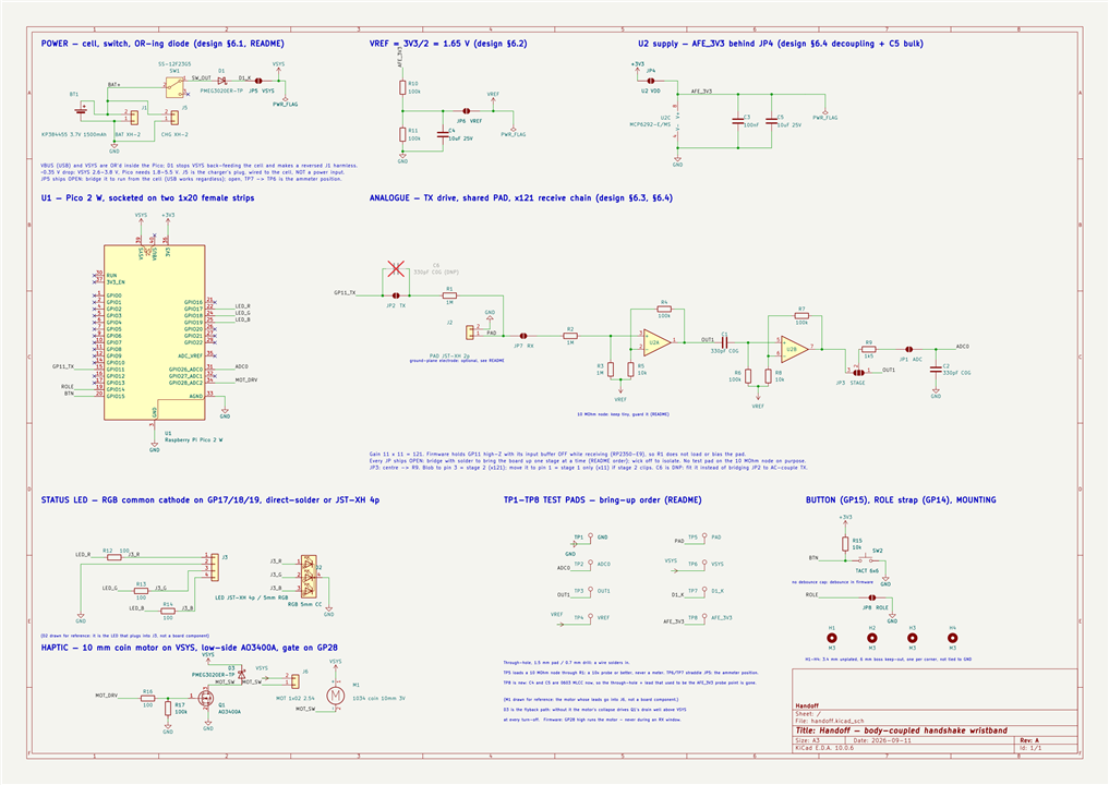

Figure 2.5. The whole circuit, on one sheet. A Pico 2 W does everything digital, top left. The block in the middle is the part this post is really about: one pin drives the skin plate, and the same plate feeds an amplifier that lifts what comes back off the other person. The rest is a cell and a switch, the light, the motor and the button.

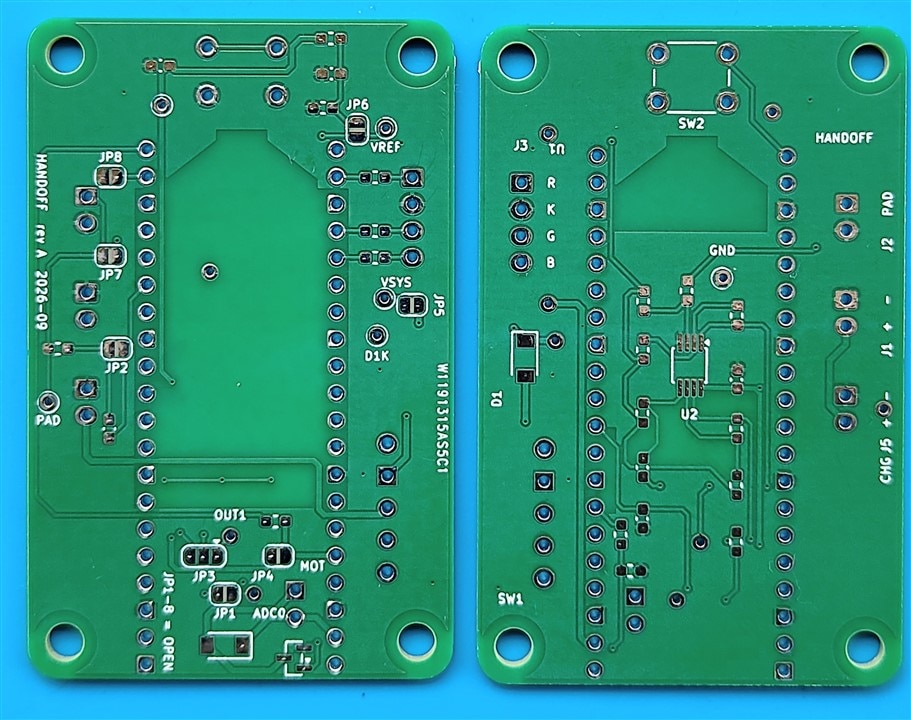

Figure 2.6. The board, 40 by 62 mm, two layers. Left: the top, where the Pico sits on two header strips, with the amplifier beside it and the plugs around the edge. Right: the same board seen from underneath, which carries the rest of the small parts and a row of solder jumpers. Every jumper ships open, so the board can be brought up one stage at a time.

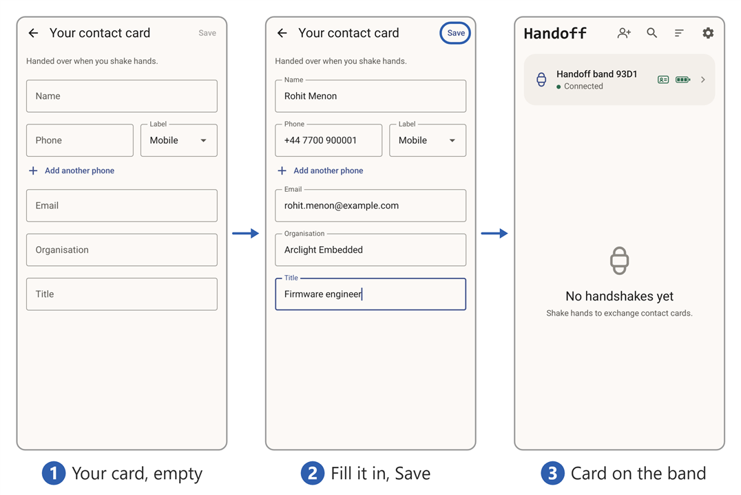

"Next you set up your contact card in it."
He tapped Set it up and looked at the form. Name. Phone. Email. Organisation. Title.
"Do I have to put all the details in here?"
"Only what you'd put on a card. That's all it is, really. It's your card. If you'd rather not give out your personal number, put the work one in. Leave anything blank you like."
He keyed in his details and tapped Save. In his hand the band blinked green, twice, quick.
"Green's good. That's your details saved on the band. Pop it on."
He put it on. Left wrist, out of habit, and glanced at her.
"Other wrist," she said. "It has to be on the hand you shake with."
He moved it across and looked at the phone. An empty page. No handshakes yet.

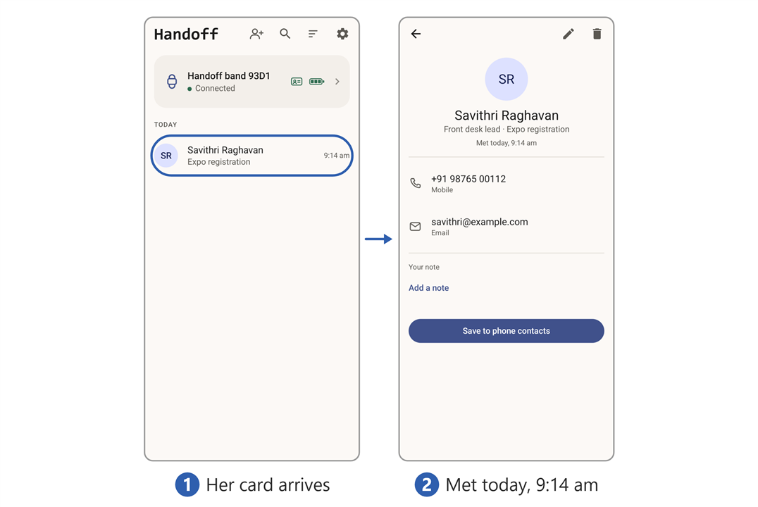

"So you're saying I just shake hands. How do I know it's actually worked?"
"Oh, you'll know." She came out from behind the desk and held out her hand with a broad smile. "I'm Savithri, by the way. Lovely to meet you, Rohit."
He took it.
It was an ordinary handshake: warm, firm, a second long. The band on his wrist flickered white. Before he had even let go it went green and gave a small buzz against his skin.
"Check your phone."
Her name was there. Savithri Raghavan. He tapped it. Met today, 9:14 am, and under it her number and her email.

"And you've got me?"
She turned her own phone around. A long list of names, and his at the top.
"Everyone I've said hello to this morning." She grinned. "Cool, right?"

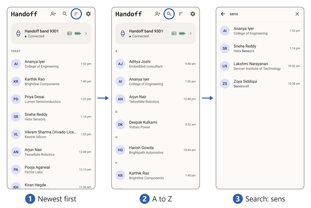

5.1 Home page
The UI was simple. A band info card at the top of the page, showing the band's name, Handoff band 93D1, with Connected under it. On the right, a small green card icon showing that his card was saved on it, and a battery with three green bars.
Below it, the people. Everyone he had met, newest at the top, with the organisation and the number under each name, and the time he met them on the right.
Four buttons along the top, beside the Handoff wordmark:
  • Create contact, for one typed in by hand.
  • Search, which looks through names, organisations and notes at once.
  • Sort, flipping the list between Newest first and A to Z.
  • Settings.
Figure 5.1. Home page.

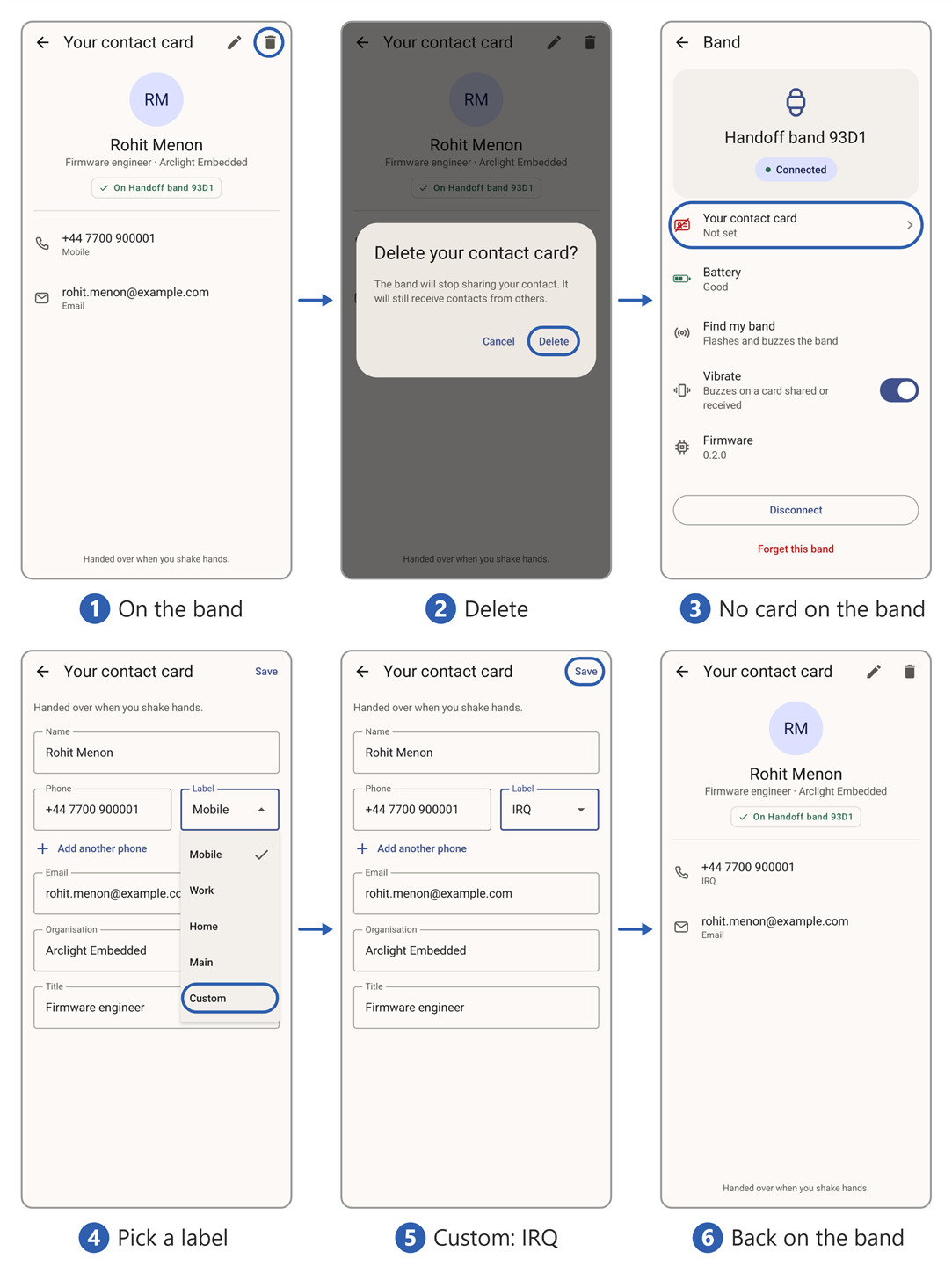

He tapped Your contact card. There it was, as he had typed it that morning, with a small tick under his name: On Handoff band 93D1. Two icons in the top bar, a pencil to edit and a bin to delete the card.
He pressed the bin.
Delete your contact card? the app asked. The band will stop sharing your contact. It will still receive contacts from others.
He tapped Delete. Back on the band info page the green card icon had gone red, with a line through it. No card saved on the band.
He set it up again. Name, phone, email, organisation, title, the same as the morning. This time, at the phone number, he tapped the label. Mobile, Work, Home, Main, and at the bottom, Custom.
He couldn't resist. He picked Custom and typed IRQ.
Now the people who shook his hand would get a number labelled IRQ. If they knew what an interrupt request was, they'd smile. If they didn't, they weren't his kind of people anyway.
Save. The band blinked green, twice, and the icon on the band info page went green again.

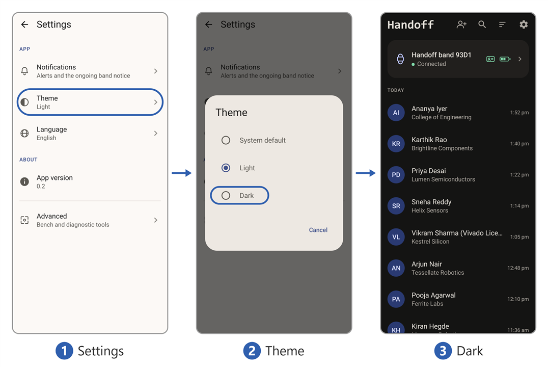

5.4 Settings page
Settings was two short groups.
Under App: Notifications, Theme and Language. Under About: the app version.
The app has no internet permission at all. Every contact he had collected lived on his phone and nowhere else.
He opened Theme and picked Dark. The lounge was dim and the white page was a lantern.
Figure 5.4. Settings page.
He sat back. The whole app had taken five minutes to walk through, and there had been nothing in it he needed to look up.

A flat metal plate on the back of the case, which gets pressed to the skin. Of course. Two people, two plates, and the handshake closing the circuit between them: a signal sent through his body and picked up on the other side. A galvanic contact, skin to metal.
He tilted it to the light. The plate had a thin clear coating over it. Sealed, edge to edge. No path for a current, which ruled out his first theory.
So the plate wasn't a contact. It was one half of a capacitor. The skin was the other half, and the coating was the dielectric. The metal never touched him, and it did not have to. The band was coupling into his skin through the coating, and the handshake was coupling him into the person whose hand he held.
Capacitive body-coupled communication.
He put the band back on, and finished the coffee. He knew what it was now. The next question was how.

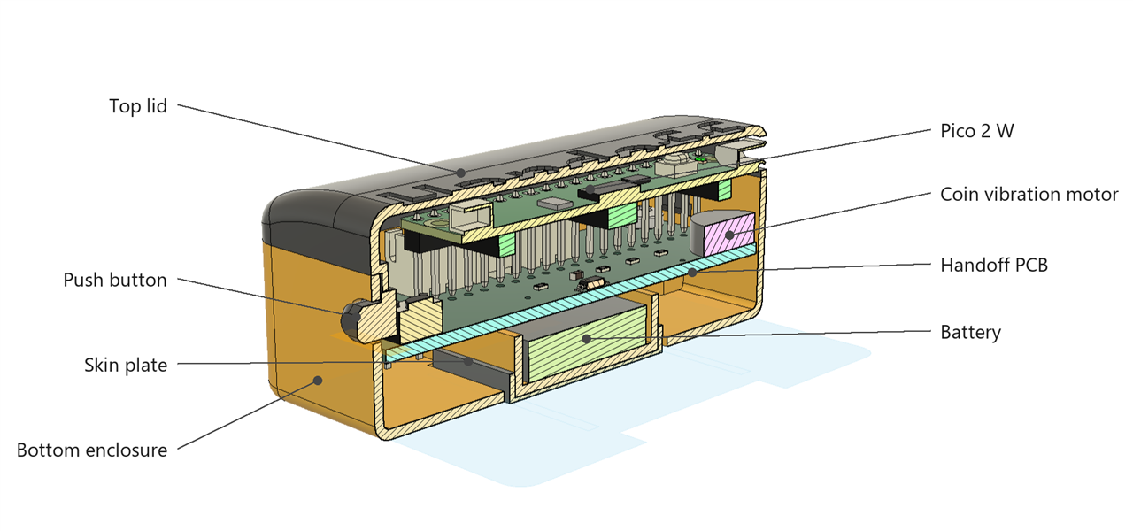

6.2 What's inside
He had met most of it already, from the outside (Figure 6.1).
Figure 6.1. One band, around its Pico. Purple feeds the Pico, orange is driven by it, and the plate is both. Grey is not part of the band. The second, outer electrode is left out of the drawing; it is in Figure 6.3.
  • One plate, both directions. The tones go out through it, and the other band's tones come in through it.
  • A second plate on the outer face, wired to the board's ground. Nobody holds a return wire, so this one couples to the room instead (6.4).
  • Two amplifiers between the plate and the Pico, because what arrives is tiny (6.4).
  • The rest is for the wearer: the button Savithri held for five seconds, the light that blinked, the buzz on his wrist. Figure 4.4 has every one of them.
Why a Pico 2 W?
  • The tones come straight from a pin. PIO, the Pico's small programmable I/O engines, switches a pin between 180 kHz and 200 kHz on its own, to the cycle. No oscillator, no driver chip, and the processor is free.
  • The converter reads them directly. It samples 500,000 times a second, fast enough for 200 kHz, so there is no mixer to bring anything down first.
  • Two cores. One weighs five pitches in what arrives, twenty thousand times a second, all the time. The other runs the handshake and Bluetooth.
  • Bluetooth on board. The phone link needs no second chip.
  • A buck-boost converter on board. A Li-ion cell starts above 3.3 V and ends below it. The Pico takes anything from 1.8 to 5.5 V and makes its own 3.3 V, so the battery needs no regulator.
  • It runs at 144 MHz, not the 150 it boots at. Both tones have to come out as a whole, even number of clock cycles (800 and 720), and 144 MHz is the nearest clock that does it for both (6.5).
  • Small. 21 × 51 mm, and it plugs into a socket on the band's board.
Appendix A has the parts, appendix B every step to build it.

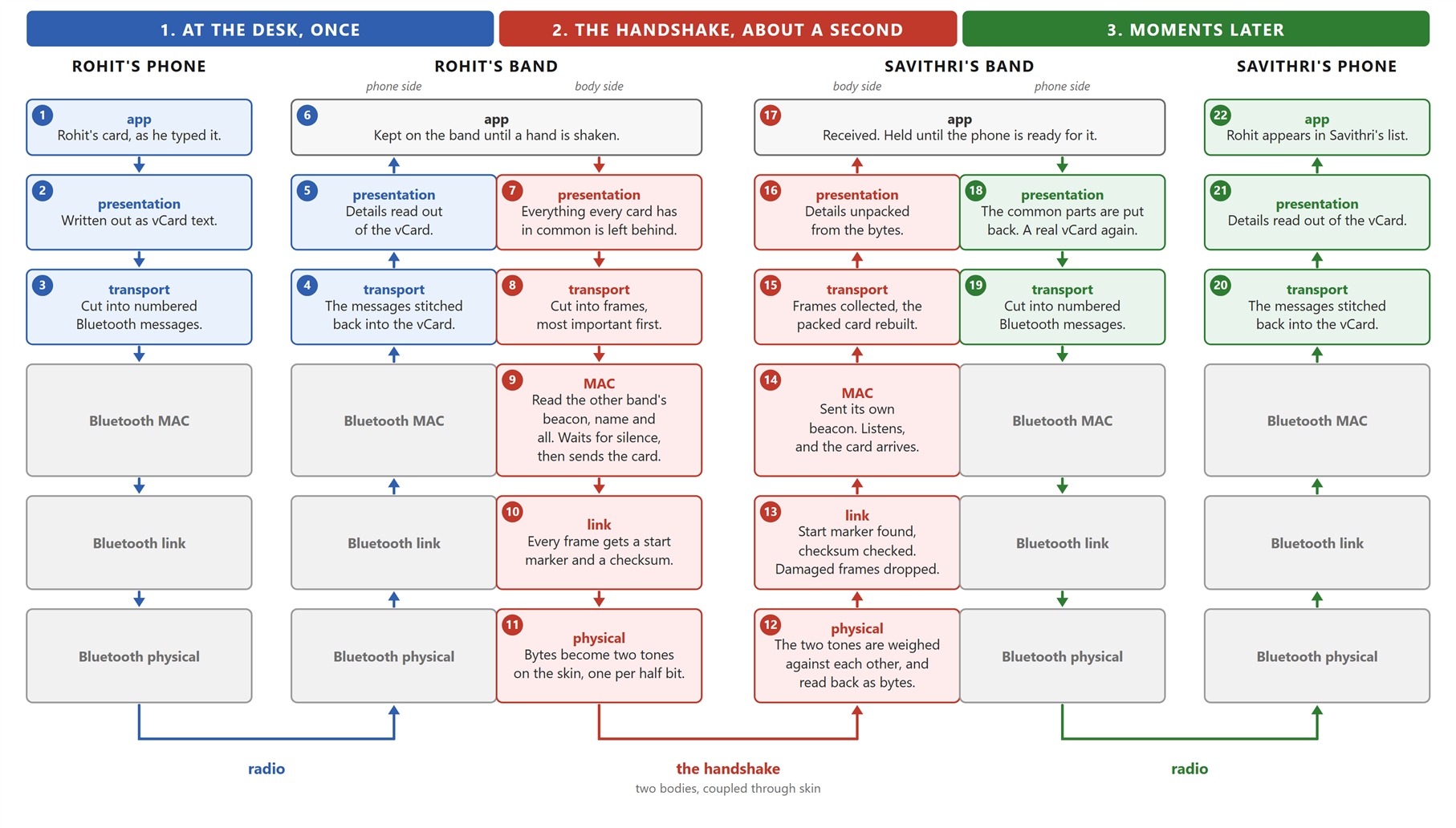

6.3 One card's journey
Figure 6.2. Rohit's card on its way to Savithri. Hers makes the same trip the other way, at the same time. Click to enlarge.
  • Follow the numbers in Figure 6.2, 1 to 22.
  • Blue, at the desk: Rohit's phone gives his card to his band.
  • Red, the handshake: his band sends it through the two of them, into hers.
  • Green, a moment later: her band passes it to her phone.
  • The small word in each box is the layer's name. The sentence under it is what happens.
  • Grey is Bluetooth. It works, so it is left alone.
  • Red had to be designed from nothing. Two boxes to come back to:
    • Box 7 throws away what every card has in common, and box 18 puts it back. Why?
    • Box 9 read a nonce that was not its own. Whose, and why does that settle who speaks?
Everything in red comes from three facts:
  1. The wire is a person.
  2. A handshake is about a second long.
  3. Nobody announces it.

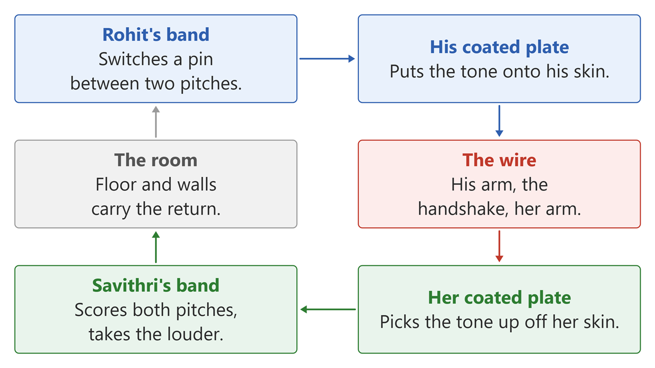

6.4 The wire is a person
The wire is somebody, so it must be safe. And it is a terrible wire, so little gets through (Figure 6.3).
Figure 6.3. The loop a handshake makes. The only thing that touches is the two hands.
  • Rohit's band puts the tone out. A pin on the Pico switches between two pitches, 180 and 200 kHz, and one of them is on the plate at all times. No radio, no aerial.
  • His plate puts the tone onto his skin. Without touching it: the plate is coated, so it is half a capacitor, and the tone crosses the last gap as an electric field.
  • The wire is his arm, the handshake, her arm. A person is a poor wire, so only a whisper of the tone comes out the other end.
  • Her plate picks it up off her skin. What arrives is tiny, so two amplifiers of ×11 make it big enough to read.
  • Her band hears it. Every 50 µs it scores both pitches and asks only which was louder. Three more bins, at 140, 160 and 220 kHz, carry nothing and measure the room alongside them.
  • The room closes the loop. Nobody holds a return wire, so each band's outer electrode couples to the floor and the walls.

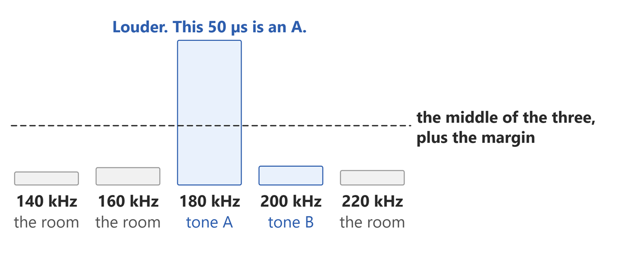

Figure 6.4. What the band weighs: the two tones every 50 µs, the three room pitches every fourth. One tone is on the plate at a time, and here it is A.
  • Two tones, not one. 180 kHz and 200 kHz. Every 50 µs the band scores both and asks which is louder. That answer is one step of the message. A dry hand or a loose grip makes both quieter together, so the comparison still comes out right.
  • Three pitches nobody ever sends. 140, 160 and 220 kHz, scored through the same amplifier and the same body as the tones. They are not a message. They are a live reading of how noisy the room is.
  • The middle of the three, not their average. One stray signal landing on one of them cannot move the middle of three. Standard radar practice, not an invention.
  • Is anybody there? becomes one comparison. Is the tone louder than that middle reading, by a set margin? The reading is an average, kept fresh over the length of one preamble, and averaging is safe here because nothing the band sends can land on those three pitches. The first radio averaged the tone's own pitch instead, and a long tone pulled the average up to meet it until the receiver went deaf. Appendix C.
  • The margin is computed, not tuned. It comes from a sentence, I will accept one moment a minute where the band thinks someone is there and nobody is, and the arithmetic follows. Nobody turned a knob until the bench looked happy.
  • Two tones are never off. With one tone, half the message is silence and carries nothing. With two, every step is a tone at the same peak voltage, so each bit arrives with about twice the energy, and nothing in the amplifier changed.

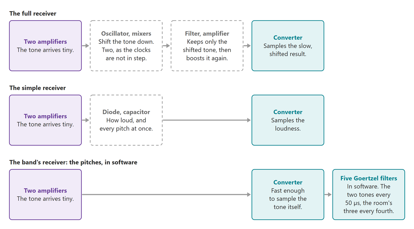

Figure 6.5. What the Goertzel filter replaces. Dashed: the parts the band does not have.
There are two usual ways to hear a tone (Figure 6.5).
  • The full receiver shifts it down with an oscillator and a mixer, then filters and amplifies it again.
  • It needs two mixers, I and Q. The two bands run on separate clocks, so a tone arrives at any phase, and one mixer's output fades with the phase.
  • The simple receiver is a diode and a capacitor, an envelope detector. Or a tone-decoder chip such as the LM567.
  • The band does all of it in software. The converter samples the tones themselves, 500,000 times a second. A Goertzel filter turns every 25 samples into one number: how much of that pitch is there, at any phase. The band runs five of them: the two tones every window, and the three room pitches every fourth window.
Better than the full receiver:
  • Five parts gone: the oscillator, two mixers, the filter and the second amplifier.
  • No mixer offset drifting under the reading.
  • Five channels for the price of the parts of none. Adding the three noise pitches added no hardware at all.
Better than the simple receiver:
  • A diode hears every pitch at once. Mains hum, phone chargers and lights all count as signal.
  • The LM567 only says yes or no. The band needs numbers, to tell which of two tones is louder.
  • The pitch never drifts. The LM567's is set by a resistor and a capacitor. Goertzel's is set by the crystal clock.
Why Goertzel and not an FFT. Both measure frequencies. An FFT measures all of them, and the band needs five.
  • Five answers, not thirteen. An FFT of 25 samples returns 13.
  • Sample by sample. Goertzel updates two running numbers as each sample lands. There is no block to store, and the answer is ready with the 25th sample.
  • Any length. A standard FFT wants 16 or 32 samples. At 32, these tones would fall between two answers and smear across both. 25 samples hold exactly nine and ten cycles of them, so each sits dead on one.
  • Cheap. All five, plus the decision, cost about a fifth of one core, measured in the real firmware, with Bluetooth running on the other core.

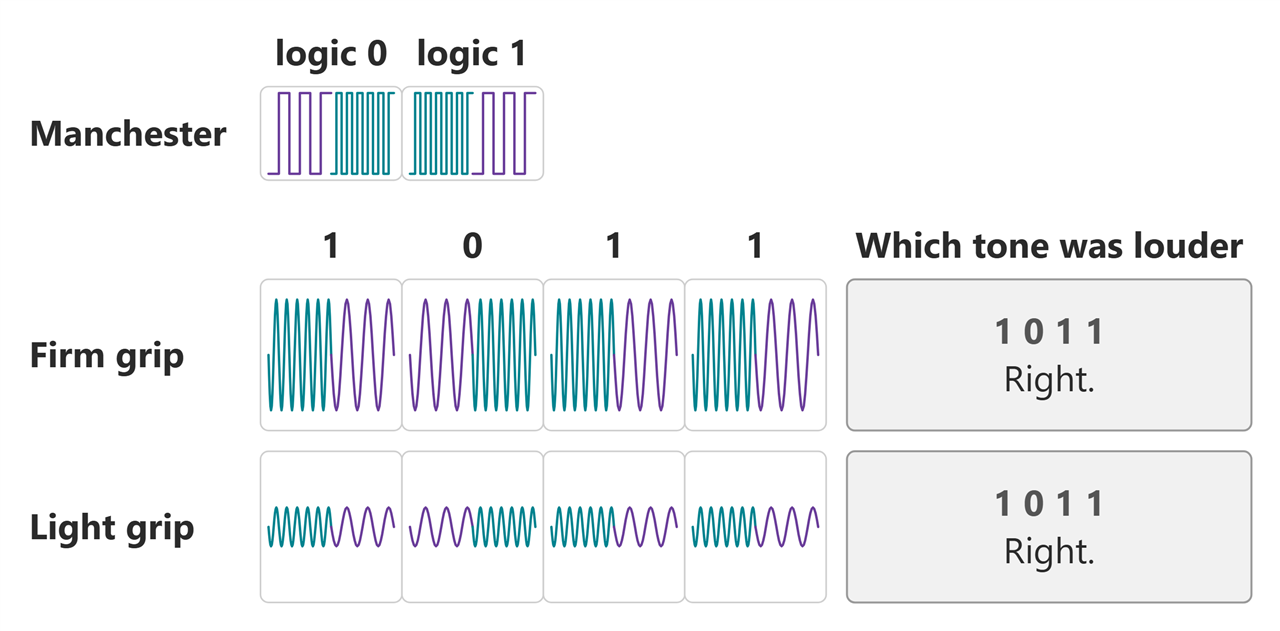

6.6.2 Reading each bit

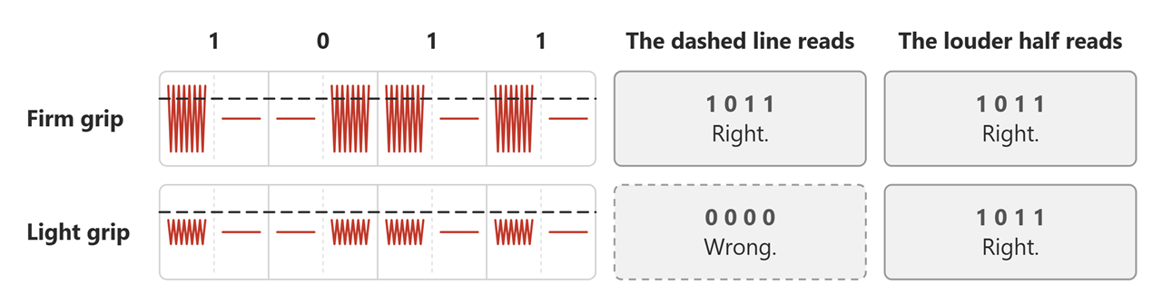

Figure 6.6. The same four bits, through a firm grip and a light one. The key is the square wave the pin sends; the rows under it are what survives two bodies and the band's filters. The gap between the two pitches is drawn far wider than it is: they are really 180 and 200 kHz, a tenth apart.
  • Each bit is two chips. 180 kHz then 200 kHz is a 0; 200 kHz then 180 kHz is a 1. This is Manchester coding (Figure 6.6).
  • How much arrives changes with grip and posture. It does not matter: the receiver never asks how loud, only which of the two was louder.
  • Every bit changes in the middle, so the receiver never loses count.
  • The imbalance cancels. Every bit carries one chip of each tone, so if one tone always arrives a tenth stronger, both halves of every bit carry that tenth. The band measures the imbalance anyway, on every frame, and reports it, but nothing corrects for it, because nothing needs to.
  • The cost is half the speed: 2,000 bits a second.

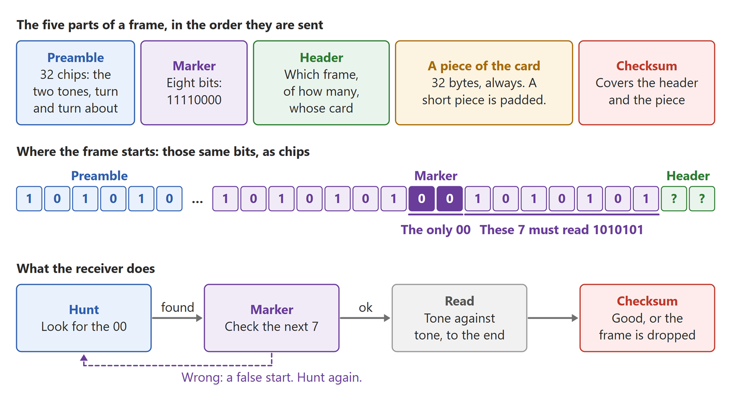

6.6.3 Finding where a frame starts
A card does not fit in one go, so it goes in frames. Figure 6.7 is one frame; section 6.7 is how the card is cut up.
Figure 6.7. One frame, 156 ms. Each part keeps its colour in all three rows.
  • The start is a landmark, not a count. Some of the preamble is lost while the receiver wakes up, so it never counts chips. It looks for the one 00, then checks the seven chips after it.
  • Why the marker reads differently in the two rows. 11110000 is the marker's eight bits. On the plate every bit is two chips, so those eight go out as sixteen, and the one place the alternation breaks is where the four 1s turn into the four 0s. That break is the 00, and the seven chips after it are what the receiver checks.
  • How strict that check is, is also computed. From another sentence, one false start per 24 hours of listening, the receiver works out how clean the run in front of it has to be: 28 transitions out of 30.
  • No length field. A length can itself arrive damaged. Every frame is the same size, and the header says how many frames make the card.

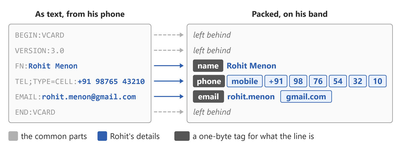

  • A vCard is nearly half common parts: BEGIN:VCARD, TEL;TYPE=CELL, END:VCARD (Figure 6.8).
  • The link is slow. Sent as text, Rohit's card alone takes the whole second. Savithri's never gets a turn.
Figure 6.8. A card like Rohit's, as text and packed.
  • Packed (Figure 6.2, box 7): labels become one-byte tags, digits go two to a byte, common email domains become one byte. 169 bytes becomes 79, and both cards fit.
  • Packed once, at the desk. The band stores only the packed card, so a handshake has nothing left to do but send.
  • Savithri's band rebuilds it (Figure 6.2, box 18) into a proper vCard before her phone sees it.

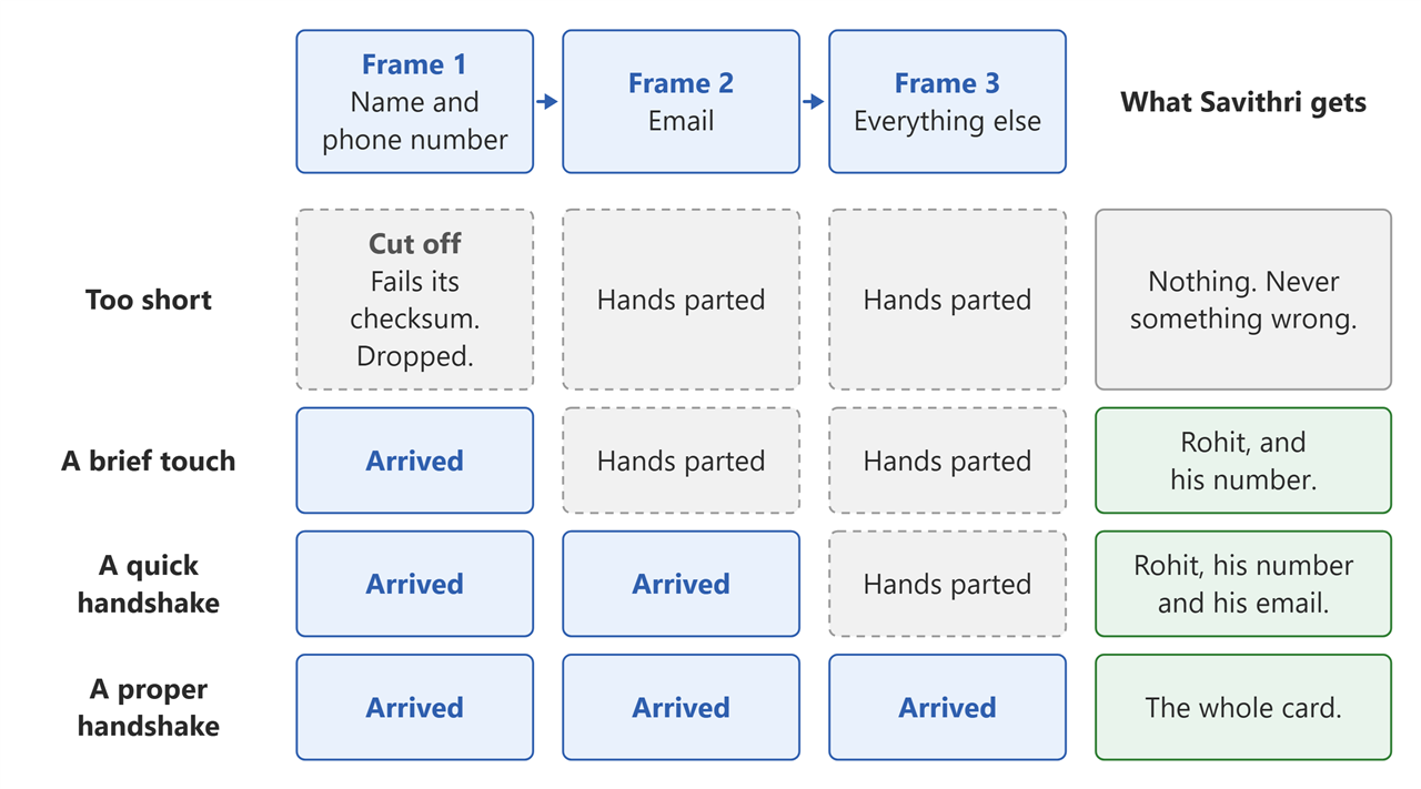

Figure 6.9. Sent most important first. Nothing is ever asked for twice.
  • Most important first: name and number, then email, then the rest (Figure 6.9).
  • Never half a field. Every frame reads on its own, so a number never arrives with the wrong label.
  • No asking again. There is no time. A damaged frame fails its checksum and is dropped.
  • Whatever arrived goes to the phone. If the hands part after frame 1, Savithri still gets his name and number. Without frame 1 she gets nothing.

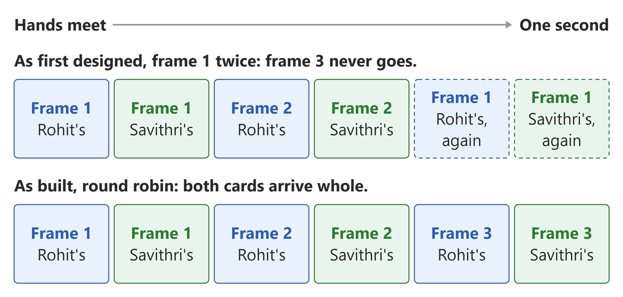

And one thing that looked right and was not. The plan was to send frame 1 every other time (1, 2, 1, 3, 1, 2), spending half the airtime on the part that matters most.
Figure 6.10. What the channel carries in a one-second handshake. The two bands take turns, three frames each.
  • A frame takes 156 ms. About six fit in a one-second handshake, shared between the two bands (Figure 6.10).
  • Every repeat of frame 1 is a frame the other band already has. The frame it still needs never goes.
  • Simulated over one-second handshakes: frame 1 every other time gives a complete card 0 % of the time. Each frame once, in turn: both cards complete every time.
  • Fix: plain round robin. 1, 2, 3, then round again. A brief touch still gets a name and a number, because round robin sends frame 1 first anyway. The order was what kept that promise; the repeating never did.

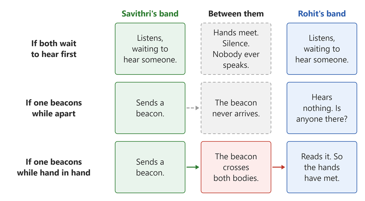

6.8 Nothing says go
Nothing tells the band a hand has closed. Three parts: why waiting cannot work, what the band does instead, and who speaks once the hands meet.
6.8.1 Waiting does not work
Figure 6.11. Being heard is the touch.
  • No button, no accelerometer, no touch sensor.
  • Quiet means nothing. There is no channel until the hands meet, so an empty room and a hand in a hand sound exactly the same (Figure 6.11).
  • If every band waits to hear someone, no band ever speaks.
  • Being heard is the touch. Hearing another band is itself the proof, because there was no path until the hands met.
6.8.2 So every band keeps beaconing
Figure 6.12. One band's cycle, drawn to scale in time, and what happens when a hand closes on another wrist.
  • Every band runs the same loop, all day: beacon, then listen, then beacon again (Figure 6.12).
  • The beacon is a short frame carrying a nonce, a number drawn at random and used once, under a checksum.
  • It never beacons over someone else. The listening clock only runs while the channel is quiet, so a band that can hear anything at all remains silent.
  • Is that a peer? The checksum passed, and noise almost never passes a checksum.
  • Is that me? A band shuts its ears while it beacons, but an echo of its own beacon can still reach it a moment later. The nonce is what tells the two apart.
  • The listening period is drawn fresh every cycle. On a fixed rhythm, two bands whose beacons clash would clash for ever.
  • How long it listens on average was worked out, not chosen: listen too little and the beacons clash more often, listen too long and the hands part before the two bands have met. It works out at about three beacons' worth.
  • Two bands that drew the same nonce both read it as their own, both stand down, and both draw again. It costs one cycle.

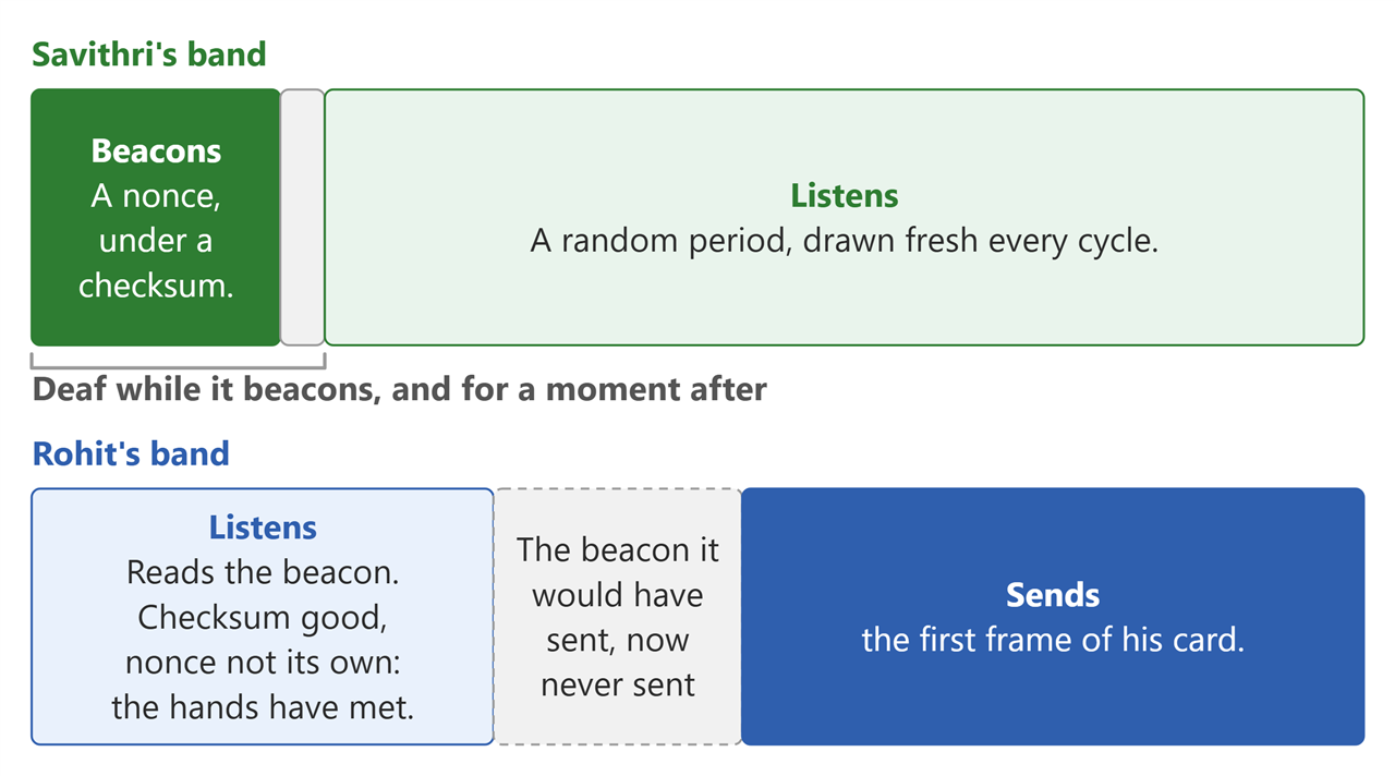

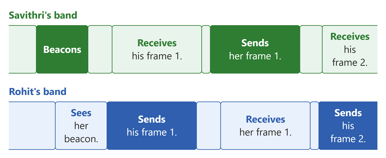

6.8.3 The one that heard, sends
Figure 6.13. Figure 6.12 zoomed out: the one that heard sends first, then one frame each, in turn.
  • A band is deaf while it beacons, and for a moment after. So a band that managed to read a beacon had not started one of its own (Figure 6.13).
  • At most one band can ever read the other. There is nothing to elect, and no tie to break.
  • The reader goes first (box 9 of Figure 6.2). It is the only one that knows a handshake has started.
  • The beaconer receives. As far as it knows it spoke into an empty room, and its ears are already open when the frame arrives.
  • One frame each, then swap. Not a whole card each. They alternate frame by frame, so a touch that ends early still leaves both ends with a name and a number.
  • One pad, one direction at a time. Each band waits out the other end's recovery before it starts, so the far end is certainly listening.

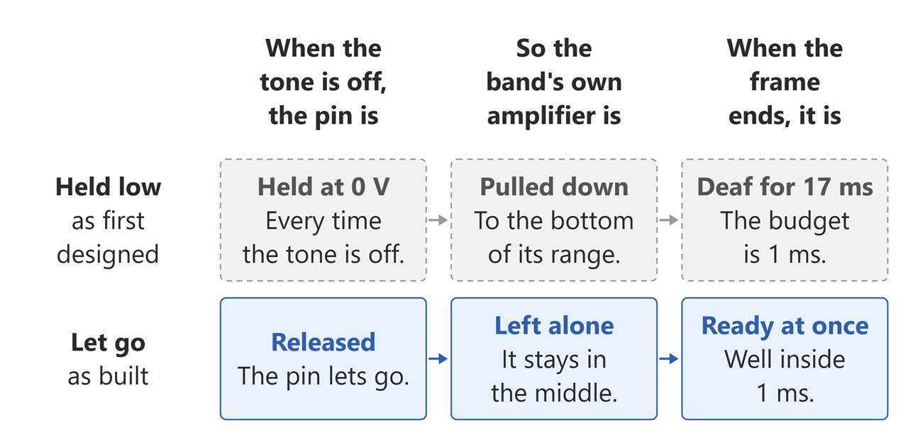

  • The first one switched a single tone on and off, and taught me that off is never really off. Appendix C is that story.
  • The second sends two tones and asks only which is louder. Worn, it is about twice as good as the first.

7.3 The board

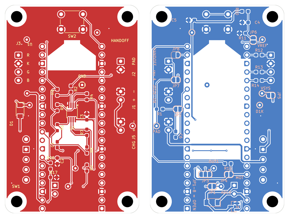

  • It was designed in two days, because that is all the time there was. The board works. The next one needs more thought and more research behind every choice on it.
  • The button wants to be a right angle part. The one fitted points straight up and the case needs it out of the side, so it was bent over and glued to the board. A right angle switch in the footprint settles it.
  • A surface mount RGB behind a diffuser is the cleaner answer. The 5 mm through hole LED eats space inside the box, and a small part under a printed diffuser looks tidier from the outside.
  • The motor was meant to sit on the wall of the case, so that the whole box buzzes against the wrist. The cheap coin motor's wires were short and stiff, and could not be used to hold it there, so it went onto double sided tape on the PCB instead. A surface mount motor soldered to the board answers the wires and the mounting together.
  • One port should program and charge. Today the Pico's port programs, and the cell is charged on a separate TP4056 module, plugged into the board through a 2 pin JST-XH port and left outside the case. The charger belongs on the board.

9 The boards, from PCBWay
This is my first sponsored project. PCBWay manufactured the PCBs and shipped them to me. I only had to source the components.
Figure 9.1. A bare board as it arrived, both sides.
It started with their email. PCBWay wrote on 10 September offering to sponsor a project. The board didn't exist yet, and the Make a Connection contest deadline was 16 days away. I designed the board in two days and placed the order on Saturday.
Their engineers were super helpful and prompt.
  • The finish. I had picked leaded HASL on the order form but asked for lead-free in the notes. Tori caught the mismatch that same Saturday and asked which one I meant.
  • The antenna. Under the Pico's antenna there is a patch with no copper on either side. That's deliberate. To a fab it looks like a slot someone forgot to draw. Sophia asked me instead of guessing. Then she sent back the exact files they had received so I could check them against mine. It was settled the same morning.
Speed. The order went in on Saturday 12 September. Every question was closed by the next working day, Monday the 14th. Shipped by DHL on the 15th, and at my door on the 23rd. It would have been earlier: a glitch in the DHL portal would not let me upload my KYC, so customs clearance sat waiting. The 24 hour lead time and the fast shipping are what got this project finished inside the contest deadline.
Quality. I gave these pads a hard time. Surface mount and through hole, soldered and desoldered again and again, a vacuum pump and solder wick over the same joints many times. Not one pad lifted. On the breakout boards I usually buy, a pad comes away after two or three rework sessions. These took everything I did to them and still look like new.
Figure 9.2. The pair, finished, on the box they came in.
Serene, in their marketing team, made the whole thing easy, from the first email to the order going through.
Thank you to PCBWay, and to Serene, Tori and Sophia, for backing my project.
If you want to build a pair yourself, appendix B has the board files ready to upload to PCBWay.

Handoff PCB Upload hardware/build/handoff-pcbway.zip to PCBWay. 40 × 62 mm, 2 layers, 1.6 mm, 1 oz copper. HASL is fine; ENIG is the one upgrade worth paying for, for flat pads under the amplifier's 0.65 mm pins. hardware/build/order.md answers every other question the order form asks, and lists what to check on their preview before you pay. The smallest run is five, which is the right number anyway: two bands and three spares.
On the board
Ref Part Package Qty Code
U1 Raspberry Pi Pico 2 W socketed, not soldered 1 R190344
- 2.54 mm 1×40 female header cut into two 1×20 for the Pico 1 strip 555698
U2 MCP6292-E/MS dual op-amp, 10 MHz MSOP-8 1 R193529
R1, R2 100 kΩ, the two electrode resistors 0603 2 1481824519-20P
R3 1 MΩ, bias for the high-impedance node 0603 1 R134792
R4, R6, R7, R10, R11, R17 100 kΩ 0603 6 1481824519-20P
R5, R8, R15 10 kΩ 0603 3 1481824531-20P
R9 1.5 kΩ 0603 1 R134878
R12, R13, R14, R16 100 Ω 0603 4 1860310035-20P
C1, C2 330 pF C0G/NP0 0603 2 R136892
C3 100 nF X7R 0603 1 R172322
C4, C5 10 µF X5R, 25 V 0603 2 R144171
C6 330 pF C0G. Not fitted, a spare footprint 0603 0 R136892
D1, D3 PMEG3020ER-TP (Tech Public, not Nexperia) SOD-123FL 2 R241663
Q1 AO3400A N-channel MOSFET SOT-23 1 R209179
SW1 SS-12F23G5 slide switch, SPDT, right-angle through-hole 1 R132611
SW2 Tactile push button, 6 × 6 × 5 mm through-hole 1 618182
J1, J2, J5 JST-XH 2.50 mm 2-pin male through-hole 3 -
J3 JST-XH 2.50 mm 4-pin male, or solder the LED straight in through-hole 1 -
J6 2-pin 2.54 mm header, or solder the motor leads in through-hole 1 -
Two values differ from the silkscreen, and this is the one place it matters. The board and the repository BOM were laid out with R1, R2 and R3 all at 1 MΩ, which is what the design document asks for. What is fitted, and what every measurement in this post was taken with, is R1 = R2 = 100 kΩ and R3 = 1 MΩ. See B.1 for what that means for the person wearing it, and 5.4 for why 10 kΩ is not better still.

Follow docs/hardware-bringup.md, one step at a time. It has a drawing of each face.
  • Solder in three passes: small parts on the top face, small parts on the bottom face, then the through-hole parts.
  • Check after every pass with the meter. Each step lists what to measure and what it should read.
  • Fit 100 kΩ at R1 and R2, not the 1 MΩ the silkscreen and the repository BOM name. R3 is 1 MΩ. Appendix A and B.1 are why.
  • The eight solder jumpers, JP1 to JP8, all start open. Close each one only when its step says so. That way each block is proved before the next is joined to it.
  • Clean with isopropyl alcohol after every pass, and let it dry. Flux left near the amplifier upsets it.
  • One script runs every powered check: scripts/bringup.py. It flashes a test program, then switches the LED, the motor and the transmitter from the PC.

B.6 Plates, box and strap
Step P of the bring-up guide. This is the part that decides whether the band works on a wrist rather than on a bench.
There are two electrodes, not one. The skin plate is the signal. The outer one is the return path, and it is the difference between a link that dies after a few seconds and one that runs all day (6.4).
  • Solder the free end of the plate wire to the copper side of one 25 × 25 mm square. The other end is already in the board's PAD hole: it went in during bring-up, as the bench electrode, and the plate is what it grows into.
  • Cover that copper completely with one layer of clear packing tape, round the edges. Thinner tape couples better. This is the insulation the safety rules turn on.
  • Tape it to the outside of the bottom half, taped face out, so it lies against the wrist.
  • The second square is the outer electrode. One wire, exactly one and never two, from its copper to J2 pin 2, which is board ground. It mounts inside the top of the box, facing the room, with the board and the cell between it and the skin plate. The two must never end up back to back: at close spacing they short to each other instead of the outer one coupling to the room.
  • Press the four brass inserts into the bottom half's posts with the soldering iron, then screw the board down.
  • Cell into the battery socket. Check the plug first: the square pad is minus. Charge it on the TP4056 before the first run.
  • Charger: TP4056 OUT+ and OUT- to the charge socket. It is wired before the switch, so the cell charges with the band switched off, and the module stays outside the box.
  • Fit the top half and the 22 mm strap, and slide the switch to the position you marked during bring-up. The label comes later, in B.7: the band has to be running the real firmware before it will tell you what to put on it.
The box is an initial design, and it is honest to say so. Dry-fit it: hold the board in place and check every opening against your own parts (the USB socket, the switch handle, the button, the LED, and the way the two electrode wires and the charger lead get out) before any screw goes in. A hole is easier to open with a knife than to close.

At boot the LED flashes white and the motor taps once. Then the band tells you its name, and that is where the label comes from: four hex digits, printed as a QR code or simply typed into the app.
  • With the band on USB, run python scripts/bringup.py watch and power-cycle it. The banner prints a line like name "Handoff band 7A3C", label 7A3C.
  • For a sticker: pip install "qrcode[pil]", then python tools/band_label.py 7A3C. That writes band-7A3C.png, the QR code with the four characters under it. Print it about 20 mm square; smaller and a phone stops reading it at arm's length.
  • Or write the four digits on the band with a marker. The app takes them typed.
  • Two bands, two codes. Label both before they get mixed up.

  • A single 200 kHz square wave on the pad. Gated on for a mark, off for a space. On-off keying.
  • One Goertzel filter, on that one pitch. Everything in 5.6 about Goertzel against a mixer, a diode or an FFT was true then too, and survives unchanged, with one filter instead of five.
  • Manchester, the same as now, but each bit was tone-then-silence or silence-then-tone.
Figure C.1. The same four bits, through a firm grip and a light one, under the first radio.
  • Comparing the two halves was already right. A fixed threshold reads the firm grip and misses the light one; the louder half is the same answer for any grip (Figure C.1). That idea carried straight over; only what is in the two halves changed.
  • What did not carry over is everything else. Presence, rendezvous, and the preamble hunt all had to judge a single stream of loudness against a remembered level, because with one tone there is nothing else to compare it to (C.3).
C.2 Off is not low
This one was caught by working through the circuit, before the amplifier was built, and it is the mistake most worth passing on.
  • The tone is switched on and off. At first, off meant holding the pin at 0 V.
  • Zero is zero. It looked harmless.
  • But a band has one pad, for sending and for listening, and the pad is wired to the band's own amplifier.
  • Holding it low pulled that amplifier to the bottom of its range. Every frame did it, over and over.
  • When the frame ended, the amplifier took 17 ms to recover. The budget for turning round is 1 ms.
  • So every frame a band sent left it deaf, just when the other band's frame was due (Figure C.2).
Figure C.2. What a band does to itself when the tone is off.
  • Fix: off means let go. The pin is released, not held. The pad rests in the middle, and the amplifier never notices a frame going out.
  • One capacitor between the two amplifier stages made smaller, as a backstop. Any jolt that still gets through is gone in a fraction of a millisecond.
  • The other band gains too. A held-low off put a step on the pad thirty times bigger than the tone, and the body carried it across. A released pad sends nothing.
  • And the whole problem is gone now, which is the part worth noticing. Two tones are never off, so there is no step to recover from and nothing to release. What replaced 17 ms of amplifier recovery is 5 ms of the converter's own pipeline draining: measured, not estimated, and it does not grow with the length of what was sent.

C.4 The rendezvous, before it had a nonce in it
  • A band announced itself with a flat 10 ms tone, then recovered, then listened for a random time, then went round again.
  • Is that a peer? It outlasted 9 ms. Is that me? My ears were shut, probably. Who sends? Whoever heard first.
  • Four bugs came out of that in one afternoon: a band hearing its own shout; any carrier at all read as a peer; a preamble sent into a peer that was still deaf; and a receive turn walking away mid-frame as the floor climbed underneath it.
  • The idea underneath it was right and is unchanged. Being heard is the touch; the hearer sends; the shouter receives. Figures 5.11 to 5.13 are still that argument. What changed is that the shout became a frame with a nonce in it, so all three questions became arithmetic instead of timing.
