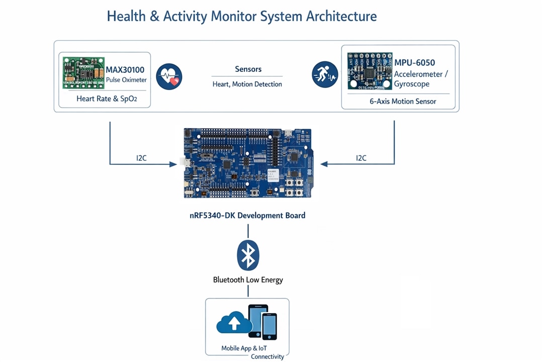

System Architecture
The wearable assistant consists of four major subsystems:
  • Processing subsystem,
  • Biomedical sensing subsystem,
  • Motion analysis subsystem,
  • Wireless communication subsystem.
The complete architecture is centered around the nRF5340-DK development kit.

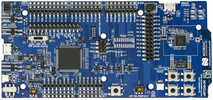

1. nRF5340-DK Development Kit
The core processing unit of the project is the Nordic Semiconductor nRF5340-DK.
The board contains:
  • Dual-core ARM Cortex-M33,
  • Bluetooth Low Energy 5.4,
  • Thread and Zigbee support,
  • Hardware cryptographic acceleration,
  • Integrated debugging interface.
  • Low power consumption,
  • Zephyr RTOS support,
The dual-core architecture enables separation of application tasks and communication tasks, improving overall responsiveness and power efficiency.
The development board also provides:
  • USB debugging,
  • UART communication,
  • GPIO interfaces,
  • I2C support,
  • SPI support,
  • PWM
  • programmable LEDs and buttons.
Responsibilities in the project:
  • Sensor communication,
  • Data processing,
  • Signal filtering,
  • BLE transmission,
  • Power management,
  • User activity analysis.
The nRF5340 was selected because of its modern wireless capabilities, excellent Zephyr RTOS support, and suitability for wearable IoT applications.

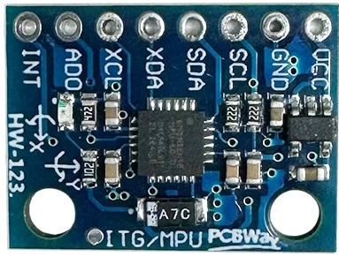

3. MPU6050 (GY-521) Inertial Measurement Unit
The MPU6050 module provides six degrees of freedom using:
  • a three-axis accelerometer,
  • a three-axis gyroscope.
The accelerometer measures linear acceleration along the X, Y, and Z axes, while the gyroscope measures angular velocity.
This subsystem enables:
  • activity recognition,
  • posture estimation,
  • orientation tracking,
  • motion analysis,
  • fall detection.
Parameters:
  • I2C communication,
Accelerometer ranges:
  • ±2g,
  • ±4g,
  • ±8g,
  • ±16g,
Gyroscope ranges:
  • ±250,
  • ±500,
  • ±1000,
  • ±2000 °/s.
Functions:
  • Motion detection,
  • Activity analysis,
  • Step counting,
  • Fall detection,
  • Spatial orientation.
The MPU6050 communicates using the same shared I2C bus as the MAX30100.
I2C was selected because of:
  • low pin count,
  • multi-device capability,
  • low complexity,
  • wide sensor compatibility.
The sensor addresses are:
I2C requires pull-up resistors. Pull-up resistors on SDA and SCL ensure proper signal integrity.
Typical values:
  • 4.7kΩ
  • 10kΩ
Most breakout boards already include pull-ups.

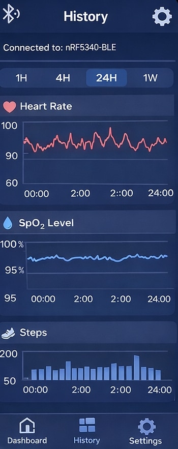

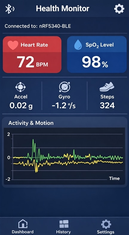

Smartphone Application
A cross-platform mobile application was developed using Flutter.
Flutter enables:
  • Android support,
  • iOS support,
  • modern UI design,
  • rapid development.
The mobile application performs:
  • BLE scanning,
  • automatic connection,
  • GATT service discovery,
  • notification subscription,
  • real-time data display.
The application displays:
  • current heart rate,
  • oxygen saturation,
  • motion information.
