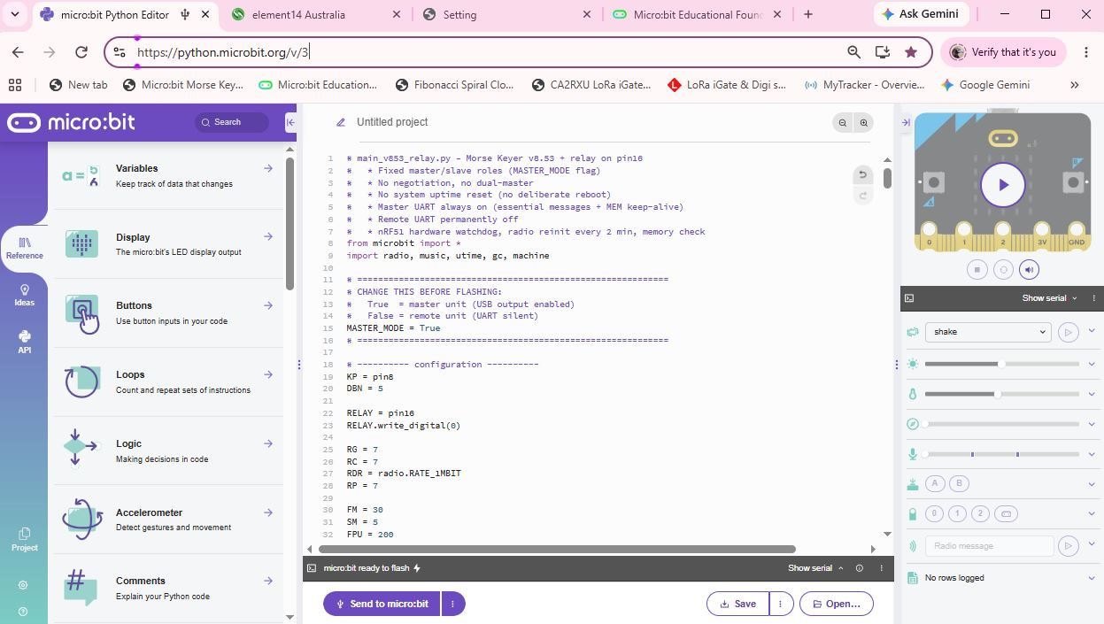

Morse Code is not dead. Here is my project to use 2 BBC micro:bits and a laptop to send Morse Code in both directions whilst also decoding Morse Code sent from both ends using button A or a proper key.
Step 1 upload the code using the Python Programmer On line.
Upload

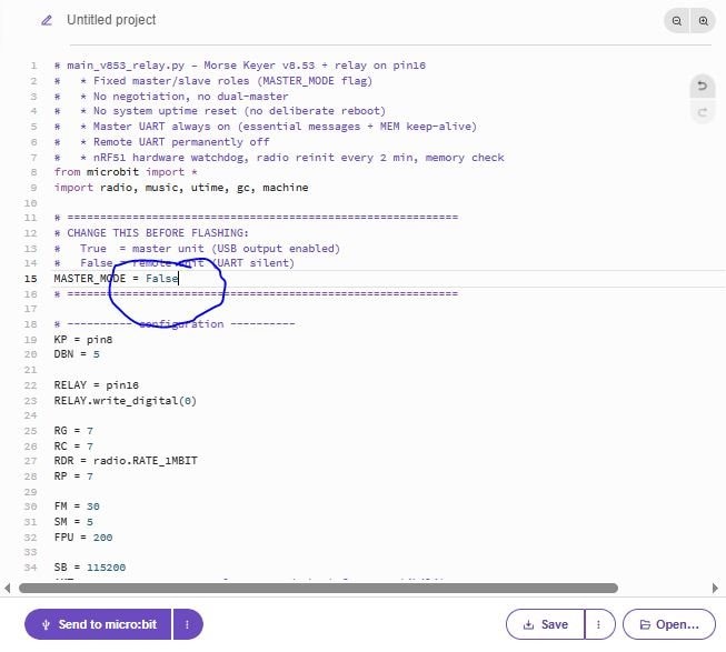

Remember to change 1 line of code to determine what end is connected to the laptop (Master). The USB port of the Remote or Slave end is not used, however it may be used for a variety of power connections of course.Master or Slave

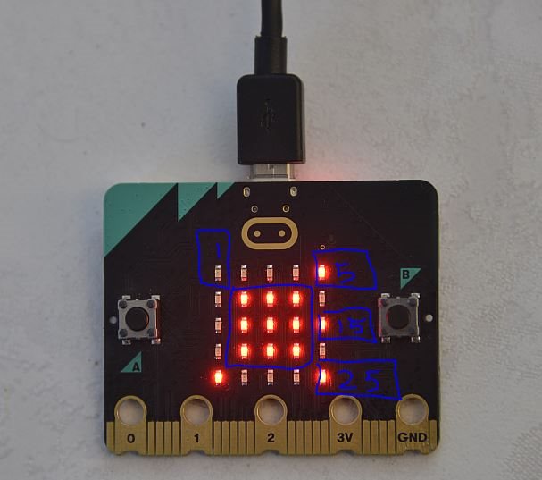

LED Layout
LED 1  is USB Tx LED 5 is USB Rx. LED 21 is WiFi Tx and Led 25 is WiFi Rx. LED 11 is Master end, LED 15 is Slave. The 9 LEDs in the middle are the Morse Code Display.

Here is the code for the micro:bit . V2.2 and above is required.
Fullscreen FasterMorseJS_854_BBC_RelayFlipped.txt Download

# ROLE:  True = master unit (USB output enabled)
#        False = remote unit (UART silent)
MASTER_MODE = True
