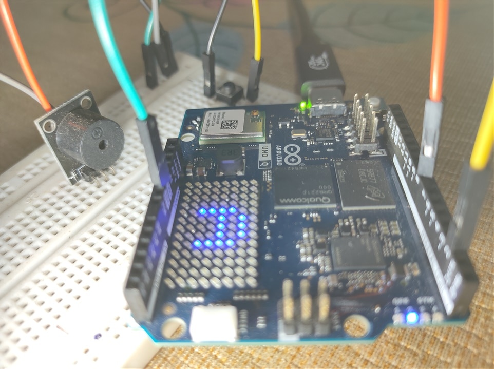

Project Overview
MorseMatrix is a standalone, real-time hardware Morse code decoder built on an Arduino Uno Q Single Board Computer with a built-in LED matrix. It turns the morse code entered through physical button presses into readable text by measuring press durations that is dash or dot, driving synchronized audio-visual feedback, and displaying decoded ASCII characters on the 8X13 LED Matrix—removing the need for a connected computer or serial monitor.

Hardware Requirements
  • Arduino Uno Q
  • Input: 1x Tactile Push Button
  • Audio Output: 1x Passive or Active Piezo Buzzer
  • Visual Output: Built-in 8X13 LED Matrix & Onboard LED_BUILTIN
  • Jumper wires, Breadboard
Design

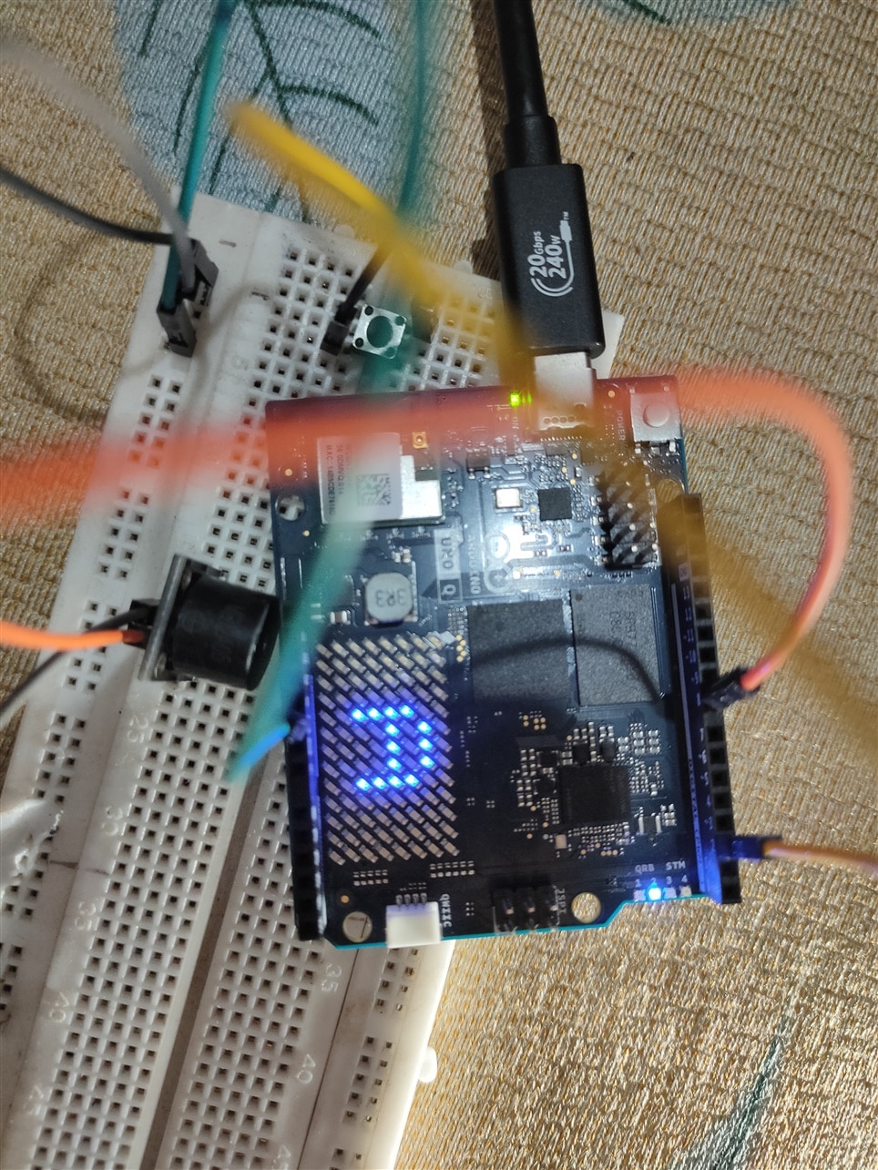

I initially started with a minimal setup on the Arduino UNO Q: a tactile push-button input paired with a simple piezo buzzer(active) and an external LED for immediate audio-visual feedback. Once I confirmed that the basic input timing logic worked reliably, I wanted to take the project a step further.
{gallery}
Img 1
Img 2
Relying on a connected computer screen and a Serial Monitor to view decoded characters felt incomplete for a standalone hardware device. To make it truly standalone, I decided to render the decoded ASCII characters directly onto the board's  8X13 LED Matrix.

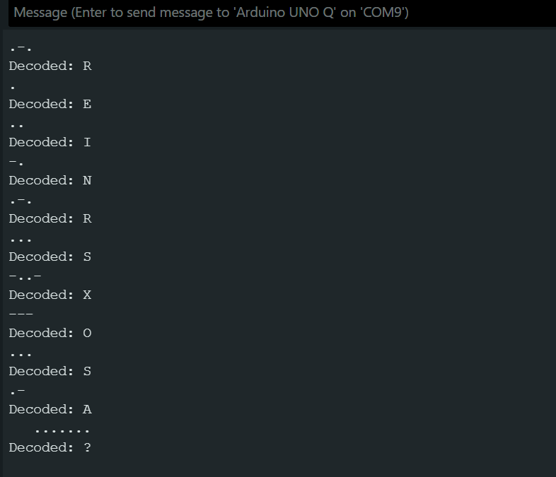

Signal Input & Timing Thresholds
  1. Active-LOW Button Sensing: The button uses the internal INPUT_PULLUP resistor. When pressed, the pin reads LOW.
  2. Tone & LED Synchronization: While pressed, the buzzer beeps and the onboard LED illuminates.
  3. Duration Classification:
    Press Duration <= 250 ms   => Dot (.)
    Press Duration > 250 ms     => Dash (-)
Img 3
Technical Challenges & Corrections
Matrix Skewing & Stray Pixels
Bringing the display to life presented a few interesting hardware and software challenges:
  • Matrix Skew Alignment: My initial character renderings were visibly skewed like a parallelogram, accompanied by a stray pixel in the corner. I diagnosed this as a buffer stride issue—my code was sizing the frame buffer for 12 columns instead of the driver's required 13 columns (8X13), causing an accumulator bit shift across rows. Sizing the array to uint8_t frame[8][13] instantly straightened the 5x5 font and centered it cleanly.
  • Streamlining Components (Active-LOW LED): To keep the hardware footprint clean, I eliminated the external LED and repurposed the board's built-in LED_BUILTIN. Because this board wires the onboard LED using active-LOW logic, I updated the control logic so that LOW illuminates the LED during button presses and HIGH turns it off when idle.
