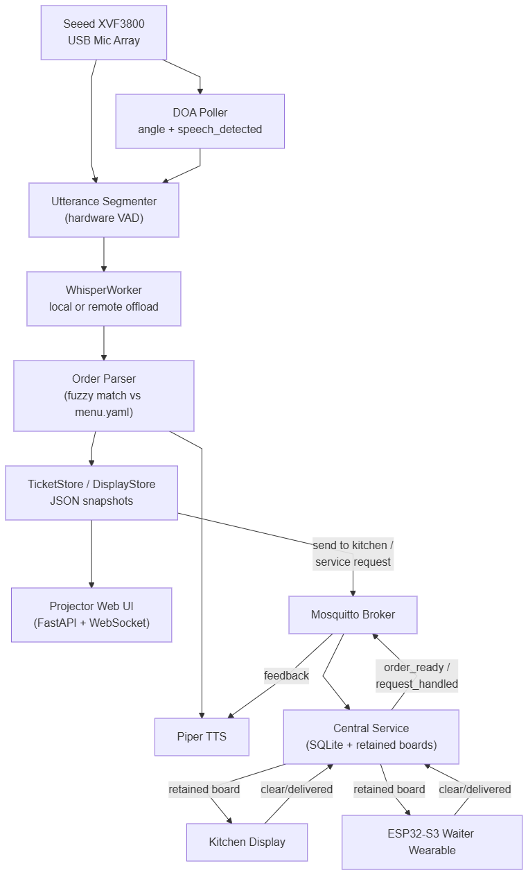

Code Organization
To Follow the code along, Let me explain to you how the code is organized. IT is slightly chaotic.
  • orderup/ — the per-table pipeline (one process per board, one board per table), plus the one part of this tree that isn't per-table:
    • audio/ — captures mic frames, shells out to arecord (https://linux.die.net/man/1/arecord)
    • doa/ — polls the XVF3800 for angle + speech-detected over USB
    • asr/ — wraps whisper.cpp (local or remote offload)
    • nlp/ — fuzzy order-parsing and voice-command recognition (after the whisper Speech to text)
    • ticket/ — the seat's current order/display state, as JSON
    • tts/ — speaks replies through Piper
    • web/ — serves the projector UI
    • seat_map.py — top-level module, turns a DOA angle into a seat label
    • integrations/ — where a table's pipeline talks outward: kitchen_sink.py to the central service over MQTT, order_sink.py to an optional external Django backend over HTTP (disabled by default)
    • main.py — wires all of the above together; the file most of this post's snippets come from
    • kitchen/ — not per-table. This is the central service (server.py, class CentralService) — its own always-on process, not scoped to any one table — plus web_server.py, the FastAPI process that bridges that service's MQTT board topics to the browser-based kitchen display over a websocket
  • firmware/waiter_wearable/ — a separate PlatformIO codebase for the ESP32-S3 wearable staff carry; it only talks to the rest of the system over MQTT, the same broker the central service uses.
The Flowchart

Beyond One Table: MQTT and Retained Messages
"Send to kitchen" and service requests don't hit an HTTP endpoint — they publish to an MQTT broker (Mosquitto), and one central service (not scoped to any single table) subscribes, persists to SQLite for crash-safety, and republishes two rolling "board" snapshots: one for the kitchen display, one for waiter wearables. MQTT fit this better than HTTP for the same reason it fits most IoT fan-out: many small, independent publishers and subscribers (every table's board, the central service, the kitchen display, every wearable) that don't need to know about each other's IP addresses or be online at the same moment — they only need to agree on a broker and a topic name.
Standing Up the Broker
The broker itself runs as one Mosquitto container, not a bare-metal install — one docker compose up on whatever machine is going to be "the network's central point" (in this deployment, the same box running the central service) is the entire setup (docker/mosquitto/docker-compose.yml):
services:
  mosquitto:
    image: eclipse-mosquitto:2
    container_name: orderup-mosquitto
    restart: unless-stopped
    ports:
      - "1883:1883"
    volumes:
      - ./mosquitto.conf:/mosquitto/config/mosquitto.conf:ro
      - mosquitto-data:/mosquitto/data
      - mosquitto-log:/mosquitto/log
volumes:
  mosquitto-data:
  mosquitto-log:
cd docker/mosquitto
docker compose up -d
restart: unless-stopped means it survives a host reboot without anyone remembering to start it by hand — important for something every table's pipeline depends on to send an order at all. The mounted mosquitto.conf is deliberately minimal, because this only ever runs on a closed restaurant LAN, never internet-facing:
# Matches config/app.yaml's mqtt: block (broker_port: 1883) and the
# Phase 0 plan in docs/mqtt-architecture-plan.md: closed restaurant LAN,
# no internet-facing exposure, so anonymous access is fine.
listener 1883 0.0.0.0
allow_anonymous true
persistence true
persistence_location /mosquitto/data/
log_dest stdout
allow_anonymous true and no TLS listener are choices that only make sense because this box never leaves the restaurant's own LAN — the moment this needed to be reachable from outside that network, both of those would need to change.
Pointing Every Board at It
Every process that needs the broker — each table's pipeline, the central service, the kitchen display's web bridge — reads the same three settings out of its own config/app.yaml:
mqtt:
  # Broker every table, the central service (orderup/kitchen/server.py),
  # the KDS, and waiter wearables all connect to -- see
  # docs/mqtt_topics.md. Always on -- unlike backend.* below, this has no
  # real external dependency to gate behind a flag.
  broker_host: 192.168.29.206
  broker_port: 1883
  table_id: table1
broker_host/broker_port point at the container above; table_id is the one setting that differs per board — it's what namespaces every MQTT topic a table publishes to (orderup/table1/order_sent, orderup/table2/order_sent, …), so two tables' pipelines never collide on the same topic even though they're all talking to one shared broker.
Sending an Order
The trigger is a voice command, recognized before the order parser ever runs (so "send my order to the kitchen" — which contains the substring "my order" — can't get misread as "show my order"), and the handler is a straight line from ticket to broker (orderup/main.py, inside the transcript consumer):
if is_send_to_kitchen(text):
    lines = ticket_store.pop_all(seat_label)
    if lines:
        kitchen_sink.send_order(seat_label, lines)
ticket_store.pop_all empties that seat's pending order and hands back the lines; kitchen_sink.send_order (orderup/integrations/kitchen_sink.py, running inside the same per-table process) is what actually does the MQTT publish:
def send_order(self, seat_label: str, lines: list[TicketLine]) -> bool:
    payload = {
        "table_id": self._table_id,
        "seat_label": seat_label,
        "timestamp": time.time(),
        "items": [
            {"item_id": l.item_id, "name": l.name, "quantity": l.quantity, "modifiers": l.modifiers}
            for l in lines
    return self._publish(f"orderup/{self._table_id}/order_sent", payload)
self._table_id comes from that table's own config/app.yaml (mqtt.table_id, e.g. "table1") — each board's process is configured with its own identity, so the topic name itself namespaces the order by table. The central service — CentralService in orderup/kitchen/server.py, a separate always-on process not tied to any one table — is subscribed on the other end and is what actually calls _publish_board, shown above.
Two different things consume that retained board on the way out, and they don't do it the same way: the ESP32-S3 wearable runs a plain MQTT client directly (PubSubClient, in firmware/waiter_wearable/src/main.cpp) and subscribes to orderup/board/waiter itself — no intermediary. Its incoming-message handler deserializes the retained JSON and hands the items array straight to the screen-drawing routine:
void onMqttMessage(char *topic, byte *payload, unsigned int length) {
  JsonDocument doc;  // ArduinoJson v7: auto-sized, no manual capacity math
  DeserializationError err = deserializeJson(doc, payload, length);
  if (err) {
    Serial.printf("[waiter] bad board payload: %s\n", err.c_str());
    return;
  renderBoard(doc["items"].as<JsonArray>());
renderBoard walks that array (newest-first, since the central service publishes oldest-first) and draws each item's table/seat/request text plus a touch-sized "DONE" button — the same button FT3168.getTouch() reads back from, closing that loop. A browser can't hold a raw MQTT connection the same way, so the kitchen display goes through orderup/kitchen/web_server.py instead: a small FastAPI process that subscribes to orderup/board/kds on the Python/MQTT side and re-broadcasts every update to connected browsers over a plain websocket — the same static-file-plus-websocket pattern the projector UI (orderup/web/server.py) already used, just fed by MQTT instead of a JSON file on disk.
Retained Messages
The interesting design decision here wasn't the transport, it was solving "how does a freshly-connected subscriber get current state" without building a separate query API. MQTT's retained messages answer that for free — publish the board snapshot with retain=True, and any client that connects after the fact (a rebooted wearable, a freshly opened kitchen display) gets the latest snapshot immediately, no polling, no REST endpoint to maintain in parallel with the pub/sub path.
The freshly-connected-subscriber problem is solved by one keyword argument (orderup/kitchen/server.py):
def _publish_board(self, board: str, items: list[dict]) -> None:
    self._client.publish(f"orderup/board/{board}", json.dumps({"items": items}), qos=1, retain=True)
retain=True is the one doing that work; qos=1 is a separate, unrelated MQTT setting — "deliver at least once," with the broker re-sending until it gets an acknowledgment, instead of the fire-and-forget default (qos=0). It's there because a dropped board update is a KDS silently missing a new order, not just a stale-but-eventually-correct display.
versus the one-off notifications the same service sends (self._client.publish(f"orderup/{table_id}/{kind}", ..., qos=1), no retain) — an order_ready ping shouldn't replay to a table that reconnects an hour later, so that one deliberately omits the flag _publish_board always sets.

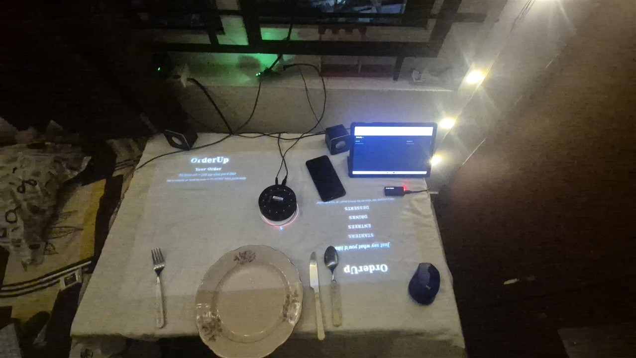

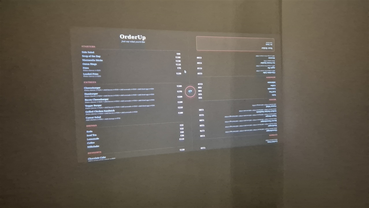

Projecting the Menu: the Table-Top Display
This is the piece that came out of the Interactive Signage angle mentioned back in "The Concept" — a small FastAPI process (orderup/web/server.py) that a projector points straight down at the table, showing each seat its own menu/order state.
How It's Built
The web UI is deliberately a pure read-only viewer — it never writes pipeline state, only reads the same files the voice pipeline already produces:
def _load_state_paths() -> tuple[Path, Path]:
    app_cfg = yaml.safe_load(APP_CONFIG_PATH.read_text())
    paths = app_cfg["paths"]
    return Path(paths["ticket_state_file"]), Path(paths["display_state_file"])
ticket_state.json (written by orderup/ticket/ticket_store.py) is each seat's current order lines; display_state.json (written by orderup/ticket/display_store.py) is each seat's current view — which category it's showing, or order, or a transient confirmed/ready notice, or off for "focus on eating" mode. Two endpoints hand those over as JSON — /api/menu (menu + seat layout, from config/menu.yaml and config/web_layout.yaml) and /api/ticket (the live combined state) — and a websocket, /ws/ticket, pushes a fresh snapshot to the browser whenever either file's mtime changes:
@app.websocket("/ws/ticket")
async def ws_ticket(websocket: WebSocket) -> None:
    await websocket.accept()
    last_mtimes: tuple[float | None, float | None] = (None, None)
    try:
        while True:
            mtimes = _mtimes()
            if mtimes != last_mtimes:
                last_mtimes = mtimes
                await websocket.send_json(read_combined_state())
            await asyncio.sleep(0.4)
    except WebSocketDisconnect:
        pass
Polling the mtimes every 0.4s instead of a filesystem watcher is a deliberately small trade — the pipeline already writes those files as plain JSON on every state change, so a watcher would save a bit of CPU for a UI where 0.4s of extra latency on a menu update is imperceptible.
On the browser side, app.js renders two independent halves of the screen — config/web_layout.yaml maps left_seat/right_seat to seat labels from config/seats.yaml, and the right half is rotated 180° in CSS so it reads upright to whoever's sitting across the table. Each half is driven purely by that seat's current view string from display_state.json — welcome, a menu category, order, confirmed, ready, or off:
function renderView(side, view, categories, ticket) {
  if (view === "order") {
    renderOrderView(container, ticket);
  } else if (view === "confirmed") {
    renderNotice(container, "Sent to Kitchen!");
  } else if (view === "ready") {
    renderNotice(container, "Order Ready!");
  } else if (view === "off") {
    renderOff(container);
  } else if (isCategory) {
    renderCategory(container, categories, view);
  } else {
    renderWelcome(container);
There's deliberately no combined "show everything" view — a seat is always showing exactly one thing at a time, driven entirely by what that seat last said ("show me the dessert menu", "show my order", "turn off the menu"), which is what makes it feel like the table is responding to you rather than just displaying a static menu.
Running It
orderup/web/server.py is its own process, separate from the voice pipeline, and the two talk to each other only through those two JSON files on disk — either can restart without taking the other down. Standalone, it's just:
python -m orderup.web.server
which serves on :8080. In the actual table deployment it's launched alongside the voice pipeline and then handed straight to a kiosk browser pointed at itself, all in one script (scripts/run_table.sh):
"$VENV_PYTHON" -u -m orderup.main > >(tee "$LOG_DIR/pipeline.log") 2>&1 &
PIPELINE_PID=$!
"$VENV_PYTHON" -u -m orderup.web.server >"$LOG_DIR/projector.log" 2>&1 &
PROJECTOR_PID=$!
# ...wait for :8080 to come up, then...
DISPLAY="${DISPLAY:-:0.0}" firefox-esr --kiosk --private-window "$PROJECTOR_URL"
--private-window on the kiosk browser is there for a specific reason: this display should always show whatever's currently deployed, never a stale cached bundle left over from before the last git pull (I was working between my main desktop and Radxa)  a persistent browser profile's disk cache can otherwise keep serving old JS/CSS indefinitely, since the static files aren't sent with cache-busting headers. A fresh private window every launch sidesteps that entirely instead of having to get cache headers right.

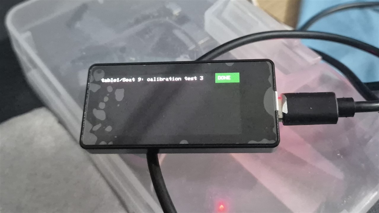

The Waiter Wearable: the ESP32-S3 Device and Its Firmware
The Device
The wearable staff carry is a Waveshare ESP32-S3-AMOLED-1.91: an ESP32-S3R8 (8MB octal PSRAM, 16MB flash) with a 1.91", 536×240 AMOLED panel (an RM67162 driven over QSPI), a capacitive touch layer (FT3168, over I2C), a QMI8658 IMU, and a JST battery header — small enough to actually wear, with just enough screen to show a handful of live requests. It's USB-powered in this deployment (no sleep/battery management wired up), and there's no buzzer or haptic on the board, so alerts here are screen-only.
Firmware Setup
The firmware is a plain PlatformIO project (firmware/waiter_wearable/), Arduino framework. There's no stock PlatformIO board definition for this exact Waveshare board, so platformio.ini starts from the generic esp32-s3-devkitc-1 definition and overrides memory settings for the octal-PSRAM/16MB-flash variant:
[env:esp32-s3-waveshare-amoled-1_91]
platform = espressif32
board = esp32-s3-devkitc-1
framework = arduino
board_build.arduino.memory_type = qio_opi
board_upload.flash_size = 16MB
board_build.partitions = default_16MB.csv
build_flags =
    -DARDUINO_USB_MODE=1
    -DARDUINO_USB_CDC_ON_BOOT=1
lib_deps =
    moononournation/GFX Library for Arduino @ 1.4.9
    knolleary/PubSubClient @ ^2.8
    bblanchon/ArduinoJson @ ^7.1.0
Those two build_flags matter more than they look: esp32-s3-devkitc-1's default USB config assumes USB-OTG wiring for Serial, but this board only exposes the native USB-Serial/JTAG peripheral — without them, boot ROM text still shows up over USB (it goes through the JTAG-serial console independent of Arduino's Serial object), but every Serial.print/printf call in the actual firmware is silently dropped. The GFX library is also pinned to exactly 1.4.9, not ^1.4.9 — 1.5+ needs a header from a newer arduino-esp32 core than the pinned espressif32 platform ships, and fails to compile here.
include/board_pins.h maps the QSPI display bus, the shared I2C bus, and the touch controller's reset/interrupt lines — pulled from Waveshare's own demo repo for this board.
Before a first build, copy include/secrets.h.example to include/secrets.h and fill in the WiFi SSID/password and the MQTT broker's LAN IP. Then it's the usual PlatformIO loop:
pio run                      # build
pio run -t upload            # flash over USB-C
pio device monitor           # serial log (115200 baud)
# or all at once:
pio run -t upload -t monitor
What the Firmware Actually Does
src/main.cpp is a single-file Arduino sketch: setup() brings up the display (Arduino_RM67162 over Arduino_ESP32QSPI), probes the touch controller once, then connects WiFi and MQTT; loop() just keeps both connections alive and polls for a touch. The interesting logic sits in three places:
  • Rendering the board. renderBoard() draws up to three requests at once — sized to be legible from across a room — walking the retained JSON backwards so the newest request shows first, and remembering which item id is on each row so a tap can be mapped straight back to it:
      if (err) {
        return;
  • Trusting the touch controller. A failed I2C read can look exactly like a real tap — Wire's requestFrom() can report success even when the FT3168 never actually ACKs, which produced garbage coordinates that happened to land on the "done" button and auto-cleared a real request seconds after it arrived. probeTouch() reads a real status register once at boot, and every bit of touch handling is gated on that probe having actually succeeded:
    bool probeTouch() {
      Wire.beginTransmission(I2C_ADDR_FT3168);
      Wire.write((uint8_t)0x02);
      bool wrote = Wire.endTransmission(false) == 0;
      bool read = Wire.requestFrom(I2C_ADDR_FT3168, (size_t)1) > 0 && Wire.available() > 0;
      return wrote && read;
  • Turning a tap into a clear. handleTouch() remaps the FT3168's native-portrait raw coordinates into the display's rotated landscape space, checks whether the tap lands in a row's "DONE" button, and if so publishes orderup/board/clear with that row's item id — the central service is what actually removes it and republishes the board, closing the loop back to this same screen.
Verifying the wearable doesn't require the whole voice pipeline running — publishing a fake retained board straight to the broker is enough to check the device end to end:
mosquitto_pub -h <radxa-ip> -t orderup/board/waiter -r -m \
  '{"items": [{"table_id": "table1", "seat_label": "Seat 1", "request": "water", "timestamp": 0}]}'
