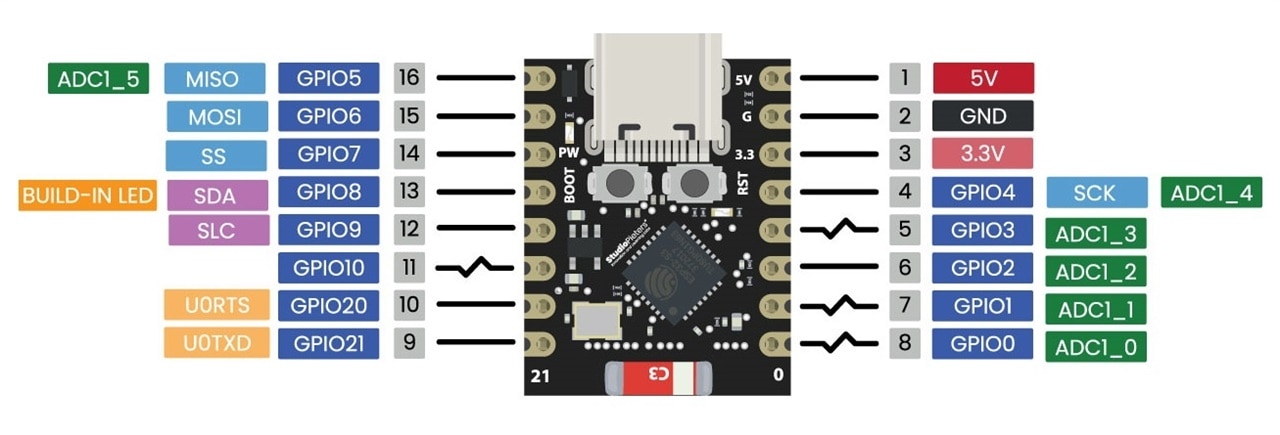

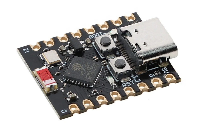

I used the following hardware components to make my low-cost RescueLink device. The main components of the device is ESP32-C3 Super Mini and the LoRa RA-01 based on the SX1278 chipset. For the microcontroller I used ESP32-C3 Super Mini because it is very compact in size, low-cost, and has low power consumption. For an emergency communication device, battery life and portability are particularly important. The ESP32-C3 is based on a 32-bit RISC-V processor and supports low-power operating modes, allowing the device to operate from a small battery for extended periods. Its compact Super Mini form factor also makes it possible to build a small, lightweight handheld device.
                                                               Image: ESP32-C3 Super Mini
                                                                Image: ESP32-C3 Super Mini Pinout

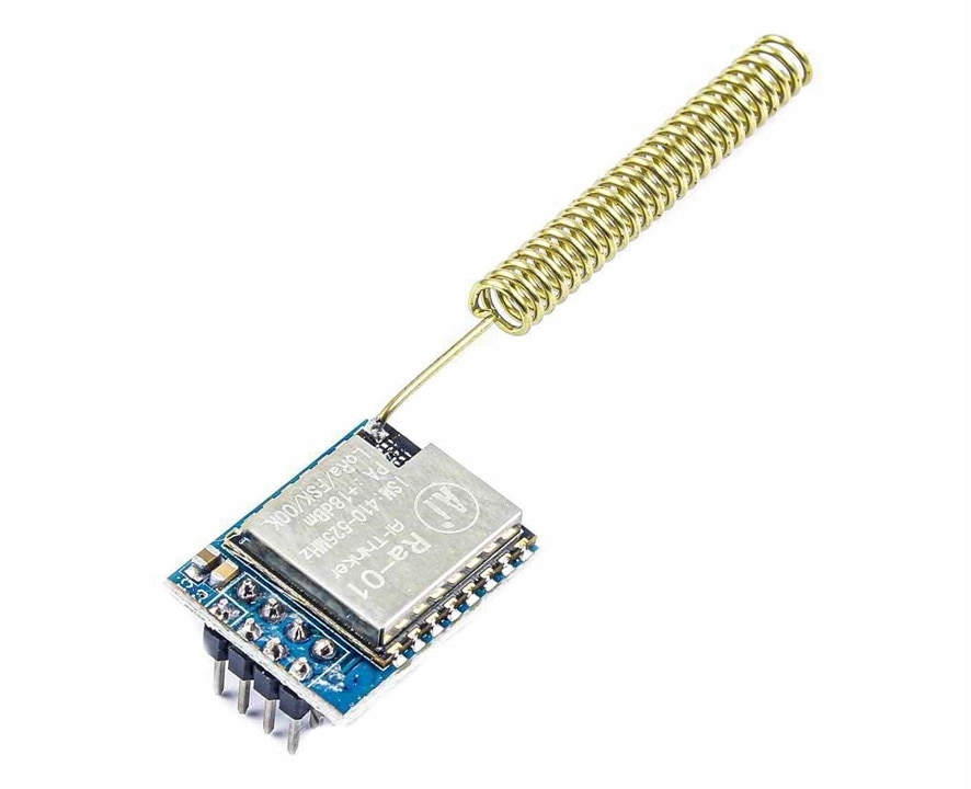

I used the RA-01 LoRa module as a communication link. RA-01 is a compact LoRa wireless communication module based on the Semtech SX1278 transceiver. It is designed for long-range, low-power wireless communication and typically operates in the 433 MHz ISM band. The module uses LoRa modulation, which provides good receiver sensitivity and robust communication over long distances, particularly for small amounts of data. Depending on factors such as antenna quality, transmit power, spreading factor, bandwidth, terrain, obstacles, and interference, it can achieve communication distances ranging from several kilometers in open areas to shorter distances in dense urban environments. It communicates with a microcontroller through an SPI interface and is commonly used in IoT devices, environmental monitoring, remote sensors, telemetry systems, and off-grid communication projects.
                               Image: RA-01 LoRa Module

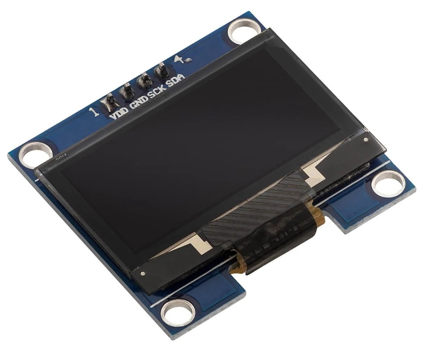

To display the messages, I used a 1.3-inch I2C OLED display for my device. Its compact size keeps the overall device portable while providing clear, high-contrast text with low power consumption. I chose a 1.3-inch OLED instead of a more common 0.96-inch OLED mainly because the slightly larger display provides a more comfortable area for reading text messages. The larger screen allows more characters to be displayed per line and makes messages easier to read, especially during emergency situations when quick and clear communication is important.
                                                 Image: 1.3inch I2C OLED

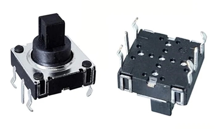

For writing messages, I used 5-way tactile button instead of a conventional keypad to keep the RescueLink device compact and simple. The five directions: up, down, left, right, and center/OK are sufficient for navigating menus, selecting characters, composing messages, and controlling the device. Compared with a full keypad, it requires fewer components, fewer GPIOs, and less physical space, allowing the device to maintain a small handheld form factor. It also provides a simple and intuitive interface that is suitable for an emergency communication device.
                                                         Image: 5-way tactile button

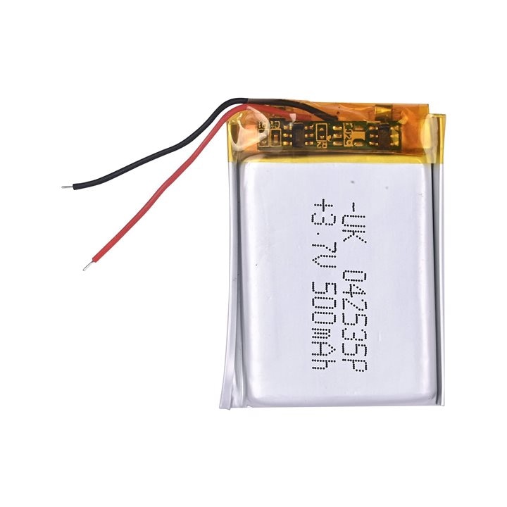

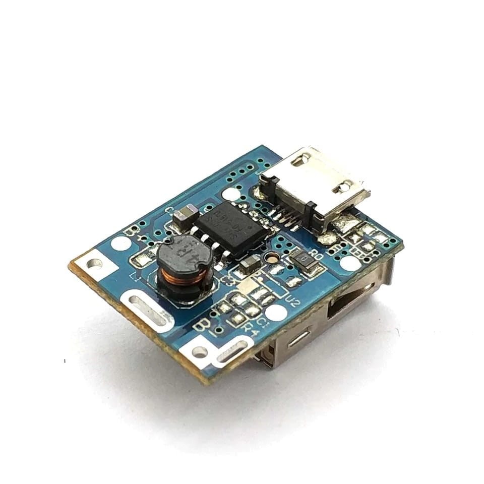

The device is battery-operated and takes power from a Li-ion battery. The output voltage of the Li-ion battery is not directly compatible with the ESP32 chip. So, I need to boost the battery voltage to 5V as the ESP32-C3 board has a built-in 3.3V regulator. At the same time Li-ion battery requires a charging circuit. I used a small power bank circuit module that serves both purposes.
                       Image: Power bank charger circuit module
                         Image: 500mAh Li-ion battery

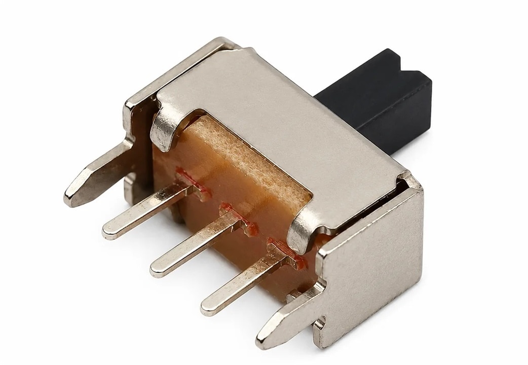

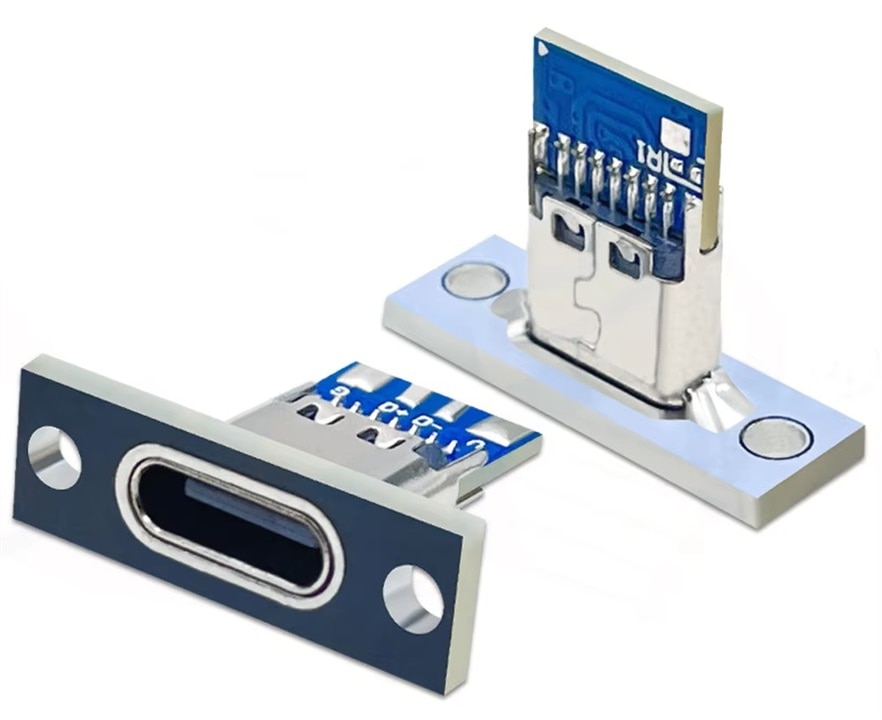

As On/Off switch, I used a 3-pin slide switch. For charging the battery, I used USB Type-C 3.1 Female Socket with secure screw-fixing plate.
                                         Image: Sliding switch
                                                  Image: USB-C Charging port

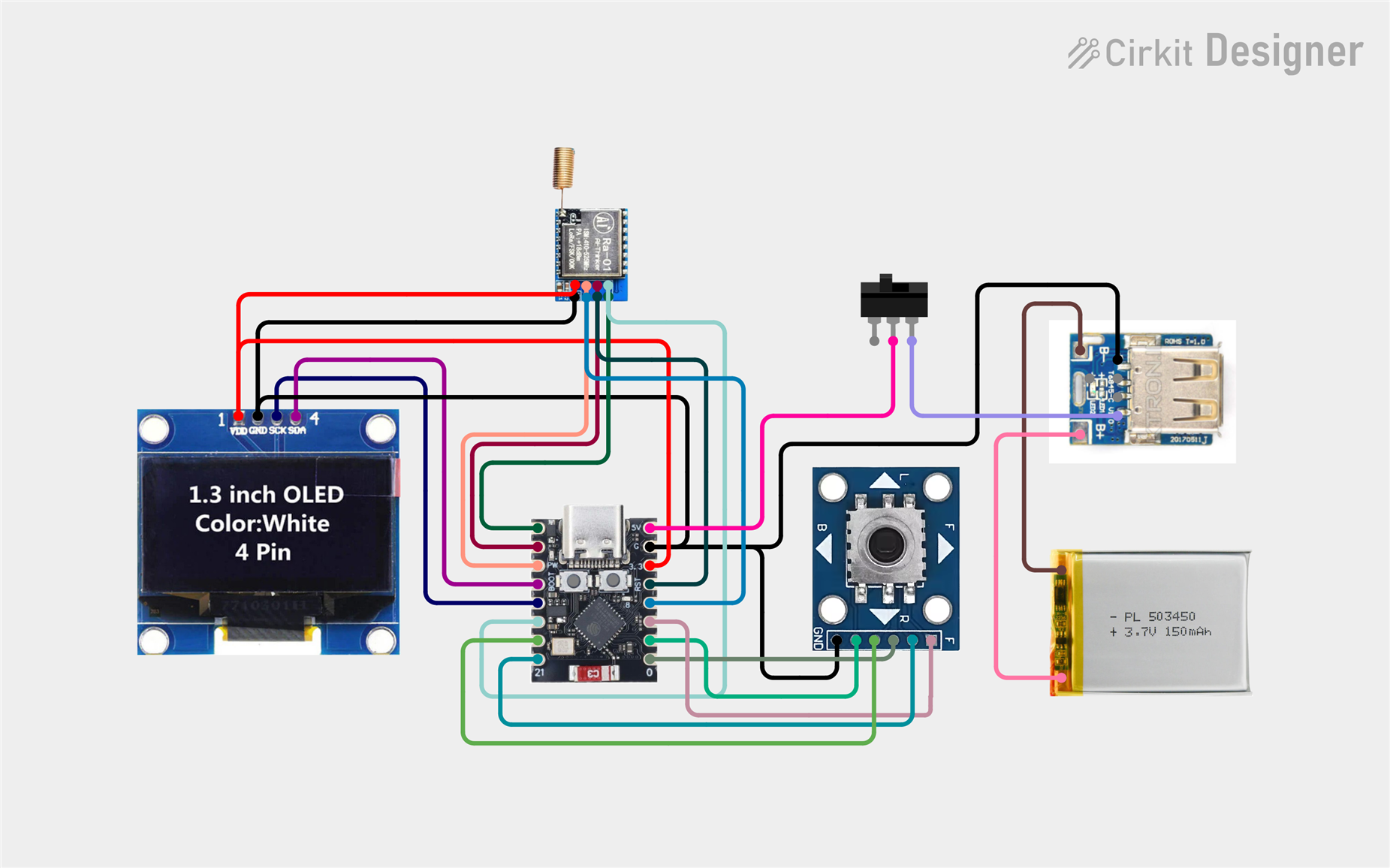

Schematic
The following image shows the schematic diagram of my project. OLED display is connected to the default I2C port of the ESP32-C3. The LoRa module is connected to the default SPI port of the microcontroller board. 5-way button is connected to the rest of the GPIOs of the ESP32 microcontroller board.
                                                                                                                   Image: Schematic Diagram

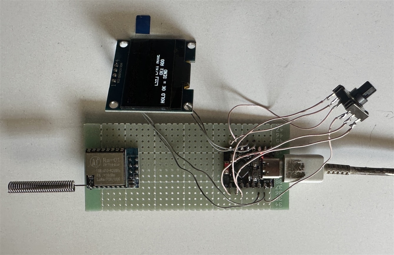

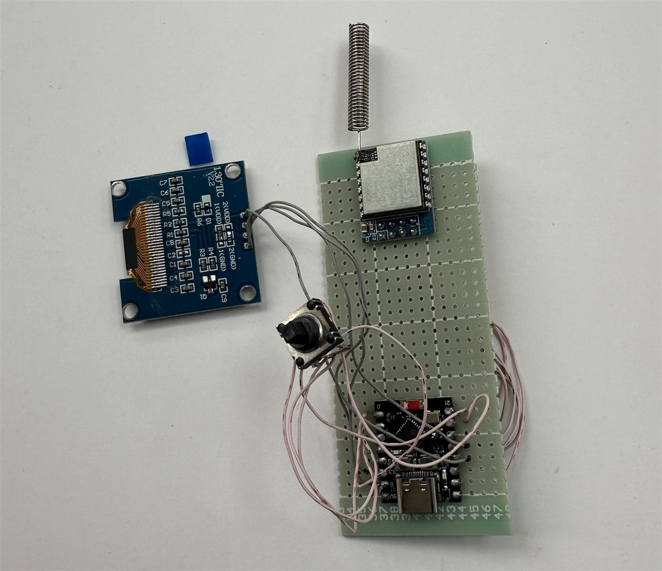

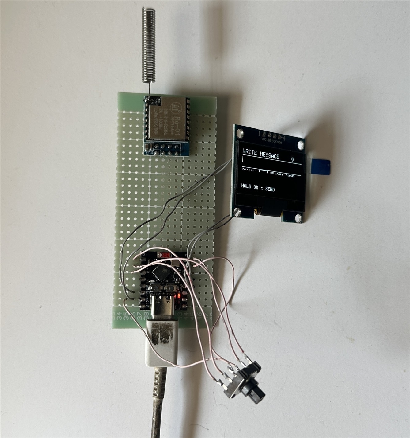

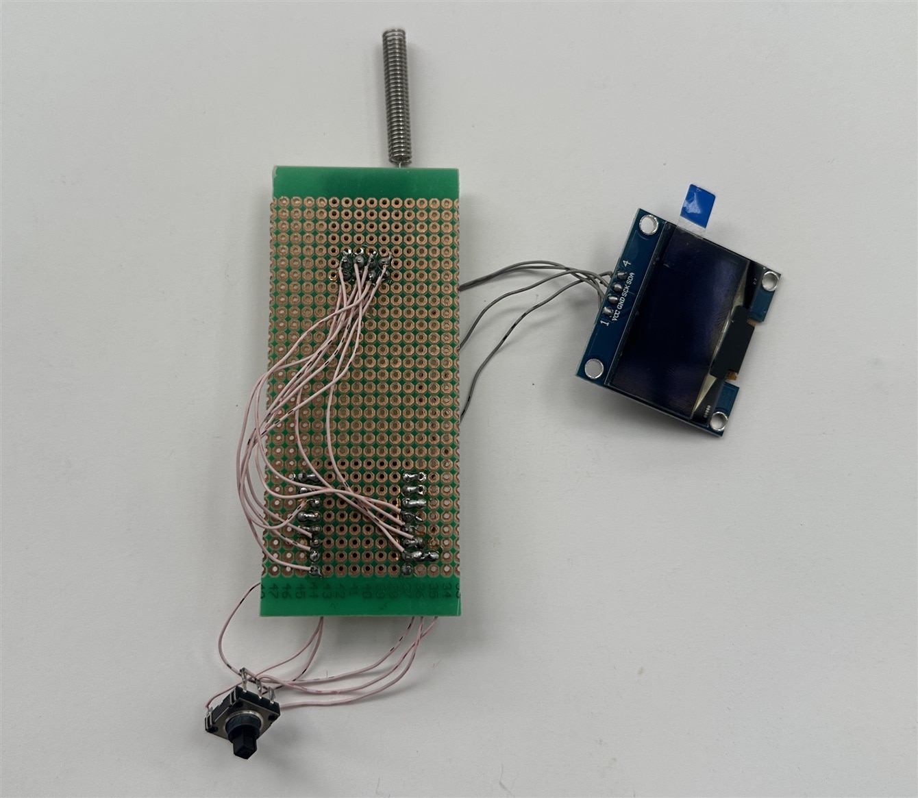

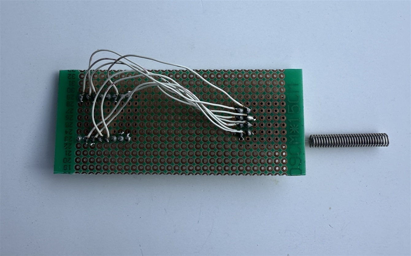

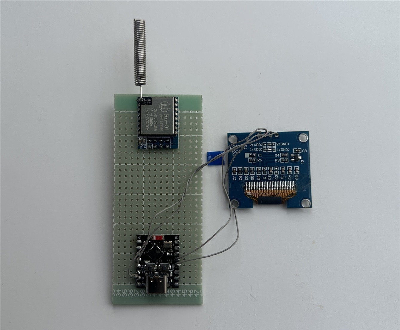

Hardware Connection & Soldering

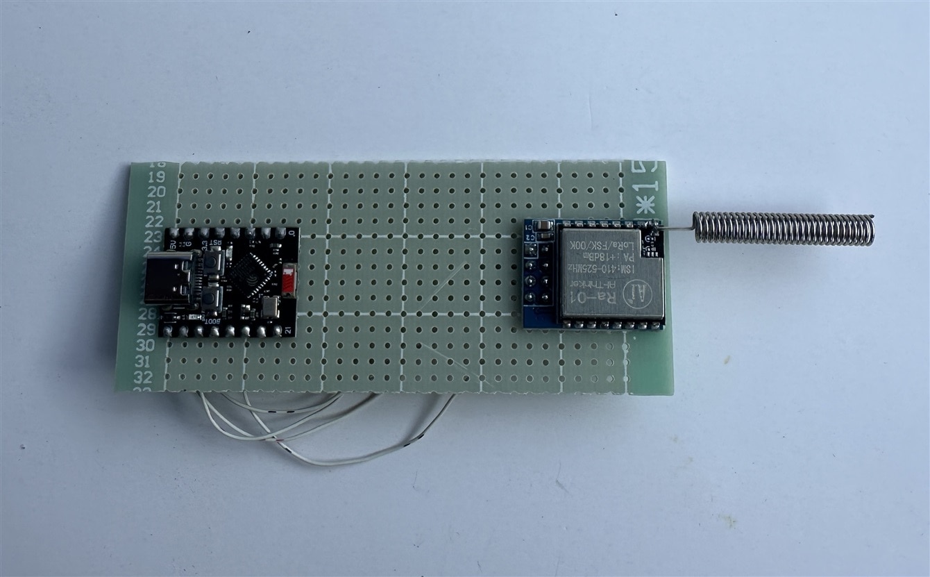

I took a small piece of single-sided perf board to solder the ESP32 module and the LoRa module and soldered both modules as shown in the image below.
I used thin flexible jumper wires to make connections between different components.
I soldered I2C OLED display to the microcontroller unit using same jumper wires.
Then I connected 5-way button to the rest of the GPIO pins of the ESP.
In this stage, I uploaded the code to the ESP board and connected a USB-C cable to power up the device. The was working as expected.
I pressed the button in all directions, and it was working perfectly.

  oled.drawStr(
    0,
    63,
    "HOLD OK = SEND"
  oled.sendBuffer();

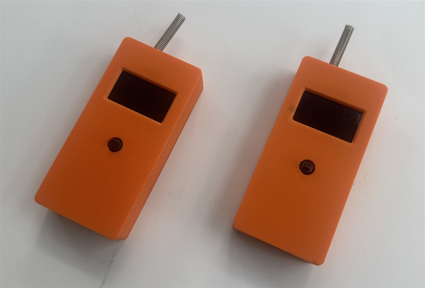

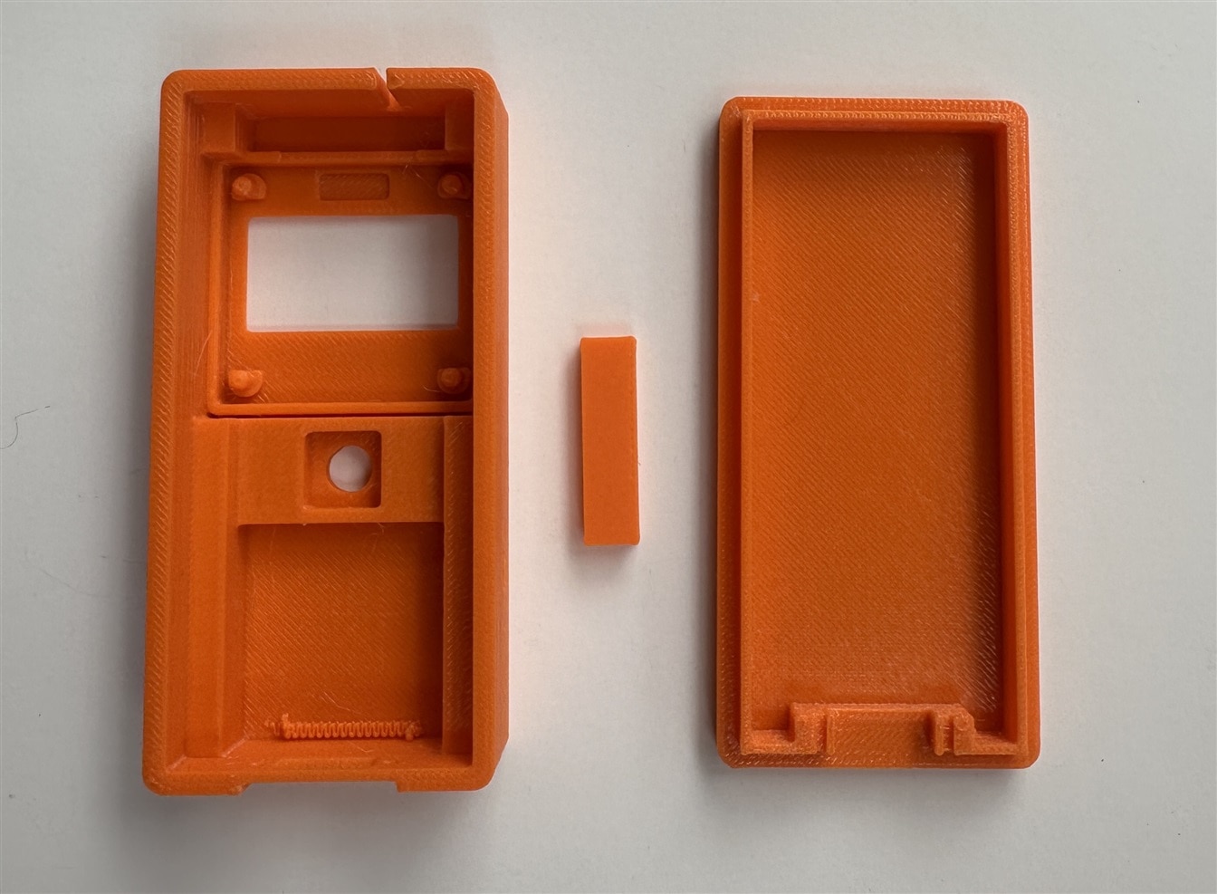

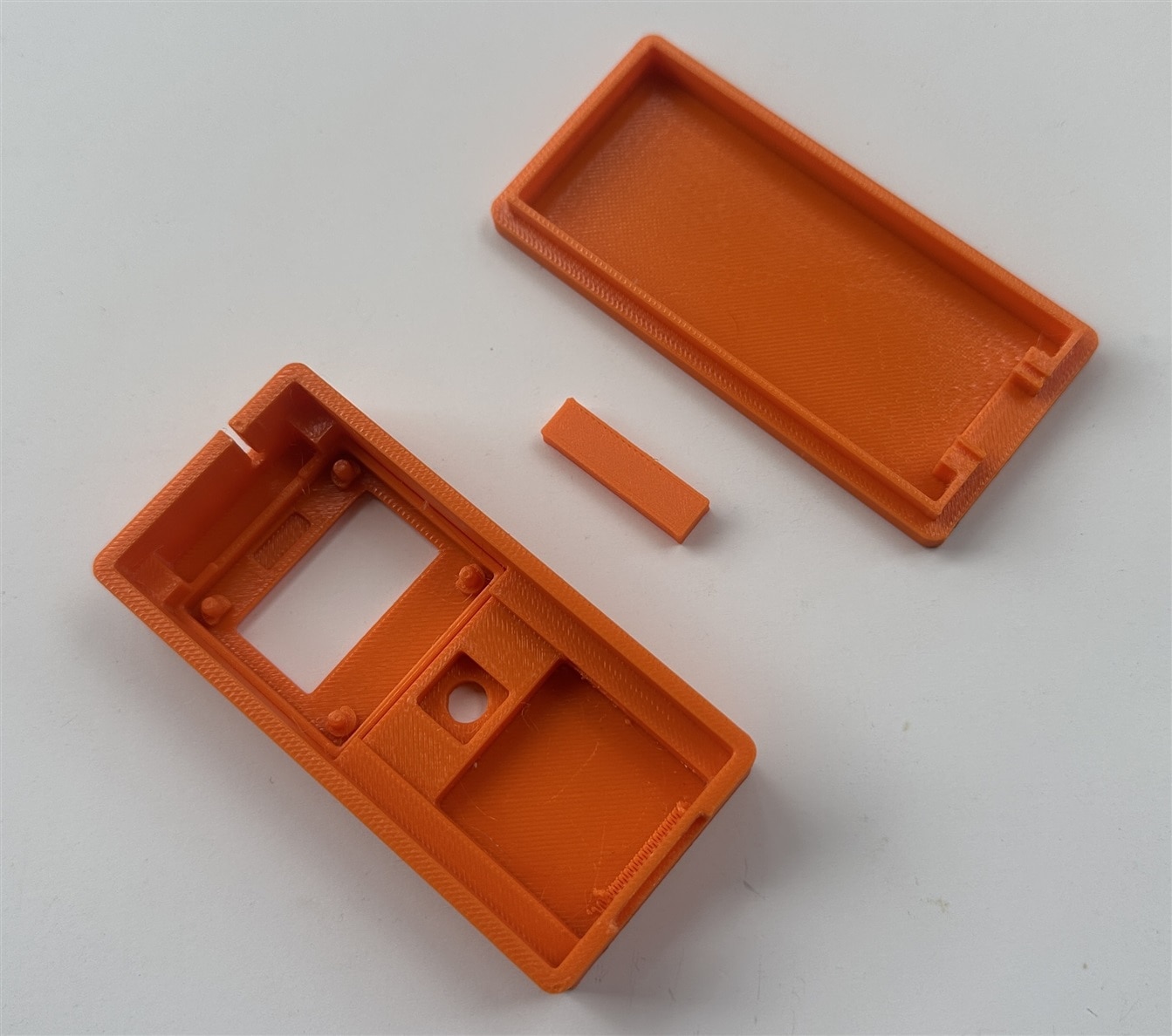

I designed a 3D case using Tinkercad and printed it using PETG material.
7673.LoRa Messenger_top.stl
0702.LoRa_Messenger_bottom.stl
4034.LoRa Messenger_stick.stl

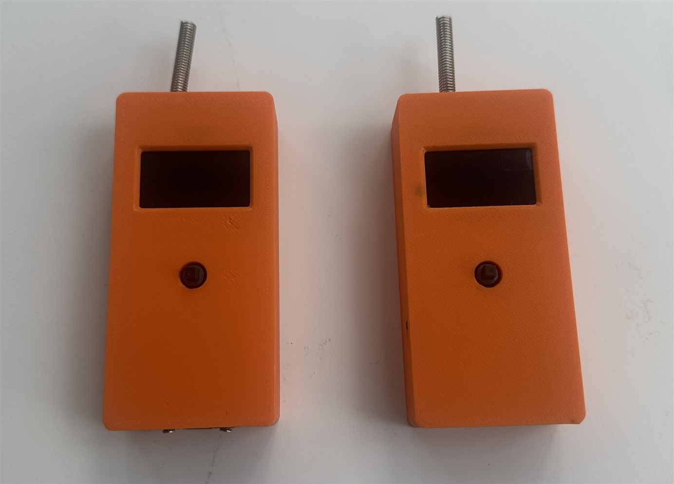

Device Is Ready:
Watch the following assembly video:
Messenger In Action
