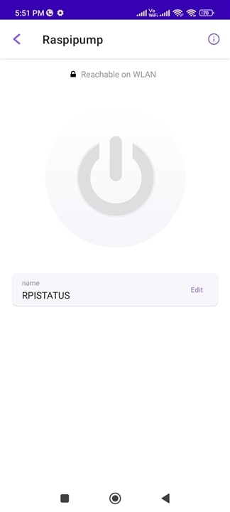

The idea is to use Rainmaker mobile application to switch on/off the pump. To do that the user will first login to Raspberry pi remotely or use the public link that was generated by ngrok and watch the status of plants using the ESP32 camera module. If the plants need water, then user can use Rainmaker Android application to turn on the pump and water the plants.
Also, I am using the Rainmaker application to start the Raspberry Pi remotely to save power. Otherwise, the Raspberry Pi will have to remain on for prolonged periods of time without any work. For raspberry Pi, there is a pin called Run that can do this. This pin if grounded for some milliseconds could start the Raspberry Pi from shutdown state.
RPI Run pin
Here is a small clip that shows how I can start the Raspberry Pi remotely using the Rainmaker Application. I can use this application from anywhere in the world. Only need is having internet connection at both ends.
The Raspberry Pi Run pin is controlled using the Xiao ESP32C3 module. A tiny transistor is connected to the GPIO of ESP32 module to bring the Run pin from Raspberry Pi to GND level for some milliseconds (approx. 50ms). This will trigger the Raspberry pi and it will turn on.

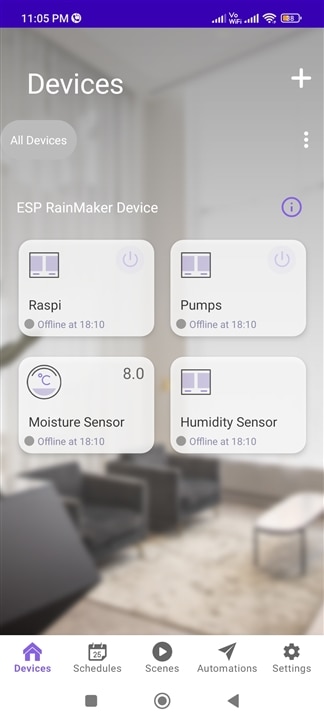

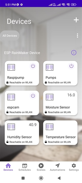

The following screenshoot shows us how the code that we write above has created in the Rainmaker application UI. The Humidity Sensor is added and the parameter is called HumidityDHT.
Finally, after adding all the devices that I want for this project, I have the following screenshots of devices with their parameters, UI type and values.
I have a push-button for Raspberry Pi running status, a on/off switch for espcam and pump devices and values for Humidity, Temperature and Moisture sensor devices.
