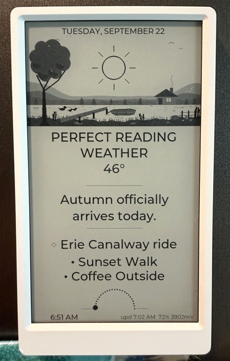

Step 6 — Design and test the screen
I arranged the grayscale illustration, date, headline, temperature, message, suggestions and sun or moon information into one full display frame.
Testing the physical device revealed a spacing problem between the local destination and the first suggestion. I adjusted the layout and checked the result on the board. This was a useful reminder that a desktop preview cannot fully reproduce the panel’s fonts and rendering.

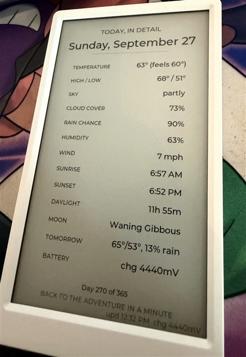

The side button also opens a detail card with weather, forecast, daylight and moon information.

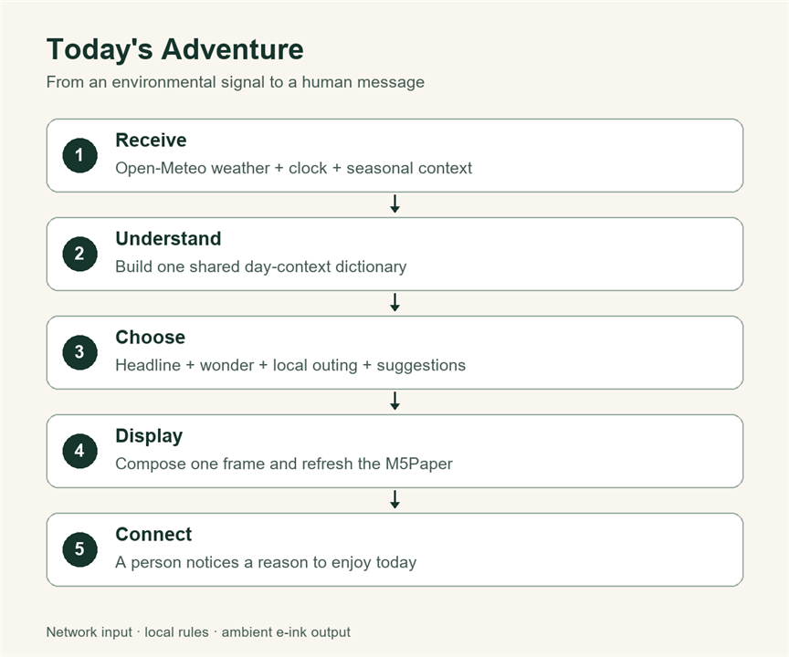

Making A Connection With Today!
Today’s Adventure receives environmental information over Wi-Fi and turns it into a visible message:
Weather data + time → local rules → e-ink message → person
Temperature, rain and daylight become an invitation such as “Open the windows today,” a local outing or an evening suggestion. Mounted on the fridge, the display communicates that message during every moment in the day.
That interpretation is the project’s connection to the theme: the electronics receive information, give it context and communicate something a person can act on.

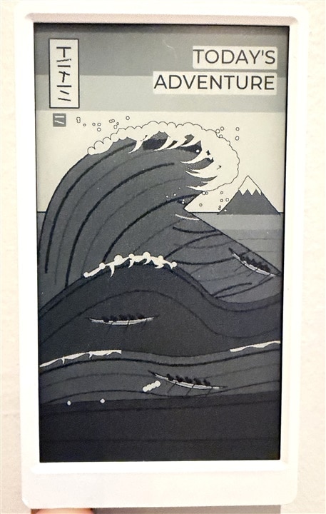

At a reported 100% battery, the display shows the wave artwork like shown at the beginning of this post. Below full charge, the next render returns to the adventure screen.
