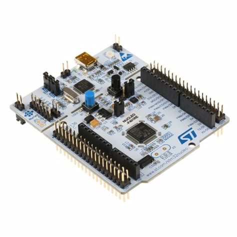

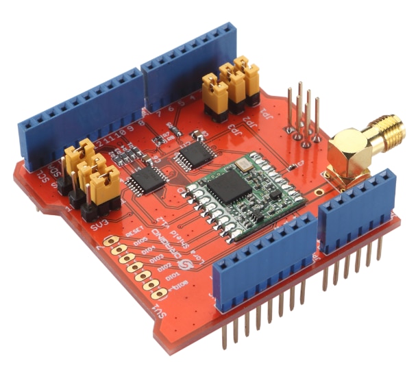

The transmission system consists of an STM Nucleo-F401RE board and a LoRa shield; I have also included a tank level monitoring setup using an ultrasonic sensor, though I have not yet calibrated or tested it.
STM Nucleo-F401RE  Buy Now
Dragino Long Range Shield
Ultrasonic distance sensor:  Buy Now
The two boards are located a few kilometers apart and there is optical visibility between Station0 and Station1.
The aim of the project is to receive data from Station1, located on agricultural land, and decide whether to open irrigation water and for how long. This project was born from a real need that I have, given that, in recent years, the temperature in summer has increased and the rains are very rare, I wanted to create a system that uses a tank to irrigate, when necessary, the younger plants which, in the absence of an extensive root system, would suffer too much from drought.
The tank has a fill valve, used to fill it with water, and a drain valve that activates when I want to water plants. At the moment I am only dealing with the remote control of the pumps, without evaluating the soil humidity, but, once the project is completed, adding such a functionality and making it absolutely automatic is a very trivial thing.
The two stations will exchange messages in the form of strings which, appropriately formatted, will allow me to send simple information from one device to the other.
Station1, at moment, is powered by a powerbank that is kept charged by a solar panel and a simple charge controller.

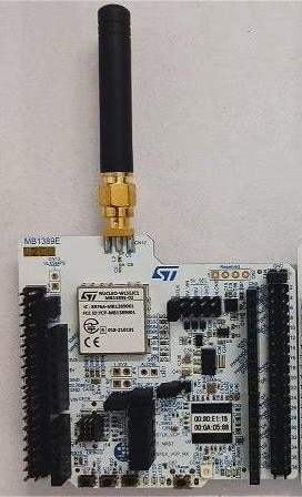

Station0
Station0 is the base station that collects remote data and allows the user to send commands to Station1 (tank filling and tank emptying).
image   NUCLEO-WL55JC
Station0 receives packets from Station1, allowing the user to decide on the appropriate action.
Commands sent from Station0 to Station1 are handled via a packet formatted as a string with comma-separated fields. These fields are:
  • ACKNumber, matching the PacketNumber of the recently received packet;
  • OpenFillValve to fill the tank with water;
  • OpenDrainValve to empty the tank—and thus irrigate.
By using a PacketNumber and an ACK, we can ensure that the packets have reached their destination.

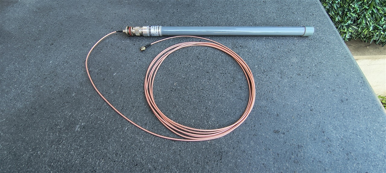

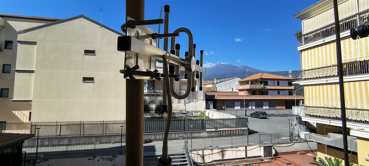

After countless attempts tweaking the parameters and configurations of the two boards I own, I realized that using high-quality antennas is crucial. While the small antennas mounted on the boards work fine for indoor testing, moving the boards even a few hundred meters apart causes the signal to degrade so much that communication becomes impossible. For anyone looking to build a real-world system covering several kilometers, I recommend choosing good antennas—either omnidirectional or directional, depending on the specific application. High-quality antennas and cables are essential for the system to function properly. Finally, it is important to ensure a clear line of sight between the two stations; buildings or other obstacles could attenuate the signal too much.
Omnidirectional Antenna
Directional Antenna (Mount Etna in the background)

    redcharly 1 month ago in reply to dougw +1
    I have tested the communication many times and found that LoRa works well when there are no obstacles between the transmitter and receiver. For instance, I conducted tests between Fondachello and S. Venera…
  • redcharly
    I have tested the communication many times and found that LoRa works well when there are no obstacles between the transmitter and receiver. For instance, I conducted tests between Fondachello and S. Venera (4.46 km), where my young plants—which need a lot of water—are located!
    Another successful experiment was the link between Giarre and S. Alfio (4.65 km); while in S. Alfio, I was in my car and used the small antenna (5 cm) on the Dragino shield, receiving the signal perfectly.
    In the coming days, I will try to establish a connection between Giarre and Fornazzo (7 km); I’ll let you know soon if it works.
