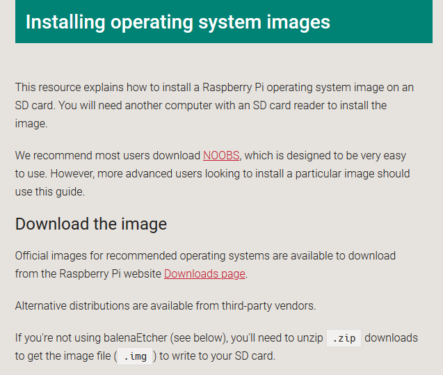

First start my flashing Raspbian on an SD card (16GB recommended). A wonderful guide is here: https://www.raspberrypi.org/documentation/installation/installing-images/
Note: Please install buster for RPi 4 otherwise Raspbian for other boards

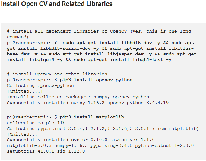

Now we need to install some Libraries:
commands in gist below>>>image

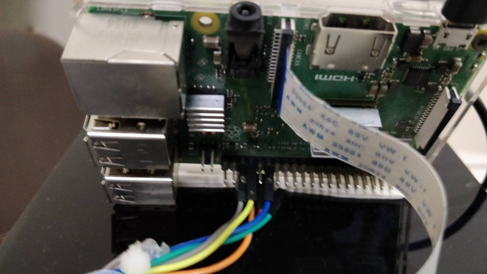

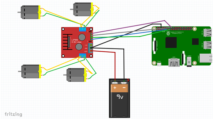

Step3: Connections

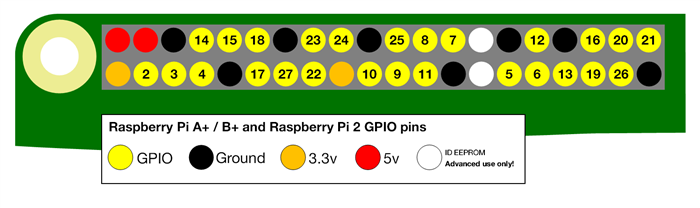

This is the basic schematic but you can change the pin connections to the Raspberry Pi according to your wish. But remember to change it in the code.
You can replace a 9V battery with a LiPo (preferably for 4WD) as L298N have input voltage upto 20V easily.
Also you can directly connect the 5V out from the motor driver to RPi but I would not recommend it as it fluctuates and can harm your Pi.
I have used the pins 5,12,13,19 to connect pins IN1,IN2,IN3,IN4 of the motor driver.
Make sure to not connect any high voltage source directly to your Pi as it will kill it!

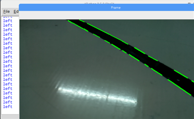

Now we start with Image Processing.
First we convert all pixels to GrayScale
then we 'Smoothen the Images"
and use "Canny Edge Detection" to bring out the borders between the objects
And ultimately we use Hough Line Transformation basically identifies shapes and lines.
The explanation of these are greatly explained here:
Gaussian Blur - Smoothening of image
opencv tutorial and explanation on Hough Line Transformation Hough Tranformation is a really good tool and very usefull.
The Hough Transform: The Basics - AI Shack
Canny Edge detection Tutorial and explaination

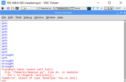

Explaining the turn decision:

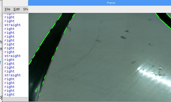

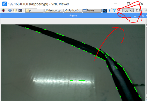

After drawing the lines we map out the distance as vectors and and measure their angles from horizontal. Its a very interesting technique. We add all the measured angles and predict the path of the lane.
As you can see in this image that most of the lines are drawn <Pi/2 so it return the value as right.
Even in this diffult scenarios when one lane is only visible because it measures the angles it can tell to go left which is correct
Note: the angle measured is in Radians not in degrees.

First we declarte the threshold that we want I found 6 to be a good spot thoug 6.4 was best suited for me.
We check if the sum of angles (the length of line is also taken into consideration while measuring the angle) was greater than threshold so when it detected lines more that 90 degrees it says to go right. The GPIO output is done accordingly.
If it is lesser tha -6 that means it is in dfferent quadrant we know that it is because more lines are bend towards left.
Similarly for Straight going but you may have to change the threshold to make it go perfectly.
The we show the lines on the image as output and check if 'q' is pressed to quit and then the llop above goes on.

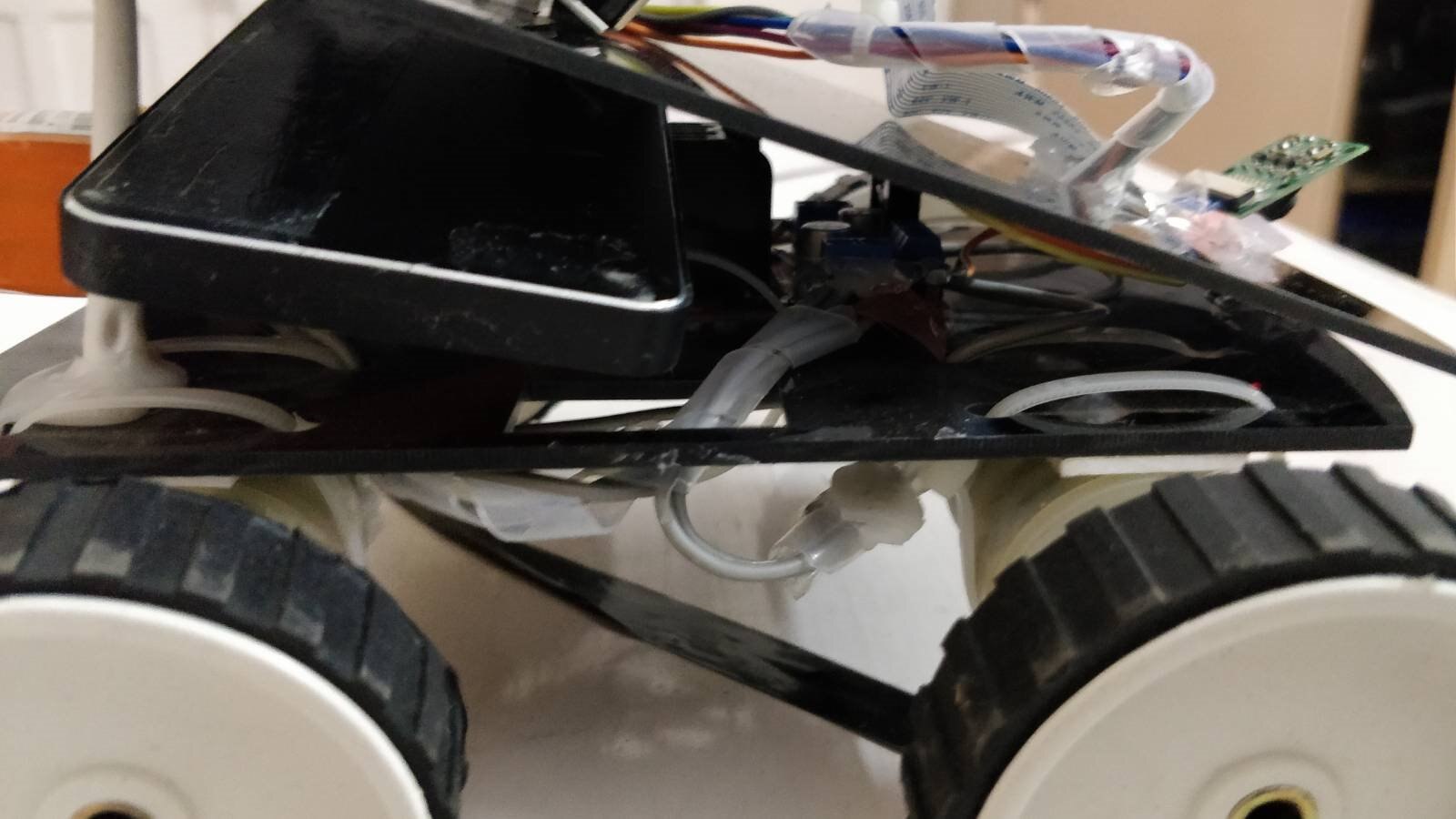

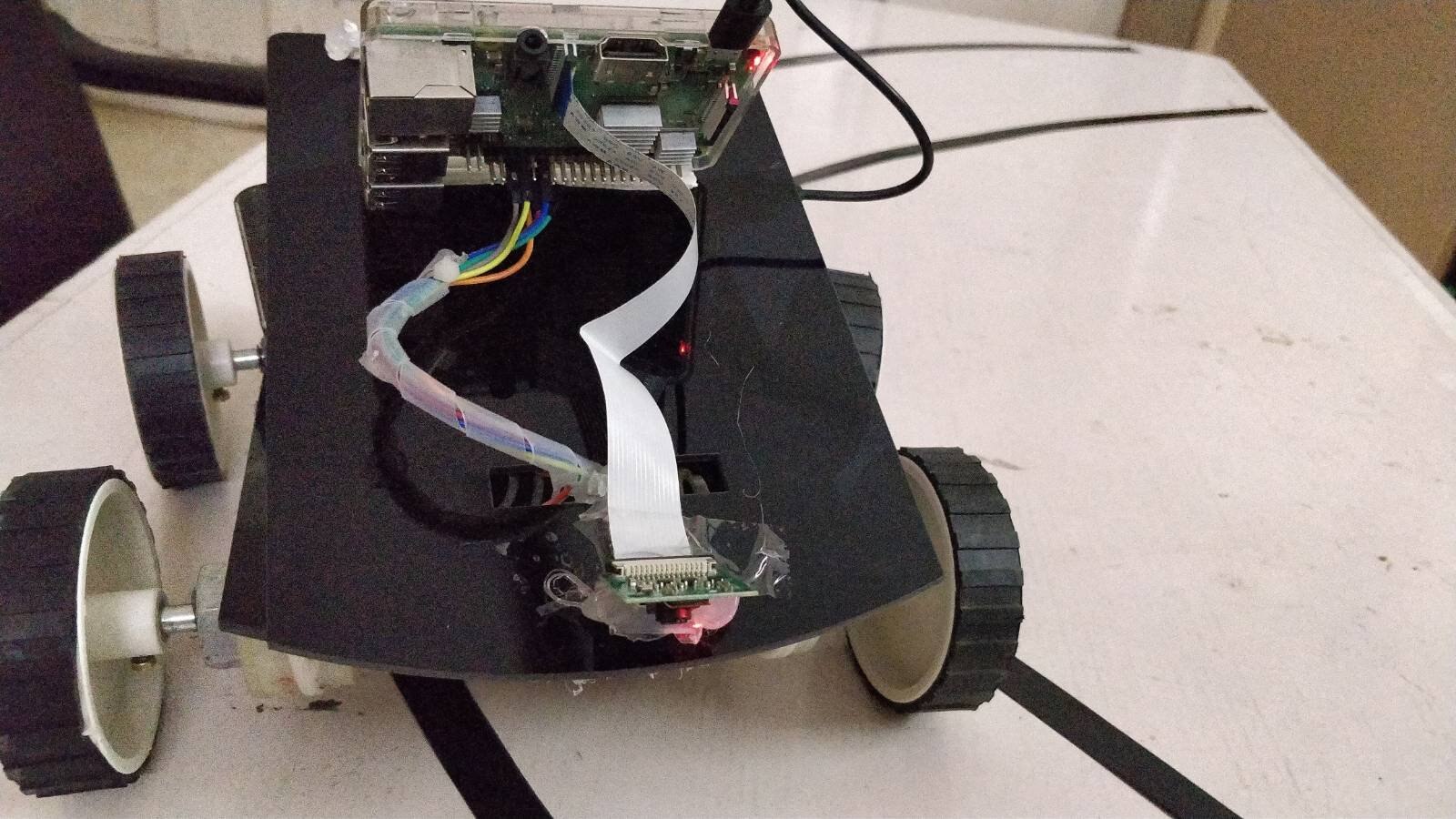

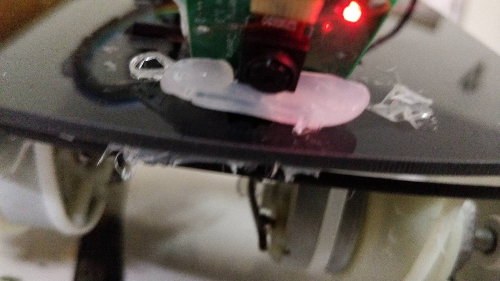

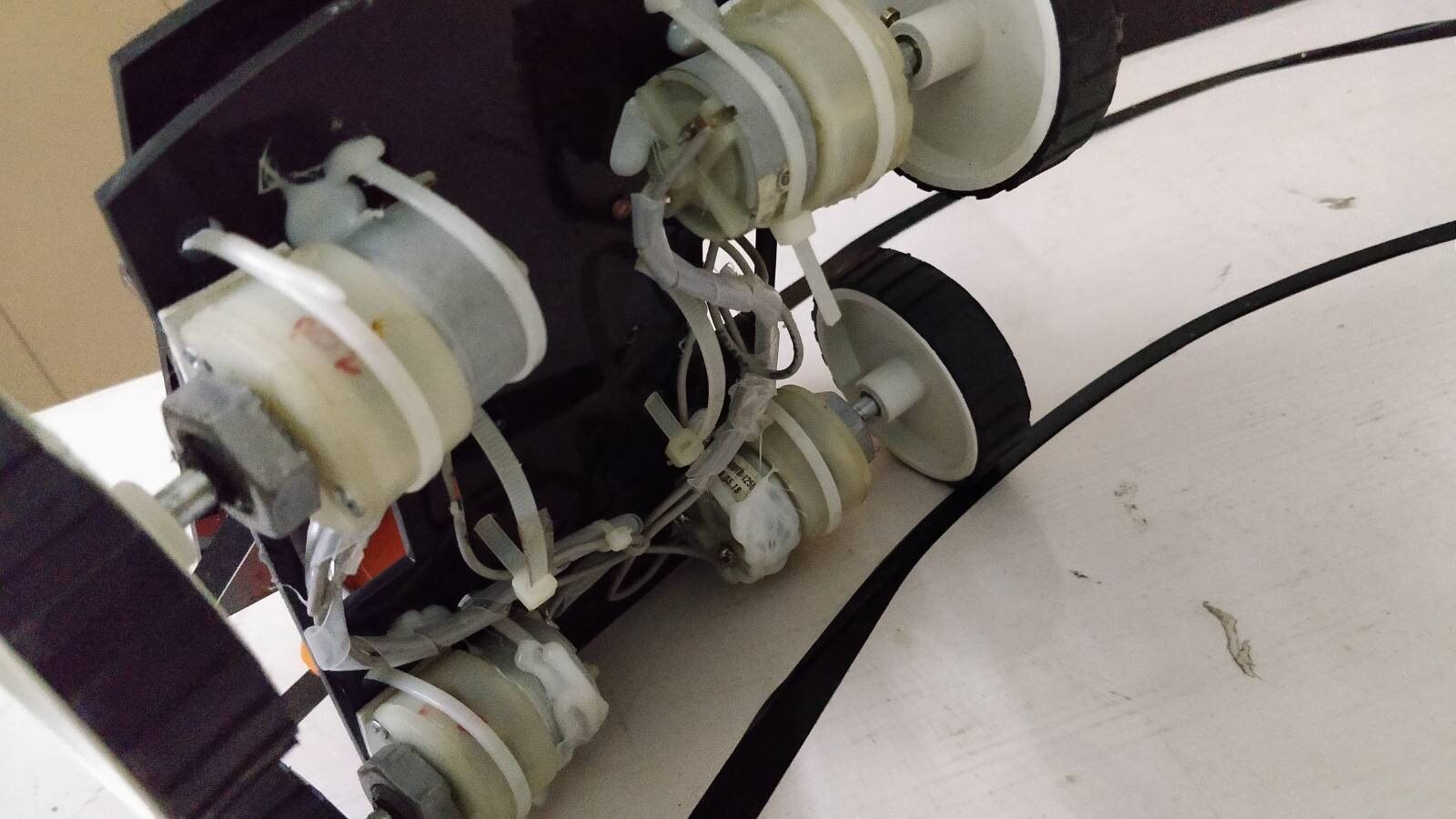

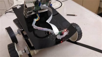

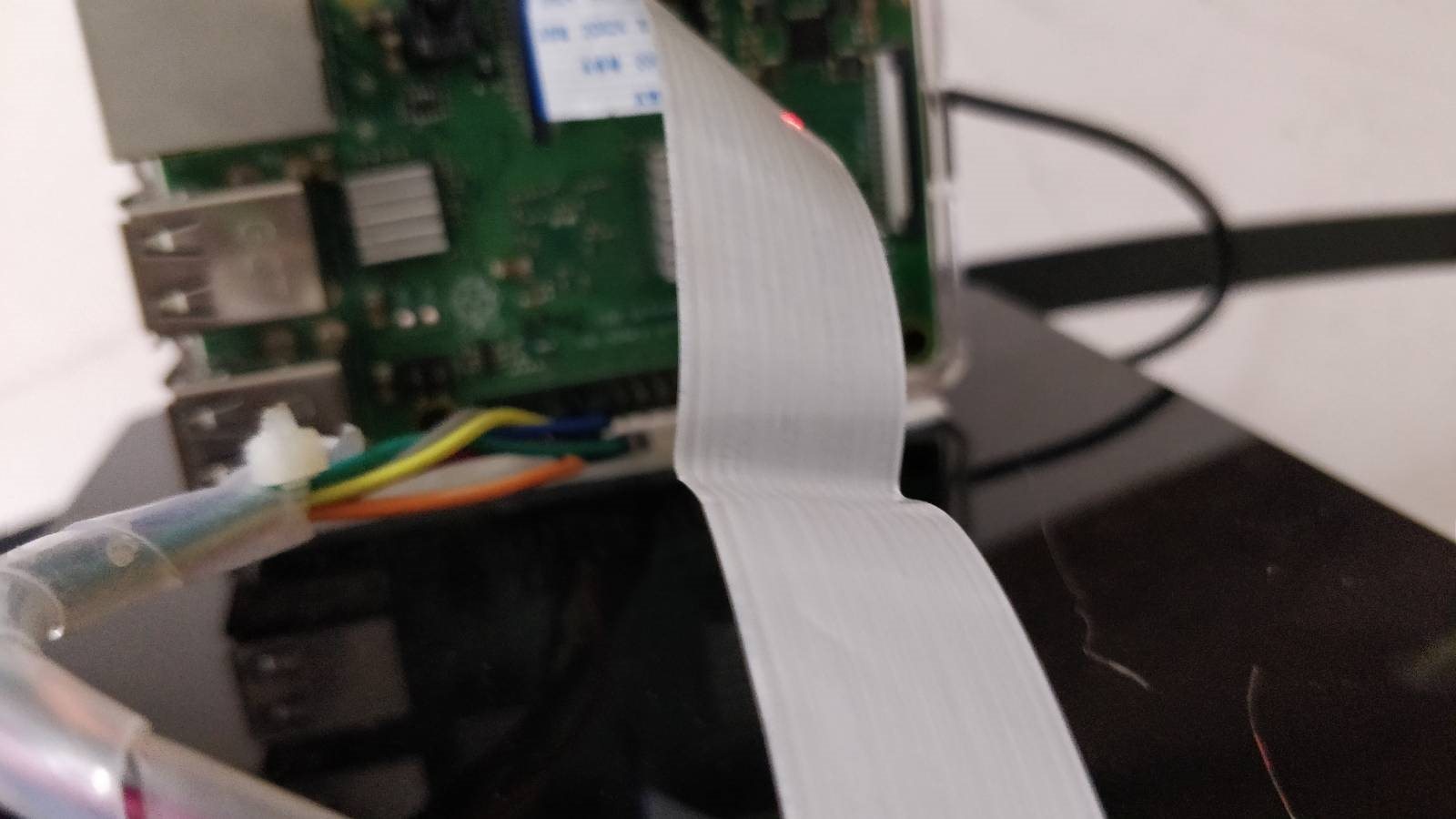

{gallery} My Robot
Robot side view
Robot front view
Camera modeule
Raspberry Pi showing connections
Robot bottom view: Messy wiring

Overall I was very happy with the project even though it didn't perform extraordinary in navigating lanes.
Checkout the video if not yet.
But I had made the project in just 4 hours so I would call it a day.
I would like to add a better navigation by training a custom model and then predicting the path ahead. But that is for another day.
The next thing I learnt was that robot was too fast in moving and so the frame would freeze and it wouldn't detect any line and give error for no line detected and stop there. So it is better to create a new function and then use PWM signals to control the speed of the motors.
I would love to use more of OpenCV's inbuilt features to just use Image processing to navigate because once we involve training a model and then Deep Learning Implementation that is very heavy for the Pi.
Here you can see that even when the SBC is making critical decisions the CPU usage is not much and it stays cool.image
