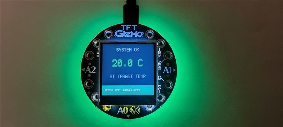

I made this prototype for an Open University Interaction Design course using a Circuit Playground Bluefruit, an all-in-one micro-controller development board, with a built-in ring of neopixels. It was my first foray into working with micro-controllers and neopixels, so although it's not very electronics-y I thought I would share, especially with where I got stuck and could use some advice!

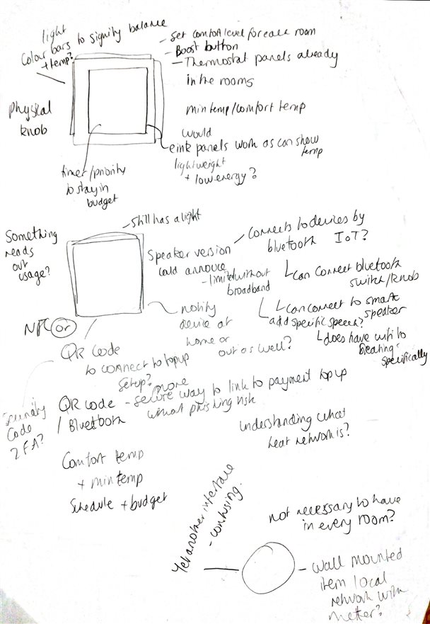

Sketches and notes of ideas
Looking at the users needs and barriers around thermostats being complicated and confusing I decided I wanted to make something that would reassure the user and help them understand what was happening with their heating and reduce stress, Making use of ambient lighting seemed to be a good way to achieve this. Initially I found a bluetooth controlled lighting strips, but it wasn't customisable enough to test and then I found NeoPixel strips and microcontrollers and I got a bit confused. When I saw the Circuit playground Bluefruit and saw that it uses Python I felt more confident I could make some with actual lights. There was a TFT screen with attachments ready to screw on as well, which meant I could even have a small screen in my prototype, which I hadn't considered would be possible when I started.

Then I followed the instructions to set it up to run CircuitPython, using an IDE called MU. A big challenge was working out what libraries I needed. The LED.animation library was great, most of the LED effects I wanted to set up I just needed to call a function from the library and adjust colours and timings and there were a couple that I made more manually. I experience migraines so one of the first things I worked out was how to reduce the brightness of the LEDs cp.pixels.brightness = 0.2 worked well for me. Another important thing I learned as a beginner was to use monotropic, which has to be set at the beginning, so that stopping the NeoPixels to animate them doesn't pause everything running.
My orginal plan was to use pictures for the screen designs and load them on, but I didn't account for the limited storage on the Circuit Playground Bluefruit, so I to make the screens in code. I used Google Gemini to help me make template to match my screen layouts and then was able to call the templates as a function with the content. This was actually so cool to use and prototype with, because I can so quickly adjust and change content or have different versions, so I think I will use this approach for other things too.
One issue I found really irritating and haven't managed to resolve is the capacitive touch buttons on the front beside the screen are not very consistent or easy to use and I spent quite a lot of time trying to work out how make and add some form of buttons to the front to fit the form factor, but I got confused and overwhelmed with deadlines looming. Would love any suggestions of how I can learn more about how to do this as it's pretty important!

  • beacon_dave
    beacon_dave 2 months ago in reply to beacon_dave
    Looks like there are already two JST 3-PH connectors on the rear of the TFT Gizmo for sensors, so you could just attach a couple of momentary push buttons at the side (similar to a digital watch). Looks like they are connected to GPIO pins A1 and A2.
    https://learn.adafruit.com/adafruit-tft-gizmo/pinouts
    Alternatively you could 3D print a round bezel that fits snug over the front of the TFT Gizmo, with rectangular window opening for the display. You could then incorporate a couple of tact switches into the front of the bezel and wire them back to the JST 3-PH connectors on the rear. This could then be tied in with a wall mounting back plate which doubles as a diffuser for the NeoPixels.
  • beacon_dave
    It looks like the touch pad sensitivity is set based on an offset to the raw_value reading when the TouchIn object is created.
    If you are powering up when holding the device in different positions, then this could alter the initial threshold setting.
    If you haven't already done so, you may want to check the threshold value that has been set to see if it is consistent or not.
    You could over-ride it so that you get the same setting every time.
    https://docs.circuitpython.org/en/latest/shared-bindings/touchio/
