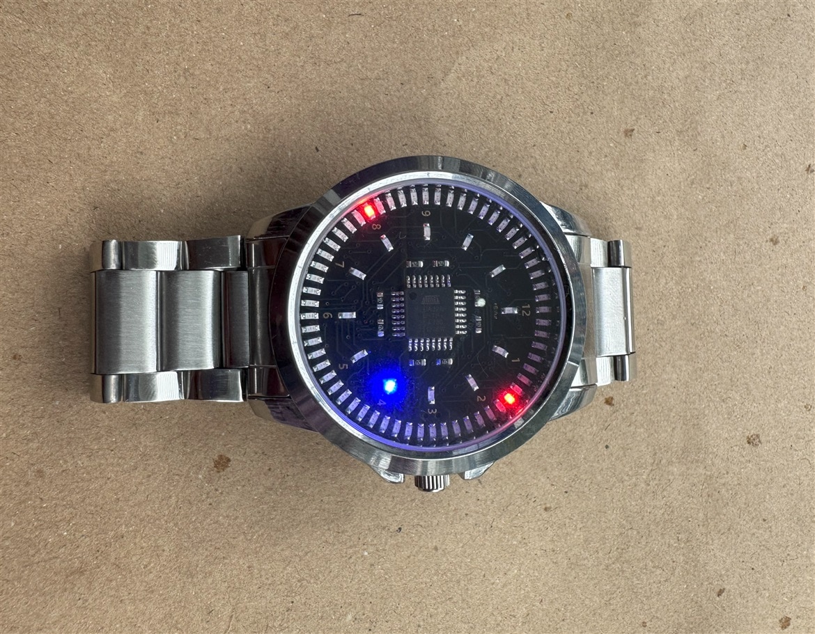

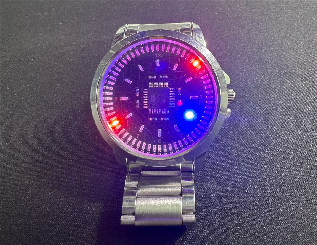

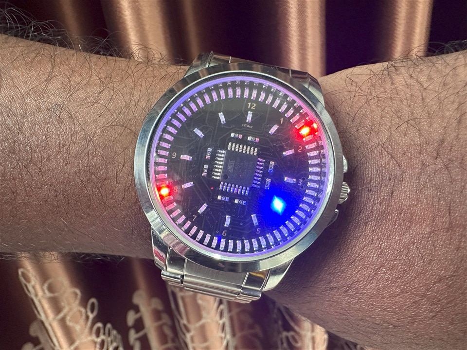

LumiDial is a custom-built wristwatch that blends classic analog style with modern LED technology. Instead of using physical hands, it uses 72 SMD LEDs arranged in a circular layout — 60 LEDs to indicate seconds and minutes, and 12 LEDs to mark the hours. At its heart lies an ATmega328 microcontroller, programmed to control the precise timing and LED animation that mimic the smooth motion of a traditional analog clock.
I designed the PCB myself, had it fabricated and assembled by JLCPCB, and then fitted it neatly inside a ready-made stainless steel watch case. The result is a unique fusion of electronics, design, and craftsmanship — a wearable piece of engineering art that glows with precision and creativity.
In this project, I’ll walk you through the entire process — from circuit design and PCB layout to assembly, programming, and enclosure — so you can build your own version of LumiDial or use the idea as inspiration for your next DIY electronics project.

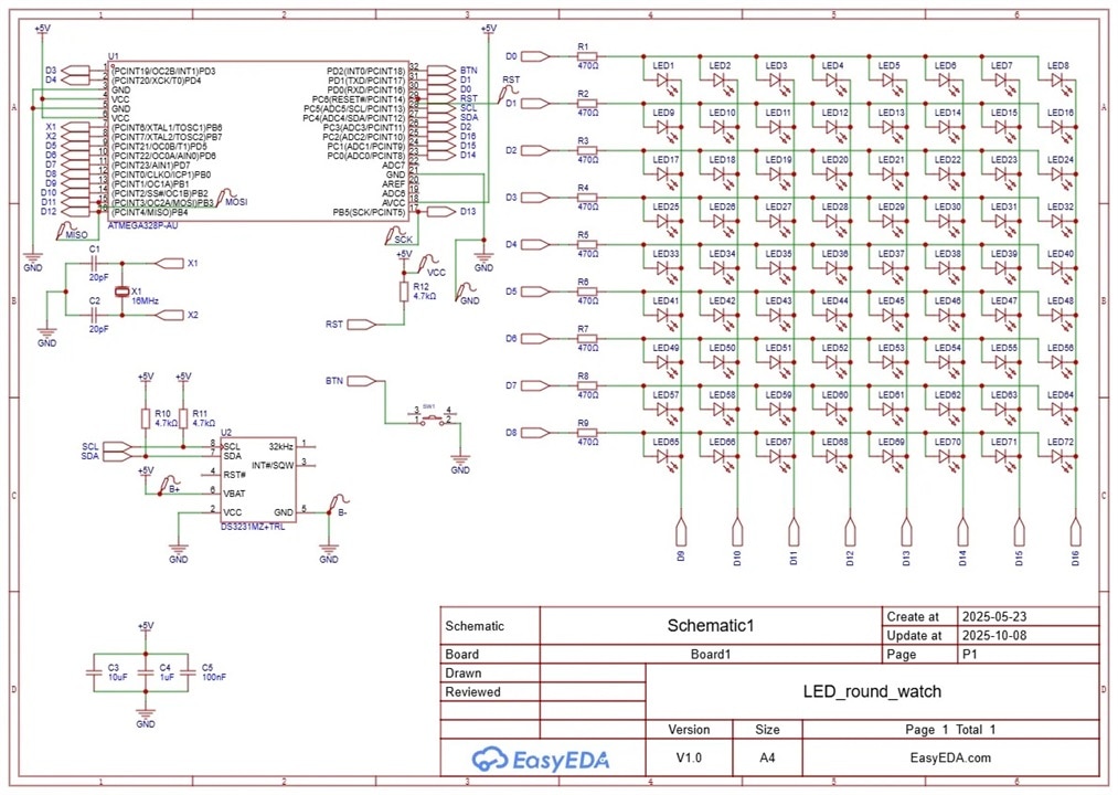

I designed the schematic for LumiDial using EasyEDA, and the complete circuit diagram is shown in the image above.
At the heart of the circuit is an ATmega328P SMD microcontroller, which acts as the brain of the watch. It controls all 72 LEDs, communicates with the RTC, and handles user input through a single button.
Real-Time Clock (RTC)
For precise timekeeping, I used the DS3231MZ+ SMD real-time clock module. It’s connected to the ATmega328P via the default I²C pins (SDA and SCL). Two 4.7kΩ pull-up resistors are added on these lines to ensure reliable I²C communication. The DS3231 provides highly accurate time information, even when the main circuit is powered off (with a backup battery if added).
LED Matrix Display
The 72 SMD LEDs are arranged in a matrix configuration to minimize pin usage:
  1. The common anodes of the LEDs are grouped into 9 lines and connected to digital pins D0 to D8 of the microcontroller, each through a 470Ω current-limiting resistor.
  2. The common cathodes are grouped into 8 lines and connected to pins D9 to D16.
This matrix setup allows the ATmega328P to control all 72 LEDs efficiently using multiplexing. Out of these, 12 blue LEDs represent the hour markers, and 60 red LEDs represent the seconds and minutes.
Time Adjustment Button
A single SMD push button is connected to the INT1 pin of the ATmega328P. It’s used to adjust or set the time manually. When pressed, it triggers an interrupt that puts the microcontroller into time-setting mode.
Clock Crystal & Capacitors
To keep the ATmega328P running precisely, a 16 MHz SMD crystal is connected to its XTAL1 and XTAL2 pins, along with two 20 pF capacitors to ground.
For stable power delivery, I added three decoupling capacitors:
  1. 10 µF electrolytic capacitor for bulk filtering
  2. 1 µF ceramic capacitor for mid-frequency noise
  3. 100 nF ceramic capacitor close to the IC for high-frequency noise suppression
These capacitors help keep the circuit stable and reduce fluctuations in the power supply, especially important when driving many LEDs simultaneously.
Power and Stability
The entire circuit is powered directly from a 3.7 V, 150 mAh Li-ion battery.
This compact battery provides enough capacity for more than one full day. The ATmega328P and DS3231 both operate reliably at this voltage, and the LEDs are bright enough at 3.7 V without the need for a separate voltage regulator.
For safety and consistent performance, a small decoupling capacitor across the battery terminals helps absorb voltage dips when many LEDs switch simultaneously.

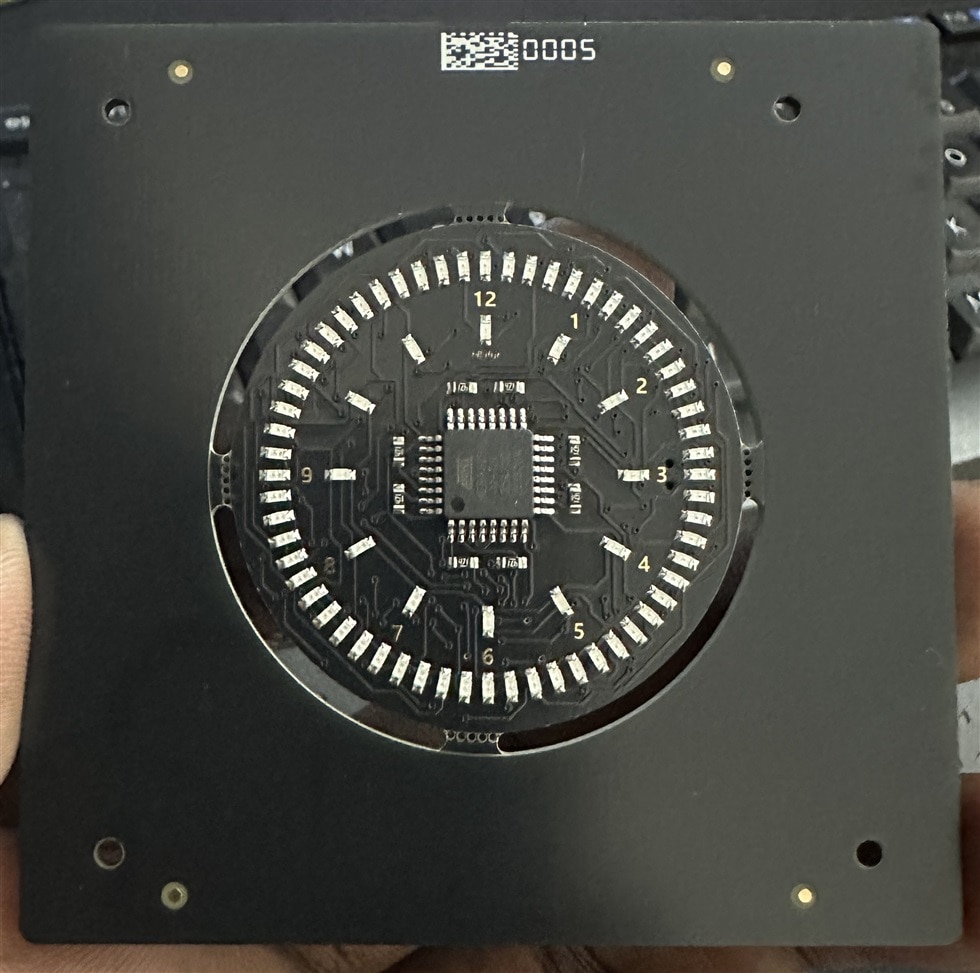

PCB Design

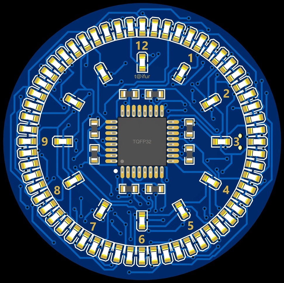

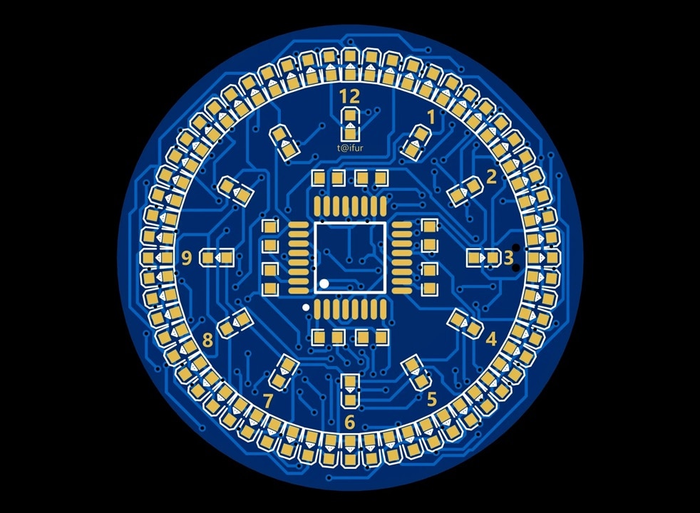

After completing the schematic, I designed a custom PCB for LumiDial in EasyEDA, focusing not only on functionality but also on aesthetic beauty and symmetry, since this is a wristwatch meant to look as elegant as it performs.
Aesthetic Layout

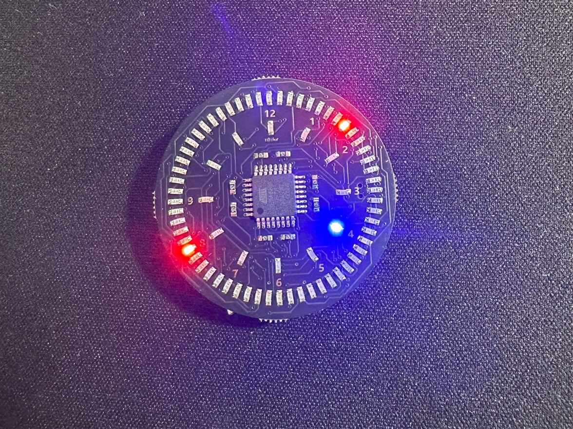

To achieve a clean and balanced appearance, I placed the ATmega328P microcontroller at the exact center of the PCB.
Surrounding it, I arranged:
  1. 12 blue LEDs in an inner circle to indicate the hours
  2. 60 red LEDs in an outer circle to display the minutes and seconds
This layout gives the watch a true analog-style dial look — glowing rings of light that represent time in a dynamic yet minimal way.
For an extra touch of elegance, I added gold-finish (ENIG) hour markings directly on the PCB silkscreen. These golden labels make the board look premium and help visually identify each hour position.
Component Placement

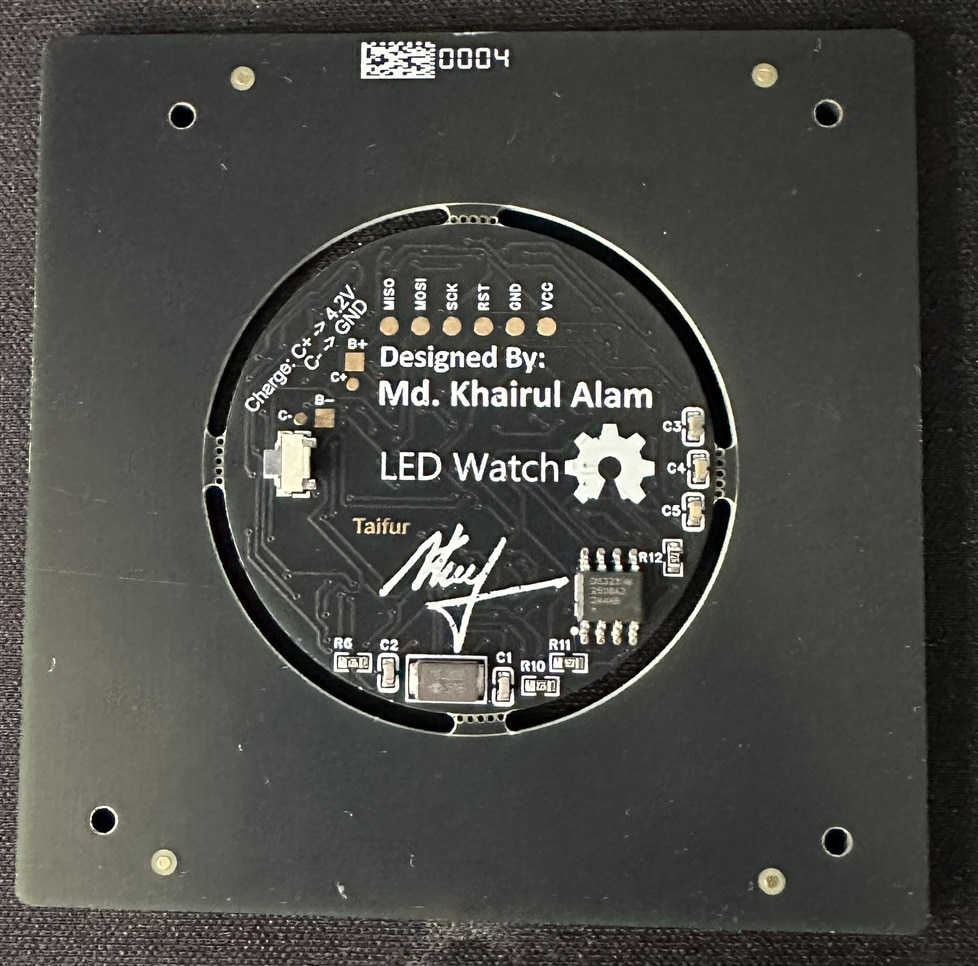

To keep the top surface neat and LED-focused, I placed all other components on the bottom side of the PCB.
This includes:
  1. DS3231MZ+ RTC
  2. 16 MHz crystal and capacitors
  3. 10 µF, 1 µF, and 100 nF capacitors
  4. The SMD button switch
  5. Power input pads
By keeping the support circuitry underneath, the top face of the watch remains sleek and symmetrical — ideal for display and photography

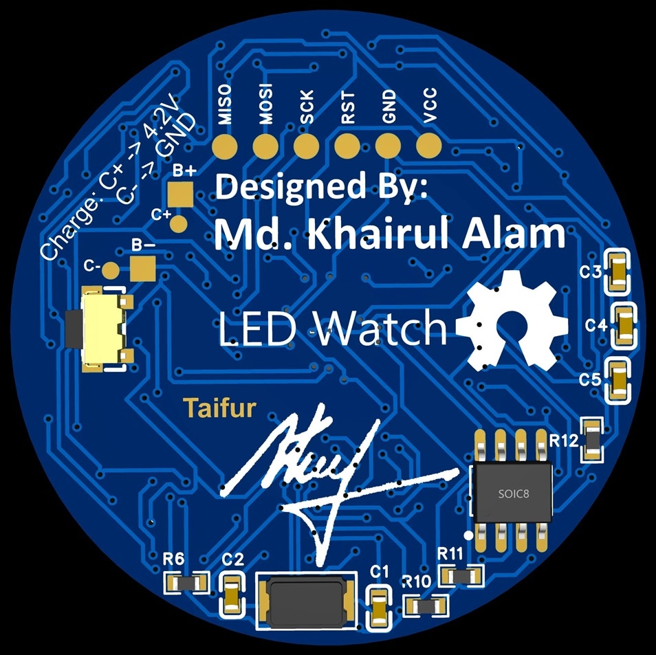

Current-Limiting Resistors
I used eight 470 Ω SMD resistors to limit current through the LEDs.
These resistors are arranged in a square pattern around the central MCU, not only for electrical convenience but also to maintain the geometric harmony of the design.

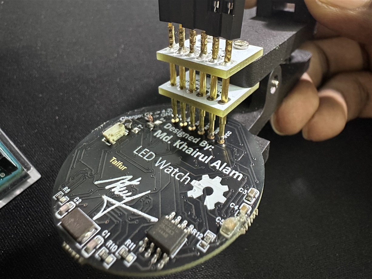

Programming Interface
To program the ATmega328P directly on the board, I included a 6-pin gold-plated programming pad on the PCB’s bottom side.
The pins are arranged in a 2.54 mm spaced row with the following connections:
  1. MISO
  2. MOSI
  3. SCK
  4. RST
  5. GND
  6. VCC
Instead of using a bulky header, these pads are designed for a pogo pin clip, allowing quick and reliable connections for uploading code or updating firmware without affecting the watch’s compact form factor.
Final Touches
The PCB was designed as a two-layer board to maintain routing clarity and reduce interference between LED rows and columns.
Special care was taken to keep all traces symmetrical and evenly spaced to match the visual flow of the LED rings.
Once the layout was finalized, I generated Gerber files and ordered the board with a matte black solder mask and ENIG gold finish, which gives the LumiDial a professional and luxurious look.
PCB Assembly and Soldering
To make the assembly process fast, precise, and professional, I used JLCPCB’s SMT Assembly Service for the LumiDial watch.
After finalizing the PCB layout and generating the Gerber, BOM, and Pick & Place files from EasyEDA, I directly uploaded them to JLCPCB for fabrication and assembly.
JLCPCB Assembly Service
JLCPCB handled both PCB manufacturing and SMD component placement with excellent quality and precision.
They assembled all SMD parts including the ATmega328P microcontroller, DS3231MZ+ RTC, resistors, capacitors, crystal, and the SMD push button.
When I received the board, it was professionally assembled, clean, and completely functional — no missing components or misalignments.
The solder joints were shiny and perfect, and all components were positioned exactly as designed. The overall build quality exceeded expectations and gave the project a truly factory-made feel.

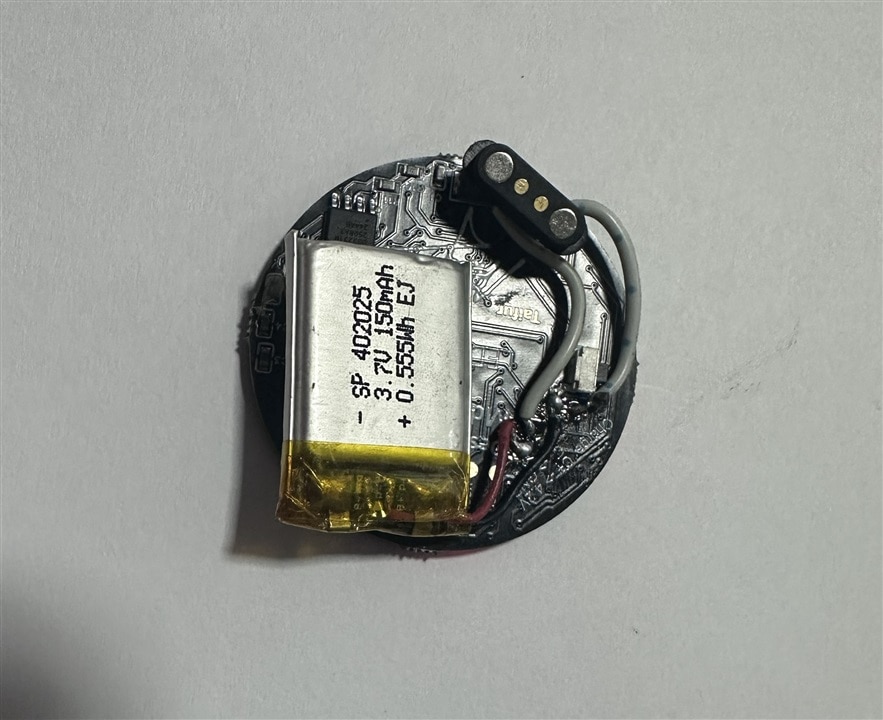

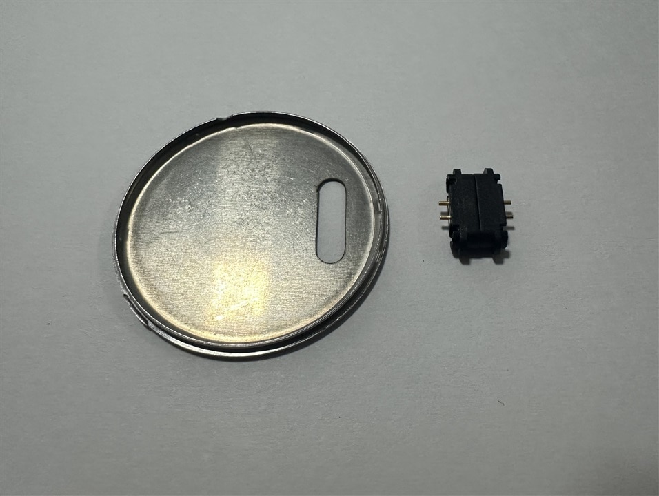

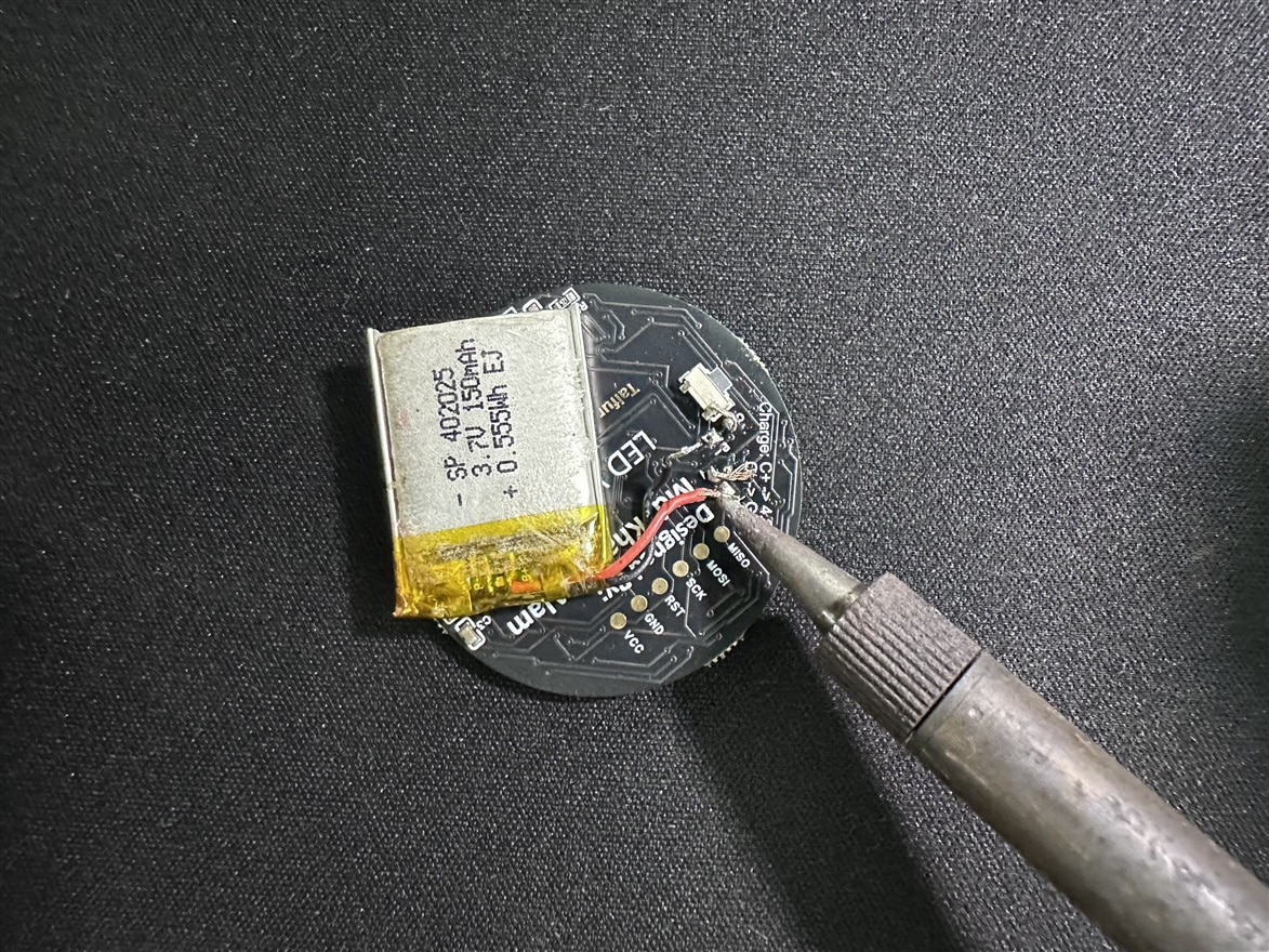

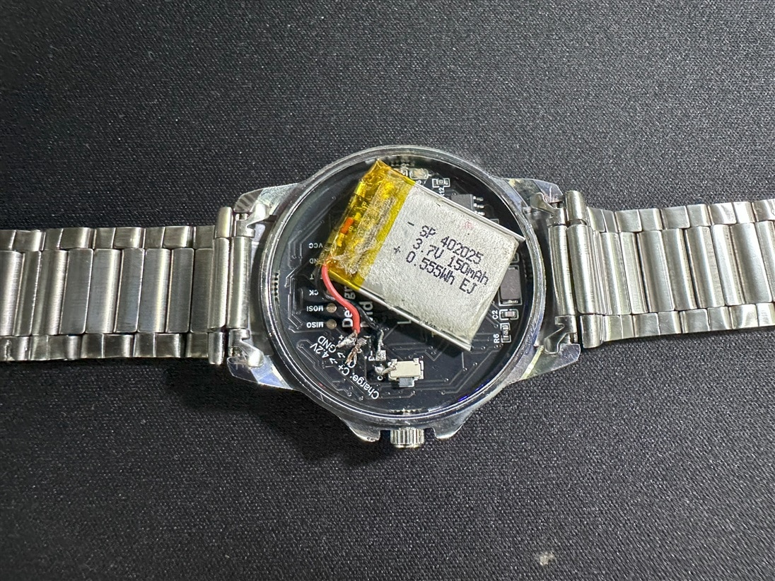

Manual Soldering

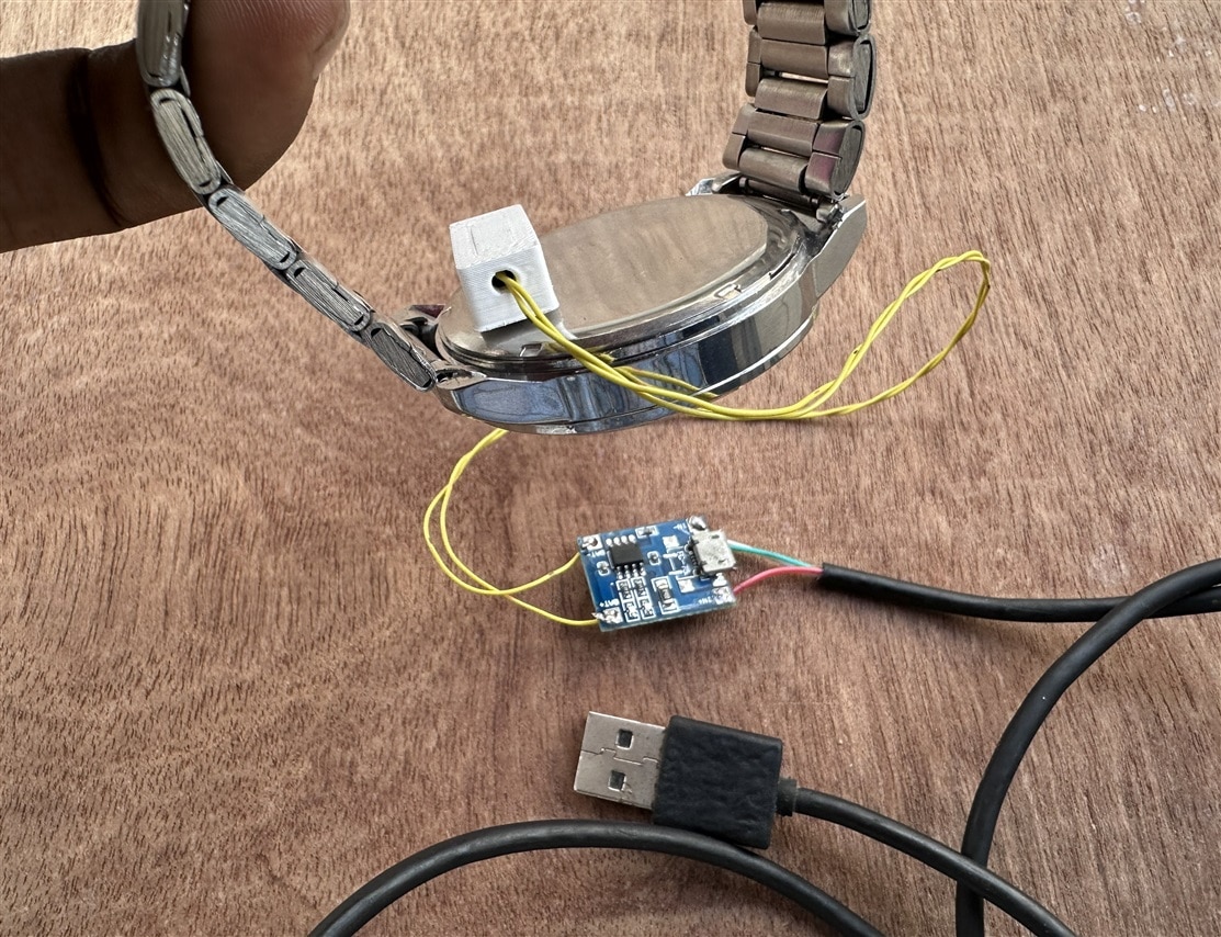

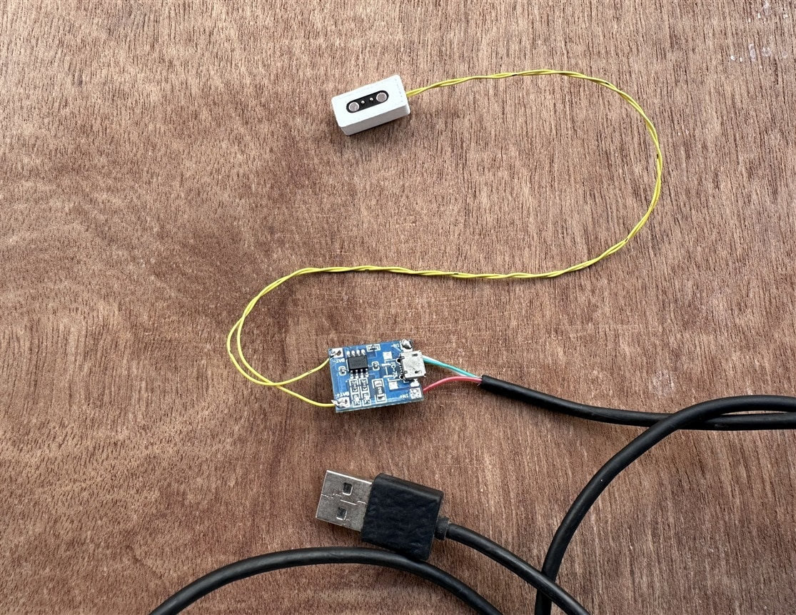

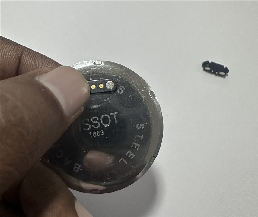

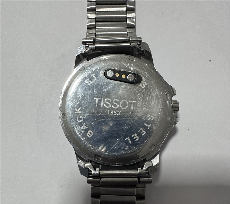

Since all SMD parts were already assembled by JLCPCB, I only had to solder a few external parts manually:
  1. The 3.7 V Li-ion battery (150 mAh)
  2. A 2-pin magnetic pogo pad for charging the battery
The magnetic charging connector makes it easy to recharge the watch without opening the case — just snap the magnetic cable onto the pads, and it starts charging.
I used a fine-tip soldering iron and low-temperature solder for these connections to avoid heat damage to the nearby components.
Final Check
After soldering, I carefully inspected all solder joints under a magnifier and cleaned the flux residue with isopropyl alcohol.
Then I connected a pogo pin programming clip to the gold pads on the bottom side of the board to upload the firmware. The watch powered up immediately, and all 72 LEDs lit up beautifully in the expected pattern.

Programming Setup
The six gold pads on the bottom of the PCB are arranged in a 2.54 mm spaced row, with the following pin order:
  1. MISO
  2. MOSI
  3. SCK
  4. RST
  5. GND
  6. VCC
These pads are actually an SPI programming header, which method works perfectly for boards without a USB interface and gives you full control over fuse settings and bootloader options through the MiniCore board package.
For quick connection, I used a magnetic pogo pin clip, which securely touches the gold pads and allows hassle-free uploading — no soldering or plugging required.

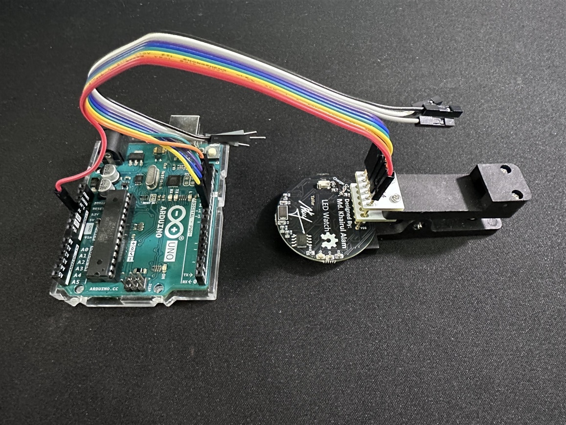

Set Up the Arduino UNO as an ISP Programmer
  1. Open the Arduino IDE.
  2. Go to File → Examples → 11.ArduinoISP → ArduinoISP.
  3. Select:
  4. Board: Arduino UNO
  5. Port: the COM port of your UNO
  6. Click Upload to load the ISP firmware onto the UNO.
  7.  After upload, your UNO is ready to act as an ISP programmer.
Connect the Arduino UNO to the LumiDial
LumiDial board has six gold-plated pads for SPI programming. Use the pogo-pin adapter to connect them to the Arduino UNO as follows:
LumiDial → Function → Arduino UNO Pin
VCC → Power (5V) → 5V
GND → Ground → GND
MOSI → Master Out Slave In → D11
MISO → Master In Slave Out → D12
SCK → Serial Clock → D13
RST → Reset → D10
Notes:
  1. Always connect GND between both boards.
  2. Make sure your LumiDial board voltage matches the UNO output (usually 5 V).
  3. You can use pogo pins or a small jig to make firm contact with the pads.

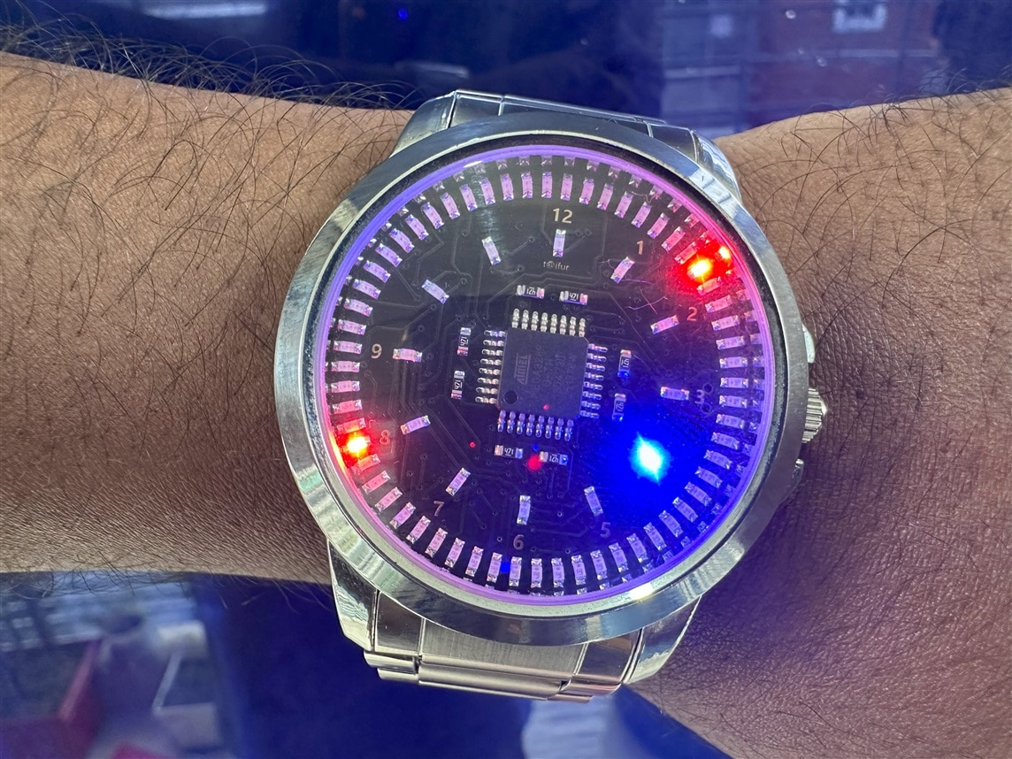

That’s it! Your LumiDial watch firmware is now programmed directly into the ATmega328P.
If everything is connected properly, the sketch will upload in a few seconds. Once done, the watch will automatically start running, displaying time using the red and blue LEDs.

Testing After Upload
After successful programming:
  1. The blue LEDs should light up at hour positions.
  2. The red LEDs will indicate the minute and second progression.
  3. Pressing the SMD button will enter time-adjustment mode (if implemented in your code).
You can easily tweak LED brightness, update the animation, or add power-saving modes by modifying the sketch.
Testing and Calibration
After programming the LumiDial watch, the next step is to test and calibrate the circuit to ensure everything is working perfectly — from LED operation to accurate timekeeping by the RTC.
This is the stage where the watch comes to life, showing its beautiful analog-style LED pattern for the first time.
Initial Power-On
After uploading the firmware and connecting the Li-ion battery, the watch powers on immediately.
If everything is working correctly:
  1. The blue LEDs will light up at the hour positions.
  2. The red LEDs will begin to move around the outer circle, representing the minutes and seconds.
If no LEDs light up, double-check the battery polarity and ensure the programming upload completed successfully.
LED Function Test
To verify the LED matrix wiring:
  1. Use a simple LED test sketch that lights each LED one by one.
  2. Observe whether all 72 LEDs illuminate properly.
  3. Check for any mismatched or dim LEDs — this can indicate reversed polarity, soldering issues, or a faulty resistor connection.
Thanks to the JLCPCB assembly, all SMD components are perfectly soldered, so most issues (if any) are usually related to LED placement or matrix mapping in the code.

Placing the PCB
After testing and calibration, I carefully placed the assembled PCB inside the 40 mm stainless steel watch case.
Make sure the LED side faces outward, properly aligned with the glass window of the case so that the LED rings are centered and evenly visible from the front.
The fit should be tight enough that the PCB stays in place without wobbling. If needed, a thin rubber or plastic ring can be used as an insulator between the PCB edge and the metal body.
Battery Connection
Next, I soldered the 3.7 V, 150 mAh Li-ion battery to the designated pads on the PCB.
Keep the battery wires short and neatly routed to avoid interference with the case closing.
Once connected, the circuit powers up, and the LED clock display activates inside the watch — giving the first complete preview of LumiDial in its final form.
Enabling Magnetic Charging
Magnetic Charging Connector Installation
For convenient recharging, I used a 2-pin magnetic charging connector that attaches externally to the back of the watch.
To integrate it cleanly with the metal case:
  1. I measured the exact outline of the magnetic connector on the back side of the stainless steel case.
  2. Using a laser cutter, I cut a precise opening according to those measurements.
  3. The magnetic connector was then inserted and fixed securely into the opening.
  4. Finally, I soldered its two contact pins to the battery pads on the PCB, ensuring proper polarity.
This setup allows the watch to be charged externally — just by snapping the magnetic cable onto the back of the case — without opening it or disconnecting the battery.
Final Fit and Finish
After all connections were made:
  1. I cleaned the inside of the glass cover to remove dust or fingerprints.
  2. I closed the back cover carefully, ensuring the magnetic connector sat flush with the steel surface.
  3. The result is a compact, professional-looking wristwatch that blends handcrafted electronics with a real watch body.
When powered on, the red and blue LEDs glow through the front glass in a beautiful analog-style pattern — turning LumiDial into a functional, stylish piece of wearable tech.
Preparing the Charger
I built a custom two-pin magnetic pogo connector combined with a TP4056 charging module. To make it look neat and durable, I designed a small protective enclosure in Tinkercad and 3D-printed it. The enclosure holds the pogo pins firmly in place and aligns them perfectly with the charging pads on the watch. It also provides a clean finish and protects the solder joints from bending or shorting. Inside the case, I connected the pogo pins to the TP4056 module using thin flexible wires, ensuring correct polarity between the BAT+ and BAT– terminals. After assembling, I sealed the connector in the 3D-printed shell, giving it a compact and professional appearance. Now, whenever I need to charge the watch, I simply snap the magnetic connector onto the back, and the watch begins charging instantly with the TP4056 LED showing the charging status.
Final Demonstration
After completing all the assembly steps, LumiDial finally came to life — glowing elegantly through the glass window of the stainless steel case.
The result is a fully functional, analog-style LED wristwatch that combines precision electronics, aesthetic design, and wearable craftsmanship in one compact build.
The Final Look
When powered on, the 12 blue LEDs illuminate the hour positions, while the 60 red LEDs around the outer ring display the minutes and seconds.
The LEDs form a clean, circular analog clock layout, with smooth transitions that mimic the motion of traditional watch hands — but in a vibrant, modern form.
Thanks to the matte-black PCB, gold-finished markings, and stainless steel body, the final appearance is both minimal and luxurious.
The symmetry of the layout — with the ATmega328P at the center and resistor squares around it — makes the whole dial look balanced and artistic, even when the LEDs are off.
