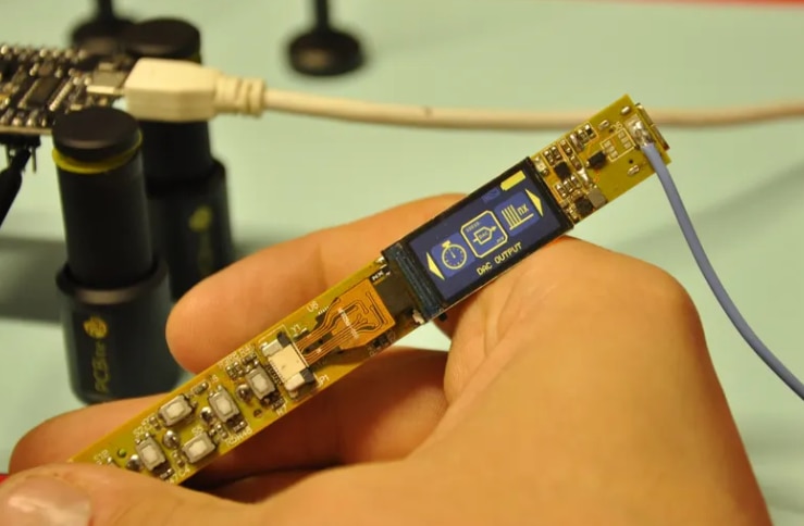

I would like to proudly present my battery-powered, RP2040-based handheld with a color screen and four reconfigurable test probes that measures voltage, resistance, frequency, and logic signals — and can just as easily generate PWM, drive servos, sniff UART, or push out NeoPixel data, all from one device with a live PC companion app.

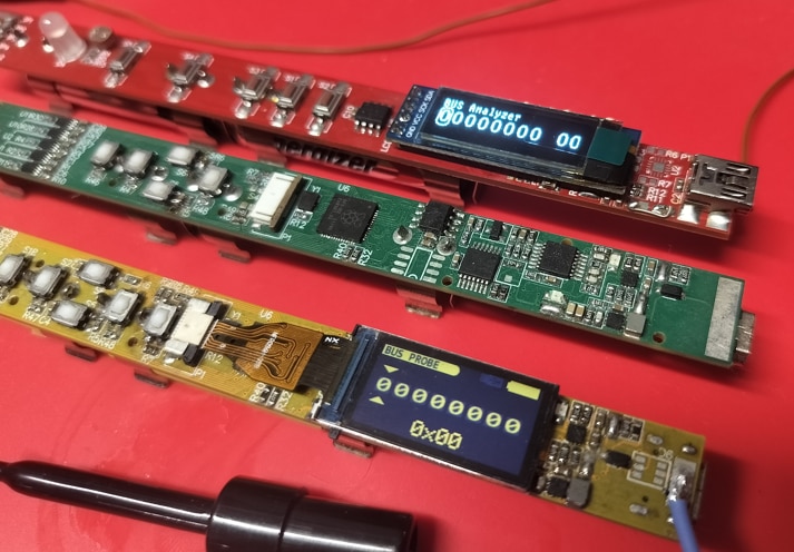

Diagno actually started as a much simpler idea before the bus-probe requirement pushed it further: one probe, one dumb little box. The first prototype — Red — ran on an AVR chip in the Arduino IDE with a single test needle multiplexed between input and output depending on the mode: H/L logic read, bus read, square-wave measurement, PWM, servo signal, DC voltage, battery level. It worked, but it made the limits obvious fast: one shared probe meant constantly rewiring what you were probing, and a single needle could never really watch or drive a whole bus at once.

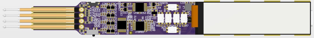

That pushed the redesign: Green swapped the AVR for an RP2040, added a color TFT, and — the actual point of the whole project — four independent test needles routed through an analog switch matrix, so firmware can reassign any needle to whatever the active tool needs: analog in, digital in, digital out, or PWM. That's what makes bit-probing a whole bus at once possible. Green's display just came out mirrored on the board, so Yellow is the fix for that: same RP2040/four-probe hardware, corrected display orientation, and a switch to USB-C. Yellow is the main character of this post — hardware's done, firmware is most of the way through the full feature set, and it's about to come back from fab as a real assembled board instead of another hand-soldered prototype.

Hardware Notes (Diagno V1 - Yellow)
  • RP2040 microcontroller (Raspberry Pi Pico family), built with the Pico SDK in VS Code
  • Color ST7735 TFT display for on-device menus, icons, and live readings — FPC connector orientation corrected from Green's mirrored panel
  • Five-button pad (up / down / select / back, plus a side button) for one-handed menu navigation
  • Four test-needle probes, muxed through analog switches so each one can become whatever the active feature needs
  • USB-C for charging and the Sidekick serial link, running off 2x NiMH cells with charge-status sensing, so it's untethered on the bench
What's Next — Purple
Yellow's actual job starts now: it's the tool I'll be using to bring up and debug the 8-bit computer build, bus probe and all. I'll be documenting that build extensively so expect to see Diagno on screen catching timing issues on the address/data bus as the computer comes together.
