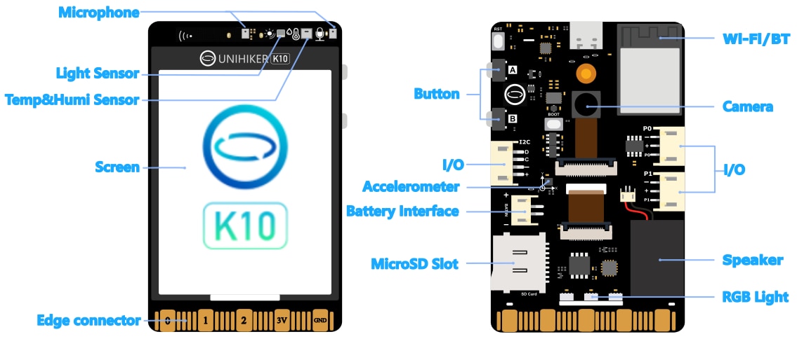

The UNIHIKER K10 is a compact and affordable board that stands out for its large 2.8-inch LCD display with a resolution of 240x320 pixels, numerous internal sensors (temperature, humidity, brightness, acceleration), two microphones, and a 2MP camera. Regarding expandability, in addition to the popular EdgeConnector, it has two 3-pin GPIO ports, a 4-pin I2C port, and even a connector for an external battery. Finally, I'd like to point out the presence of a TF card slot for managing files, logs, images, etc.

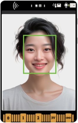

Finally, the presence of a microphone and camera allow for the creation of applications that use artificial intelligence, making them suitable for advanced projects by more experienced students.
An example of AI application: face recognition (from UNIHIKER site)

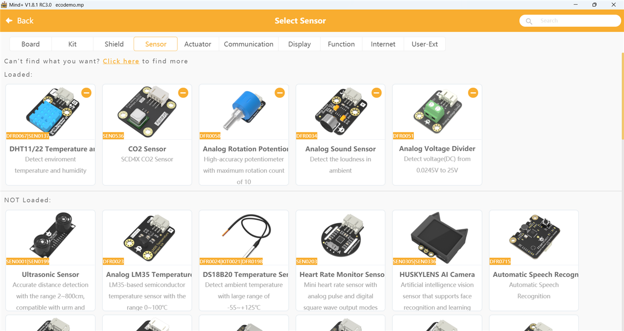

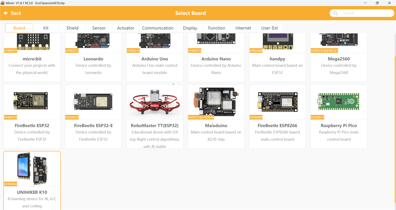

Regarding software, this board allows you to use both the Arduino ecosystem and Micropython and Python. It can be programmed using Arduino IDE, Mind+, Visual Studio, etc. I found the Mind+ solution to be very powerful, as many students are already familiar with it from using it with Arduino boards and drones, and especially because it allows programming in various programming languages ​​(Arduino, Python, Micropython) and even block-based programming, which is very useful for starting to program and solve simple home automation and IoT problems.
{gallery}Using Mind+

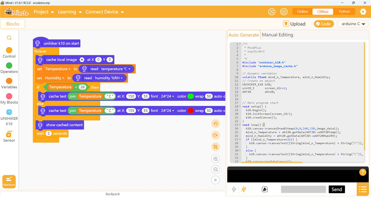

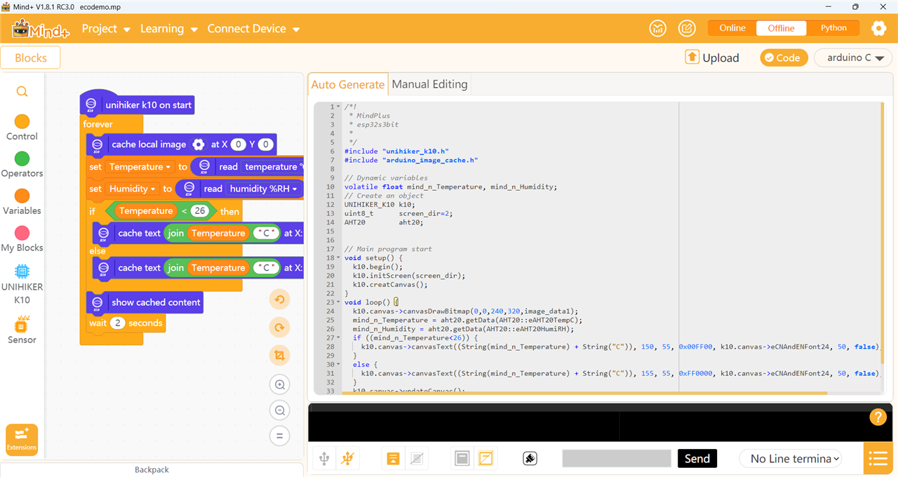

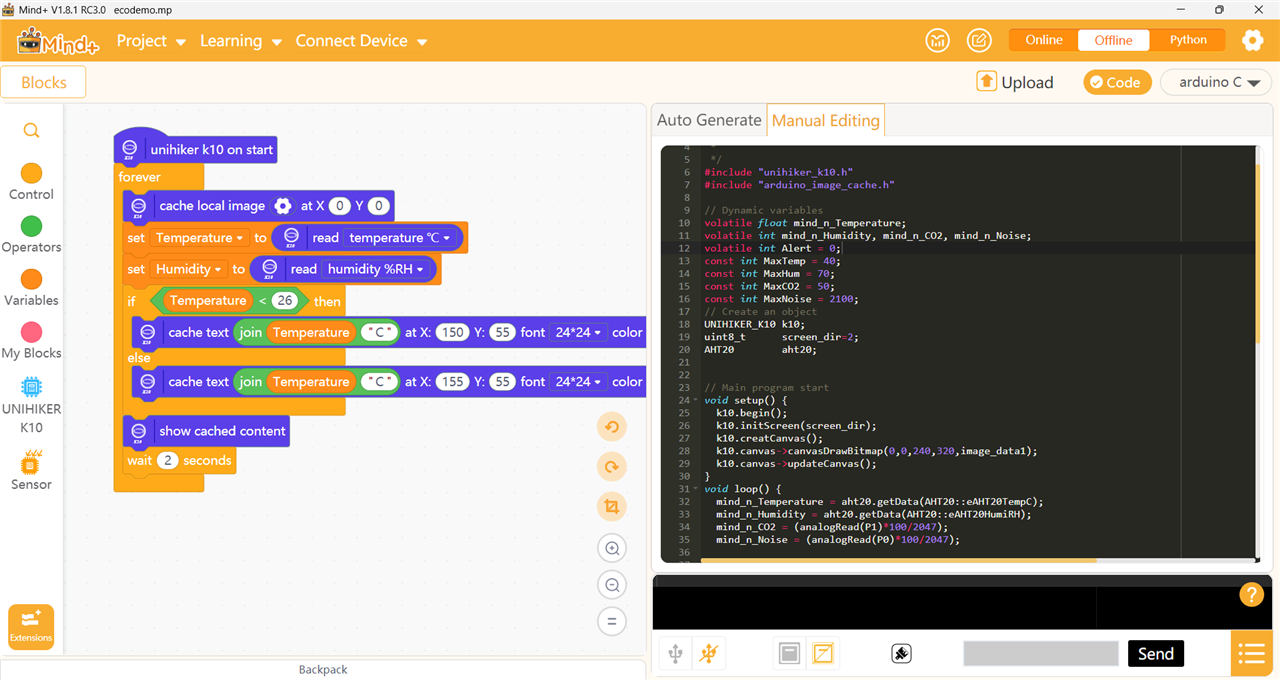

This project will be an opportunity to begin learning about the K10 board and the Mind+ development environment. Once the software is loaded, you will need to load the extension for the Unihiker K10 and the blocks relating to the board's capabilities and sensors will immediately be available. To begin, we will explore the K10's internal sensors, specifically reading temperature and humidity using the AHT20 internal sensor. We will work with the blocks and see how, as we connect the blocks to create our algorithm, the automatically generated "Arduino-style" code is displayed in the window on the right. This is very useful for giving students a sense of how each block corresponds to lines of code with a well-defined syntax. The beauty of this work environment is the additional window that allows the user to freely write their own code. This is a very useful feature because you can start producing code very quickly using blocks and scratch programming. You can then edit the code manually in the "manual editing" window to optimize it, add functionality and controls manually without going through the predefined blocks.

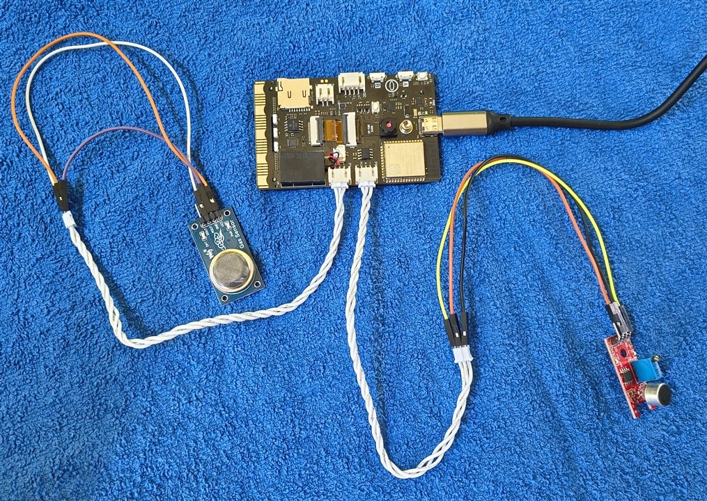

To complete it in the limited time available, I used what I found in my drawers. The programmatic thresholds for the values ​​above which the board signals an "Alert" state were obviously not derived from measurements or technical considerations, but are simply sample values.
My final impression was that the board was remarkably simple to configure and program. The two 3-pin input connectors posed no problems, even though the gas and acoustic sensors were not among the sensors "installed" on the Mind+.

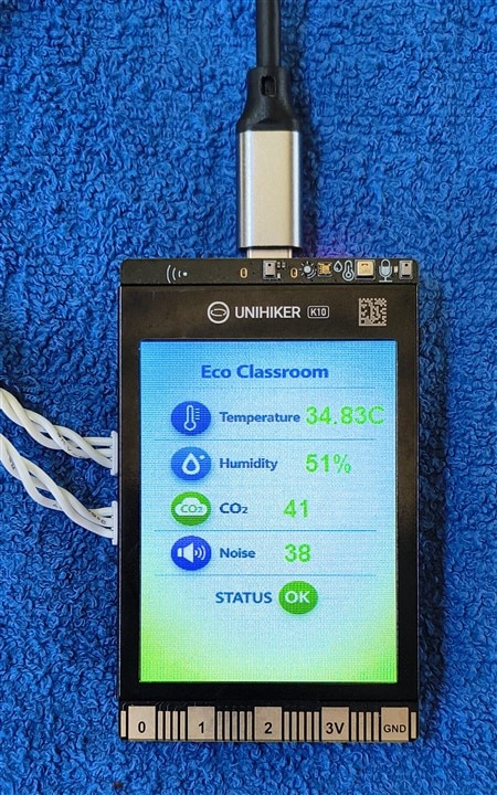

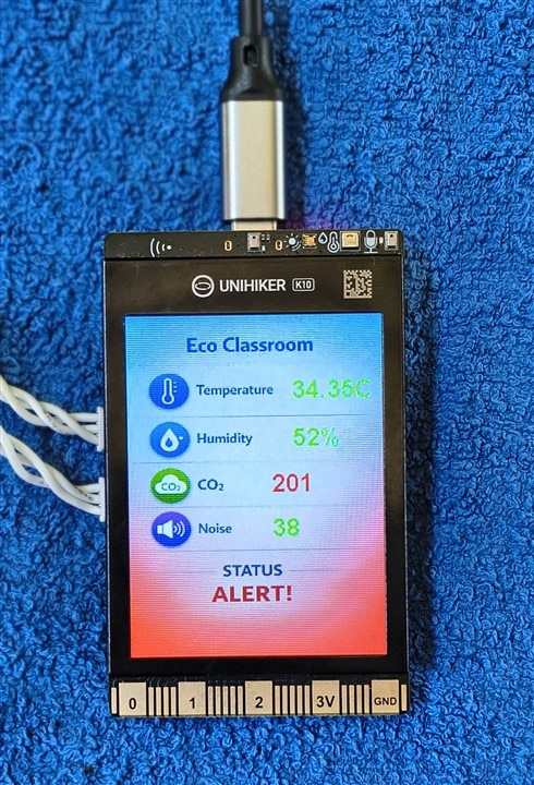

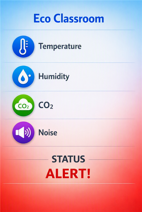

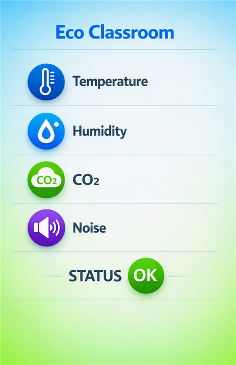

As for the graphics, I simply created two backgrounds: one in shades of green for situations where there are no abnormal values, and one in shades of red, which will be displayed when at least one value is outside the permitted range. On these two backgrounds, the values of Temperature, Humidity, CO2, and Noise values ​​will be displayed every 2 seconds, in green if they are within the normal range or red if they are abnormal and the speaker will play an acoustic alarm signal.
image             image
