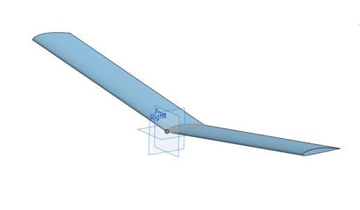

Design: This phase was where a lot of different choices needed to be made. One of the biggest choices was the wing. After running some CFD and drawing rough dimensions for the plane, I came up with the best aerofoil choice and wing dimensions, and also designed the electronics systems and fuselage. A small part of the process is shown below. See the full documentation for all the details:
CAD Model of a 1700mm dihedral wing designCFD on my wing designCAD sketch of fuselage cross section

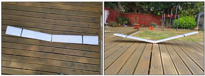

Implementation: This was one of the longest stages, as I ran into many different issues. Please see the end of Section C in my documentation for a full breakdown. This was the stage where the aircraft went from being a design to being tangible and complete. A few photos from the implementation stage:
horizontal and vertical stabilisersmain wingmaking the fuselage
