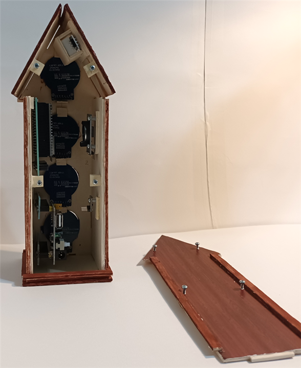

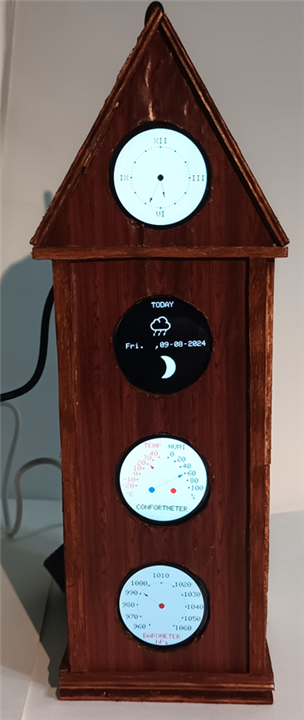

   In the past, some houses had small weather stations that showed the data of humidity, atmospheric pressure and temperature that were in that area by means of spheres, these spheres were framed in tables and hung on the walls; With the appearance of the media, these instruments fell into disuse, since in the news they offered meteorological information from all over the country.
   With this project we are going to recover this practical instrument by making a vintage electronic weather station. It is a Springfield-type weather station with imitation wood. This meteorological instrument is vertical and will have four spheres. The upper dial will show the current time, the second dial will offer a possible image of the state of the sky according to atmospheric pressure, the day and date and the state of the moon, the third sphere will offer the temperature in degrees Celsius and the percentage of humidity and the fourth and final sphere, will offer the atmospheric pressure in hPa, like the old dials, the reading of the values will be indicated by arrows.
   Round 1.28-inch TFT GC901 displays will be used for the dials. The versatile DHT-22 module will be used for temperature and humidity values and the GY-68 BMP180 module will be used to take the atmospheric pressure value. The DS3231 RTC module will be used to obtain the current time and minutes, as well as the current date. These modules will be powered by the versatile MB102 breadboard power supply, as the outputs can be configured to one at 5 VDC and one at 3.3 VDC, the latter being the one you will use to power the modules.

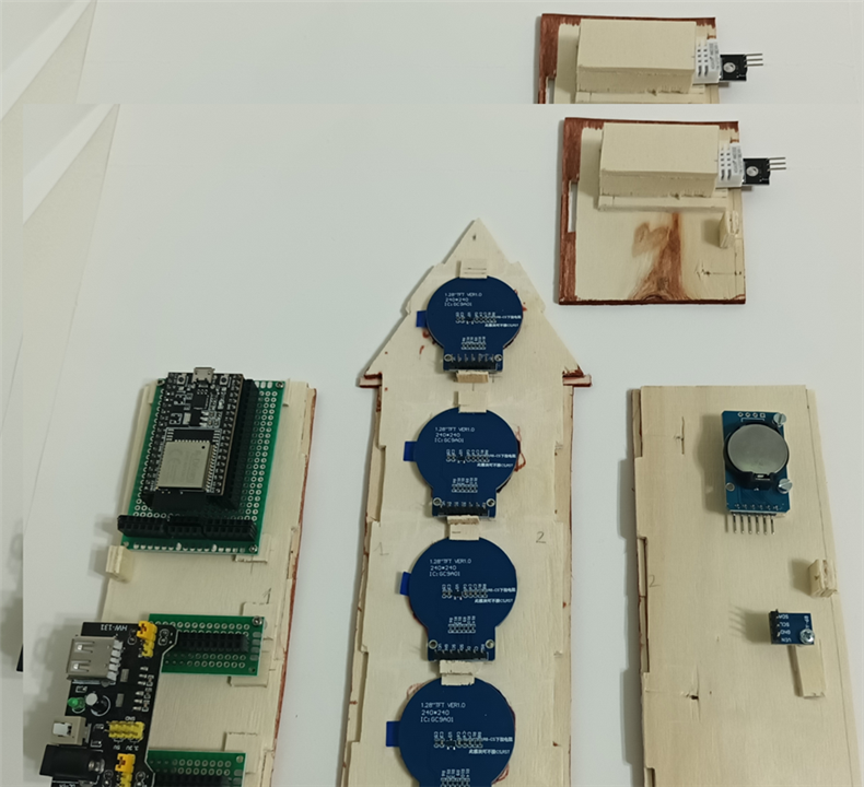

Hardware Needed:
  • 1 ESP-32 Dev Kit C V4
  • 4 GC9A01 1.28 inch Round LCD TFT display
  • 1 DHT22 AM2302 temperature & humidity module
  • 1 GY-68 BMP180 barometer sensor module
  • 1 Real time clock RTC DS3231 module
  • 1 MB102 Breadboard Power Supply
  • 1 PCB Board Set printed circuit board
  • PIN Header Single Row Straight Sockets
  • Pinleisten Header
  • Heat shrink tubing
  • Jumper wire cable 40 pcs. 20 cm each M2M male to male (optional)
  • Ultra Flexible Tinned Copper Cable

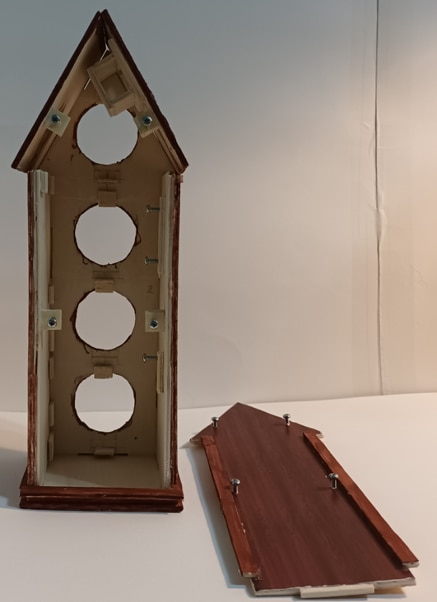

  • Wood planks

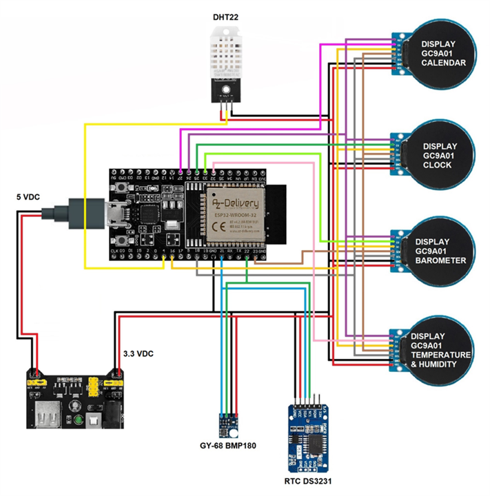

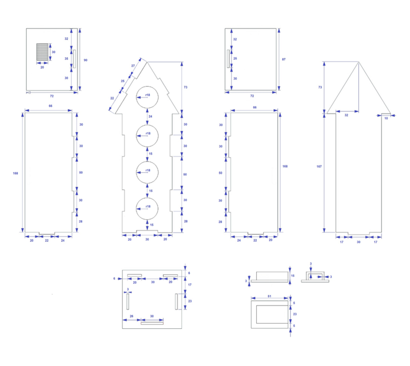

Electronic vintage weather station circuit
Electronic vintage weather station drawing parts
image          image
Description of the operation of the project

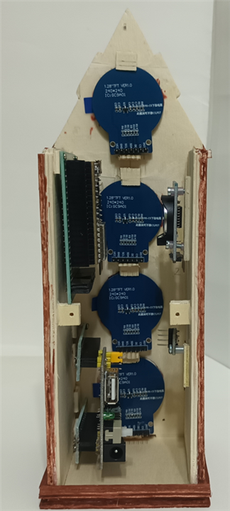

 As can be seen in the diagram of the components of the circuit, to obtain the values of temperature and humidity the DHT22 AM2302 module has been used, the OUT signal pin of this sensor must be connected to port 4 of the ESP-32 Dev Kit C V4  microcontroller so that the sensor sends the readings taken. For the measurement of atmospheric pressure the versatile BMP180 barometric module is used, and for obtaining the current time and dates the RTC DS3231 Real Time Clock module is used, these two modules communicate with the microcontroller through the I2C bus, these modules have the SDA and SCL pins connected to ports 21 and 22 which are the pins of the I2C port of the ESP-32 Dev Kit microcontroller C V4, that the two modules are connected to the same ports is not a problem, since each module has a unique address to access from the microcontroller, in this case, these addresses (BMP180 module address: 0x77 and DS3231 module address: 0x68) are defined within the libraries that are implemented at the beginning of the sketch and should not be defined or implemented,  they are transparent to the programmer.
    For the display of the readings of the previous modules, the round 1.28-inch TFT screens GC9A01 have been used, these communicate with the microcontroller through the SPI bus, so in order to select the screen where to display each reading of the modules, the CS (Chip Select) pins of each screen must be connected  to a single port of the microcontroller,  the other pins of the displays are RST (reset), DC (data), SDA (mosi), SCL (clock) will be connected to the same ports of the microcontroller, as the displays must be synchronized.
    Attention should be paid to the output voltage setting of the MB102 power supply using the jumpers, as the OFF and 3.3V pins must be bridged so that the output voltage of 3.3 VDC has the output voltage where the modules will be connected to power them. The entire assembly is controlled by the ESP-32 Dev Kit C V4 microcontroller.
   This is a read-only project of data acquired by modules and displayed on the screen, no interaction is needed. The operation of the circuit is simple, once the modules have been initialized, they continuously send the measurements obtained to the microcontroller and it will show the data through the screens, to select the screen through which each value of the modules will be displayed, the appropriate screen must be selected through the port of the microcontroller to which the CS pin of the screen is connected.

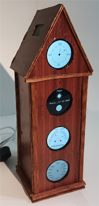

   The data from the sensor and clock readings will be represented on dials with scales.
   The sphere that will show the value of atmospheric pressure is composed of a single circumference where the scale of values will be located, where the points of pressure values with legends are thick blue points, while the intermediate points are significantly smaller, black and without a value legend. The name of the magnitude represented and the unit of measurement are indicated. The needle ends in an arrowhead and will mark the value of the pressure read by the BMP180 module.
   The dial that will mark the hours and minutes is composed of two concentric circles, where one circle will show the hour markers with blue dots and the other circle will mark the minutes with smaller black dots, it is the typical dial with the legend of the hours in Roman numerals at the cardinal points. The hour and minutes will be marked with hands ending in an arrowhead.
   The sphere that will mark the temperature and humidity is composed of two non-concentric spheres, the scales of values will be arches of these and will be opposed. In these arcs, the markers of the values will be numbers and the legends of the values will be shown in red for temperature and blue for humidity. The legends of each magnitude will also be reflected at the top and bottom of the scale, the unit of measurement. They will mark the values obtained by the sensor by means of needles ending in an arrowhead.

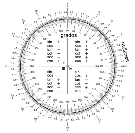

   As you can see in the photographs, the scales are circles or arcs of them, for the needle to show the exact value of the value read, the needle must be positioned at the angle by which the tip of it signals the value. Unfortunately, there is no method in the screen libraries that represents angles, so you must look for the method to be able to convert the value of the sensor reading and represent it on the perimeter of the circumference with radian degrees, for this conversion, operations with the sine and cosine of the angles will be used,  with which the coordinates will be calculated in which the tip of the needle must be located on the screen to mark the value of the reading that the sensors send.
   A radian is the measure of a central angle of a circle whose arc length subtended in equal to its radius, on the other hand, the value of 1 degree of a circle is equal to 0.0174533 radians. As you can see from the drawing, the orange dot of the circumference can be calculated using the cosine and sine, and that point will be a coordinate on the screen.

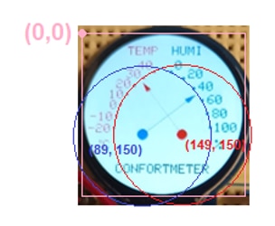

   Before continuing with the sketch, the coordinates of the GC9A01 screen will be explained. This screen is round, but to know the coordinates of a point on the screen, it is important to know that the coordinate point X = 0 and Y = 0 is the upper left corner of the pink square in the following image, i.e. the actual screen would be a circular cutout of a square screen of 240 px x 240 px resolution.
   The scale of values for both humidity and temperature will be drawn as an arc of circumference as seen in the image, so that the center of the humidity circumference will have the coordinates X = 89 and Y = 150, while the center of the circumference for the temperature scale will have the coordinates X = 149 and Y = 150,  only the arc necessary to contain the necessary scale will be drawn. In the image you can see how the circles described are located.image
   The sketch continues, the necessary variables are defined to then create both the scales of values, as well as the needles marking the temperature and humidity. For the subsequent creation of the arc of the temperature and humidity scale, the variables center_x_temperature, center_y_temperature, center_x_humidity and center_y_humidity of type int are created,  which are the values of the coordinates of the center of the circumference to be used.
int center_x_temperature = 149;
int center_y_temperature = 150;
int center_x_humidity = 89;
int center_y_humidity = 150;

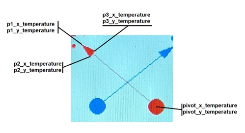

   The complete image of the needles is composed of a line that starts from the center of the circumference and ends in arrowheads that are really triangles and will mark the value of temperature and humidity. To represent the new position of a needle, first, the previous state of the needle will have to be redrawn with the background color of the screen, which defines variables to contain the old coordinates and the new coordinates obtained from the new values to represent the new position of the needle.
 The definition of the variables are float type to save the coordinates, both old and new, of the pivot of the needles, these are defined in the next line of the sketch.
float pivot_x_temperature, pivot_y_temperature, pivot_x_temperature_old, pivot_temperature_y_old;
 Float variables are also defined to save the values of the coordinates of the position of the triangle of the arrowhead that will mark the value of the temperature that the DHT22 sensor has taken, variables are created for both old and new coordinates.
float p1_x_temperature, p1_y_temperature, p2_x_temperature, p2_y_temperature, p3_x_temperature, p3_y_temperature;
float p1_x_old_temperature, p1_y_old_temperature, p2_x_old_temperature, p2_y_old_temperature, p3_x_old_temperature, p3_y_old_temperature;

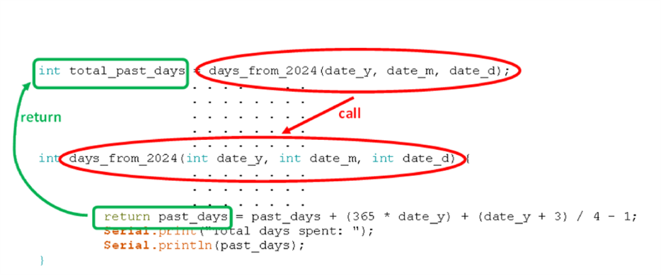

   To save the date data, variables of type int are created, to save the day (date_d), month (date_m) and current year (date_y), as well as to save the days passed with past_days and days passed since January 1, 2024 with the variable total_past_days, these last defined variables will also be used in the calculation of the moon phase.
int date_d;
int date_m;
int date_y;
int past_days;
int total_past_days;

pivot_x_temperature = center_x_temperature;
pivot_y_temperature = center_y_temperature;
   The setup() method  is the initial configuration of all modules, which initializes the variables that will contain the coordinates to represent the triangle of the needle tip with the coordinates of the center of the circumference.
p1_x_old_temperature = center_x_temperature; p1_y_old_temperature = center_y_temperature;
p2_x_old_temperature = center_x_temperature; p2_y_old_temperature = center_y_temperature;
p3_x_old_temperature = center_x_temperature; p3_y_old_temperature = center_y_temperature;
   As you can see, to indicate the pivot point of the moisture needle and the initialization of the variables with the coordinates of the triangle of the needle tip, the same steps are performed as above.
pivot_x_humidity = center_x_humidity;
pivot_y_humidity = center_y_humidity;
p4_x_old_humidity = center_x_humidity; p4_y_old_humidity = center_y_humidity;
p5_x_old_humidity = center_x_humidity; p5_y_old_humidity = center_y_humidity;
p6_x_old_humidity = center_x_humidity; p6_y_old_humidity = center_y_humidity;

	needleAngle_temperature = (temperature * deg_to_rad * 1) - 2.7;
   As you can see in the following image, to convert the radians of the circumference into coordinates of the screen, we need to perform the calculations with the cosine to calculate the coordinate on the X-axis and with the sine for the Y coordinate.
   The line arc_x_temperature = (pivot_x_temperature + ((radius_temperature + 4) * cos(needleAngle_temperature))) calculates the pixel coordinate on the X-axis of the display. The 4 pixels that are added to the radius of the circumference is to move the point away by that number of pixels and not have to make a call to the method to represent the scale every time the temperature value changes. The line arc_y_temperature = (pivot_y_temperature + ((radius_temperature + 4) * sin(needleAngle_temperature))) calculates the pixel coordinate of the Y-axis of the display.
arc_x_temperature = (pivot_x_temperature + ((radius_temperature + 4) * cos(needleAngle_temperature)));
arc_y_temperature = (pivot_y_temperature + ((radius_temperature + 4) * sin(needleAngle_temperature)));
   Having calculated the X and Y coordinates of the value of the past temperature of the for loop counter, a circle of 2 red pixels will be displayed at the X and Y coordinates corresponding to the following line of code.

When the needle_temperature() method is called  to update the position of the needle with the new temperature data, what is done is first to redraw the current state of the needle with the background color of the screen which is white, which will "erase" it and then the needle will be represented again in red to mark the new value.
To "erase" the current position of the needle, its line must be redrawn and the triangle of the arrowhead in white, which is the background color of the sphere, is done with the next two lines.
tft_temperature.drawLine (pivot_x_temperature, pivot_y_temperature, p1_x_old_temperature, p1_y_old_temperature, WHITE);
tft_temperature.fillTriangle (p1_x_old_temperature, p1_y_old_temperature, p2_x_old_temperature, p2_y_old_temperature, p3_x_old_temperature, p3_y_old_temperature, WHITE);
   With the temperature data saved, the position of the radian value of this temperature in the drawn arc of the value scale has to be calculated, this calculation is done on the following line.
needleAngle_temperature = (needle_setter_temperature * deg_to_rad * 1) - 2.7;
   When the position on the circumference of the temperature value in radians has been calculated, the coordinates of the needle must be calculated on the display and saved in its variables. To represent the needle, you must know the coordinates of the starting point, which will be its point of rotation (pivot_x_temperature and  pivot_y_temperature), the tip of the needle (p1_x_temperature and p1_y_temperature), the left vertex of the triangle of the needle tip (p2_x_temperature and p2_y_temperature) and the right vertex (p3_x_temperature and p3_y_temperature), to calculate the coordinates, calculations are made with the sine and cosine, as described when representing the scale of values, so that the following lines of code will be easy to follow.
p1_x_temperature = (pivot_x_temperature + ((radius_temperature - 1) * cos(needleAngle_temperature)));
p1_y_temperature = (pivot_y_temperature + ((radius_temperature - 1) * sin(needleAngle_temperature)));
p2_x_temperature = (pivot_x_temperature + ((radius_temperature - 16) * cos(needleAngle_temperature - 0.05)));
p2_y_temperature = (pivot_y_temperature + ((radius_temperature - 16) * sin(needleAngle_temperature - 0.05)));
p3_x_temperature = (pivot_x_temperature + ((radius_temperature - 16) * cos(needleAngle_temperature + 0.05)));
p3_y_temperature = (pivot_y_temperature + ((radius_temperature - 16) * sin(needleAngle_temperature + 0.05)));
   When coordinates are calculated and saved in the corresponding variables, they are also saved in the variables of the old coordinates (e.g. p1_x_old_temperature) for when the current representation of the needle has to be "erased".
p1_x_old_temperature = p1_x_temperature; p1_y_old_temperature = p1_y_temperature;
p2_x_old_temperature = p2_x_temperature; p2_y_old_temperature = p2_y_temperature;
p3_x_old_temperature = p3_x_temperature; p3_y_old_temperature = p3_y_temperature;
   To represent the needle in the new position and mark the new value on the value scale, a red line will first be represented from the rotation point to the tip of the arrow.
tft_temperature.drawLine (pivot_x_temperature, pivot_y_temperature, p1_x_temperature, p1_y_temperature, RED);
   And to represent the tip of the arrow, a triangle will be drawn in red with the following line.
tft_temperature.fillTriangle (p1_x_temperature, p1_y_temperature, p2_x_temperature, p2_y_temperature, p3_x_temperature, p3_y_temperature, RED);

   The last screen that is programmed will show the state of the sky according to atmospheric pressure, the day of the week and date with characters and the phase of the moon with an image, it begins with the analysis of the code for the data update of this screen.
   Thefirst one that is made is a call to the now() method  of the DS3231 module object, with this method the information of the current time and date is obtained to be displayed on the screen through the functions of this method. To get the current day, you use the now function.day() and its value is saved in the variable date_ d, using the now function.month() is fetched for the current month and saved in the date_m variable and by using the now function.year() is retrieved from the current year and saved in the date_y variable.
DateTime now =rtc.now();
date_d = now.day();
date_m = now.month();
date_y = now.year();
   The background of this screen is black, since both the images and the characters will be represented in white. The screen background color settings are set with the following line.
tft_calendar.fillScreen(BLACK);
    The next four lines of the sketch set up the caption at the top of the screen. With the setTextColor (WHITE) function  , the white color of the text is set, the setTextSize function (2) is used to set the text size to size, it will be displayed at the coordinates set with setCursor (93, 4) and the text that appears is configured with the print function ("TODAY").
tft_calendar.setTextColor (WHITE);
tft_calendar.setTextSize (2);
tft_calendar.setCursor (93, 4);
tft_calendar.print ("TODAY");
   To get the day of the week, the println(daysOfTheWeek[now.dayOfTheWeek()]) function  makes a call to the array where the abbreviations of the days of the week are saved, the module has the days of the week configured in numbers, for example, Sunday is day 0 of the week, when the array call is made. The position in the array of the passed text is searched and the text is displayed on the screen. Coordinates are set using the  setCursor function  (20, 112), text color is set using the setTextColor function (WHITE), and text size is set  using the setTextSize function (2).
tft_calendar.setCursor(20, 112);
tft_calendar.setTextColor(WHITE);
tft_calendar.setTextSize(2);
tft_calendar.println(daysOfTheWeek[now.dayOfTheWeek()]);

   To calculate the days that have elapsed since January 1, 2024, a call has been created to the method days_from_2024(date_y, date_m, date_d), which, as you can see, is passed as parameters the current day, month and year and will return the number of elapsed days that will be saved in the total_past_days variable of integer value type, the value of the variable is displayed by the Serial Monitor.
int total_past_days = days_from_2024(date_y, date_m, date_d);
Serial.print("Days since January 1, 2024: ");
Serial.println(total_past_days);
   When you call the int days_from_2024(int date_y, int date_m, int date_d) method  to calculate the total elapsed days, you receive the year, month, and current day. Then, the first conditional is executed when the year is equal to or greater than 2024, if it is fulfilled, the year 2024 is subtracted from the current year and the result is saved again in the variable of the year date_y -= 2024 and the result is shown by the Serial Monitor.

   And the number of total days is returned with return past_days  to the call that was made from the sketch line int total_past_days = days_from_2024(date_y, date_m, date_d).
   The full code of the method for calculating the number of days spent is:

   When you go out of the loop because the value of the next_day_new_moon variable is higher, the value of the total_past_days variable is subtracted, and the result of the subtraction is the days that have passed since the last new moon, the value is saved in the state_moon variable.
float state_moon = next_day_new_moon - total_past_days;
   To represent an image of the moon's phase on the screen, conditionals are used to perform checks on the value of the variable state_moon, when the value of the variable is between the values of one of the conditionals, the inside of its curly brackets is executed, e.g. if the value of the variable is 15, the conditional will be executed:
if (state_moon <= 15.5 & state_moon >= 14.5) {
	Serial.print("Today is a full moon.");
	tft_calendar.fillCircle (120, 180, 30, WHITE);
   Then, will represent a white circle of radius 30 pixels at the coordinates X = 120 and Y = 180. As can be seen in the code, for the waxing and waning phases of the moon, a white circle is represented first and then a black circle, the latter black circle will occupy its intersection with the white circle, so the white circle will lack the intersection with the black circle and will show the image of the moon's state. The rest of the conditionals are easy to follow.
   All that remains is the representation of the possible state of the sky depending on atmospheric pressure, to represent the symbols of rain, cloud with sun and sunny, four methods have been defined that represent lines to form the symbols.
   Three conditionals have been implemented, when the pressure measured by the sensor is included between the values of one of them, its interior will be executed and a call will be made to the method or methods that are inside.
if (pressu < 1000) {
	cloud();
	rain();
if (pressu >=1000 && pressu <= 1020) {
	cloud();
	sun_in_cloud();
if (pressu > 1020) {
	sun();
 With these last 3 conditionals, the code of the refresh_screens() method ends and the barometer is fully operational. The data on the screen will be updated every minute and you will be able to know if you should take the umbrella or a hat.
Project photos
image  image  image  image

      /***** Count of days elapsed since January 1, 2024 *****/
      int total_past_days = days_from_2024(date_y, date_m, date_d);                                                                         // We call the method “days_from_2024” passing as parameters the day, month and year number data. We will receive the number of days passed.
      Serial.print("Days since January 1, 2024: ");                                                                                         // Message in the Serial Monitor.
      Serial.println(total_past_days);                                                                                                      // Message in the Serial Monitor with the number of days passed.
      /***** End of process for counting days elapsed since January 1, 2024 process *****/

void create_dial_temperature() {                                                                                                            // Method to draw the temperature and humidity values scale.
      for (temperature=-20; temperature<40.1; temperature+=10) {                                                                            // Loop to display divisions every 10 degrees on the temperature scale.
            needleAngle_temperature = (temperature * deg_to_rad * 1) - 2.7;                                                                 // Needle positioning angle for a temperature value, must be converted to position in radians.
            arc_x_temperature = (pivot_x_temperature + ((radius_temperature + 4) * cos(needleAngle_temperature)));                          // Calculation to know the position on the X axis of the circumference of the radian value obtained.
            arc_y_temperature = (pivot_y_temperature + ((radius_temperature + 4) * sin(needleAngle_temperature)));                          // Calculation to know the position on the Y axis of the circumference of the radian value obtained.
            tft_temperature.fillCircle  (arc_x_temperature, arc_y_temperature, 2, RED);                                                     // A red circle of size 2 is drawn at the obtained X and Y coordinates.
      tft_temperature.setTextColor (RED);                                                                                                   // Set color text in red.
      tft_temperature.setTextSize (2);                                                                                                      // Text size 2.
      tft_temperature.setCursor (64, 16);                                                                                                   // Coordinates of the first letter of the text to be written.
      tft_temperature.print ("TEMP");                                                                                                       // Text to be written on the screen.
      tft_temperature.setCursor (80, 38);                                                                                                   // Coordinates of the first character of the next number to be written.
      tft_temperature.print ("40");                                                                                                         // The number 40 will be written on the screen.
      tft_temperature.setCursor (62, 51);
      tft_temperature.print ("30");
      tft_temperature.setCursor (47, 66);
      tft_temperature.print ("20");
      tft_temperature.setCursor (36, 82);
      tft_temperature.print ("10");
      tft_temperature.setCursor (38, 98);
      tft_temperature.print ("0");
      tft_temperature.setCursor (8, 116);
      tft_temperature.print ("-10");
      tft_temperature.setCursor (5, 134);
      tft_temperature.print ("-20");
      tft_temperature.setTextColor (RED);                                                                                                   // Set color text in red to write the degrees Celsius simbol.
      tft_temperature.setCursor (29, 159);                                                                                                  // Coordinates of the C letter.
      tft_temperature.print ("C");                                                                                                          // Letter C for writing degrees Celsius.
      tft_temperature.fillCircle (24, 161, 2, RED);                                                                                         // Red circle of size 2 in the past coordinates.
      tft_temperature.fillCircle (24, 161, 1, WHITE);                                                                                       // White circle of size 1 in the past coordinates to do one small "o" before C letter.
      for (humidity=0; humidity<101; humidity+=20) {                                                                                        // Loop to show percentage divisions of 20 on the humidity scale.
            needleAngle_humidity = (humidity * deg_to_rad * 0.6)- 1.15;                                                                     // Needle positioning angle for a humidity value, must be converted to position in radians.
            arc_x_humidity = (pivot_x_humidity + ((radius_temperature + 4) * cos(needleAngle_humidity)));                                   // Calculation to know the position on the X axis of the circumference of the radian value obtained.
            arc_y_humidity = (pivot_y_humidity + ((radius_temperature + 4) * sin(needleAngle_humidity)));                                   // Calculation to know the position on the Y axis of the circumference of the radian value obtained.
            tft_temperature.fillCircle (arc_x_humidity, arc_y_humidity, 2, BLUE);                                                           // A blue circle of size 2 is drawn at the obtained X and Y coordinates.
      tft_temperature.setTextColor (BLUE);                                                                                                  // Set color text in blue.
      tft_temperature.setCursor (132, 16);                                                                                                  // Coordinates of the first letter of the text to be written.
      tft_temperature.print ("HUMI");                                                                                                       // Text to be written on the screen.
      tft_temperature.setCursor (137, 38);                                                                                                  // Coordinates of the first character of the next number to be written.
      tft_temperature.print ("0");                                                                                                          // The number 0 will be written on the screen.
      tft_temperature.setCursor (157, 51);
      tft_temperature.setCursor (173, 70);
      tft_temperature.setCursor (187, 90);
      tft_temperature.print ("60");
      tft_temperature.setCursor (195, 111);
      tft_temperature.print ("80");
      tft_temperature.setCursor (198, 132);
      tft_temperature.print ("100");
      tft_temperature.setCursor (200, 158);
      tft_temperature.print ("%");
      tft_temperature.setTextColor (BLACK);                                                                                                 // Set color text in black.
      tft_temperature.setCursor (49, 195);                                                                                                  // Coordinates of the first letter of the text to be written.
      tft_temperature.print ("CONFORTMETER");                                                                                               // Text to be written on the screen.

void needle_temperature() {                                                                                                                 						                                    // Method for the dynamic management of the temperature indicating needle.
      tft_temperature.drawLine (pivot_x_temperature, pivot_y_temperature, p1_x_old_temperature, p1_y_old_temperature, WHITE);               					 	                                    // Draw the needle in white color with the old values, it will be erased from the screen.
      tft_temperature.fillTriangle (p1_x_old_temperature, p1_y_old_temperature, p2_x_old_temperature, p2_y_old_temperature, p3_x_old_temperature, p3_y_old_temperature, WHITE);             // Draw the needle tip triangles in white with the old values, they will be erased from the screen.
      needleAngle_temperature = (needle_setter_temperature * deg_to_rad * 1) - 2.7;                                                                                                         // The temperature value will be converted to radians.
      p1_x_temperature = (pivot_x_temperature + ((radius_temperature - 1) * cos(needleAngle_temperature)));                                                                                 // Calculation to know the position on the X-axis of the circumference of the radian value obtained for the tip of the needle.
      p1_y_temperature = (pivot_y_temperature + ((radius_temperature - 1) * sin(needleAngle_temperature)));                                                                                 // Calculation to know the position on the Y-axis of the circumference of the radian value obtained for the tip of the needle.
      p2_x_temperature = (pivot_x_temperature + ((radius_temperature - 16) * cos(needleAngle_temperature - 0.05)));                                                                         // Calculation to know the position on the X-axis of the circumference of the radian value obtained for the triangle to the left of the tip of the needle.
      p2_y_temperature = (pivot_y_temperature + ((radius_temperature - 16) * sin(needleAngle_temperature - 0.05)));                                                                         // Calculation to know the position on the Y-axis of the circumference of the radian value obtained for the triangle to the left of the tip of the needle.
      p3_x_temperature = (pivot_x_temperature + ((radius_temperature - 16) * cos(needleAngle_temperature + 0.05)));                                                                         // Calculation to know the position on the X-axis of the circumference of the radian value obtained for the triangle to the right of the tip of the needle.
      p3_y_temperature = (pivot_y_temperature + ((radius_temperature - 16) * sin(needleAngle_temperature + 0.05)));                                                                         // Calculation to know the position on the Y-axis of the circumference of the radian value obtained for the triangle to the right of the tip of the needle.
      p1_x_old_temperature = p1_x_temperature; p1_y_old_temperature = p1_y_temperature;                                                                                                     // Save current values in the old value variables.
      p2_x_old_temperature = p2_x_temperature; p2_y_old_temperature = p2_y_temperature;                                                                                                     // Save current values in the old value variables.
      p3_x_old_temperature = p3_x_temperature; p3_y_old_temperature = p3_y_temperature;                                                                                                     // Save current values in the old value variables.
      tft_temperature.drawLine (pivot_x_temperature, pivot_y_temperature, p1_x_temperature, p1_y_temperature, RED);                                                                         // Draw a red line for the temperature indicator needle with the coordinates passed.
      tft_temperature.fillTriangle (p1_x_temperature, p1_y_temperature, p2_x_temperature, p2_y_temperature, p3_x_temperature, p3_y_temperature, RED);                                       // Draw the two red triangles for the tip of the temperature indicator needle with the coordinates passed.
void needle_humidity() {                                                                                                                                                                    // Method for the dynamic management of the humidity indicating needle.
      tft_temperature.drawLine (pivot_x_humidity, pivot_y_humidity, p4_x_old_humidity, p4_y_old_humidity, WHITE);                                                                           // Draw the needle in white color with the old values, it will be erased from the screen.
      tft_temperature.fillTriangle (p4_x_old_humidity, p4_y_old_humidity, p5_x_old_humidity, p5_y_old_humidity, p6_x_old_humidity, p6_y_old_humidity, WHITE);                               // Draw the needle tip triangles in white with the old values, they will be erased from the screen.
      needleAngle_humidity = (needle_setter_humidity * deg_to_rad * 0.6) - 1.15;                                                                                                            // The humidity value will be converted to radians.
      p4_x_humidity = (pivot_x_humidity + ((radius_temperature - 1) * cos(needleAngle_humidity)));                                                                                          // Calculation to know the position on the X-axis of the circumference of the radian value obtained for the tip of the needle.
      p4_y_humidity = (pivot_y_humidity + ((radius_temperature - 1) * sin(needleAngle_humidity)));                                                                                          // Calculation to know the position on the Y-axis of the circumference of the radian value obtained for the tip of the needle.
      p5_x_humidity = (pivot_x_humidity + ((radius_temperature - 16) * cos(needleAngle_humidity - 0.05)));                                                                                  // Calculation to know the position on the X-axis of the circumference of the radian value obtained for the triangle to the left of the tip of the needle.
      p5_y_humidity = (pivot_y_humidity + ((radius_temperature - 16) * sin(needleAngle_humidity - 0.05)));                                                                                  // Calculation to know the position on the Y-axis of the circumference of the radian value obtained for the triangle to the left of the tip of the needle.
      p6_x_humidity = (pivot_x_humidity + ((radius_temperature - 16) * cos(needleAngle_humidity + 0.05)));                                                                                  // Calculation to know the position on the X-axis of the circumference of the radian value obtained for the triangle to the right of the tip of the needle.
      p6_y_humidity = (pivot_y_humidity + ((radius_temperature - 16) * sin(needleAngle_humidity + 0.05)));                                                                                  // Calculation to know the position on the Y-axis of the circumference of the radian value obtained for the triangle to the right of the tip of the needle.
      p4_x_old_humidity = p4_x_humidity; p4_y_old_humidity = p4_y_humidity;                                                                                                                 // Save current values in the old value variables.
      p5_x_old_humidity = p5_x_humidity; p5_y_old_humidity = p5_y_humidity;                                                                                                                 // Save current values in the old value variables.
      p6_x_old_humidity = p6_x_humidity; p6_y_old_humidity = p6_y_humidity;                                                                                                                 // Save current values in the old value variables.
      tft_temperature.drawLine (pivot_x_humidity, pivot_y_humidity, p4_x_humidity, p4_y_humidity, BLUE);                                                                                    // Draw a blue line for the humidity indicator needle with the coordinates passed.
      tft_temperature.fillTriangle (p4_x_humidity, p4_y_humidity, p5_x_humidity, p5_y_humidity, p6_x_humidity, p6_y_humidity, BLUE);                                                        // Draw the two blue triangles for the tip of the humidity indicator needle with the coordinates passed.

int days_from_2024(int date_y, int date_m, int date_d) {                                                                                    // Received the current day, month and year.
      if (date_y >= 2024) {                                                                                                                 // Conditional that compares the year received, if it is equal or greater than 2024, the instruction inside the braces is attached.
            date_y -= 2024;                                                                                                                 // It is subtracted from the year received 2024 and stored in the same variable.
            Serial.print("Past years: ");                                                                                                   // Message in the Serial Monitor.
            Serial.println(date_y);                                                                                                         // Message in the Serial Monitor of the value of the variable "date_y".
      past_days = date_d;                                                                                                                   // Store the days received in the variable “past_days”.
      Serial.print("Days gone: ");                                                                                                          // Message in the Serial Monitor.
      Serial.println(past_days);                                                                                                            // Message in the Serial Monitor of the value of the variable “days_past”.
      for (byte c = 1; c < date_m; c = c + 1) {                                                                                             // Loop to convert past and completed months of the year into days.
            past_days = past_days + daysInMonth[c];                                                                                         // The days of each completed month are added to the days contained in the variable “past_days” and stored in the same variable.
            Serial.print("Days gone by months: ");                                                                                          // Message in the Serial Monitor.
            Serial.println(past_days);                                                                                                      // Message in the Serial Monitor of the value of the variable "past_days".
      if (date_m > 2 && date_y % 4 == 0) {                                                                                                  // If one of the past months is February and the year is a leap year the instruction inside the braces is attached.
            past_days = past_days + 1;                                                                                                      // A day is added to the variable “past_days”.
            Serial.print("Days passed by leap year: ");                                                                                     // Message in the Serial Monitor.
      return past_days = past_days + (365 * date_y) + (date_y + 3) / 4 - 1;                                                                 // The value of the past days is added, the result of multiplying the days of a year by the past years since 2024, one day for each leap year and subtracting 1 from the current day. The value is returned to the call of this method.
            Serial.print("Total days spent: ");                                                                                             // Message in the Serial Monitor.
