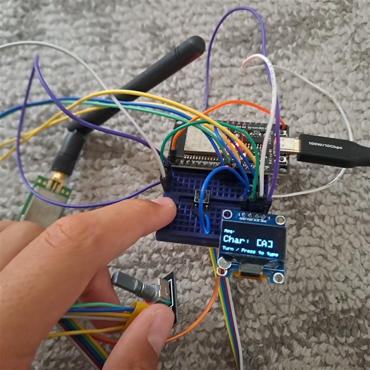

ESP32 nRF24 Walkie-Talkie (Main Description)
This project is a wireless communication terminal built on the ESP32 microcontroller, utilizing the nRF24L01 2.4GHz transceiver module for data transmission. The system features a 0.96" I2C OLED display to show real-time operational status (such as current channel and transmission states) and an incremental rotary encoder with a push button for user input. Rotating the encoder adjusts the active channel, while pressing the integrated button triggers an outgoing transmission packet.

    Dear cstanton,
    I have just added the images
