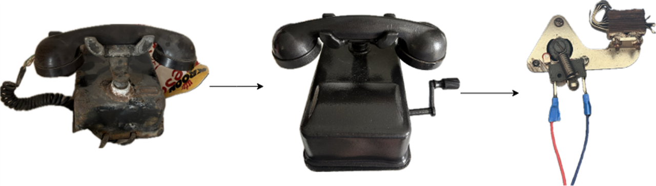

Let's be honest, our grandparents hate smartphones. They find it hard to navigate through menus, forget where the emergency button is, and often want nothing to do with modern technology. On top of that, the world is full of electronic waste. That's where the idea came from: why not kill two birds with one stone? My bachelor's thesis professor gave me this telephone to restore; although its exact model remains unconfirmed despite historical research, engraved codes on the components indicate it was standardized by the Reichspost (RP), possibly pointing to a Siemens & Halske Ortsbatterie desk phone from 1933 that used a local battery system and a side-mounted magneto crank instead of a rotary dial. I took an old telephone from the World War II era and gave it a second chance. The main idea was to build an emergency device where seniors or vulnerable people don't have to learn anything new, they use the exact classic gesture they grew up with: picking up the receiver from the hook. This project started as my bachelor's thesis.

Step 1 - hardware assembly & retrofitting: cleaning and restoring the vintage telephone chassis, painting it with a rugged hammer-tone finish, and adapting a custom microswitch onto the receiver's hook mechanism to capture physical lifting.

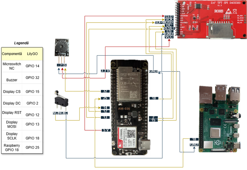

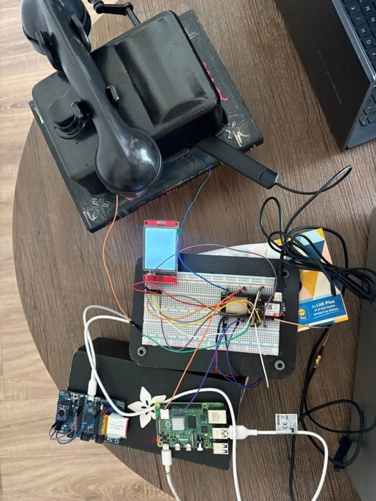

Step 2 - The processing & communication core & audio/visual feedback: inside the shell, I mounted the LilyGO T-Call board (which packs an ESP32-WROVER-B and a SIM800L module together), a 2-inch TFT ST7789 display, a voice-command subsystem (powered by a Raspberry Pi 4 and an Adafruit PyBadge), an external antenna, and a Li-Po battery. To keep track of what's happening, the display was used to indicate all the states the board goes through, from initialization and operator detection to network searching and placing the call. Additionally, to give the user instant audio feedback, I added an active buzzer. It chirps during critical moments (like confirming that an emergency alarm has been triggered) and, even better, it mimics a traditional dial/ring tone while the emergency call is active so the user knows the call is going through.
Step 3 - firmware & cellular positioning: writing the Arduino-based firmware using a finite-state machine logic to query tower parameters sequentially (AT+CCED, AT+CENG, AT+CREG=2) for cellular triangulation.
Step 4 - cloud & Telegram integration: executing HTTPS POST requests to the Google Geolocation API and utilizing the Telegram Bot API to dispatch formatted Markdown emergency messages.

Challenge 1 (AT command incompatibility): the primary command initially planned for data extraction (AT+CCED) was not supported by the SIM800L firmware version.
  • Workaround: developed a cascading fallback algorithm that automatically switches to AT+CENG and AT+CREG=2 to reliably extract network parameters under any condition.
Challenge 2 (rural geolocation accuracy): testing in rural areas revealed long distances between cell towers, resulting in coverage radio over 6 km and position errors around 1 km.
  • Workaround: thoroughly documented this physical limitation of Cell-ID technology and proposed upgrading to a native GPS module (like the LilyGO T-SIM7000G) for future iterations.
    Challenge 3 (voice recognition reliability): voice triggers proved inconsistent in noisy real-world environments.
    • Workaround: by testing different thresholds for the voice recognition method, a 70% accuracy has been achieved, taking into account that only an analog microphone could be installed on the Adafruit microcontroller; a better microphone would achieve better results.
    Current project status & remaining challenges
    What is working right now: the hardware restoration of the vintage telephone housing is complete, the mechanical hook switch and audio feedback (buzzer) are fully functional, and the core emergency loop, fetching cellular data and dispatching a Telegram alert with a Google Maps link, works reliably in covered areas.
