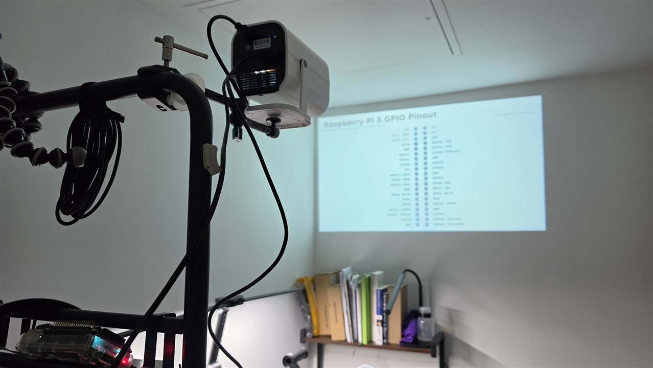

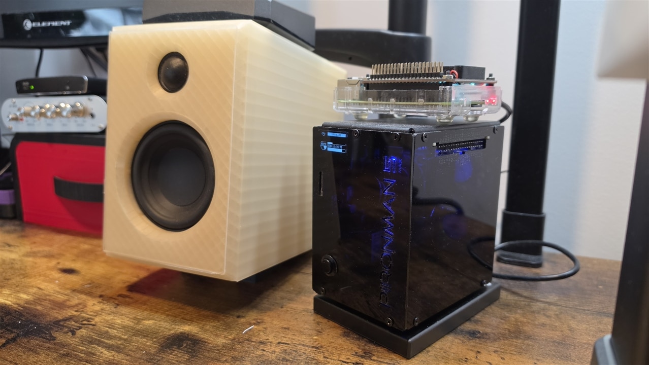

Current Setup for Gaia and Gaia wall. Raspberry Pi 5 16gb with a  Pironman 5 max case with 500gb m.2 drive and 1tb external for storage and above it currently is the Raspberry Pi 4 4GB with 64GB micro SD card for the GAIA wall node.

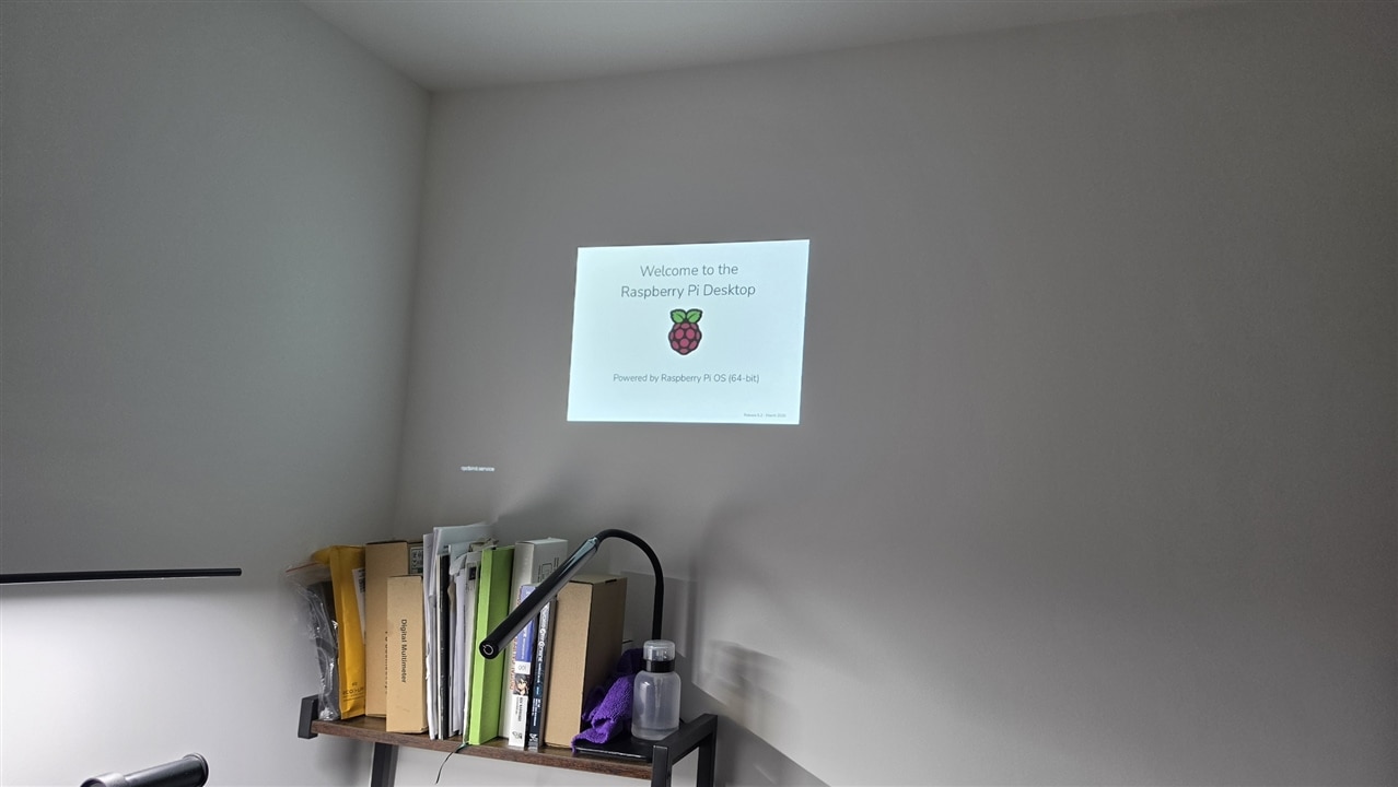

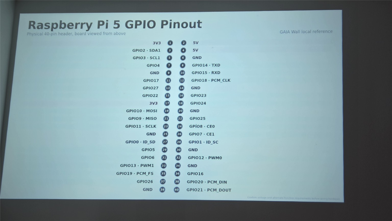

GAIA Wall first time booting up
GAIA Wall displaying a Raspberry Pi 5 GPIO reference page full-size on the workshop wall.

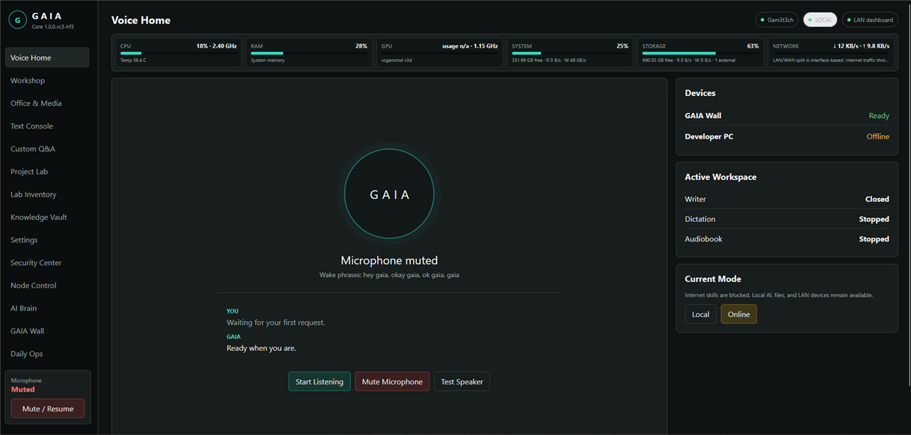

screenshot of my current GAIA dashboard home page simple and works. any device on the network can access it and I have a remote app that I can send voice commands on any device to it as well.  I can also control my main computers and transfer files through a program I designed for it for easy access to files I might be working on.  Many machines one GAIA fully offline on the LAN (no outside influence unless I allow it) and has built in virus scanning and other features. Maybe more on this in the future.

GAIA Wall is a separate Raspberry Pi connected to a projector.
Instead of treating the projector as another monitor connected directly to my main computer, I wanted it to become an independent display device that GAIA could control over the network.
The idea is that I can eventually tell GAIA:
"Put this on the wall."
The Raspberry Pi Wall Node then handles displaying it. This keeps the projector independent from my main workstation and gives me a large workshop display that can change depending on what I am doing.

Launching everything manually worked very well. Once the local Wall service was running, Chromium opened in kiosk mode and the interface appeared full-screen through the projector.
That was the point where GAIA Wall stopped being an idea and became a real working node.

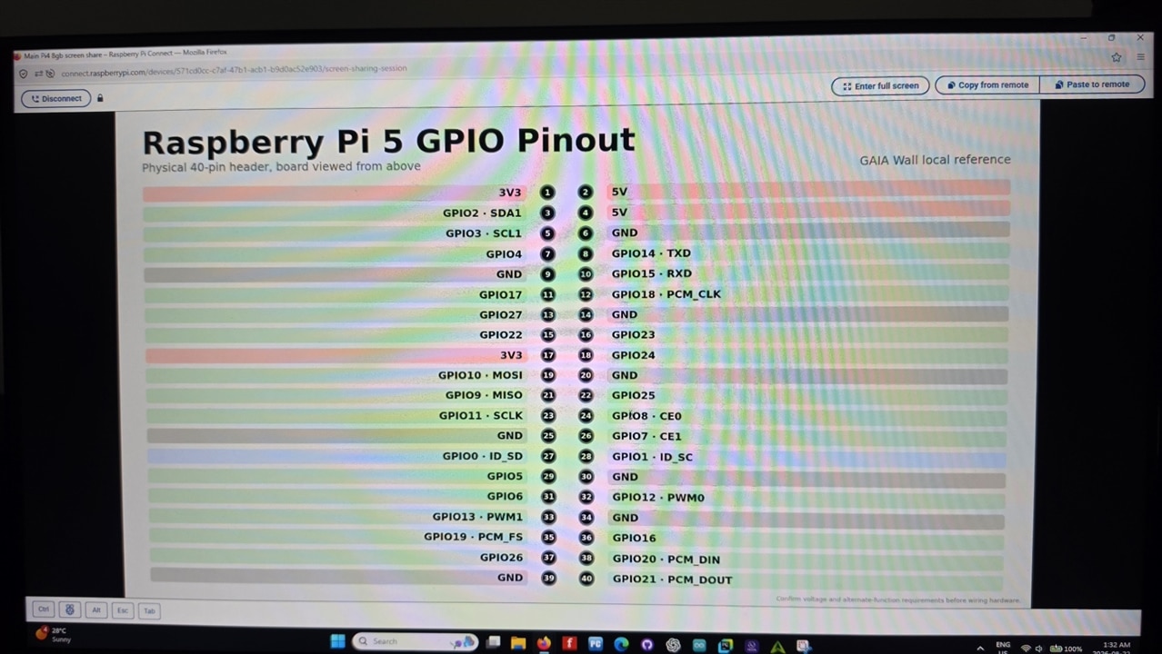

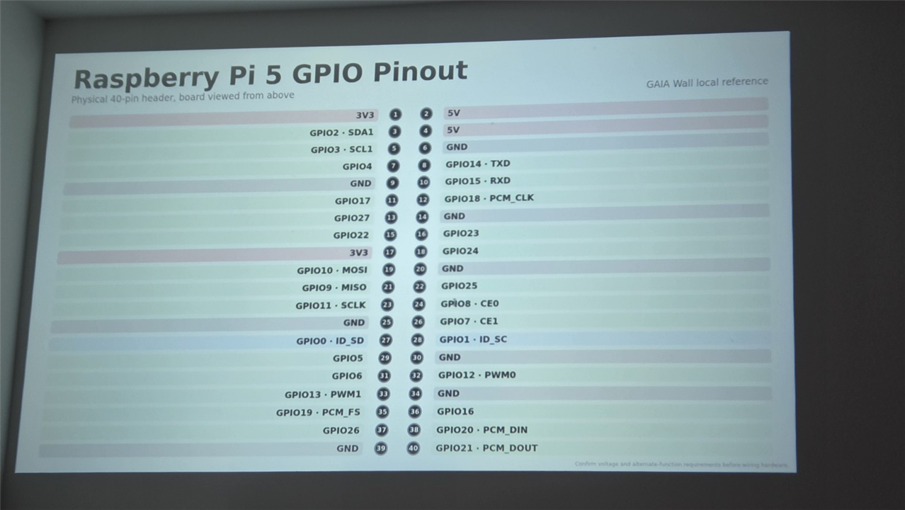

A closer view of the working projector output. The "GAIA Wall local reference" page is being rendered by the Wall node.
One of the first useful modes was a local electronics reference display. In this example the wall is showing a Raspberry Pi 5 GPIO pinout, exactly the kind of information I often want visible while working at the bench.
The same GAIA Wall reference mode viewed remotely during development and testing.

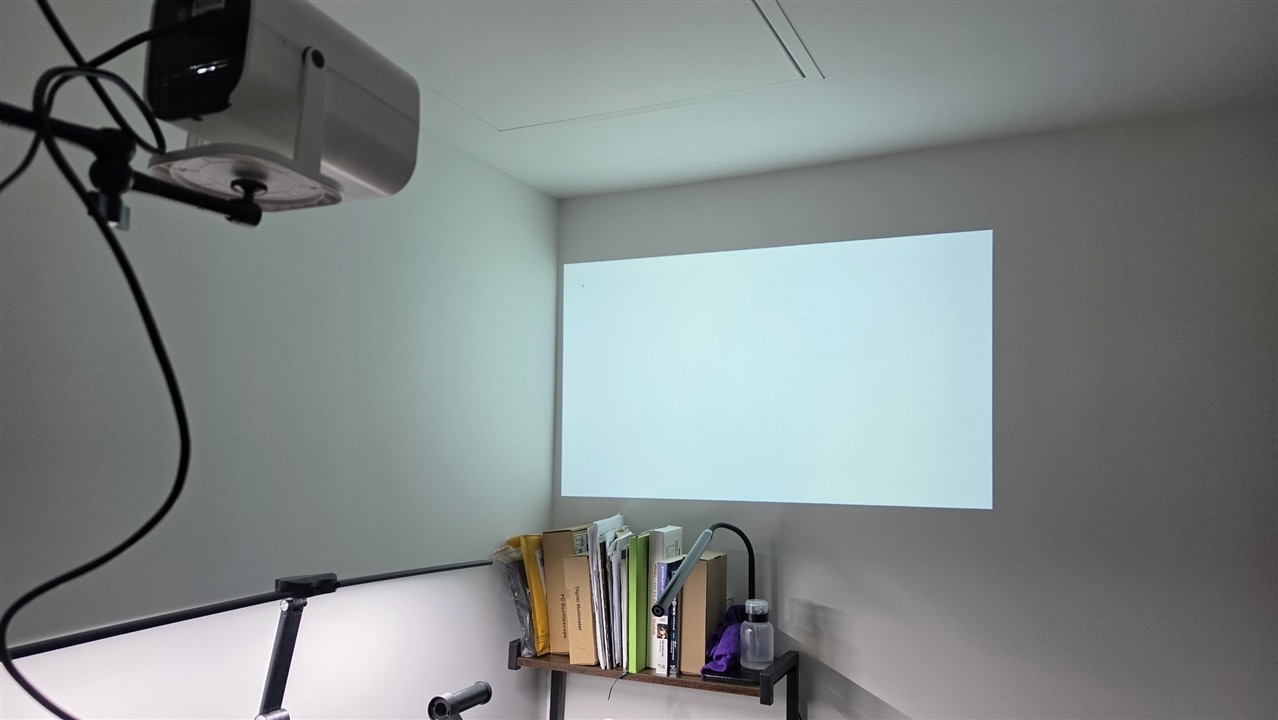

The Giant White Screen Problem
The next step was obvious: make it happen automatically when the Raspberry Pi boots. That is where things became more interesting.
After configuring Chromium to start automatically, I rebooted the Raspberry Pi. The projector came on. Chromium started. And I was greeted by a huge white screen.
Not quite the workshop command centre I had imagined.
The strange thing was that almost everything appeared to be working. The Raspberry Pi had booted, the projector was working, the GAIA Wall service was running, and Chromium had launched. But the display itself was blank.
If I closed Chromium and launched the exact same kiosk command manually a little later, GAIA Wall appeared normally. That was the clue.
The white screen issue during initial bootup.

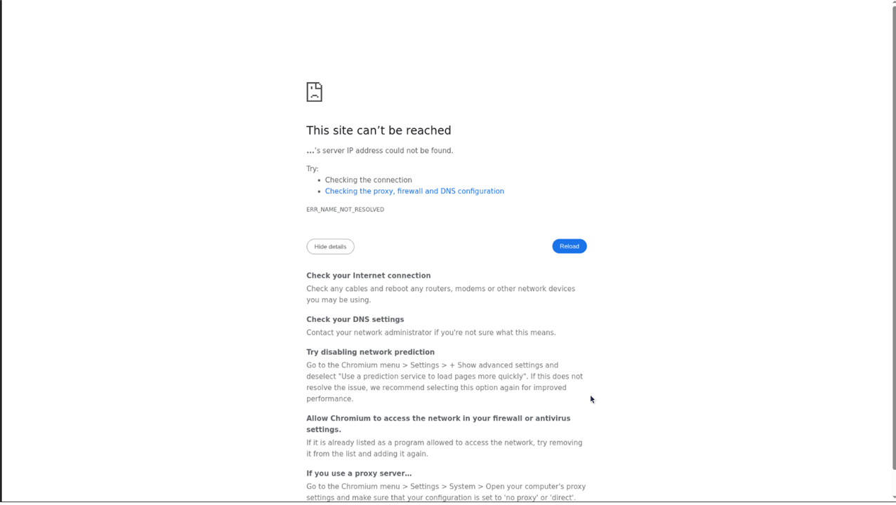

The problem appears to be a startup race. Chromium can launch before the graphical environment and Wall service are completely ready. The result can be a stale, blank or failed kiosk window even though the individual parts of the system are healthy.
During development I captured several failure states that helped narrow down the problem.
One early Chromium failure during Wall-node development. The browser was alive, but the target it expected was not available at that moment.
A Raspberry Pi remote session during startup troubleshooting. Desktop-session details such as the keyring prompt were another reminder that unattended kiosk boot is different from manually launching the same software later.
