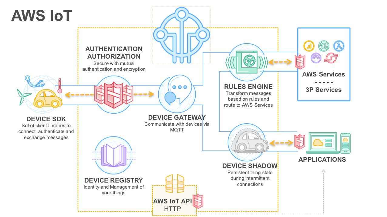

How Alexa controls the devices through skills
The devices respond to the instructions from users through MQTT with Manufacturer server as endpoint. By default, Alexa has no control over the devices unless the endpoints are exposed by the Manufacturers through skill integration. Alexa provides Smart Home skills to manufacturer so that they can implement the endpoints to be used by Alexa.
Image taken from an Alexa blog post

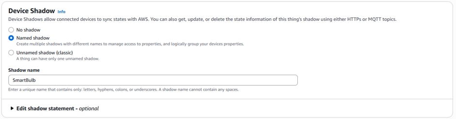

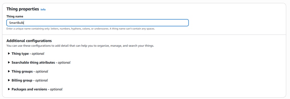

Creating a new IoT device with Shadow enabled
From the AWS management console, navigate to IoT and from the options, select things and create a new thing. Give the name as “SmartBulb” which will be our thing name we will use throughout this tutorial.
Leave rest of the configurations as it is.
Creating a named shadow
Select the named shadow option and provide the name as same as our thing name.

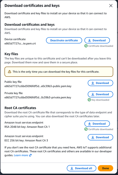

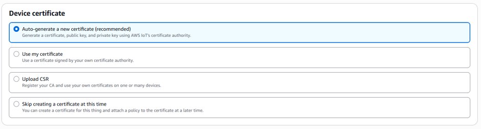

Generating certificates
Keep rest of the information as default and generate certificates. If you have your own CA signed certificated you can use them as well.

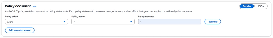

Creating policy

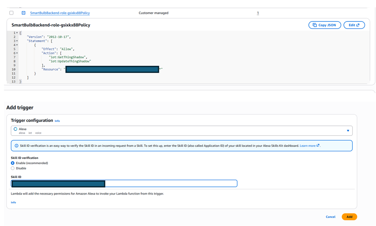

Policies allow to restrict the permission a device can have. For now, provide all permissions. We can later fine tune it to respond to Alexa alone. Here I already have a policy named “SmartPlantPolicy” which I use for all my test devices initially before fine tuning them. You can use “SmartBulbPolicy”

Download the certificates
Once the device is created, we will be prompted to download the certificates. Download and save them in a secure folder.

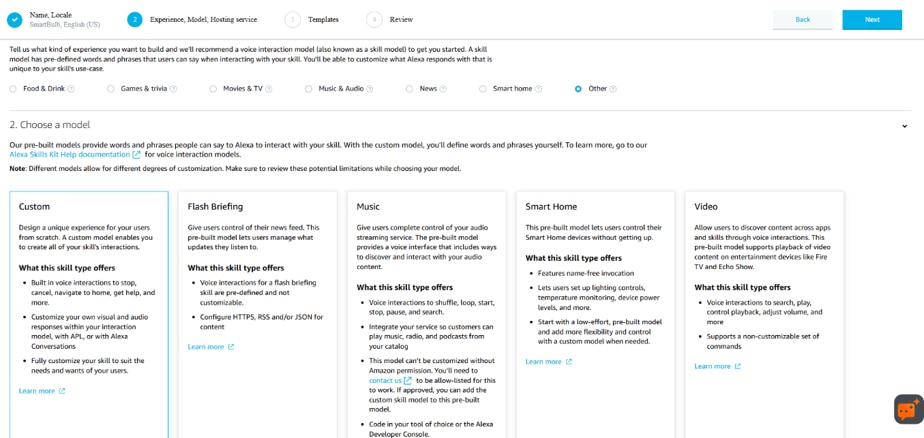

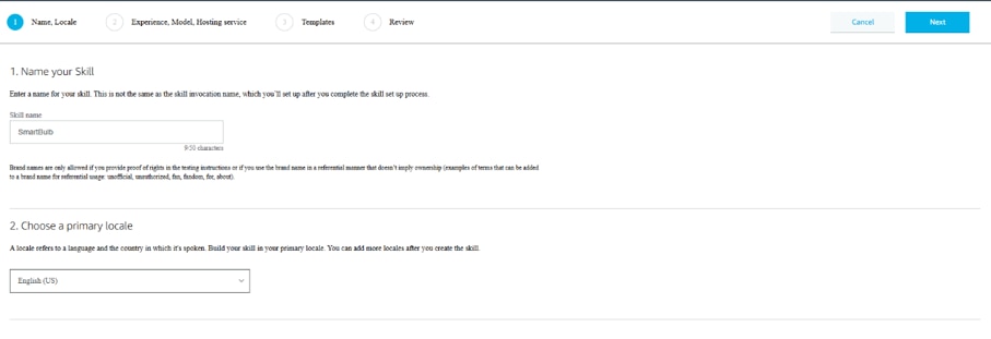

Creating an Alexa Skill through web portal
From the Developer Console navigate to create a new skill. Provide the name of the skill as “SmartBulb”. Click next.
List of Alexa Model available
Alexa comes with several models catering to different devices. For our requirement we will go with Custom options. Smart Home provides cookie cutter template, which is useful if your device matches it, but if you would like to mix in multiple properties it's better to opt for custom model. Even though our device will act as a simple switch we will use custom skill for now.

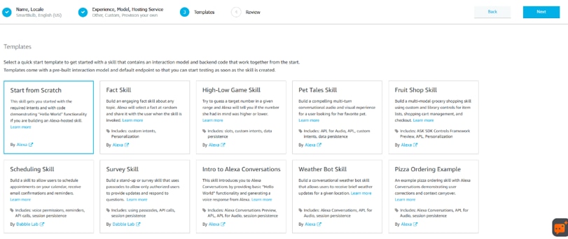

List of custom templates
Even for the custom options, there will be tons of predefined templates available, for now select "Start from scratch" option.

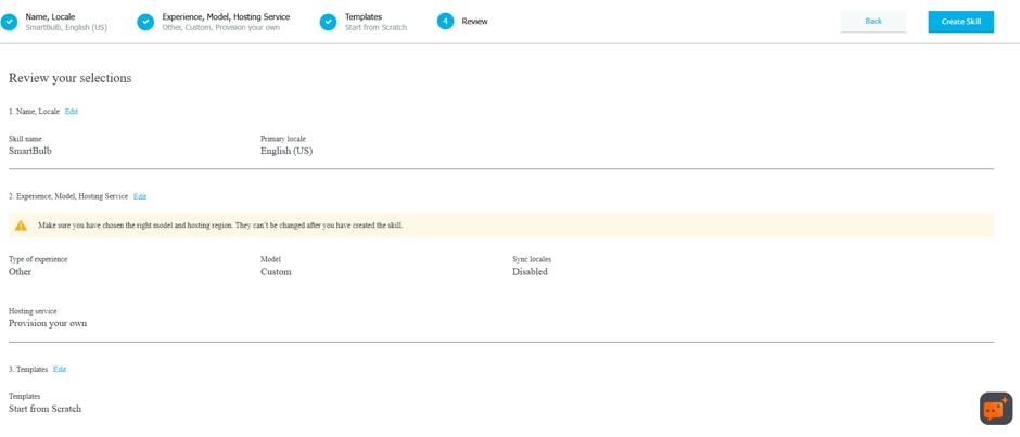

Review the options
Once the options are selected you will be prompted to review the changes and create the skill.

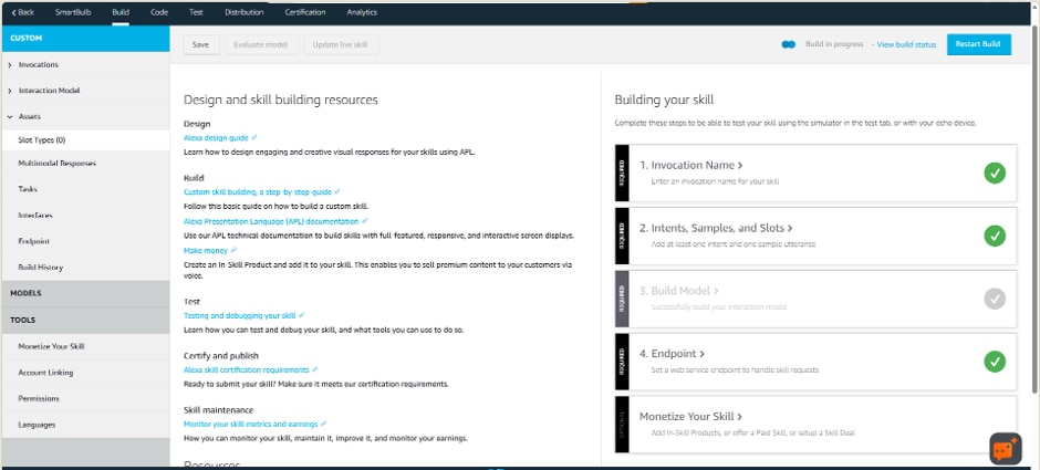

Build completion
If all the process are validated, you will be presented with build successful screen.

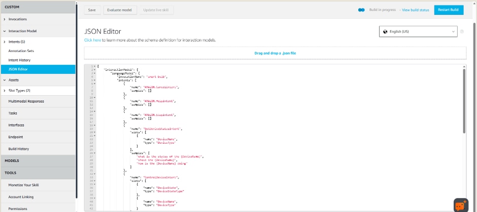

Update the Smart Bulb skill with custom options
In this section, we can make how our device behaves. There are multiple intent available, for our purpose we only need to enable the below intents and options alone.
  1. Since we will use this thing to turn on/off a GPIO, we can club together output devices which uses simple on/off logic using “DeviceType” for example,
    1. Bulb
    2. Fan
    3. Motor
  2. Getting device information through “GetDeviceStatusIntent”
    1. This permission requires read permission to be enabled on AWS IOT thing device shadow.
  3. Controlling the device state through “ControlDeviceIntent”
    1. This permission requires write permission to be enabled on AWS IOT thing device shadow
  4. Since we are exploring the device as a switch, we provide states as “On” and “Off” through “DeviceStateType” option.
The json file is attached along with this post.

Once the json file is uploaded, rebuild the skill.

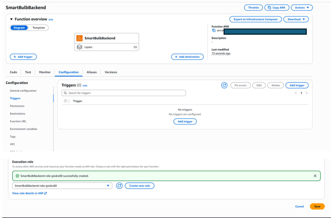

Create a lambda function
From AWS management console, navigate to AWS Lambda and create a python-based lambda.

Create a trigger and configure it to use Alexa skill
From the configuration section, click “Add trigger” and paste the Alexa Skill ID. Create a new execution policy that allows connecting to AWS IOT devices and fetch device shadow. Copy the function ARN, we need to paste this information in Alexa developer console.

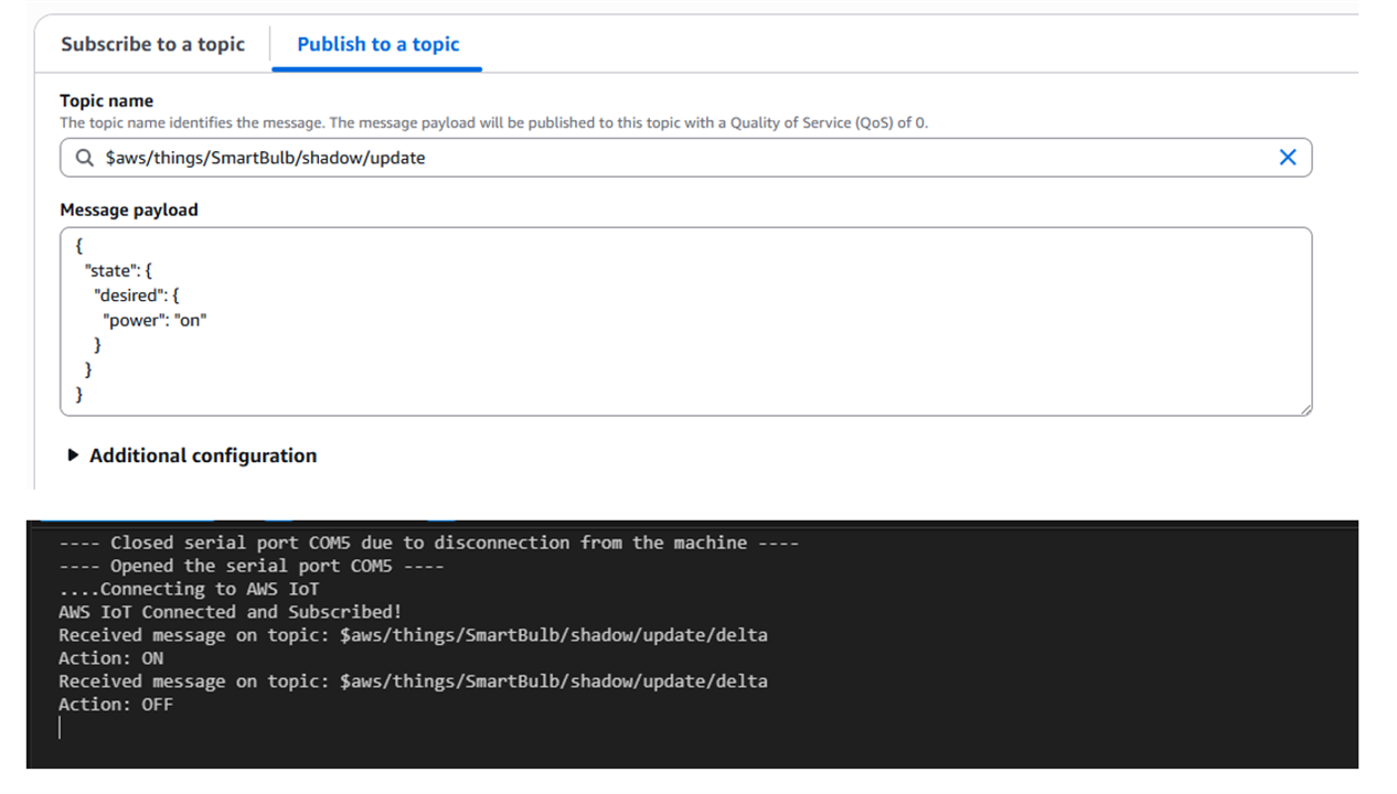

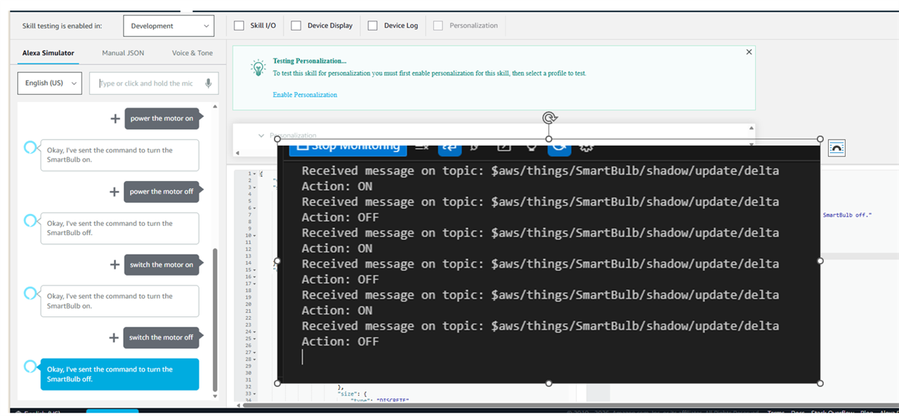

Testing our proof of concept: Testing communication between AWS IOT console and IOT device
Using Arduino IDE, create a new project and upload the below code to ESP32. From the AWS IOT management console page, using "MQTT client connectivity" tab, publish a MQTT message. If it's successful, we will see the below message in serial monitor.

// Device Certificate
static const char AWS_CERT_CRT[] PROGMEM = R"EOF(
-----BEGIN CERTIFICATE-----
-----END CERTIFICATE-----
)EOF";
// Device Private Key
static const char AWS_CERT_PRIVATE[] PROGMEM = R"EOF(
-----BEGIN RSA PRIVATE KEY-----
-----END RSA PRIVATE KEY-----
)EOF";
Testing communication between Alexa Skills dashboard and device
From the Alexa development dashboard, enter the message to turn on motor or light. You will receive the message in the device if all the device configurations are done properly.

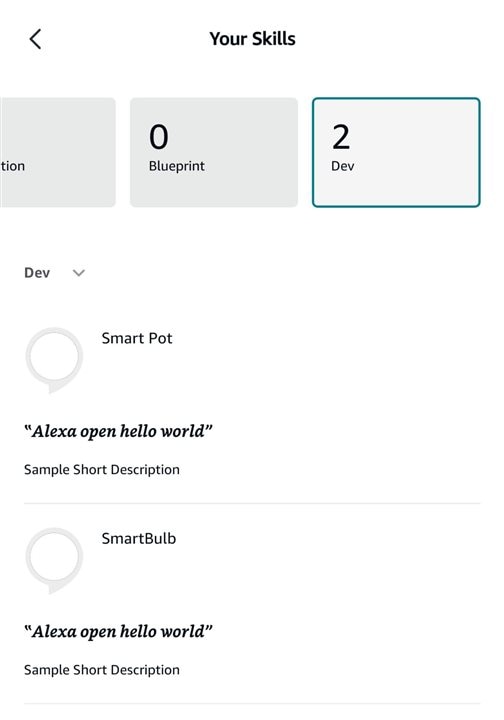

Connecting from mobile app
From the Alexa app, navigate to skills section, under "Your skllls", navigate to the skills you have created under dev section. By default they are enabled.
{gallery}Alexa Mobile Appp
Conclusion
That's it. We have created a custom skill that could provide us with as much privacy as possible. Once the device warranty is over, I will create a new post that will provide information on how to control a RGB device through custom skill and firmware.
