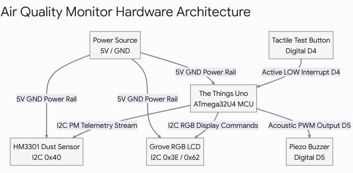

1. System Architecture & Physical Layer
This project utilizes a modular hardware ecosystem designed around the The Things Uno development board. The system integrates laser-based particle sensing, dynamic visual indication via a backlight-controllable display, physical user input, and acoustic feedback mechanisms to deliver a complete ambient monitoring solution.
  • I2C Bus (SDA / SCL): Connected in parallel with the HM3301 sensor (dust concentration readings) and the Grove RGB LCD display (text and backlight color control).
  • Digital Input (D4 - INPUT_PULLUP): Push button connected to ground (GND). Pressing it generates a falling edge (HIGH -> LOW) and triggers the test mode.
  • Digital / PWM Output (D5): Controls the piezoelectric buzzer using audio signals (tone()) to generate sound notifications.
  • Power Bus (5V / GND): Shared power supply line from The Things Uno board for the sensor, display, and auxiliary circuitry.

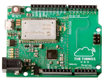

The Things Uno (ATmega32U4 Microcontroller)
  • Architecture: Based on the Arduino Leonardo / ATmega32U4 architecture running at 16 MHz.
  • Integrated I2C Bus: Features dedicated hardware I2C lines hardwired on pins D2 (SDA) and D3 (SCL).
  • Digital I/O & Pull-ups: Offers software-configurable internal pull-up resistors on GPIO pins (utilized on D4 for button debouncing).
  • Connectivity: Includes built-in Microchip LoRaWAN module capabilities for optional long-range IoT data transmission.

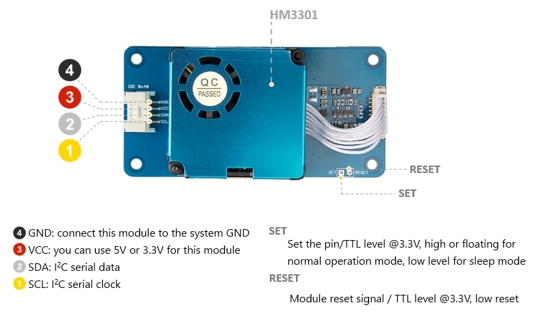

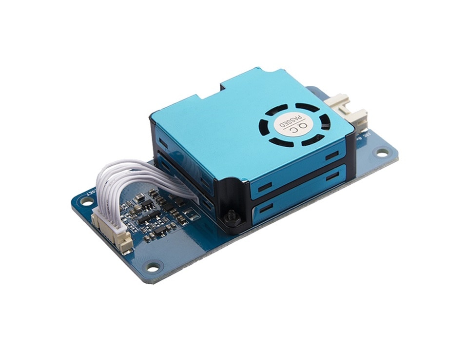

Grove - Laser PM2.5 Sensor (HM3301)

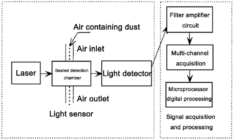

  • Measurement Principle: Employs laser scattering technology to continuously count suspended particles in the air.
  • Detection Metrics: Simultaneously measures mass concentration for PM1.0, PM2.5, and PM10 (ug/m^3).
  • Communication Protocol: Transmits data via I2C interface at fixed address 0x40 using a 29-byte telemetry frame protected by an 8-bit CRC checksum.
  • Operating Voltage: Requires a 5V power supply for the internal fan and laser diode driving circuitry.

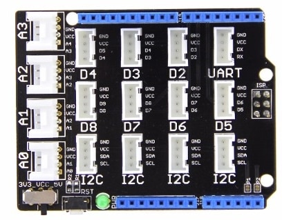

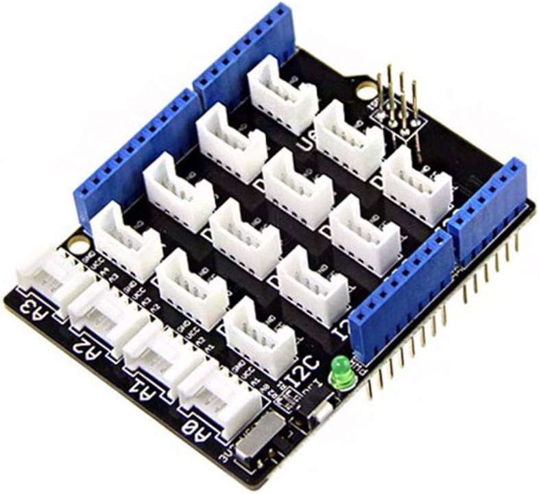

SeeedStudio Base Shield V2 16 x Grove Connectors for Arduino

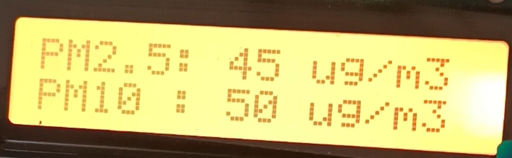

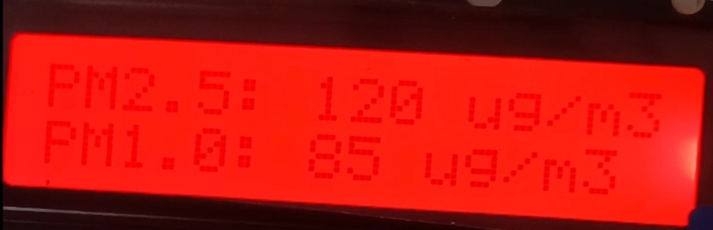

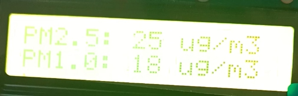

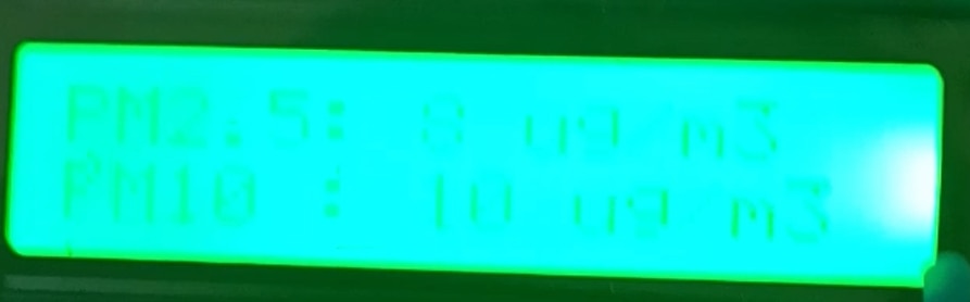

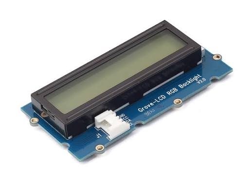

Grove - LCD RGB Backlight (16x2 Characters)
  • Display Capability: Displays 2 rows of 16 monochrome characters for numeric and textual data readout.
  • RGB Backlighting: Features an integrated multi-color LED backlight driver (PCA9633) controllable over I2C (Address 0x62 / 0x3E).
  • Dynamic Indicator: Allows programmatic color switching (Green, Yellow, Orange, Red) to visually reflect WHO Air Quality Index thresholds.

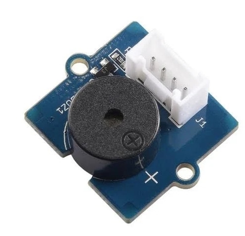

Grove Piezo Buzzer
  • Driver Interface: Connected to pin D5 using square-wave tone generation (tone() function).
  • Audible Alerts: Emits variable-frequency acoustic signals corresponding to system boot completion, simulated alert thresholds during testing, and sequence cancellations.
  • Power Handling: Driven with active low-state cleanup (digitalWrite(LOW)) to eliminate residual current drain and background high-pitched noise.

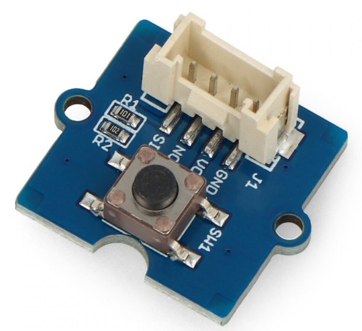

Grove - Button
  • Signal Logic: Configured as an active-LOW digital input connected between pin D4 and GND.
  • Input Sensing: Triggers state changes on falling-edge transitions (transitioning from HIGH to LOW) to prevent infinite looping when held.
  • Functionality: Provides user-driven execution of the manual RGB and acoustic diagnostic sequence.

The Seeed Studio Grove HM3301 utilizes MIE light scattering theory to count airborne particles. An onboard diode laser illuminates incoming airflow, and a photosensitive detector transforms scattered light into electrical pulses processed into particulate mass concentrations (ug/m^3).
In the Grove PM HM3301 laser sensor, despite the common colloquial use of the term "CRC", the manufacturer actually implemented a simpler and computationally faster Checksum mechanism (an 8-bit byte sum of the data frame).According to the official technical documentation, the sensor transmits a frame consisting of 29 bytes via the I2C bus. The first 28 bytes contain the header and the particulate matter concentration readings, while the final 29th byte (index 28 in the array) stores the checksum.
Checksum Calculation Algorithm
The logic is straightforward: you add up the values of the first 28 bytes of the received data frame. Since the variable storing the sum is an 8-bit type (uint8_t / byte), it automatically overflows (modulo 256). This eliminates the need for complex polynomial division operations. You then compare this calculated value with the byte stored at the end of the frame.

The Arduino operates at 5V logic level while supplying 5V power rails natively via USB or external supply, making it directly compatible with the HM3301's 5V power requirement and signal levels.
Sensor Pin (HM3301) Arduino Uno Pin Function
VCC (Pin 1) 5V System 5V Power
GND (Pin 2) GND Ground Reference
SCL (Pin 3) SCL / A5 i2c Serial Clock
SDA (Pin 4) SDA / A4 i2cSerial Data
SET (Pin 5) N/C Pull-up to High (Normal Operation)
Pin Mapping & Hardware Conflict Resolution
The The Things Uno board uses an ATmega32U4 microcontroller (equivalent to the Arduino Leonardo). On this architecture, digital pins D2 (SDA) and D3 (SCL) are hardwired to the primary hardware I2C bus.
To prevent signal contention between I2C communication and digital I/O:
  • I2C Bus (SDA / SCL): Reserved exclusively for the HM3301 Sensor and RGB LCD Display.
  • Button (D4): Relocated from D2 to D4 to prevent holding SDA low.
  • Buzzer (D5): Relocated from D3 to D5 to prevent outputting I2C clock pulses as audible high-pitched noise.
Wiring & Pinout Guide
Component Component Pin / Connector The Things Uno Board Pin Connection Notes
HM3301 Sensor Grove I2C Connector I2C Port (SDA/SCL) Powered via 5V rail
RGB LCD Display Grove I2C Connector I2C Port (SDA/SCL) Shares I2C bus (Address 0x3E / 0x62)
Tactile Button Terminal A Digital Pin 4 (D4) Uses internal INPUT_PULLUP
Terminal B GND Short to GND on press (diagonal pins)
Piezo Buzzer Positive (+) Pin Digital Pin 5 (D5) PWM / Tone output pin
Negative (-) Pin GND Ground reference

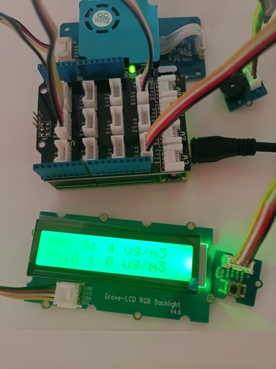

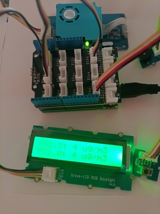

2. Assembled project

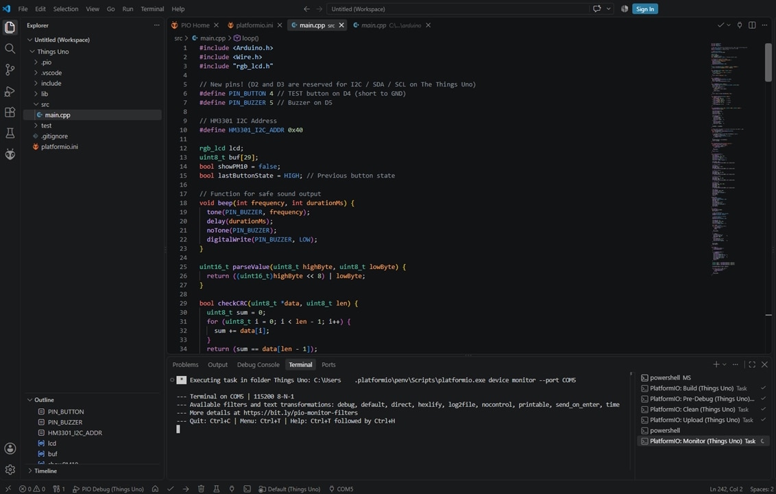

The firmware for this project was developed using Visual Studio Code integrated with the PlatformIO IDE extension. This modern embedded development setup replaces traditional environments like the Arduino IDE, offering professional dependency management, advanced code autocompletion, real-time debugging capabilities, and automated build system integration.
Key Characteristics & Advantages
  • Visual Studio Code (VS Code)
    • Lightweight Code Editor: Provides a fast, flexible, and extensible source code editing environment.
    • IntelliSense & Navigation: Delivers code autocompletion, instant syntax checking, and fast navigation through complex functions and class structures.
    • Built-in Terminal: Allows direct execution of command-line tools, Git operations, and serial communication monitors.
  • PlatformIO IDE Extension
    • Automated Dependency Management: Automatically fetches, configures, and tracks third-party libraries (e.g., Grove - LCD RGB Backlight) using the project's platformio.ini configuration file.
    • Multi-Platform Build System: Handles cross-compilation for various microcontroller targets (in this case, the atmelavr platform for the ATmega32U4 chip on The Things Uno).
    • Integrated Serial Monitor: Features a built-in terminal for debugging output via USB Serial at customizable baud rates (e.g., 115200 baud).
    • Strict Version Control Integration: Keeps library versions pinned to guarantee consistent builds across different machines and team members.
## Development Environment
* **IDE:** Visual Studio Code
* **Ecosystem / Extension:** PlatformIO IDE
* **Framework:** Arduino Framework
* **Platform:** Atmel AVR (`atmelavr`)
* **Target Board:** The Things Uno (ATmega32U4 / Leonardo)
3. Environment Configuration (platformio.ini)
Ensure your environment dependencies and build target are configured correctly:
[env:thethingsuno]
platform = atmelavr
board = leonardo
framework = arduino
monitor_speed = 115200
lib_deps =
    seeed-studio/Grove - LCD RGB Backlight @ ^1.0.0
4. Complete C++ Source Code (src/main.cpp)

  // Stage 2: Yellow Test
  lcd.clear();
  displayData(18, 25, 30);
  beep(1000, 100);
  if (delayWithInterrupt(1800)) goto cancel_test;
  // Stage 3: Orange Test
  lcd.clear();
  displayData(35, 45, 50);
  beep(1200, 100);
  // Stage 4: Red Test
  lcd.clear();
  displayData(85, 120, 150);
  beep(1800, 150);
  delay(100);
  beep(1800, 150);

5.1. Includes & Pin Definitions
#include <Arduino.h>
#include <Wire.h>
#include "rgb_lcd.h"
#define PIN_BUTTON 4 // TEST button on D4 (short to GND)
#define PIN_BUZZER 5 // Buzzer on D5
#define HM3301_I2C_ADDR 0x40
  • #include <Arduino.h>: Provides standard Arduino functions (pinMode, digitalRead, delay, etc.).
  • #include <Wire.h>: Enables I2C hardware communication used by both the LCD and the HM3301 sensor.
  • #include "rgb_lcd.h": Library controlling the Grove RGB Backlight LCD.
  • PIN_BUTTON & PIN_BUZZER: Reassigns button and buzzer to digital pins D4 and D5 to avoid conflict with I2C pins (D2/SDA and D3/SCL on the ATmega32U4).
  • HM3301_I2C_ADDR: The fixed 7-bit I2C address (0x40) for the HM3301 sensor.

5.5. Sensor I2C Communication (initHM3301 & readHM3301)
bool initHM3301() {
  Wire.beginTransmission(HM3301_I2C_ADDR);
  Wire.write(0x88);
  return (Wire.endTransmission() == 0);
bool readHM3301(uint8_t *data) {
  Wire.requestFrom((uint8_t)HM3301_I2C_ADDR, (uint8_t)29);
  uint8_t idx = 0;
  while (Wire.available()) {
    if (idx < 29) {
      data[idx++] = Wire.read();
    } else {
      Wire.read();
  return (idx == 29 && checkCRC(data, 29));
  • initHM3301(): Sends command byte 0x88 over I2C to activate the sensor. Returns true if transmission succeeds (endTransmission() == 0).
  • readHM3301(): Requests 29 bytes from address 0x40. Reads bytes into buf and checks validity with checkCRC().

5.12. Visual and Acoustic Indicator Logic
The display features a dynamic RGB backlight that automatically changes color based on the real-time PM2.5 dust concentration levels (measured in ug/m^3), adhering to global Air Quality Standards:
  • Green (RGB: 0, 200, 0): Good Air Quality (<12ug/m^3) — Safe levels; standard operation.
  • Yellow (RGB: 255, 200, 0): Moderate Air Quality (13 - 35ug/m^3) — Acceptable air quality.
  • Orange (RGB: 255, 80, 0): Unhealthy for Sensitive Groups (36 - 55ug/m^3) — Elevated pollution levels.
  • Red (RGB: 255, 0, 0): Unhealthy Air Quality (> 55ug/m^3) — High pollution alert.

The environmental metrics acquired by the HM3301 sensor correspond to WHO Air Quality Guidelines.
Parameter Good Moderate Unhealthy / Hazardous Measurement Unit
PM1.0 0 - 12 13 - 35 > 35 ug/m^3
PM2.5 0 - 12 123 - 35 > 35 ug/m^3
PM10.0 0 - 54 55 - 154 > 155
ug/m^3
Conclusion
This implementation establishes a stable, low-latency Indoor Air Quality edge monitoring system. The combination of the The Things Uno module and the optical precision of the Grove HM3301 allows seamless, low-cost sensor deployments suitable for smart home platforms and environmental research.
