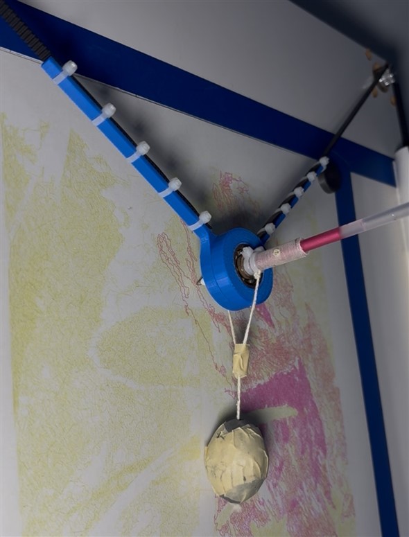

Ink Bot's mechanism consists of a pen held against a piece of paper on a slightly angled vertical board. This pen is held by a component commonly referred to as a gondola. The gondola is weighed down so that the pen presses into the board. Each arm of the gondola connects to belts that run up to and over the stepper motors' pulleys. There are counterweights on the other ends of the belts so that when the stepper motors move, the lengths of the belts connected to the gondola change, causing the pen to move around on the page. An Arduino is used to communicate drawing instructions to the stepper motors. The drawing instructions are generated separately depending on what the desired effect is, and more information about these algorithms is detailed in the next section.

The Ink Bot mechanism was mostly built out of repurposed materials, and I encourage anyone trying to recreate this to do the same! The dimensions of your drawing surface don’t matter since you can always adapt your code to account for different geometries. I was lucky enough to have a repurpose store nearby, but you can look around to see what people are getting rid of on Craigslist and Facebook Marketplace, local thrift stores, or even see what kind of junk people leave on the curb. Here is the entire Ink Bot mechanism, broken down piece by piece:
(1) I used an 11/16” thick, 20 ¼” by 34 ¾” board from the repurpose store as the drawing surface, drilling one 1” hole surrounded by four 1/8” holes in each corner to mount the stepper motors as seen below:
The four 1/8” holes were each countersunk since the bolts I had handy for my stepper motors were too short to go through the board.
(2) Then I cut two 3 ½” by ¾” planks at a 14-degree angle to act as the legs to prop up Ink Bot and drilled them into the back of the board at the bottom corners. I also reinforced these with vertical supports made of the same planks, but this was more of an aesthetic choice than anything.
(3) I designed a Gondola (the pen holder) to incorporate used skateboard bearings and had it 3D printed through my school’s design lab.
This Gondola was printed after a couple of iterations of prototypes that I built out of tape, cardboard, and old gift cards cut up, so you can get creative with this. There are better gondolas out there, but I wanted to challenge myself by coming up with my own.
(4) I used zip ties to connect the gondola arms to the timing belts, and string to hang the counterweight from the gondola.
(5) Finally, I cut a 1 ½” inner-diameter, 23” long PVC pipe along its length and glued each half along the sides to act as guides for the counterweights, which were attached to the opposite ends of the belts using zip ties and strings.
The entire Ink Bot mechanism is not perfect by far, but that is the beauty of it. It can be made with no overly special tools, for relatively cheap, and it can be programmed to create some pretty impressive drawings.

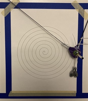

Various Mechanical Issues
I won’t go into too much detail here, but designing the gondola and finding the right amount of counterweight to use were challenges that just required some iterative design and trial and error to work through. To prove it to you, here are some pictures of the first two gondola iterations:
gondola iteration 1     gondola iteration 2
The first gondola was made entirely out of cardboard and painter's tape, and the second was made using cut-up and glued-together hotel key cards. These iterations helped me figure out the geometry needed for the 3D printed gondola.
Calibration
Speed and position calibration were also problems that required some good old trial and error. I printed the same picture over and over again using a ton of different max stepper motor speeds and landed on one that I think has a good balance between the time it takes to print and the shakiness in the pen lines. For position calibration, I printed a large rectangle over and over again while tweaking Ink Bot’s geometry in the code that converts the x,y coordinates to stepper motor steps. I did this until the rectangle’s side lengths matched the prescribed side lengths almost perfectly.
