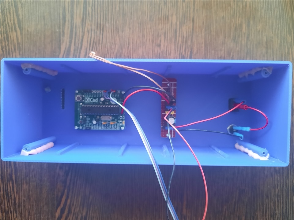

Hi makers!
As I said in the title, my project is not yet ready to fully show itself, but it is not far off. You will see in the following pictures what components I want to use, and you will probably understand the project more easily. It is a project that involves LEDs, as they are still the most "colorful" components.
And now, let's do a short introduction, first a visual one.
{gallery}Visual intro
IMAGE TITLE: Interior
IMAGE TITLE: Back view
IMAGE TITLE: Placing the display
IMAGE TITLE: Front view
Purpose
My goal is to create an offline project, and here I mean not using internet connections, because I don't have any others, to monitor the environment, but at the same time I don't want it to be so banal, so I switched from DHT22 to a module that also incorporates ENS160. And that's not all, I want to have a more animated display. Wink
Components used:
Mostly, the necessary parts are:
• microcontroller (I use the "old" ATMega328);
• a matrix panel (I use 8x25);
• ENS160+AHT21 (temperature, humidity, air quality index);
• wires and connectors or courses;
• and a bit of manual work. Nerd
At the electronic diagram level we have something like this:
I know it's a minimal representation, but given the number of components, I don't think you can really put it in any difficulty. The actual connections to the MCU are up to you, but you can easily deduce them from the program below.
The microcontroller is a well-known one, ATMega328, which I soldered onto a minimal board (I've used it on other projects before). There's not much to say about it, or maybe there is ThinkingSweat smile.
ENS160 is a compact solution for monitoring indoor air quality by detecting VOC and AHT21 by measuring temperature and humidity. It connects quickly to boards like Arduino and other platforms via I2C or SPI, plus it operates at 5V with low consumption of approximately ~10mA.

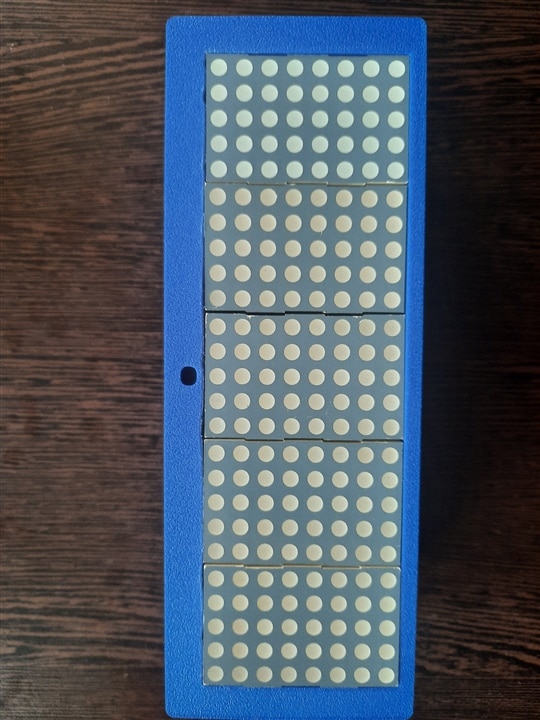

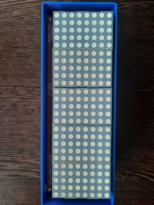

The display is made up of 5 8x5 LED matrix pieces (I think I've presented PCB v1 here before, homemade virianta) with MAX7219 as driver. I would say that the display is unique, in the sense that it is not found in stores, but after all, that's the pleasure of building.
I also added a resistive divider with LDR to automatically adjust the display's brightness, a pretty handy method, so I don't think another module is needed.
