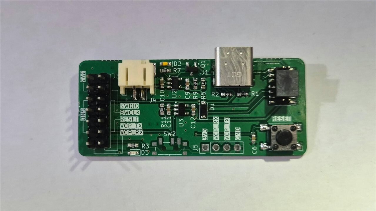

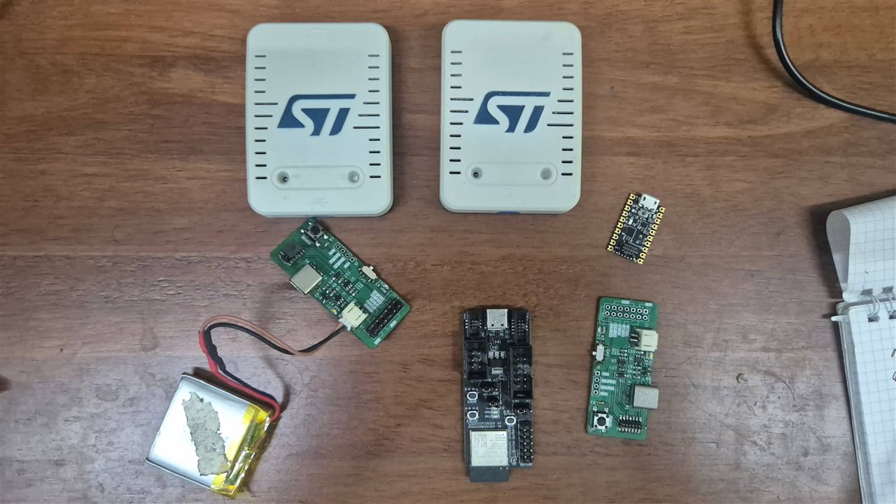

When it comes to work projects, 80% of the time for my primary MCU I work with STM32 family chips, 15% I work with Nordic Semiconductor SOCs, and the last 5% is something very specific. And when it comes to hobby it's a mixed bag. Given the large percentage of STM32, I had invested in an STLink V3, in fact I have access to two (one belonging to my College), and I use an nRF52 DK to program the nRF52 on custom boards using 6 individual male-male jumper wires. But as the scale of the work started increasing and the types of clients increased, it became more work-intensive to switch between different programming interfaces and cables.
Now, the STLink V3 has an STDC14 connector and comes with two cables - STDC14 to STDC14 and STDC14 to ARM10 - they both have a 1.27mm spacing. But some clients wanted 2.54mm connectors, either in IDC format or simply a bare minimal 4-pin connector like the one seen on Blue Pills. There was another requirement: the STLink V3 does not power the board, it only has a VCC pin to detect the voltage level. There were times when the assembly process of clients required the board to be programmed before the battery is attached, and without an additional connector/test point to power the board, it became difficult. So last year, to handle the 1.27mm/2.54mm and the power issue, I made an interface board. This has a LiPo with an MCP73831 charger and ideal-FET power path, this way I can choose to power the actual board, all using one IDC connector.

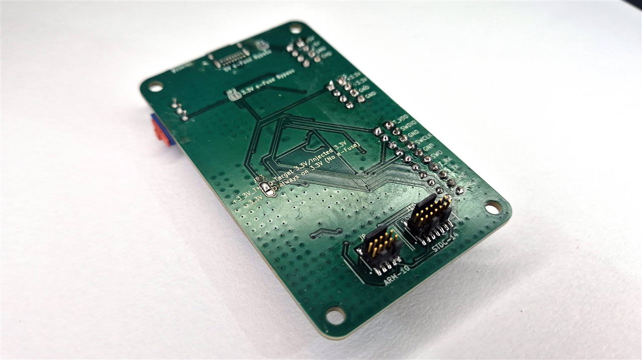

Coming to usability, after talking to a couple of heavy users, I decided to copy the STLink V3: have the STDC14 connector at the bottom along with the ARM10. For the 2.54mm connectors, I'll have one row of male and one row of female connectors, that way it's more flexible. Also, in rare cases where clock jitter is causing corruption of the UART lines, I can attach a logic analyzer to debug it while using the 2.54mm connectors.

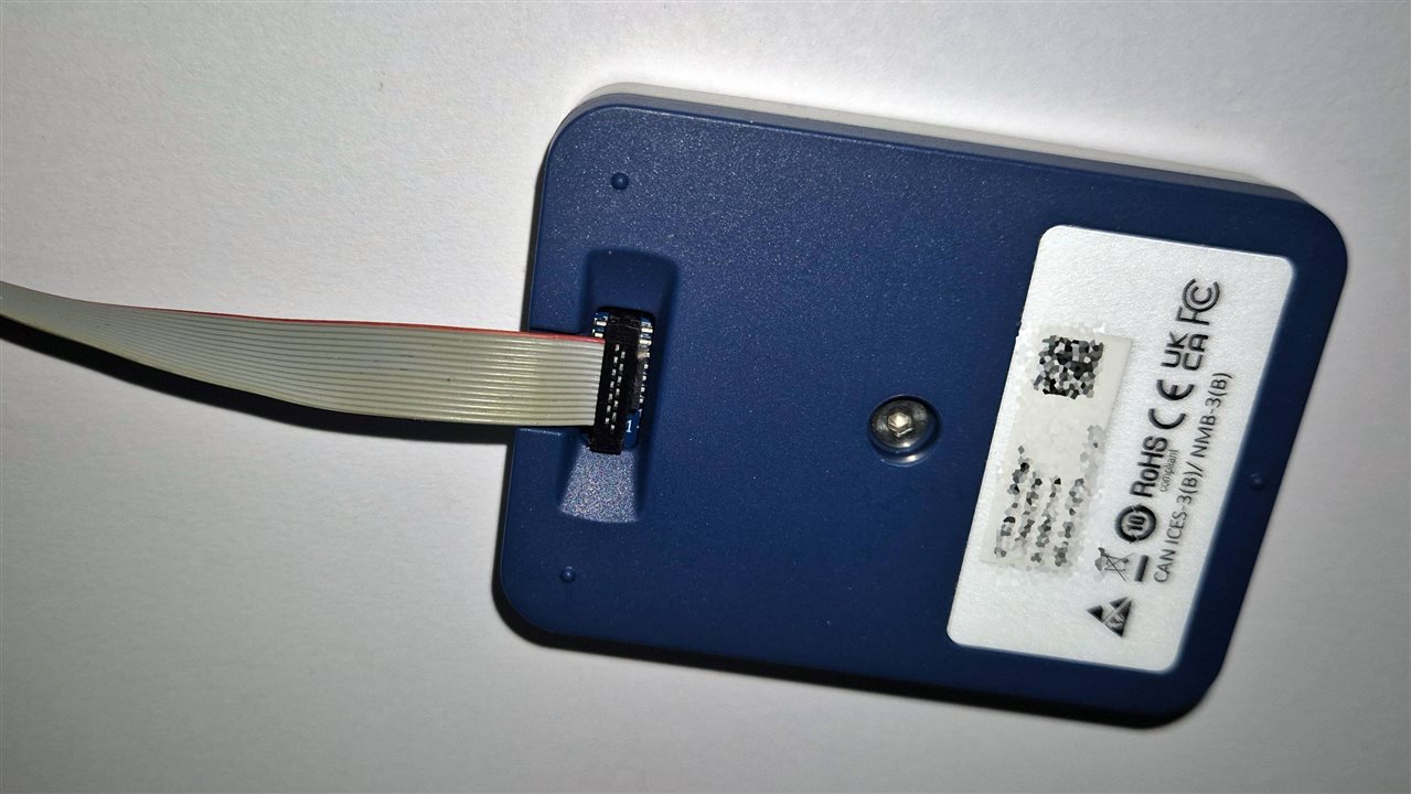

Underside of he STLINK V3
3 groups of 2.54mm connectors have been planned: a 5V + GND set, a 3.3V + GND set, and another set with the SWD + UART connectors. Plenty of pins to use. I did drop the LiPo battery, because in the last design it became more of a hassle to place the LiPo safely away from the header pins that could poke it. And also, with the current design we're powering the programmer and the board using one USB, so it's no longer needed.

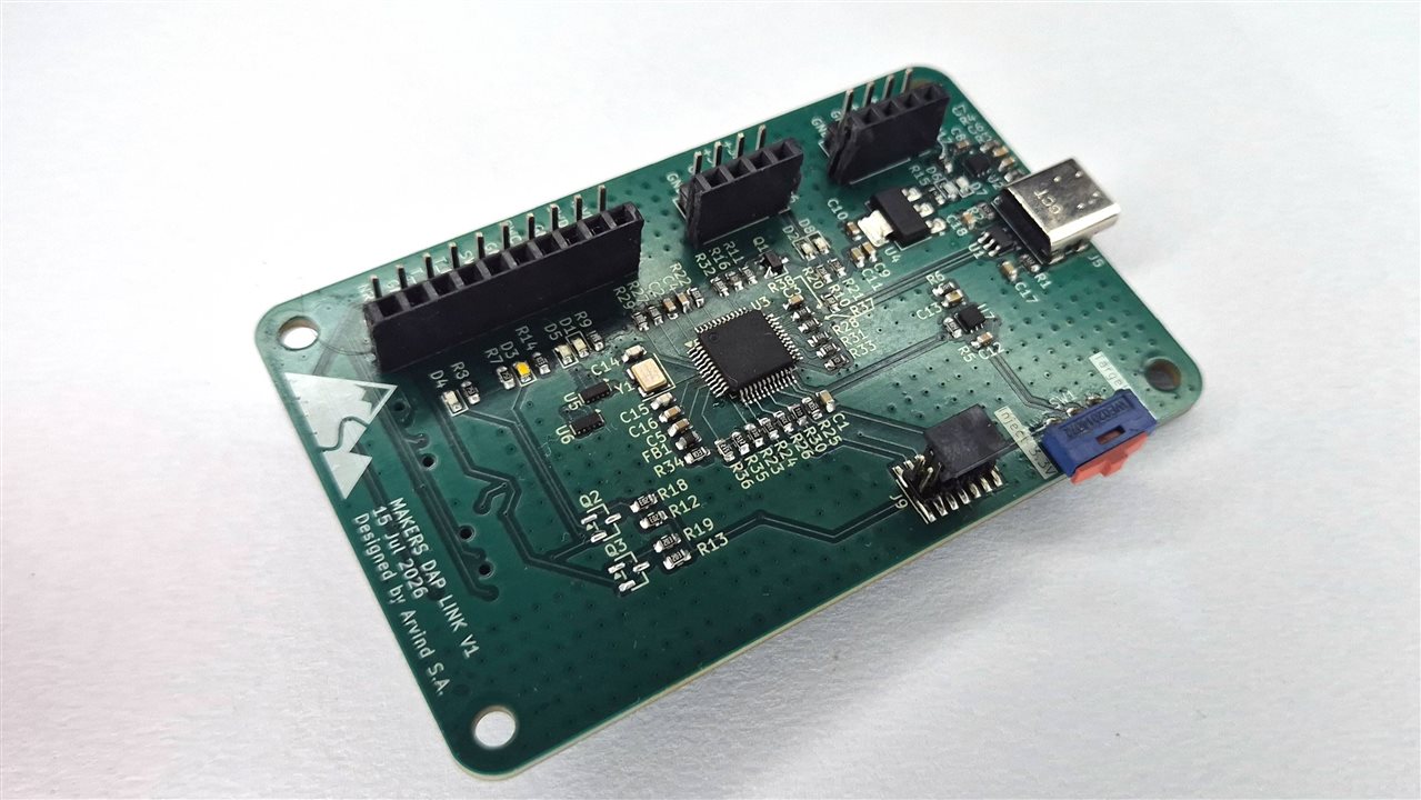

Here is my final Schematic
Mechanically, the board landed on a 50x90mm portrait shape, USB-C on top, connectors running down one long edge, 4-corner M3 mounting. After the Assembly it looked like this. Note how lined up the passives are around the STM32.

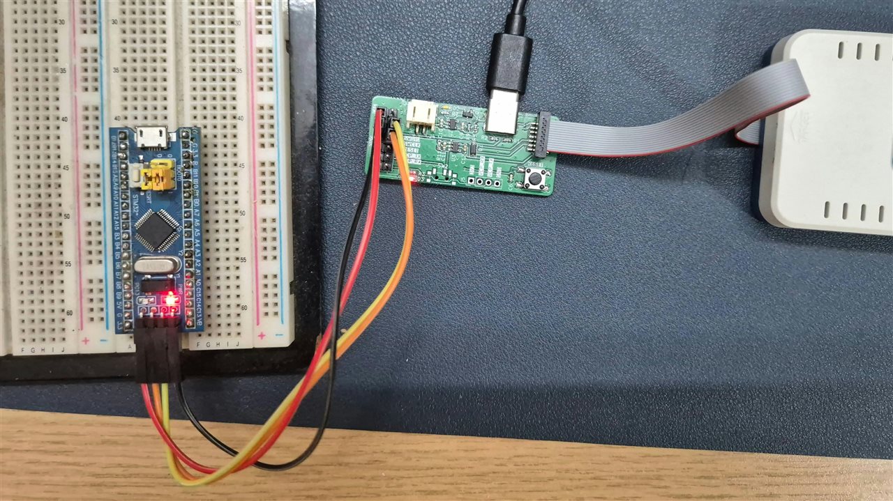

I Successfully manged to program, verify, extract firmwares on STM32, Nordic, MAX52632, and couple of other vendors too. The Programmer does show up as COM port, but it is not working. Argh, This is the problem with using Pre Compiled Firmwares Lazily. No Problem, I will flash a custom firmware to check if there is any error with the circuit before I blame the firmware. My Clients did love the Concept and the final design. Now, to make few of them and give it.
