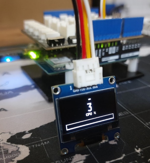

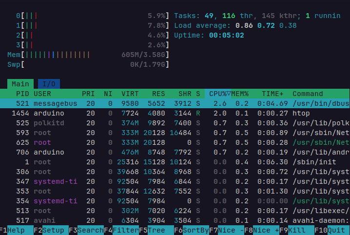

For the last few weeks, I’ve had an Arduino UNO Q sitting on my desk, quietly running Hermes Agent. Most of the time it is not seen. No screen, no blinking lights that signify anything, just a small board doing work I can't see.
Occasionally, I’d ssh in, run htop, stare at a wall of numbers, and close terminal again. It worked, but it never felt quite right.
A machine that was actually doing something, thinking, responding, sometimes working hard enough to get warm, deserved better than a terminal window I had to remember to open.
Hence, I added a small SSD1306 OLED display that was connected through I2C with the help of a Grove Base Shield and was in a position to show the CPU load, RAM, temperature, and network throughput on a rotating set of screens.
What made this project interesting, however, was not just the display but also coming up with a way of distributing the workload onto the two very different processors of an UNO Q as well designing user interface which does actually deserve a space on a 128x64 black and white screen.
Using the RPC Bridge

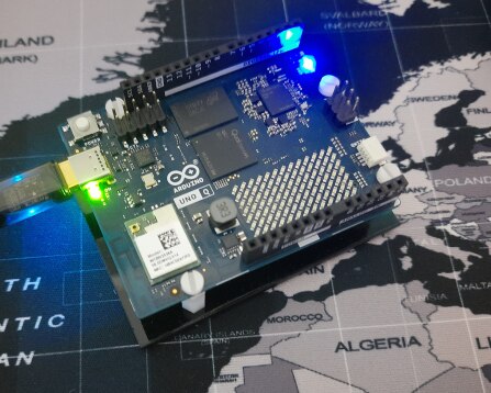

The UNO Q has the looks of any ordinary UNO board, yet hidden inside this usual form factor is a pair of controllers sharing a single PCB. One is Qualcomm’s Dragonwing QRB2210 SoC that is capable of running full Debian Linux, while the other is STM32U585 microcontroller functioning according to Arduino sketch model. Hermes exists on the Linux side and this side has a real filesystem built upon Linux allowing the use of Python and package management. The two sides communicate with each other over RPC layer Arduino calls Bridge - therefore one can call Bridge.call() in Python and this call will be caught in the sketch with the use of Bridge.provide().
Overall, the first real design question was which side should own the display. Driving the display directly from Python seems like the easiest path, because there are many libraries that work with display, direct I2C access and absence of any RPC layer to bother about. However, I did not want to go this route, because the Linux side of the board has real tasks to carry out. Whenever Hermes is busy on doing something with the aid of Python code, that Python
Thus, I changed the arrangement. The Linux's task is very clear: to poll psutil every second and tell it the values of the CPU, RAM, temperature, network throughput, and uptime.

Building the OLED UI
Monochrome displays provide a different approach to design thinking than greyscale displays do. It does not include any shading or soft edges; pixels can either be on or off. Therefore, the solution lies not in some dithering tricks but instead in the good use of bold shapes and large white space instead of cramming in every single number into one dashboard.
The dashboard consists of three rotating screens that change every 4 seconds, with each screen having its own identity.
The Hero screen answers one question immediately: How much is the CPU currently working? A large table number displays the CPU usage percentage in the center.

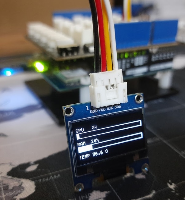

The Vitals screen exchanges a simple interface with figures entailing the CPU and RAM levels along with a temperature reading underneath the bars.
This would be his application is closest to htop but has been cleverly simplified into a format that one can read from afar.

This is done intentionally as there is no need for any concepts with the features. A standard graph is a good enough idea and does the work well.

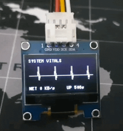

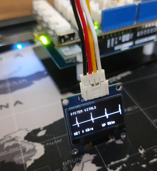

The Pulse screen is the most interesting and entertaining part of the whole project and connects the whole project with the purpose of what it does.
Unlike the previous screen, the Pulse uses ECG-style rolling wave features formed by a straight line with the peaks according to the CPU and RAM load. When idle, it beats slowly but speeds up in case of high-load situations.
