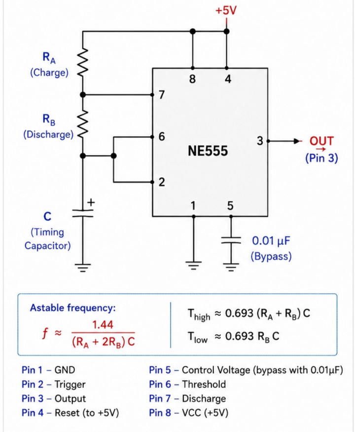

  • NE555 timer IC — pulse generation in astable mode
  • CD4017BE decade counter — counting and dividing the generated pulses
  • Resistors — setting the timing characteristics of the 555, 10K ohm and 220 ohms for leds
  • Capacitor — setting the timing characteristics of the 555, 100uF

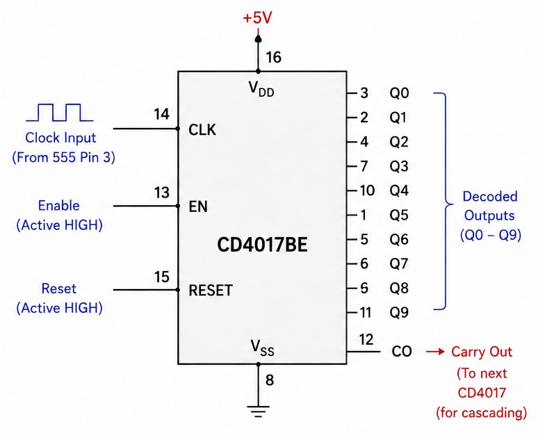

I also remembered another IC from digital electronics: the CD4017BE decade counter. It can sequentially activate ten decoded outputs, Q0 through Q9, in response to clock pulses supplied to its clock input.
So I decided to combine the two:
NE555 Timer → periodic pulses → CD4017 Decade Counter → elapsed-time output → LED/Buzzer
{gallery}Circuit Diagrams
My initial architecture was therefore to generate a pulse as consistently as possible, ideally somewhere in the range of a few seconds per pulse, and then use the decade counter to count those pulses. By taking an output from one of the later counter stages, I could create a much longer delay than the individual 555 pulse period.
For example, if one pulse represented approximately 5 seconds, the tenth counted pulse would represent approximately 50 seconds. An LED or buzzer connected to an appropriate counter output could then act as the alert.

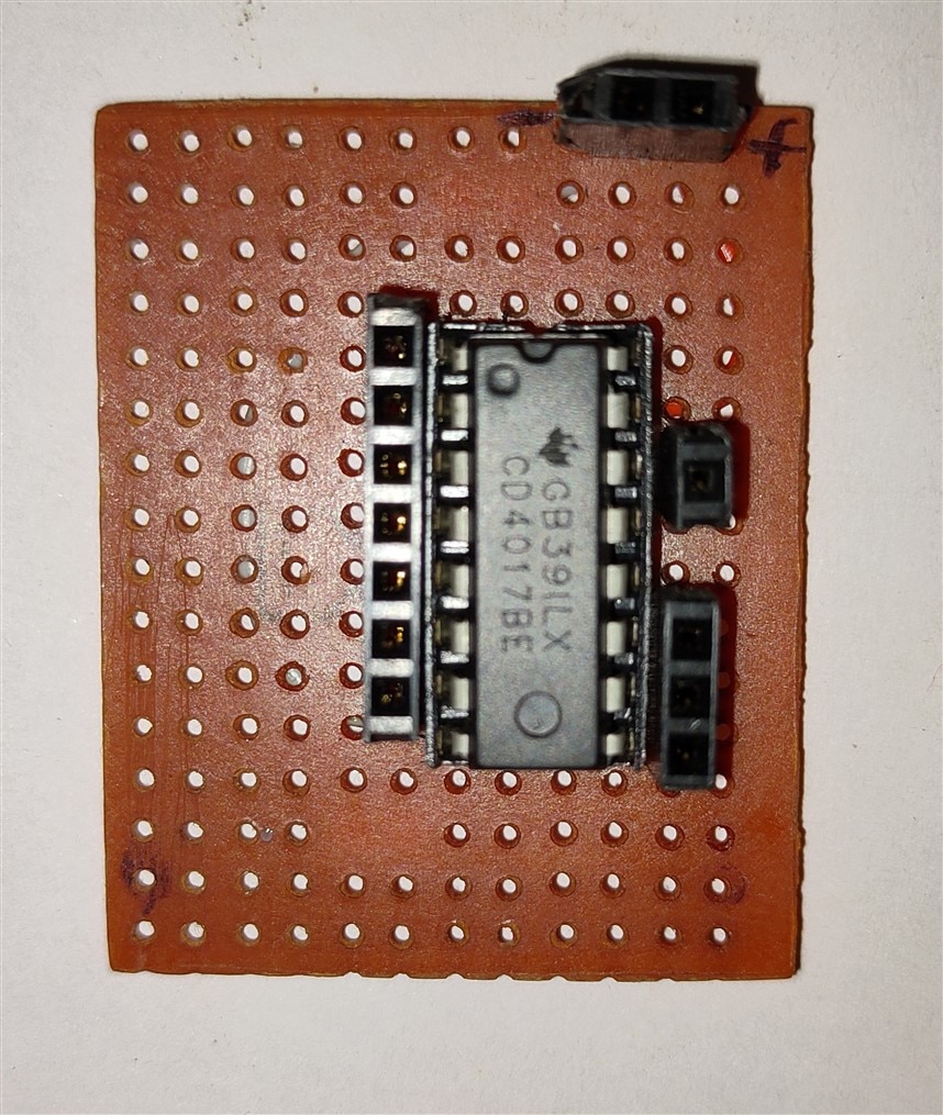

I initially ordered the decade counter along with components for my other electronics projects. I deliberately ordered only one CD4017, because I expected that I would be able to configure the 555 to produce a sufficiently long pulse period that a single decade counter would provide at least several minutes of timing.
That assumption turned out to be one of the first problems I encountered.

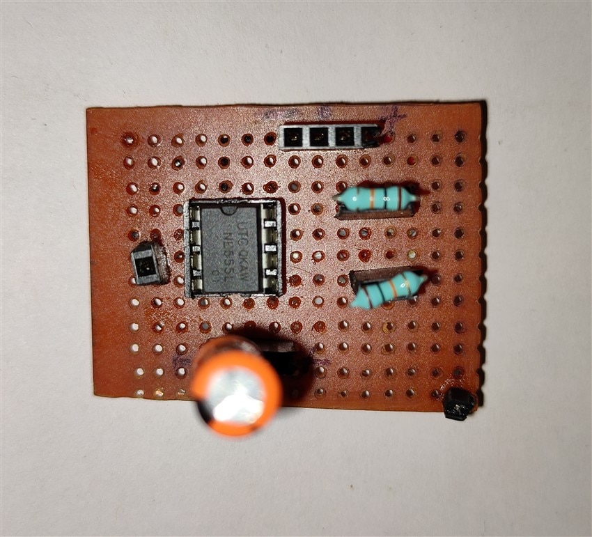

With the components I had available, I found that I could not reliably generate a pulse much longer than roughly 15 seconds using the NE555 configuration.
This meant that even with the CD4017 counting ten stages, the maximum practical timer duration was only around two minutes rather than the several minutes I had initially hoped for.
For example, if the 555 produced a pulse approximately every 12 seconds, reaching the tenth counter state would take approximately:
12 seconds × 10 ≈ 120 seconds
So the basic architecture worked, but the range of useful timing intervals was much smaller than I had expected.

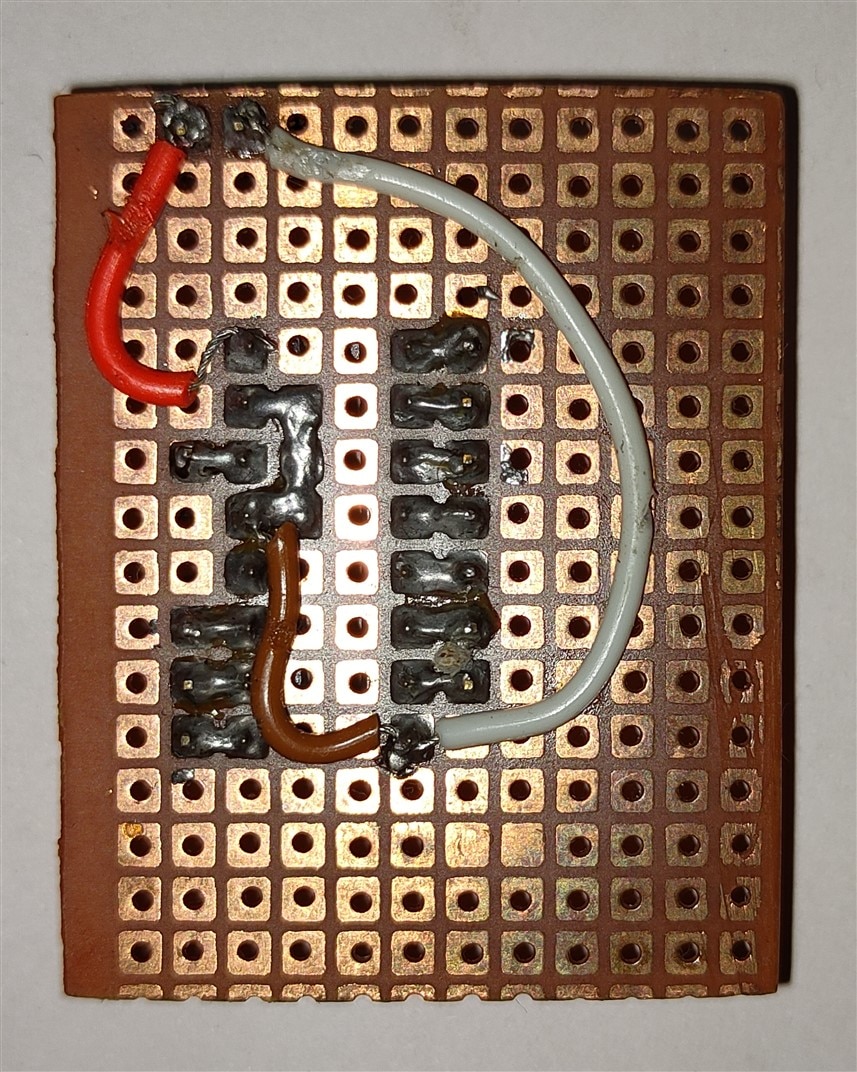

{gallery}NE555 timer ic
Front
Back

The obvious solution was to increase the number of counting stages.
The CD4017 has a carry-out (CO) output that can be used to drive another counter, allowing multiple counters to be cascaded or daisy-chained. In principle, this would allow the first CD4017 to count ten pulses and then provide a signal that could advance a second counter.
This would dramatically increase the possible timing range without requiring the 555 itself to generate extremely long pulses.
Unfortunately, this introduced another practical problem: I only had one decade counter.
When I went to a local electronics store to find another one, I discovered how difficult it can be to find specific electronic components locally. Many of the stores in my area are primarily electrical stores rather than electronics component stores. I was eventually lucky enough to find a shop that actually stocked electronic components, although it did not have everything I was looking for.
I found suitable capacitors and resistors, but the CD4017 was unavailable. Instead, the shopkeeper gave me a CD4066BD, telling me that it was the same thing.
It was not.
After researching the component later, I found that the CD4066 is an analog switch IC, designed for switching analog or digital signals electronically. It is fundamentally different from a decade counter and cannot simply replace a CD4017 in this circuit.
That was an interesting reminder that identifying components correctly is just as important as knowing how to connect them.
{gallery}CD 4017 Decade Counter
Front
Back
The Second Problem: Component Tolerances
Since I could not immediately obtain another CD4017, I decided to continue experimenting with the single counter and try to increase the 555's pulse period instead.
The problem is that increasing the timing resistance and capacitance introduces another challenge: component tolerances and non-ideal behavior become increasingly important.
The timing of an astable 555 circuit depends on its resistor and capacitor values. In an ideal calculation, changing these values gives a predictable change in frequency. In a real circuit, however, the actual values can differ from their nominal values because of component tolerance.
Capacitors can also have significant variation, leakage, temperature dependence, and other non-ideal characteristics. The resistors I had available also had limited value ranges and tolerances.
The capacitors I had were particularly unsuitable for accurately producing long delays. Some had poor or unspecified tolerances, and I did not have a sufficiently wide range of capacitor values to experiment systematically.
This made me realize that simply calculating a resistor-capacitor combination on paper is not enough when building a practical timer. The quality and tolerance of the actual components matter considerably.
As a result, I decided that getting a proper resistor and capacitor assortment kit would make further experimentation much easier.
Another Lesson from the NE555
I also noticed that the measured timing of my particular NE555 circuit did not always match the value predicted by the standard astable-mode equations.
Initially, I thought this might be because the particular NE555 I was using was a newer version of the traditional 555. However, I learned that the difference is better explained by the fact that the standard equations describe an idealized circuit, while real components have tolerances and non-ideal characteristics.
Factors such as the actual resistor and capacitor values, capacitor leakage, supply voltage, and the characteristics of the specific 555 implementation can all contribute to differences between the theoretical and measured timing.
This became another useful part of the project: the circuit was teaching me where theoretical equations stop being perfectly predictive and where real-world electronics begins.

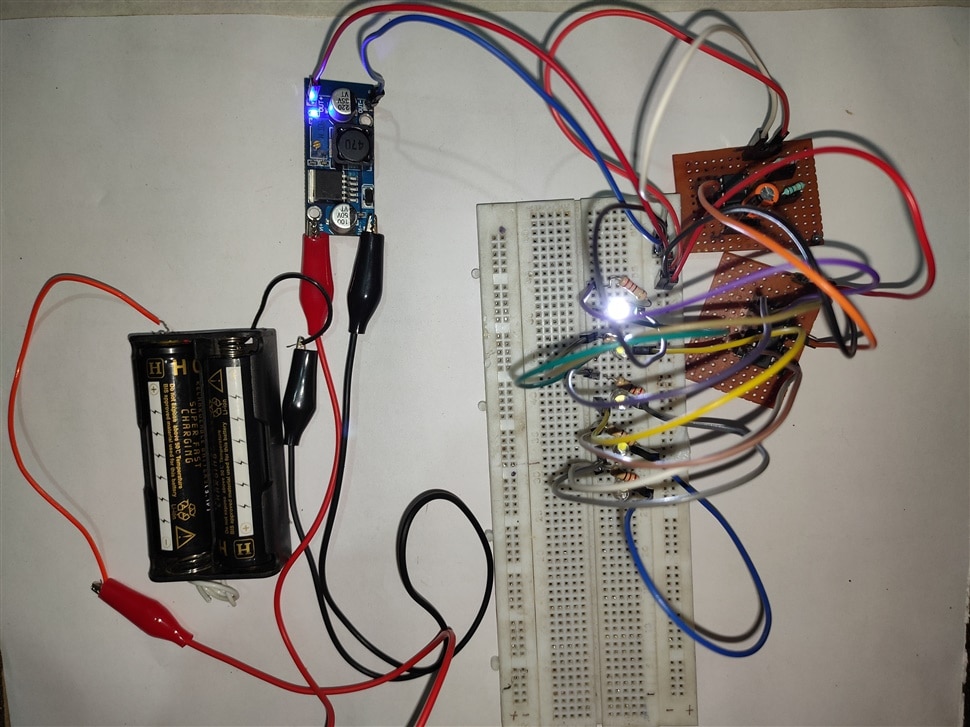

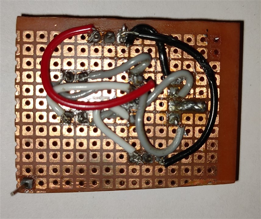

Current State of the Prototype
At present, the project is still under development, but I have a working basic prototype.
I have soldered the ICs and the static parts of the circuit onto a zero PCB/perforated prototype board, along with the necessary headers. For power, testing, and experimentation, jumper wires are still heavily used.
Prototype
The basic concept of generating pulses with the NE555 and feeding them into the CD4017 is working. The remaining challenge is achieving a sufficiently long and, more importantly, sufficiently reliable timing interval for the final timer.
I have ordered a resistor and capacitor assortment so that I can experiment with a much wider range of component combinations. I also plan to obtain additional decade counters so that I can test cascading multiple CD4017 counters. I also plan to add a debounce switch to use the reset pin properly as its sensitive and sometimes triggers false increments.
