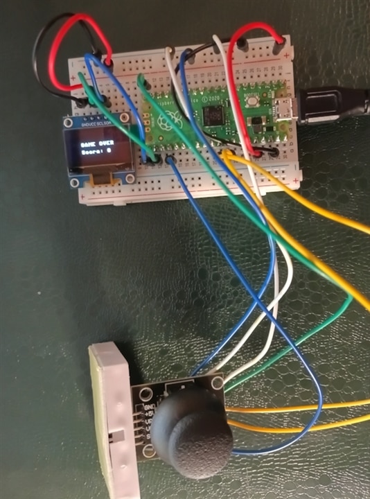

Introdution
Transforming a Raspberry Pi Pico into an 8-bit Tetris arcade system is a fantastic hands-on project for learning MicroPython and embedded electronics. Using standard components like Raspberry Pi Pico, OLED display, an analog joystick and a buzzer, you can build a fully functional game complete with graphics, fluid controls, and retro audio.
Key Game Features & Enhancements
  • Non-Blocking Audio System: Uses MicroPython's time.ticks_ms() to play the classic Korobeiniki melody in the background without causing input lag.
  • Ghost Piece & Hold Function: Renders a shadow projection showing where the tetromino will land, enabling precise placement.
  • Persistent High Score: Utilizes the onboard Flash memory via JSON serialization to store the top score across power reboots.
  • Dynamic Speed Scaling: Automatically increases the fall velocity (drop_speed) every 5 cleared lines to ramp up difficulty.
  • Hardware Status Monitoring: Illuminates the status LED when block stack heights reach critical levels.
Components

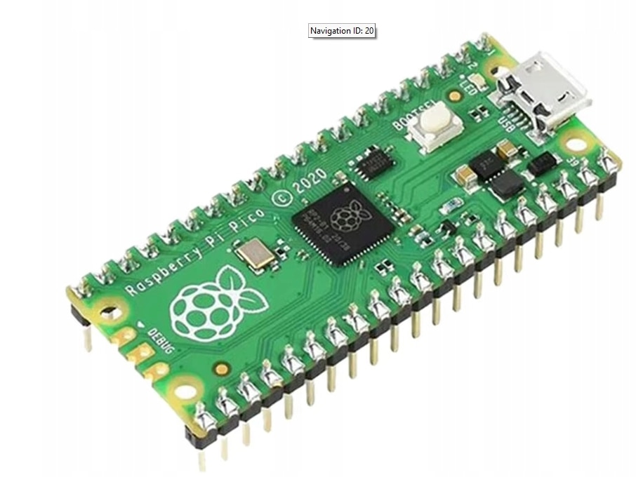

Raspberry Pi Pico

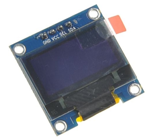

OLED Display

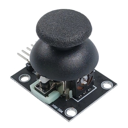

Analog Joystick
Buzzer

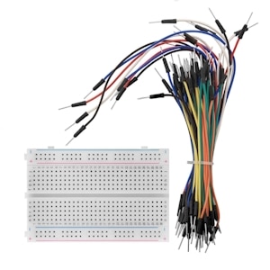

Breadboard and jumper wires
Hardware Requirements & Pinout
To assemble the hardware, connect the components to the Raspberry Pi Pico according to the following pinout configuration:
Component Component Pin Raspberry Pi Pico Pin Notes
0.96" OLED Display VCC 3V3 (Pin 36) 3.3V Power Supply
GND GND (e.g., Pin 38) Ground
SCL GPIO 17 (Pin 22) I2C0 Clock
SDA GPIO 16 (Pin 21) I2C0 Data
Analog Joystick VCC 3V3 (Pin 36) Analog Power Supply
GND GND Ground / AGND (Pin 33)
VRx (X-Axis) GPIO 26 / ADC0 (Pin 31) Left/Right Movement
VRy (Y-Axis) GPIO 27 / ADC1 (Pin 32) Soft & Hard Drop
SW (Button) GPIO 15 (Pin 20) Piece Rotation (Pull-Up)
Buzzer Signal (+) GPIO 18 (Pin 24) PWM Audio Signal
GND (-) GND (e.g., Pin 23) Ground
LED Indicator (optional) Anode (+) GPIO 14 (Pin 19) Warning Light via 220Ω resistor
Cathode (-) GND Ground
Software Setup Guide
  1. Flash MicroPython: Hold the BOOTSEL button on the Pico while plugging in the USB cable. Open Thonny IDE, select the MicroPython (Raspberry Pi Pico) interpreter, and install the latest firmware.
  2. Install Display Driver: Create a file named ssd1306.py on the Pico device and paste the official SSD1306 MicroPython I2C driver code into it.
  3. Upload Main Application: Paste the main game logic script into a file named main.py and save it directly to the root of the Raspberry Pi Pico.
Note: Naming the file main.py allows the Raspberry Pi Pico to execute the game automatically upon receiving power from any USB port or battery pack.
The code development was divided into several stages, starting with a basic version that provides peripheral support—an OLED display and analog joystick—and implements the core game mechanics. The second stage adds a preview of the next block, while the third stage introduces the traditional "Korobeiniki" melody (Tetris Theme) played in the background on the buzzer without blocking the game loop (using a timer/non-blocking countdown). The final stage is the most extensive, incorporating key improvements such as a level and acceleration mechanism (Speed Up), a Hard Drop function (quickly pushing the joystick up), a block holding system (Hold Piece), LED status indicator support, high score saving, and a Menu/Pause screen.
First stage - basic functions
This script combines hardware interaction—reading analog joysticks, driving a piezoelectric buzzer, and updating an OLED display—with core game logic.

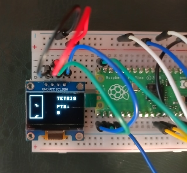

1.1. Hardware Initialization and Setup
The program starts by importing essential modules: random for spawning random tetraminos, time for managing frame rates and block drop intervals, and hardware drivers from the machine library.
  • I2C and OLED: An SSD1306 OLED display (128x64 pixels) is initialized over the I2C protocol using specific GPIO pins (SCL on pin 17, SDA on pin 16). This serves as the visual canvas for the game.
# --- I2C and OLED Initialization ---
i2c = I2C(0, scl=Pin(17), sda=Pin(16), freq=400000)
oled = SSD1306_I2C(128, 64, i2c)

1.4. Rendering on the OLED Display
The draw function handles the graphics pipeline on every frame iteration. It clears the screen, draws a bounding rectangle for the playfield based on BLOCK_SIZE coordinates, loops through the 2D board array to render locked blocks, draws the active falling piece, and outputs the current score on the right side of the screen using oled.text().

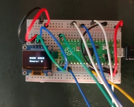

  • Game Over Condition: If a new piece spawns and immediately triggers a collision (check_collision), the game terminates, plays a low buzzer tone, displays a "GAME OVER" message along with the final score, and breaks out of the loop.

      if check_collision(cur_shape, cur_x, cur_y):
        sound(150, 0.5)
        oled.fill(0)
        oled.text("GAME OVER", 28, 25)
        oled.text(f"Score: {score}", 28, 40)
        oled.show()
        break

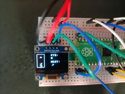

Second stage - Next Block Preview
Here is the modified Tetris game code. I added support for the next_shape variable and a function that draws a preview of the upcoming block on the right side of the screen under the "NEXT:" label.
The most important changes implemented in the updated Tetris script include:
  • Next_shape variable: This is drawn randomly at the beginning and each time a tile is locked at the bottom of the board.
  • Tile queuing: Before generating a new tile, cur_shape takes the value from next_shape, and for next_shape, the next object from the SHAPES list is drawn randomly.
  • Preview section in draw(): A mini-loop has been added to the screen at coordinates (65, 44) to draw the tile layout from the preview under the NEXT: text.
        sound(150, 0.5)
        oled.fill(0)
        oled.show()
        break

The recent updates introduce a next-piece preview feature to the Tetris game, expanding the user interface and logic to display the upcoming tetromino.
Key Changes
  • Next Shape Queue: A next_shape variable is initialized alongside cur_shape to track the upcoming block.
  • UI and Rendering Expansion: The draw() function now renders a "NEXT:" label and loops through the next_shape matrix to draw a visual preview in the bottom-right corner of the OLED screen.
  • Queue Rotation in the Loop: When the active piece locks into place, the current block is replaced by the queued one (cur_shape = next_shape), and a new random shape is generated for next_shape.
Code Examples of the New Additions
2.1. Initializing the Next Shape Queue:
# --- Main Game Loop ---
cur_shape = random.choice(SHAPES)
next_shape = random.choice(SHAPES)  # Added: Generation of the next shape preview
2.2. Rendering the Next Shape Preview in draw():
    # UI on the right side
    oled.text("PTS:", 60, 2)
    oled.text(str(score), 60, 14)
    oled.text("NEXT:", 60, 30)
    # Drawing the next block preview
    preview_x = 65
    preview_y = 44
    for y, row in enumerate(next_shape):
        for x, val in enumerate(row):
            if val:
                oled.fill_rect(
                    preview_x + x * BLOCK_SIZE,
                    preview_y + y * BLOCK_SIZE,
                    BLOCK_SIZE - 1,
                    BLOCK_SIZE - 1,
                    1,
2.3. Updating the Queue in the Main Loop:
        else:
            merge_shape(cur_shape, cur_x, cur_y)
            clear_lines()
            # Retrieving the next block from the queue
            cur_x = GRID_W // 2 - len(cur_shape[0]) // 2
            cur_y = 0

import random
import time
from machine import ADC, Pin, PWM, I2C
from ssd1306 import SSD1306_I2C
# --- Joystick and Buzzer Initialization ---
vx = ADC(Pin(26))
vy = ADC(Pin(27))
btn = Pin(15, Pin.IN, Pin.PULL_UP)
buzzer = PWM(Pin(18))
buzzer.duty_u16(0)
# --- Note Definitions for Melody (Frequencies in Hz) ---
NOTE_E5 = 659
NOTE_B4 = 494
NOTE_C5 = 523
NOTE_D5 = 587
NOTE_A4 = 440
NOTE_G4 = 392
NOTE_F4 = 349
NOTE_E4 = 330
NOTE_GS4 = 415
# Tetris Melody (Korobeiniki): (note, length in time units)
MELODY = [
    (NOTE_E5, 4),
    (NOTE_B4, 2),
    (NOTE_C5, 2),
    (NOTE_D5, 4),
    (NOTE_C5, 2),
    (NOTE_B4, 2),
    (NOTE_A4, 4),
    (NOTE_A4, 2),
    (NOTE_C5, 2),
    (NOTE_E5, 4),
    (NOTE_D5, 2),
    (NOTE_C5, 2),
    (NOTE_B4, 6),
    (NOTE_C5, 2),
    (NOTE_D5, 4),
    (NOTE_E5, 4),
    (NOTE_C5, 4),
    (NOTE_A4, 4),
    (NOTE_A4, 4),
    (0, 2),  # pause
    (NOTE_D5, 4),
    (NOTE_F4, 2),
    (NOTE_A4, 2),
    (NOTE_C5, 4),
    (NOTE_B4, 2),
    (NOTE_A4, 2),
    (NOTE_G4, 4),
    (NOTE_C5, 2),
    (NOTE_E4, 2),
    (NOTE_E5, 4),
    (NOTE_D5, 2),
    (NOTE_C5, 2),
    (NOTE_B4, 6),
    (NOTE_C5, 2),
    (NOTE_D5, 4),
    (NOTE_E5, 4),
    (NOTE_C5, 4),
    (NOTE_A4, 4),
    (NOTE_A4, 4),
    (0, 4),  # pause
current_note_idx = 0
note_start_time = time.ticks_ms()
TEMPO_UNIT = 110  # Duration of the base note unit in ms
def update_music():
    """Handles background melody playback without blocking the game"""
    global current_note_idx, note_start_time
    now = time.ticks_ms()
    freq, duration_units = MELODY[current_note_idx]
    duration_ms = duration_units * TEMPO_UNIT
    if time.ticks_diff(now, note_start_time) >= duration_ms:
        current_note_idx = (current_note_idx + 1) % len(MELODY)
        note_start_time = now
        freq, _ = MELODY[current_note_idx]
        if freq > 0:
            buzzer.freq(freq)
            buzzer.duty_u16(8192)  # Quieter background sound
        else:
            buzzer.duty_u16(0)
def play_effect(freq, duration=0.05):
    """Short sound effect for movements/points"""
    buzzer.freq(freq)
    buzzer.duty_u16(32768)
    time.sleep(duration)
    buzzer.duty_u16(0)
# --- Board and Block Configuration ---
GRID_W, GRID_H = 10, 18
BLOCK_SIZE = 3
OFFSET_X, OFFSET_Y = 2, 2
SHAPES = [
    [[1, 1, 1, 1]],  # I
    [[1, 1], [1, 1]],  # O
    [[0, 1, 0], [1, 1, 1]],  # T
    [[0, 1, 1], [1, 1, 0]],  # S
    [[1, 1, 0], [0, 1, 1]],  # Z
    [[1, 0, 0], [1, 1, 1]],  # J
    [[0, 0, 1], [1, 1, 1]],  # L
board = [[0] * GRID_W for _ in range(GRID_H)]
score = 0
def rotate(shape):
    return [
        [shape[y][x] for y in range(len(shape) - 1, -1, -1)]
        for x in range(len(shape[0]))
def check_collision(shape, px, py):
    for y, row in enumerate(shape):
            if val:
                nx, ny = px + x, py + y
                if nx < 0 or nx >= GRID_W or ny >= GRID_H:
                    return True
                if ny >= 0 and board[ny][nx]:
                    return True
    return False
def merge_shape(shape, px, py):
            if val and py + y >= 0:
                board[py + y][px + x] = 1
def clear_lines():
    global score
    full_lines = [i for i, row in enumerate(board) if all(row)]
    for index in full_lines:
        del board[index]
        board.insert(0, [0] * GRID_W)
        score += 100
        play_effect(1000, 0.1)
def draw():
    oled.fill(0)
    # Board grid
    oled.rect(
        OFFSET_X - 1,
        OFFSET_Y - 1,
        GRID_W * BLOCK_SIZE + 2,
        GRID_H * BLOCK_SIZE + 2,
        1,
    # Locked blocks
    for y in range(GRID_H):
        for x in range(GRID_W):
            if board[y][x]:
                oled.fill_rect(
                    OFFSET_X + x * BLOCK_SIZE,
                    OFFSET_Y + y * BLOCK_SIZE,
                    BLOCK_SIZE - 1,
                    BLOCK_SIZE - 1,
                    1,
    # Current active block
    for y, row in enumerate(cur_shape):
            if val and cur_y + y >= 0:
                oled.fill_rect(
                    OFFSET_X + (cur_x + x) * BLOCK_SIZE,
                    OFFSET_Y + (cur_y + y) * BLOCK_SIZE,
                    BLOCK_SIZE - 1,
                    BLOCK_SIZE - 1,
                    1,
    # Right-side interface
    preview_x, preview_y = 65, 44
            if val:
                oled.fill_rect(
                    BLOCK_SIZE - 1,
                    BLOCK_SIZE - 1,
                    1,
    oled.show()
cur_y = 0
last_drop = time.ticks_ms()
while True:
    # Background melody playback
    update_music()
    # Controls
    val_x = vx.read_u16()
    val_y = vy.read_u16()
    if val_x < 15000:  # Left
        if not check_collision(cur_shape, cur_x - 1, cur_y):
            cur_x -= 1
            time.sleep(0.08)
    elif val_x > 50000:  # Right
        if not check_collision(cur_shape, cur_x + 1, cur_y):
            cur_x += 1
            time.sleep(0.08)
    if btn.value() == 0:  # Rotate
        rotated = rotate(cur_shape)
        if not check_collision(rotated, cur_x, cur_y):
            cur_shape = rotated
            time.sleep(0.15)
    drop_interval = 100 if val_y > 50000 else 500
    # Block dropping
    if time.ticks_diff(now, last_drop) > drop_interval:
        if not check_collision(cur_shape, cur_x, cur_y + 1):
            cur_y += 1
        else:
            clear_lines()
            cur_y = 0
                buzzer.duty_u16(0)
                play_effect(150, 0.5)
                oled.fill(0)
                oled.show()
                break
        last_drop = now
    draw()

import json
import random
import time
# --- Peripherals Initialization ---
vx = ADC(Pin(26))
vy = ADC(Pin(27))
led = Pin(14, Pin.OUT)
buzzer.duty_u16(0)
# --- High Score Persistence ---
HIGH_SCORE_FILE = "highscore.json"
def load_high_score():
    try:
        with open(HIGH_SCORE_FILE, "r") as f:
            return json.load(f).get("high_score", 0)
    except:
        return 0
def save_high_score(new_score):
    try:
        with open(HIGH_SCORE_FILE, "w") as f:
            json.dump({"high_score": new_score}, f)
    except:
        pass
high_score = load_high_score()
# --- Audio & Music Setup ---
MELODY = [(659, 4), (494, 2), (523, 2), (587, 4), (523, 2), (494, 2), (440, 4)]
def update_music():
    if time.ticks_diff(now, note_start_time) >= duration_units * 100:
        if freq > 0:
            buzzer.freq(freq)
            buzzer.duty_u16(4000)
        else:
            buzzer.duty_u16(0)
def sound(freq, duration=0.04):
    buzzer.freq(freq)
    buzzer.duty_u16(20000)
    buzzer.duty_u16(0)
# --- Game Settings & Shapes ---
BLOCK_SIZE = 3
SHAPES = [
    [[1, 1, 1, 1]],  # I
def rotate(shape):
    return [
def check_collision(shape, px, py, board):
            if val:
                    return True
                    return True
    return False
def get_ghost_y(shape, px, py, board):
    ghost_y = py
    while not check_collision(shape, px, ghost_y + 1, board):
        ghost_y += 1
    return ghost_y
# --- Start Menu ---
def show_menu():
    while btn.value() == 1:
        oled.fill(0)
        oled.text("TETRIS PICO", 20, 10)
        oled.text(f"HI-SCORE:{high_score}", 15, 30)
        oled.text("Press Joystick", 8, 50)
        oled.show()
        time.sleep(0.1)
show_menu()
score = 0
level = 1
lines_cleared = 0
drop_speed = 500
cur_y = 0
while True:
    update_music()
    # LED warning indicator (turns on when stack height reaches row 4)
    led.value(1 if any(board[4]) else 0)
    # Read Joystick analog inputs
    # Horizontal movement (Left / Right)
    if val_x < 15000 and not check_collision(
        cur_shape, cur_x - 1, cur_y, board
        cur_x -= 1
        sound(400)
        time.sleep(0.08)
    elif val_x > 50000 and not check_collision(
        cur_shape, cur_x + 1, cur_y, board
        cur_x += 1
        sound(400)
        time.sleep(0.08)
    # Hard Drop (Joystick pushed up)
    if val_y < 10000:
        cur_y = get_ghost_y(cur_shape, cur_x, cur_y, board)
        sound(800, 0.05)
        last_drop = 0
    # Rotation (Joystick button pressed)
        if not check_collision(rotated, cur_x, cur_y, board):
            cur_shape = rotated
            sound(600)
            time.sleep(0.15)
    # Automatic fall rate (Soft drop if joystick is pushed down)
    current_interval = 50 if val_y > 50000 else drop_speed
    if time.ticks_diff(now, last_drop) > current_interval:
        if not check_collision(cur_shape, cur_x, cur_y + 1, board):
            cur_y += 1
        else:
            # Lock the current piece into the board array
                        board[cur_y + y][cur_x + x] = 1
            # Clear completed lines and calculate points
            full = [i for i, r in enumerate(board) if all(r)]
            if full:
                for i in full:
                    del board[i]
                lines_cleared += len(full)
                score += (len(full) ** 2) * 100
                level = (lines_cleared // 5) + 1
                drop_speed = max(100, 500 - (level - 1) * 40)
                sound(1200, 0.15)
            # Spawn next piece
            cur_y = 0
            # Check for Game Over condition
            if check_collision(cur_shape, cur_x, cur_y, board):
                buzzer.duty_u16(0)
                led.value(0)
                if score > high_score:
                    save_high_score(score)
                oled.fill(0)
                oled.text("GAME OVER", 28, 20)
                oled.text(f"Score: {score}", 28, 35)
                oled.text(f"Level: {level}", 28, 48)
                oled.show()
                sound(150, 0.6)
                break
        last_drop = now
    # --- Render Screen Frame ---
    oled.fill(0)
    # Draw game grid border
    oled.rect(
        OFFSET_X - 1,
        OFFSET_Y - 1,
        1,
    # Draw landed blocks
            if board[y][x]:
                oled.fill_rect(
                    BLOCK_SIZE - 1,
                    BLOCK_SIZE - 1,
                    1,
    # Draw Ghost Piece shadow
    ghost_y = get_ghost_y(cur_shape, cur_x, cur_y, board)
            if val and ghost_y + y >= 0:
                oled.pixel(
                    OFFSET_Y + (ghost_y + y) * BLOCK_SIZE,
                    1,
    # Draw active falling piece
                oled.fill_rect(
                    BLOCK_SIZE - 1,
                    BLOCK_SIZE - 1,
                    1,
    # Draw HUD / Interface side panel
    oled.text(f"PTS:{score}", 40, 2)
    oled.text(f"LVL:{level}", 40, 14)
    oled.text("NXT:", 40, 30)
            if val:
                oled.fill_rect(
                    75 + x * BLOCK_SIZE,
                    30 + y * BLOCK_SIZE,
                    BLOCK_SIZE - 1,
                    BLOCK_SIZE - 1,
                    1,
    oled.show()
