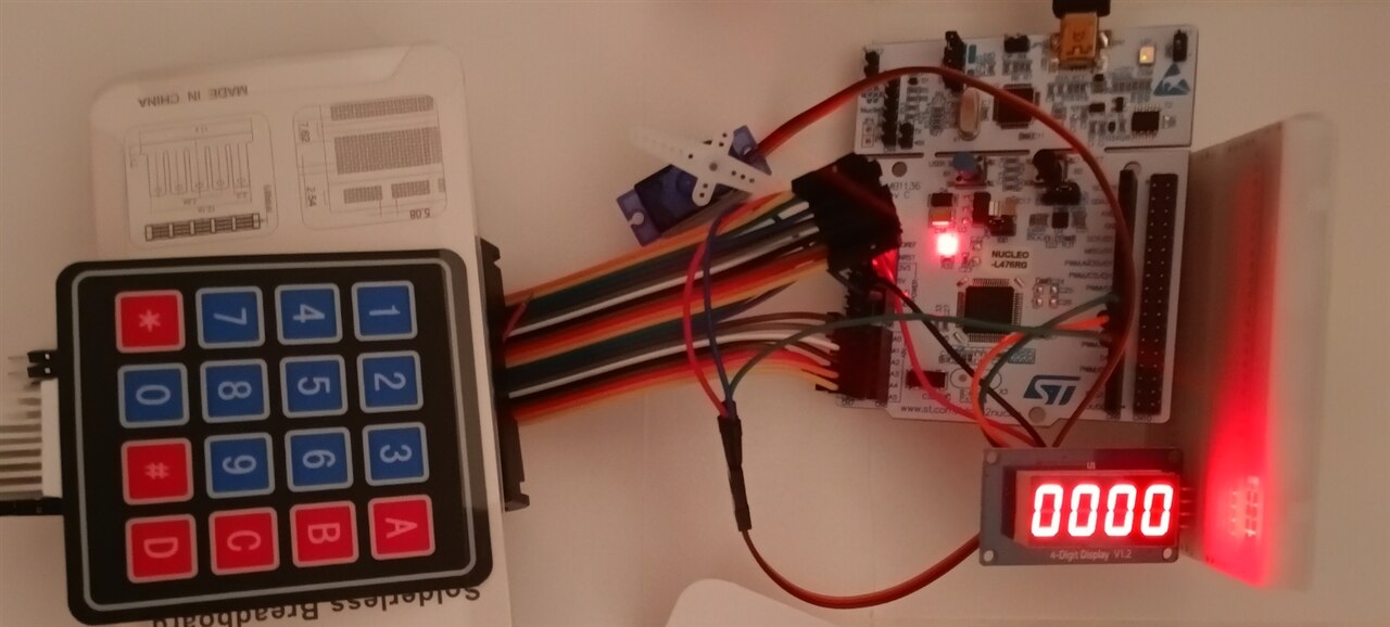

Secure Digital Combination Lock
kp35
kp35
29 Aug 2026
This project details the hardware architecture, firmware mechanisms, and interface dynamics of an embedded electronic access control system (EACS) centered on the STM32-based Nucleo-L476RG platform. Featuring a dynamic matrix keypad scanner, a TM1637-driven 7-segment LED display module, and a Pulse-Width Modulation (PWM) controlled servomechanism, the system manages secure state transitions between locked and unlocked modes.
Embedded access control systems require a rigorous balance between input validation latency, user feedback precision, and physical actuator safety. Utilizing traditional microcontroller unit (MCU) peripherals without non-blocking structures often leads to UI freeze or missed keystrokes during prolonged execution loops (e.g., waiting for motor displacement).
This work addresses the realization of a deterministic, state-machine-driven door lock interface implemented on the STM32L476RG microcontroller (ARM® Cortex-4 core operating up to 80 MHz). The interface combines:

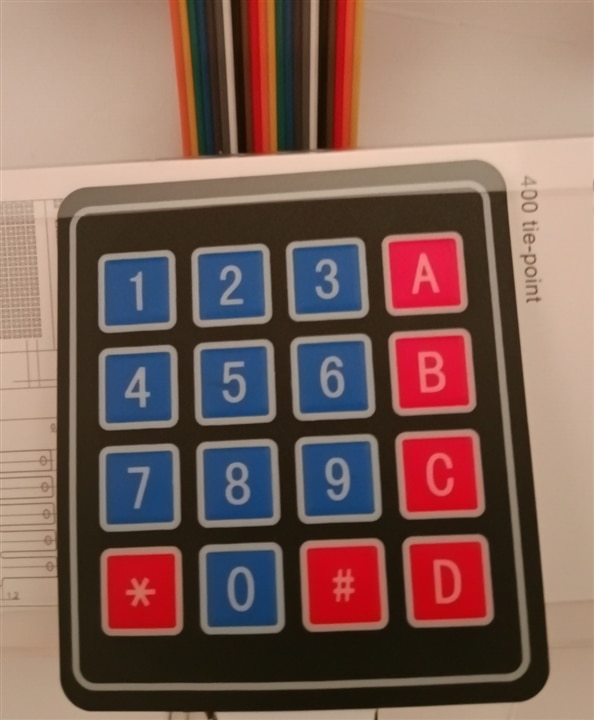

  • A 4×4 membrane keypad for credential entry and administrative triggers.

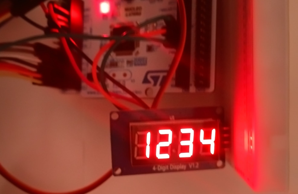

  • A TM1637 two-wire display controller for Human-Machine Interface (HMI) feedback.

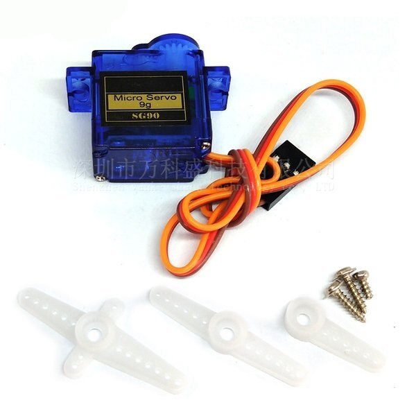

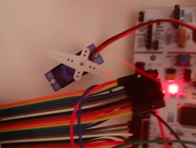

  • A high-torque positional servo motor for locking bolt engagement.

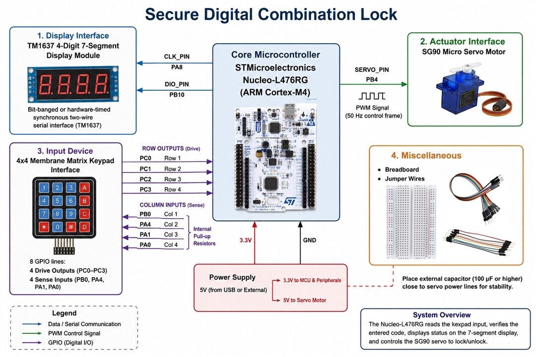

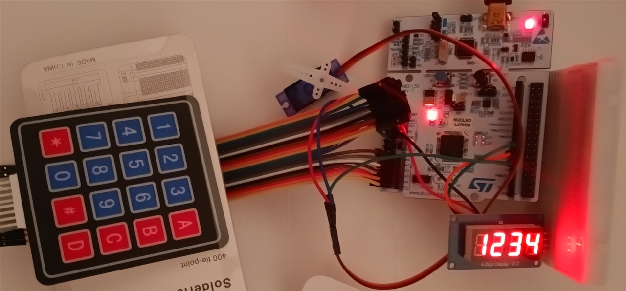

Hardware Architecture & Pin Topology
The system topology maps digital, analog, and power routing to isolate high-current inductive spikes generated by the motor from sensitive logic lines.
System Interconnect Topology

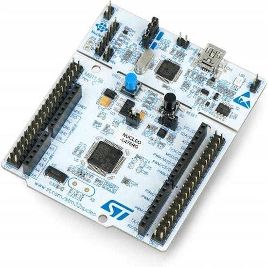

  • Core Microcontroller: STMicroelectronics Nucleo-L476RG (ARM Cortex-M4)
  • Display Interface (TM1637 4-Digit 7-Segment Display Module): Bit-banged or hardware-timed synchronous two-wire serial interface (CLK_PIN on PA8, DIO_PIN on PB10).
  • Actuator Interface: SG90 Micro Servo Motor - PWM channel driving a 50 Hz control frame (SERVO_PIN on PB4).
  • Input Device: 4x4 Membrane Matrix Keypad Interface - 8 GPIO lines partitioned into 4 drive outputs (PC0–PC3) and 4 sense inputs with internal pull-up resistors (PB0, PA4, PA1, PA0).
  • Misc: Breadboard, jumper wires, external capacitor (recommended for servo decoupling)
Hardware Pinout Configuration
Component Signal / Function Microcontroller Pin (Nucleo-L476RG)
Keypad Rows Row 0–3 (Drive) PC0, PC1, PC2, PC3
Keypad Columns Column 0–3 (Sense) PB0, PA4, PA1, PA0
TM1637 Display CLK (Clock) PA8 (Arduino D7)
TM1637 Display DIO (Data) PB10 (Arduino D6)
SG90 Servo PWM Control PB4 (Arduino D5)
Key Technical Challenges Solved
  1. Eliminating External Dependencies: By writing a native scanning algorithm using INPUT_PULLUP and dynamic row output toggling, the build environment remains lean and immune to version conflicts.
  2. Matrix Transposition & Calibration: Physical membrane keypads often feature internal trace crossings that differ from standard layout assumptions. Using systematic mapping adjustments resolved coordinate inversions cleanly in software.
  3. Non-Blocking UI State Machine: The system safely tracks entered PIN sequences against a hardcoded string ("1234"), providing visual feedback via custom 7-segment glyphs (OPEn, CLO, Err) while supporting manual lockdown via key 'A'.
