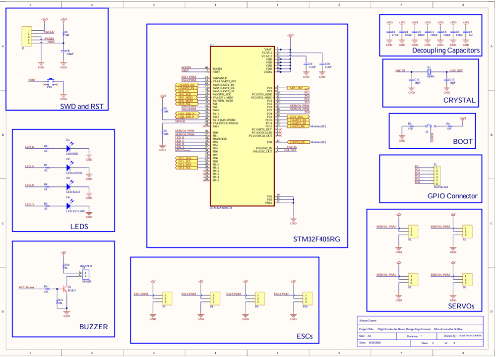

2. Microcontroller and Control Section
The main controller is the STM32F405RGT6.
I selected this MCU because it provides a Cortex-M4 core together with a large number of timers and communication peripherals, which makes it suitable for a flight-control-oriented embedded platform.
The microcontroller section includes:
• SWD programming and debugging
• Hardware reset
• BOOT configuration
• External 8 MHz crystal
• Local decoupling capacitors
• Four status LEDs
• Buzzer control
• ESC PWM outputs
• Servo PWM outputs
• Additional GPIO breakout connections
Special attention was given to providing decoupling capacitors around the MCU supply pins and making the major interfaces individually accessible during future debugging and firmware development.

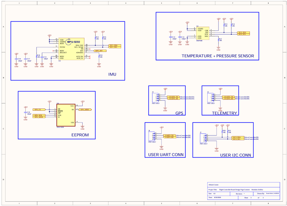

3. Sensor and Communication Interfaces
The board contains two main onboard sensors.
The MPU-9250 is used as the inertial measurement unit and provides motion-related measurements required by a flight-control system. It is connected to the STM32 through I2C and also provides an interrupt signal.
A BMP280 is included for pressure and temperature measurement and is connected through a separate I2C bus.
Using separate I2C buses allows the sensor interfaces to be organized independently and gives additional flexibility during firmware development and debugging.
A 25LC1024 EEPROM is connected through SPI for non-volatile storage.
The board also provides dedicated connectors for:
• GPS over UART
• Telemetry over UART
• Additional user UART
• Additional user I2C
This allows external modules to be added without redesigning the controller board.
4. ESC and Servo Control
Four dedicated ESC outputs are included in the design.
Each ESC connector provides:
• PWM control signal
• 5 V
• Ground
The STM32 timer peripherals are intended to generate the control signals.
Four additional servo outputs are also included, providing extra PWM channels for future actuators or auxiliary control mechanisms.
These interfaces were separated and clearly labeled to simplify wiring and debugging during future hardware testing.

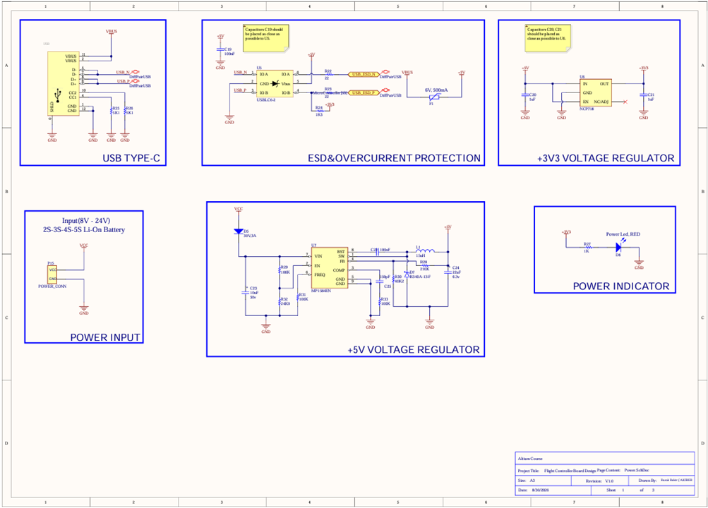

5. Power Architecture
The board can be powered from an external Li-ion battery source.
The present design targets an input range of approximately 8 V to 24 V.
An MP1584EN buck converter generates the 5 V rail from the main battery input.
The 5 V rail is then used directly by appropriate peripherals and is also supplied to an NCP718 linear regulator to generate the 3.3 V rail required by the STM32 and low-voltage peripherals.
The power section therefore follows:
Battery Input
→ MP1584EN Buck Converter
→ 5 V Rail
→ NCP718 LDO
→ 3.3 V Rail
The board also includes a power indicator LED.
USB Type-C is included for communication and development purposes.
The USB section contains:
• USB Type-C connector
• 5.1 kΩ configuration resistors
• USBLC6-2 ESD protection
• 22 Ω series resistors on the USB data lines
• Resettable overcurrent protection
Protection and filtering components were included around the USB and power interfaces to improve robustness during development.
