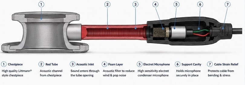

At its heart, TARANGA is a phonocardiograph: a device that captures the acoustic vibrations produced by the heart's valves and the flow of blood through it, and turns them into a visual, time-frequency waveform instead of just a sound in someone's ear. It's built around a completely conventional stethoscope chestpiece — the same kind found in any clinic — but with an electret microphone embedded inside, so that the same vibrations a doctor hears can also be digitised, amplified, filtered, and displayed.

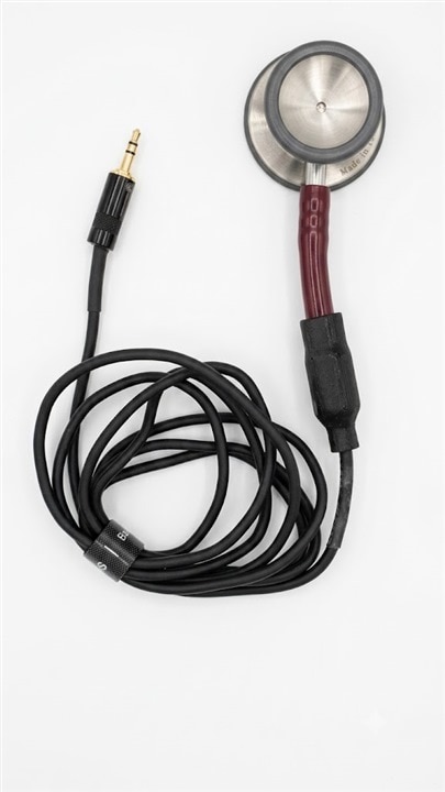

The first prototype was deliberately minimal — almost stubbornly so. An electret microphone was fitted inside a standard stethoscope chestpiece, and its output was run straight into a PC's sound card through a 3.5 mm stereo jack. No amplifier. No filter. No enclosure to speak of.
It was a proof of concept, nothing more — but it answered the only question that mattered at that stage: can an ordinary chestpiece, with a cheap microphone glued inside it, actually pick up heart sounds well enough to be recorded and analysed on a PC? It could. That was enough to justify going further.
Cross section view:
image generated using Ai to demonstrate the concept

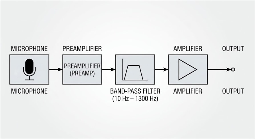

A raw microphone signal straight into a sound card is noisy, weak, and full of everything except the heart sound you actually want — handling noise, ambient room noise, electrical hum. The second phase existed to solve exactly that problem.

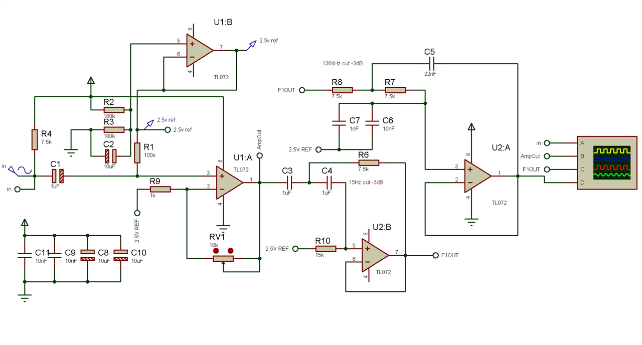

The microphone signal was preamplified and filtered before being fed into a dedicated USB sound card, rather than the PC's built-in (and usually poor-quality) audio input. This is also where the project's core electronics — the block that would later become the heart of the final kit — took shape:
image   image
Heart and lung sounds live almost entirely in this band. S1 and S2 sit around 30–70 Hz, gallops (S3/S4) drop as low as 20 Hz, and murmurs and breath sounds spread broadband up toward 600–2000 Hz. Filtering to this window, before amplification, meant the signal reaching the PC was finally clean enough to actually study.
The attached clips demonstrate the filtered heart and lung sound which are clean and the background noise and humming are reduced significantly. The web app has been developed by Zihad Tarafder from our team. Thihs app has been incorporated into the University Telemedicine Program later on.

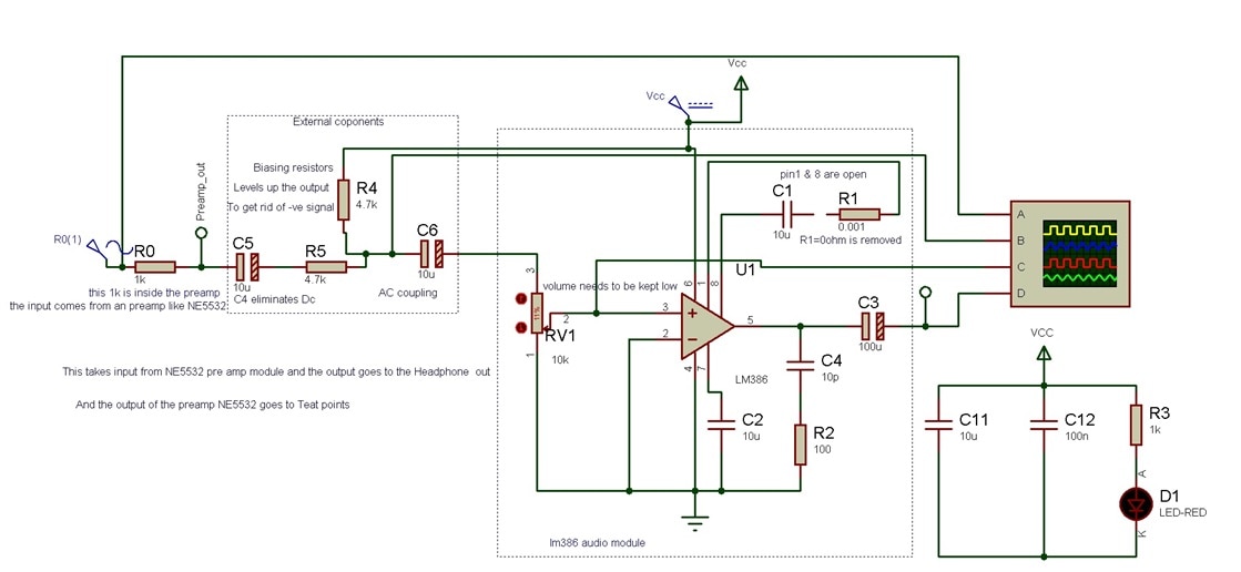

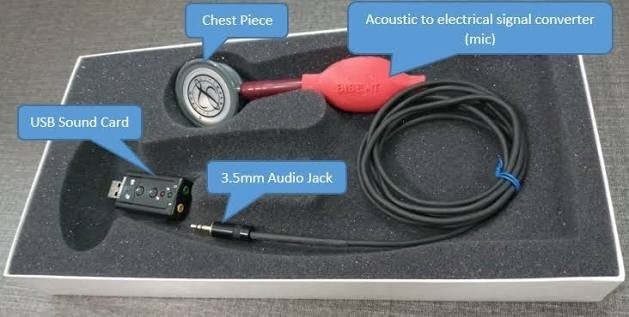

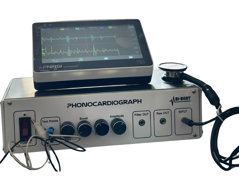

The result is the BiBEAT Phonocardiograph Trainer Kit — a compact panel that takes the same electret-mic stethoscope and wraps it in a proper front end:
  • Input — for the electret mic-based stethoscope
  • Raw OUT — the unfiltered, LM386-amplified microphone signal
  • image
  • Filter OUT — the tone-filtered, cleaned-up output
  • Amplitude — output gain control
  • Boost switches — three selectable frequency emphases:
    • Cardiac (low-frequency emphasis, for heart sounds)
    • Lungs (mid-frequency band)
    • High Freq (crackles and bowel sounds)
  • Test Points — direct oscilloscope probe access
  • Power switch
In the lab setup shown below, the kit's Filter OUT feeds a USB sound card into a PC running Audacity, while the Test Points connect directly to an oscilloscope for real-time waveform viewing — so a student can watch a live trace while they're listening, and then go back afterward and pull the recording apart offline.
