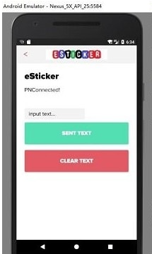

This is how it appears in ANDROID phone

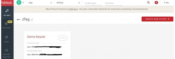

  • pubsub service behind the bar
The API dey and registered service shall be use in the program both in mobile APP and raspberry PI part, as broker

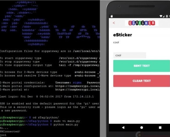

RUNING the APP

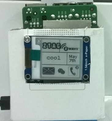

  • Start the app in raspberry PI
runing
python main.py
  • Input text such as 'cool', it appears in phone app

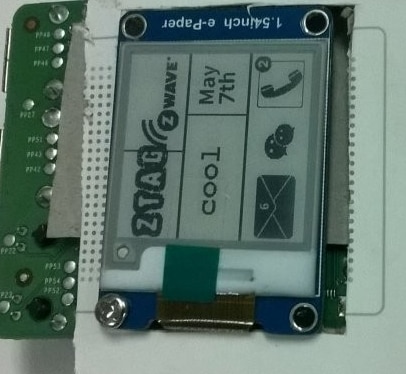

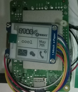

  • On The Wireless Electronic Fridge Tag as well
z-wave part is not passed in testing, but the UI still keep it
  • put it into one case and stick magnet as back
