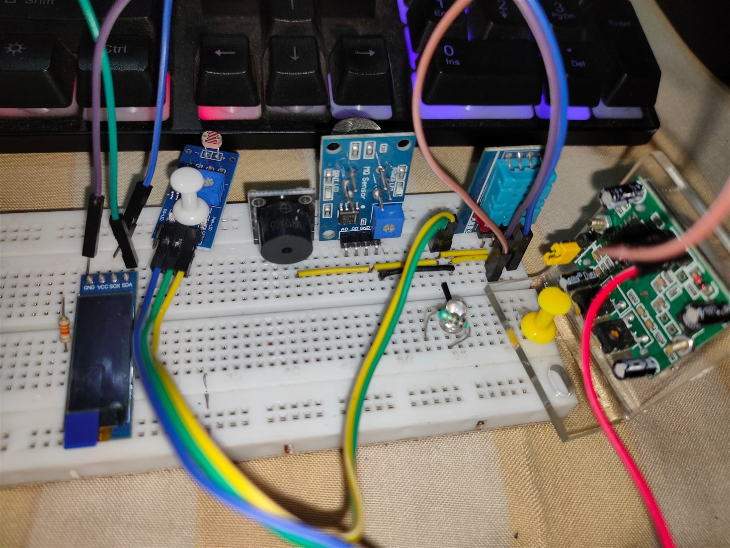

In this project I have built A warehouse management System that can tell the Moisture and the Temperature of warehouse it would be very useful for the local warehouses that help the local farmer to prevent their grains from getting spoiled when there is more moisture and result of that get damaged.
I myself come from the farmer family and many time I see that we generally stores the grains in a small room but because if the Moisture and temperature change the food grains get damaged and farmers faces heavy losses.
and from the many insects and specially the mouse.

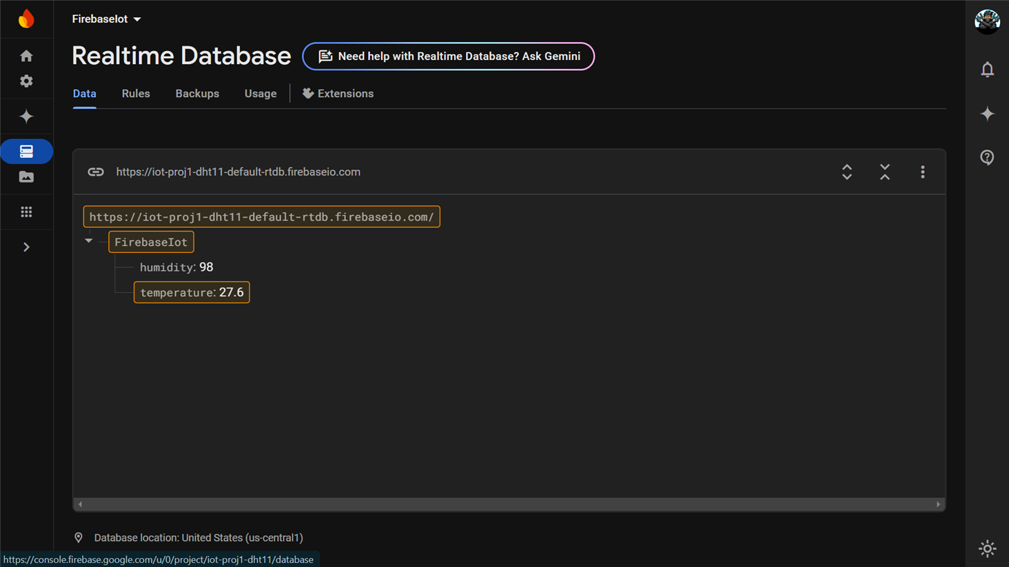

So to prevent that I have built A warehouse management system and  Using the DHT11/22 sensors for the Temperature and PIR Sensor And placed that in the  possible entry point of the Mouse so if they will come the PIR sensor will detect them and I have Attached the Active buzzer for that  it would gives alarm on high frequency so by listening that sound the mouse will run away and that will help  the farmer to save their food grain and temperature and moisture can be also seen on the  small OLED Display that will be easier for the user and if they are away from the warehouse they can monitor the warehouse using the  custom build dashboard I send  the all data to the Firebase Realtime-database and through a web interface they can easily get the data from their mobile phone .

So basically This project showcases the integration of the NodeMCU and DHT11 sensor to monitor temperature and humidity.This module is a foundational part of a larger project designed to monitor comprehensive warehouse parameters, ensuring optimal environmental conditions, safety, and efficiency .With its scalability, this solution is ideal for applications like home automation and environmental monitoring, serving as a foundation for advanced loT projects.
Since this is still an active project, I want to make it for a Larger scale as the hardware progresses.
