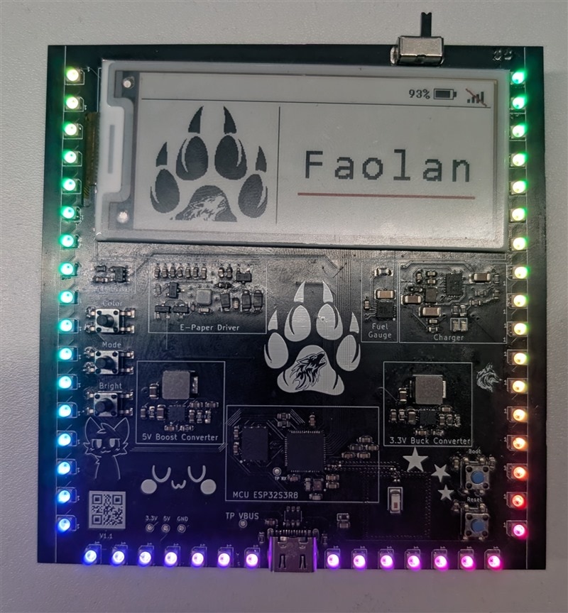

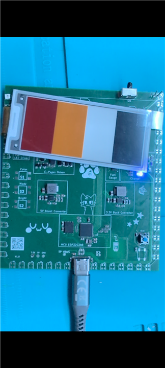

The current state of the badge is revision 1.1, which features 48 LEDs and one 4-color E-Ink display to convey information and to draw attention. Behind the scenes a powerful microprocessor is built in to control all of these, while having a lot of wiggle room for future features and firmware updates. There is also a powerful power system which controls and measures the power flow precisely. More on that later.
But while this is already functional and could be the end of the project, I want more features, like NFC, LoRa, GNSS and much more. More about that in chapter 9.

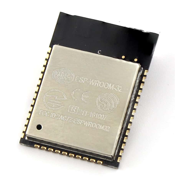

Normally you would use a prebuilt and pre-certified ESP module like this one:
There are almost only advantages in doing it like that:
  • Fewer parts to solder
  • Cheaper than buying every single part yourself
  • You get a properly calibrated antenna
  • It is already CE certified, so if you want to sell this as a product it is much cheaper to get an overall CE certificate for the whole design
But I decided against that. Why? There are multiple reasons, and one of them is that I am not doing this as a project I want to finish as cheaply as possible. I want to max out my learning experience while doing it, and soldering the bare ESP chip with all its capacitors and strapping pin configuration taught me much more than using a prebuilt module could ever have done.
Additionally I already own a LiteVNA which I bought for my previous project, and with that I can measure the signal reflection from the antenna and match the impedance with exact and measured values.
And to be honest, I think the pre-certified modules with their metal shield look kind of ugly. There are so many beautiful PCB designs out there based on the ESP32, with nice part placement, nice silkscreen images or text, and then there is a big metal something in one corner sitting on top of the PCB which breaks the overall design. In my design there is nothing like that. The ESP32 is completely integrated into the PCB and therefore creates one consistent style.

There are 7 important sections on the board, which are also marked and labelled on the silkscreen: charger, fuel gauge, 3.3V buck converter, 5V boost converter, MCU, LED driver and e-paper driver. The chapters below group them slightly differently, because the charger and the fuel gauge sit right next to each other and belong to the same job, and the same goes for the two converters.

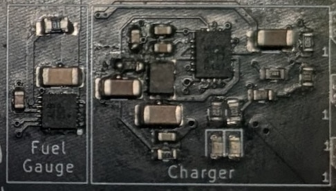

The USB-C port and the battery are directly connected to an MP2617HGL, which charges the battery when a USB-C plug is inserted and powers the system from the battery if no cable is connected. It can switch between both of these power sources seamlessly without any visible power loss for the rest of the system.

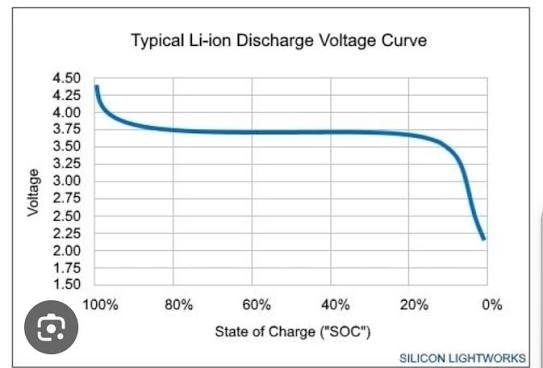

Directly next to it is a MAX17260SETD, a high precision fuel gauge which can precisely measure the remaining percentage of the battery as well as the current that is flowing. This is needed to get a precise remaining battery percentage, because simply calculating it from the voltage via a voltage divider does not work with Li-Ion batteries because of their discharge behaviour.

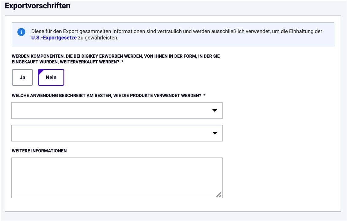

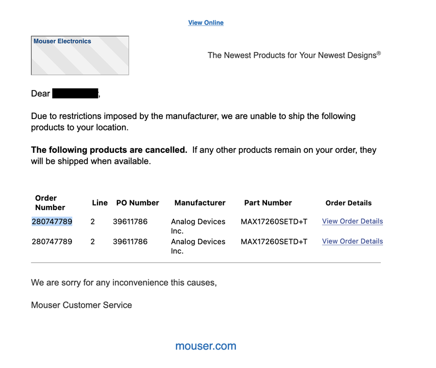

Sourcing the MAX17260 turned out to be the most awkward part of the whole BOM. My order at Mouser was cancelled, with the note that restrictions imposed by the manufacturer meant they could not ship the part to my location. Digi-Key did ship it, but only after I filled in an export compliance form asking whether the components would be resold in the form they were purchased in, and what application they would be used for. I also had to promise that I am not building anything military, aircraft, medical or aerospace related with this component. Not something I expected from a fuel gauge.

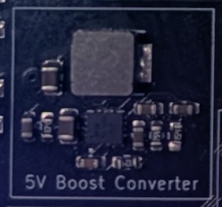

3.3 Buck/boost systems

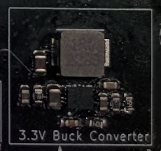

The input voltage for the whole system is not consistent: when USB-C is connected it is 5V, when it is battery powered it is anything between 3V and 4.2V. But the system needs a stable 3.3V and 5V for the MCU and the LEDs.
Therefore I need to step the voltage up and down safely, and that is why I chose the TPS63070RNMR, which can seamlessly switch between boosting and bucking to the selected voltage, configurable with resistors at the setup pin.

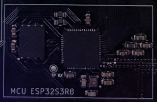

As the microcontroller I used the ESP32-S3R8, which is one of the best ESP32s with integrated WiFi and BLE. In this variant it has 8MB PSRAM but no internal flash, which is why there is a 16MB flash storage chip next to it. That makes it one of the strongest configurations you can easily achieve using the ESP32-S3, with more RAM and storage than most projects would realistically need. But I chose it anyway, because I don't want to be limited by hardware on my own board when new features come along, so I went with the best setup I could easily do.

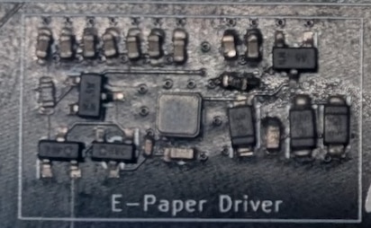

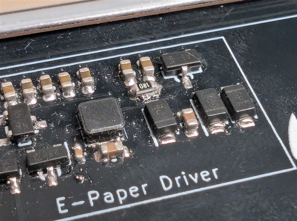

The e-paper driver consists of a boost circuit which generates several rails from the incoming voltage, positive and negative, up to about ±16V. This is required by the e-paper display to get enough voltage to move the small ink particles inside it. The exact rails and the values I measured on them are listed in chapter 6.5.

In the layout approach I always separate the different regions from each other, for the sake of design and for clarity when taking a look at it. Additionally it is worth mentioning that the RF antenna sits in the bottom right corner, far away from any switching logic like the power converters or the LED and display drivers.
The layer layout is quite straightforward: the first layer is data, the second one is ground, which is good for signal integrity, the third is the power plane, where the 3.3V and 5V from the converters go, and the fourth layer is data again.
4.2 Silkscreen
Labelling and outlining every functional block on the silkscreen (charger, fuel gauge, 3.3V buck converter, 5V boost converter, e-paper driver, LED driver, MCU) is a great addition to this PCB. It does not only make it clear what does what, it also helps when debugging, because I can read what a certain section does without having to look into the schematics again.
I also added some pictures and symbols to the silkscreen, which makes the PCB more interesting to look at and makes it a bit more personalized.

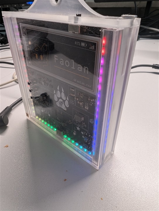

5. Housing
The PCB also needs a nice housing so that you can wear it. It should be solid but should also not obstruct the view onto the PCB. That is why I designed my own: the frame is 3D printed in resin, and the front and back panels are plexiglass, so the board stays visible from all sides.

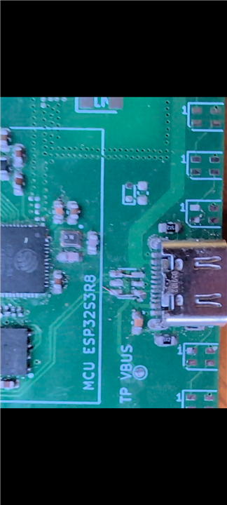

6.1 USB not enumerating
This is the first problem I run into on every board I build: I connect it to the computer and hope and pray that it shows up as a USB device in my device list. Of course it did not on the first try.
I searched two full days for the issue. I measured all power rails and the current draw, but everything seemed fine. I reflowed the MCU a dozen times and still got no USB enumeration. I still wasn't convinced that the MCU was sitting correctly, because the 56 pins are spaced around 0.4mm apart, which means being off by just 0.2mm makes either everything or some sides and pins of the MCU stop working.
Since I didn't want to resolder the MCU again, I looked into the USB driver log of my Linux machine. In the past I had problems where only RX was working, so a handshake gets attempted but aborted on timeouts. That is why looking into the driver logs is a good option when the computer recognises the PCB as something, but not as a functional USB device. This time there were no logs at all regarding my PCB.
After that I searched for a way to get any data or logs out of the chip about what it is doing, because the list of possible problems is endless: a faulty clock signal, a short on a power rail, not enough current from the power converters, a misaligned MCU, a problem on the USB lines, a problem with the USB-C port, and so on.
I knew the USB port itself was fine, because I measured the resistance between power and ground with a multimeter and did a continuity test on the data lines and the CC pins using a USB-C cable I cut open.
While searching for what else I could do, I discovered that the ESP does not only have a USB JTAG module to talk to other devices, but also a native serial module that prints out system logs like boot messages. If I can read that, I know exactly what is going on: not booting, wrong clock speed, crashes, and so on. But I also knew that it would not be easy to access, because unlike rev 1.1, rev 1.0 did not have a test pad for that serial pin, so I somehow had to reach the pin directly while the ESP was soldered to the board and running. With a normal cable it would have been impossible to touch a pin that small with no trace going away from it, but then I had an idea: I stripped a cable and wound it around one of my multimeter probes, which has a really pointy tip, and with that I could pick the signal off the pin. I connected that cable and a ground connection to one of my USB to serial converters and started a serial monitor on my laptop. The result: the ESP boots up just fine. Then it reboots because it doesn't find any firmware on the empty flash, but that is fine. That confirmed that everything was working and only the USB data line was faulty.
I thought about resoldering the MCU again, but I didn't really want to, because it is always a hassle and optically it looked connected.
As a next step I tried to narrow down the fault. I looked up the voltage levels a USB connection should have and measured what I actually had. The result: my D+ line was almost 0V, which shouldn't be the case. After bridging the 22Ω resistor I have in series with the data line, the problem still didn't vanish, and I was clueless again.
The next day it struck me: what if the ESD protection, which does not only protect the VBUS line but the data pins as well, is faulty? I desoldered it and bridged the connection with thin copper strands, and the computer connected successfully without any problems.
In later builds I used the same part and the same schematic for the ESD protection without any problem, so it was probably either a faulty one or it got damaged by heat during the process.
6.2 ESP32-S3 alignment on the PCB
Like I already mentioned, placing the ESP32-S3 with all of its 56 pins on the PCB without any misalignment is not that easy. I work with hot air on the lowest fan setting, but it is still enough airflow that the chip doesn't align itself through surface tension. This gets worse after a few iterations, when there is a little bit too much old solder paste on the pads.
What helped me the most was placing the MCU and all other components one after another and then putting the whole board on a heat plate. I did it that way for assembling rev 1.1, and the ESP self aligned correctly on the first try. On a half assembled board I didn't want to risk damaging the other components with the heat plate.
6.3 Unstable 3.3V rail caused by contamination
In the first revision I also had the problem that the 3.3V rail did not have 3.3V. It had anything from 1.9V up to 10V. It was really weird behaviour, because sometimes the voltage was stable and stayed that way over a few power cycles, but after reflowing the buck boost chip I sometimes got fluctuating voltage levels instead.
In the end the fix was easy: I desoldered the power IC once again and cleaned it and the PCB with isopropanol, and after that it worked perfectly. I think remaining flux and solder paste allowed really small currents in the µA range to flow, or bridged the two voltage divider resistors and changed them by a few ohms. Normally that wouldn't be a big deal, but the feedback divider pin is quite sensitive to leakage currents like that and to small resistor value changes, and therefore it produced weird output voltages.
6.4 Charger circuit seemed to not charge the battery
After everything else was fixed, so the LEDs worked, the e-paper worked and the USB communication worked, I wanted to find out how much current the charging IC can actually push into my battery. Instead of using the fuel gauge that is already built into the board, I used a multimeter. There were two reasons for that. At first I simply forgot that I had the fuel gauge on the board, and after I remembered it, I didn't trust it. I thought a multimeter would definitely give me the correct value, so I could use that to double check the fuel gauge.
So I put my multimeter in series between the charger IC and the battery. But I only measured around 5 to 20mA, which is nowhere near enough, because it should have been way higher. At least a few hundred mA.
In the process of troubleshooting I removed the NTC sensor and changed a few resistor values to tweak the configuration of the charger IC, but nothing seemed to work. In the end I gave up on it and ordered the next revision, because everything else worked and I wanted the project ready for a specific deadline, since I wanted to take it to a convention. I only removed the NTC sensor in that revision and did not make any more changes, because I could not find any errors in my schematic.
While the next revision was being produced and shipped, I tried out the fuel gauge, and I found something wild: it showed more than 1000mA going into the battery. Same configuration, same charger, same cable as before. I was happy and devastated at the same moment. Happy because it worked, devastated because it had worked all along and I was just too stupid to measure it correctly, because I never thought about the burden voltage my multimeter was producing.
A multimeter measures current by putting a shunt resistor in series with the circuit, and I measured mine at around 10Ω on the mA range (it fluctuated between 9.6Ω and 10.1Ω, so 10Ω is close enough for this calculation). Mine is a cheap 20€ meter from Amazon, so that value will be a lot lower on better equipment, but the effect itself does not go away. That doesn't sound like much, but it was the whole reason for my wrong measurement. The MP2617 regulates against the voltage it sees at its battery pin, and with the multimeter in the path, that is no longer the original battery voltage:
V_BAT_pin = V_battery + I · R_multimeter
With 10Ω in series, the charger can no longer see the battery. It only sees the battery voltage plus whatever drops across the meter, and that drop grows with the current. Because of Ohm's law, 1A through 10Ω would be 10V of extra voltage the charger would have to produce, which is more than the 5V it gets from USB in the first place. So the charger does what it is designed to do: it sees a pin voltage far above its 4.2V target and turns the current down. Less current means a smaller drop, which means a lower pin voltage, so it turns the current up again. It settles wherever the drop across the meter exactly fills the gap between the real battery voltage and the 4.2V target:
I = (4.2V − V_battery) / R_multimeter
With a half charged battery at 4.0V and a 10Ω burden, that balance sits at 20mA, which is exactly the ballpark of what I measured. And because this is not a soldering mistake or a configuration mistake but simply how the circuit behaves with the meter in it, the wrong value was perfectly stable and perfectly reproducible. That is what made it so convincing, and that is why I didn't question it at first.
6.5 E-Paper suddenly not responding in rev 1.1
After finding out all this, the next revision arrived. Because I knew there was no problem anywhere, I populated the whole board, soldered everything with the heat plate, connected it to my laptop and got really excited when the USB connection and the flashing worked on the first try. I flashed my code, the LEDs were working, I got correct power readings from my fuel gauge, but the e-paper didn't do a thing.
I did not understand that at all, because compared to rev 1.0 I had not changed a single component in the schematic, apart from removing the NTC sensor in the charger section, which has nothing to do with the display. All I did was some rerouting and swapping one GPIO pin, in this case moving the panel power control from GPIO7 to GPIO8.
Before doing the logical thing and comparing the voltage levels of rev 1.0 and rev 1.1, I swapped every component over from rev 1.0 to rev 1.1: swapped the diodes, tested again. Swapped all resistors in that area, tested again. Even swapped the MCU and tested again. No change.
The e-paper needs its own set of boosted rails, so one possibility was that the boost converter on the board was somehow not working. I measured all of them and got the following results:
Rail Measured
VGH +16.3V
VGL −16.8V
VDH +15V
VDL −15V
VDHR +7V
VCC input 3.4V
Everything within spec, and stable even after two minutes. So the boost was running fine. That is the point where the whole thing got confusing, because now I had a panel that gets correct power and still refuses to finish powering on.
After all that measuring, I added print statements into every phase of the PDLS update sequence, so the serial output would tell me how far the driver actually gets and where the process hangs, because it could have been a data problem. That gave me new important information about this problem: the code enters COG_update(), sends the 0x04 power on command to the display, and then sits in b_waitBusy() forever. The BUSY line stays LOW for more than 60s instead of going HIGH after a moment.
That means the panel receives the command and starts doing something, but never reports back that it is ready. That points at the panel power stage rather than at SPI, because a broken SPI path would already fail earlier at the OTP health check, and that one passed. That confused me quite a bit, because I couldn't think of any other potential sources of error. The power rails seemed fine. The data signal seemed fine.
After a long back and forth, and with the more or less helpful help of Claude, I figured out that the whole problem came down to one wrong resistor. The boost circuit has a current sense resistor, R31 in my schematic. The reference design specifies 0.47Ω and my schematic specifies 0.47Ω too, but the part actually sitting on the board was 1Ω, because I didn't have a 0.47Ω resistor at home. That limits the peak switch current the panel controller can draw to roughly half of what it is supposed to have.
At this point I argued against this finding, because that same exact 1Ω was on rev 1.0 as well, and there the display worked without any problems. I thought that if a part is identical on both boards, it cannot be the difference between working and not working. That objection sounds correct, but in my case it was still wrong.
What resolved it was going back into the KiCad files and comparing the routing of the two versions. In rev 1.1 every current carrying trace in the boost loop, so Display_VCC, the FET source net, the diode cathode net and Display_VGL, got roughly 8mm longer, because I had pushed everything down a little bit so the display would have enough space. All of those traces are only 0.2mm wide and I never compensated the width for the added length, because I never gave any thought to the problems that could come with that. It adds a few hundred milliohms of extra loop resistance. Again, that sounds irrelevant, but the 1Ω resistor was already marginal on rev 1.0 and had no headroom left, and the longer traces ate up what little was left.
The fix was simple and looks funny: I stacked a second 1Ω resistor in parallel on top of the first one, which gives me about 0.5Ω, and the display came up on the first try.
Because I don't plan to buy 0.47Ω resistors, I am going to change the schematic to use two 1Ω resistors in parallel.
This taught me an important lesson about PCB design: trace width and length seem irrelevant for most signals, but in edge cases, or when there are specific voltage or current requirements, they matter a lot.

At this point all of the hardware works as intended. Every single functional block on the board has been used in the firmware, measured and used in a real application, and none of them is left out or bypassed with a wire. What is not finished is the firmware side of it, and that is what the next chapter is about.
The e-paper display renders text and images and can be updated over a web interface that the controller hosts itself. That means I can connect to the badge with a phone or laptop over WiFi, upload a new image or change the text, and the badge redraws itself without needing a cable or a reflash. Because it is an e-paper panel, the image stays on the screen afterwards even if the battery runs completely empty, which was one of the main reasons for choosing this display technology in the first place.
The controller also drives all 48 LEDs through the level shifter and can address every single one of them individually. Brightness and colour are freely controllable, and the LED rail can be switched off entirely when the LEDs are not needed, which matters a lot for runtime because the LEDs are by far the biggest consumer on the board.
On the power side everything comes up in the right order and all rails are properly initialised at boot. The 3.3V rail is stable and the 5V rail can be turned on and off at any time from the ESP via one GPIO. The charger works exactly as it should: when a USB-C cable is plugged in it charges the battery, when the cable is removed the system keeps running from the battery, and the switchover between the two happens without the rest of the system noticing anything at all.
The fuel gauge is alive and talking over I2C. It reports the battery voltage correctly and it reports the charge and discharge current correctly, both while the charger is running and while the badge is running on battery only. As described in chapter 6.4, it was in fact the fuel gauge that was right the whole time and my multimeter that was wrong, so at this point I trust it a lot more than I did at the beginning.
USB works for both flashing and serial output, so the whole development loop runs over a single cable without any external programmer.
8.2 What doesn't work yet
The one thing that is not finished is the state of charge estimation of the fuel gauge.
The raw values are fine. The gauge sees the correct voltage and it measures the correct current in both directions. What it does not get right yet is the derived information, so the remaining percentage and the estimated time until the battery is full or empty.
While discharging, the first 90% drop away in roughly the first 20% of the actual runtime, and after that the reading sits below 10% for a very long time while the badge just keeps running. Charging shows the same pattern in the other direction: it sits at some percentage and tells me one hour left, and one hour later it sits at around the same percentage and still tells me one hour left. Then at some point it climbs faster and reports full.
So the curve is compressed at one end and stretched at the other, which is a strong hint that the gauge is not working with a correct model of my battery, rather than that anything is broken. Right now I see two possible explanations and I have not ruled out either of them.
The first one is a configuration problem in my firmware. The gauge needs to know the design capacity of the cell and a few parameters describing where the cell is considered empty. If those values do not match the cell I actually use, every percentage it derives from them is going to be off in exactly this kind of way.
The second one is that the gauge simply has not learned the battery yet. This type of gauge builds its model over complete charge and discharge cycles, and I have not completed more than maybe one and a half full cycles so far. A 10000mAh battery takes a considerable amount of time to run empty, so getting through several full cycles is less a matter of debugging and more a matter of patience and monitoring.
