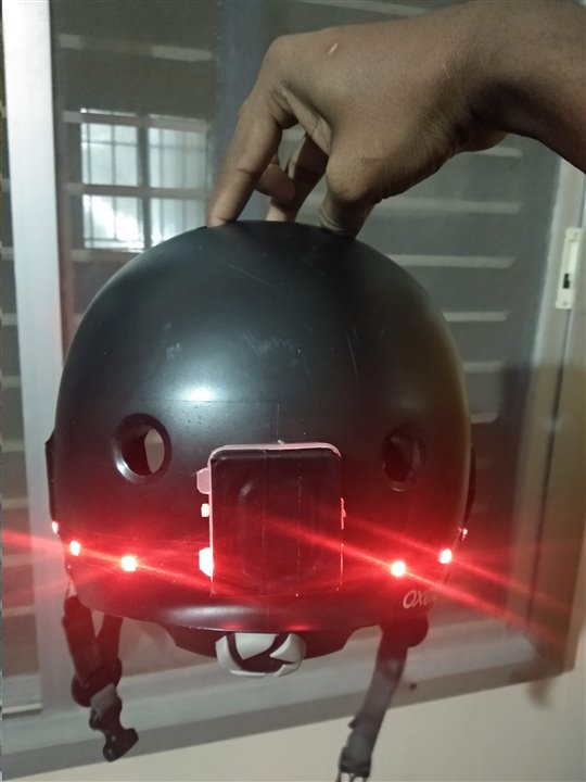

    vishwasn over 4 years ago in reply to robogary
    Yeah, that application can resolve a lot of issues and reduce the total weight and size of the project. In mine, I have housed an ADXL345+Arduino Pro mini+ 250mAh battery+TP4056 charger inside that black box behind. I would suggest you find an optimal point where the head motion is significant to get the change in the sensor value. Otherwise, Nicla Sense ME supports Edge.ML by KTH. You can try that and make an ML Model which will reduce your burden. Here's an article by ralphjy/products/arduino/b/blog/posts/nicla-sense-me-machine-learning-using-edge-ml

  • vishwasn
    Awesome build. I had made something similar using arduino promini and neopixel LEDs ( Just to have Chase mode with minimal wires).
