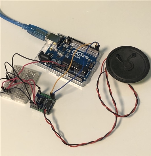

The first step for me was to check that I could get the sound module working.
A few different but similar sound modules are easily and inexpensively available. For a previous project I used one that takes an SD card, which is very easy to pop out and re-load with new sounds. I bought this particular model of sound module because it actually includes 4MB of memory on the board itself, saving having to dedicate an SD card for the project. I've been upgrading the storage on my Raspberry Pi machines and using the hand-me-downs for this kind of thing, but the space of even an older SD card is ridiculously overkill for a project like this.
As it turns out, the 28 sound bites easily fit within the 4MB of the module. In fact, it only uses about 1/3 of the available space!
Sound module drive space
To put files onto the sound module, it works like a USB drive - just plug it in using a micro-USB cord and then drag the sound files onto it (I'm on a Mac. Your experience might be more exciting). Note that it expects the sound files to be named 00001.mp3, 00002.mp3 etc, so you can later access them by number to play them. This is what my sound module drive file list looks like:
Sound module file names
There are a few ways of triggering the sounds, but for the number of sounds we wanted to include, the serial communication option was the best way. It also requires the least amount of wiring, and no extra parts are needed this way.
arduino with sound module
I used a library built by Chris Snijder to make the serial communications with the board much easier. You can find it in GitHub:  https://github.com/SnijderC/dyplayer
To install the library into your Arduino IDE, download it as a zip file, unzip it, then (for Arduino IDE 1.8 on Mac at least), choose Sketch - Include Library - Add ZIP library, and then choose the dyplayer folder.
Note: I ran into a bug in the dyplayer library that mis-interprets the sound file numbering - they are all seen as odd numbers. To get around that I added a little conversion into the code so that all files can be played. I've added extra comments into the code to describe it. If you're following this build to create your own, you may want to double check that this issue still exists, or if it's even an issue with a different Arduino IDE build. Using the Software Serial example included with that library I was able to spot the numbering issue after having spent a fair bit of time wondering why so many sounds were missing!
You might notice that in these earlier pictures I have connected the sound module via the Uno's standard serial port. This works well, but it meant I had to disconnect the 2 serial wires every time I wanted to upload a new sketch. It also meant that the debug serial console in the Arduino IDE was not available.
That's why I later switched to using Software Serial, for easier sketch updates, and also so that I could debug that odd dyplayer numbering bug. I strongly recommend keeping that built-in serial port free if at all possible - it could save you a lot of trouble later!
