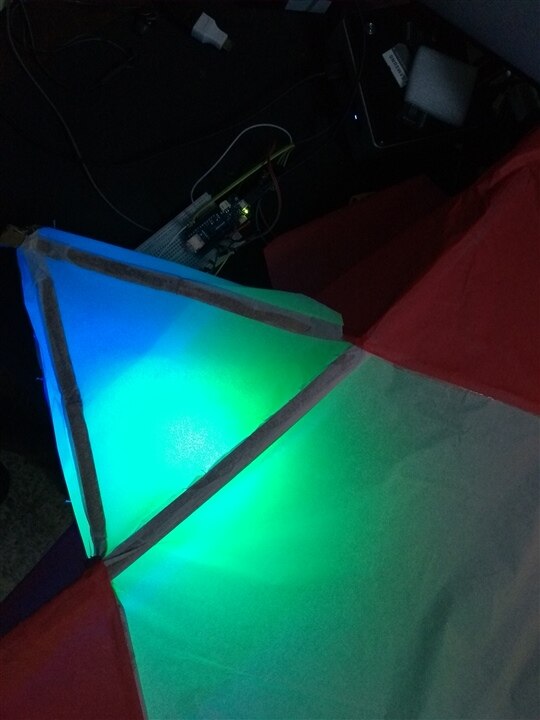

This is a continuation, of my first blog for the Singing Traditional Christmas star, using the Arduino MKR ZERO. As part of this blog my mission is to add LEDs to the star inside before wrapping it up with butter paper. And I will also have to think of a way to add the speaker to one of the spokes of the star, so that the sound can be heard clearly.
For the LEDS, I know I mentioned in my previous blog post that I would use NeoPixels, but I don't have a strip which means I would have to chain the single NeoPixels which will get messy, so instead of chaining NeoPixels together one by one, I planned to use APA102 strip that I had in my kit.
Here is the updated circuit.
MKRZero adding APA102 Led strip
The APA102 LED strip connection to the Arduino MKR ZERO

Now before I get to the difficult part of the build, that is dressing up the star and hiding the components, here is a quick diffusion test of the LED strip - APA102, with one spoke of the star dressed with butter paper.
Star LED strip diffusion 1Star LED strip diffusion 2Star LED strip diffusion 3
  • scottiebabe
    scottiebabe over 4 years ago +4
    I like how the butter paper (I think locally we call it https://en.wikipedia.org/wiki/Parchment_paper, ) diffuses the LEDs, it looks really good! I will have to remember this idea.
