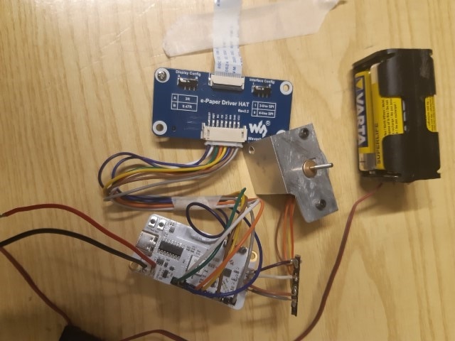

At the end of these random reasoning, I devised a Christmas tree ornament that can visualize Tweets on an eink screen. The components for this project are
  1. The TMC2300 IoT reference board: I selected this board because I want to add some "special Fx" to the ornament
  2. a eink display. I found an interesting 2.9 inches flexible display by Waveshare. It has an SPI interface, so it is perfectly compatible with any microcontroller
  3. a 2-phases motor
  4. a battery pack

The display I chose was the Waveshare 2.13" e-Paper HAT (D)
All the information about the product and the software required to drive the display are available here
The hat comes with a connector with wires that can be connected to a standard header. The pins used are as follow
TMC2300-IoT-REF pin ESP32 pin e-Paper HAT
DIO0 IO14 CK
DIO1 IO19 CS
DIO2 IO13 DIN
DIO3 IO25 RST
DIO4 IO26 DC
DIO5 IO33 BUSY

5. The ball
The initial plan was to put everything inside a Christmas tree ball, but the display hat board was too cumbersome. For this reason, I switched to a transparent box .
  • a transparent box
  • cardboard
  • a small piece of polystyrene
I created a small box from cardboard to hide all the electronics and placed everything inside the box
Then, I mounted a PC fan on the shaft of the stepper motor, placed all the electronics inside the plastic box, filled with some polystyrene balls
