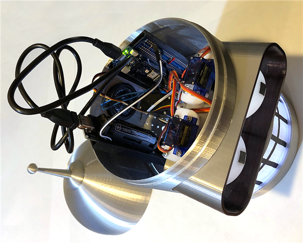

Building Bender

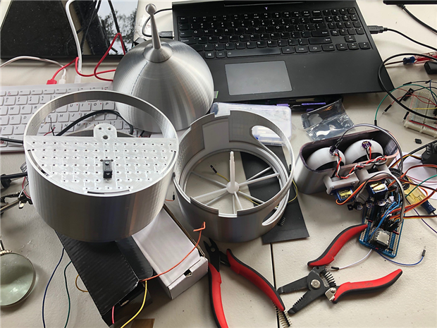

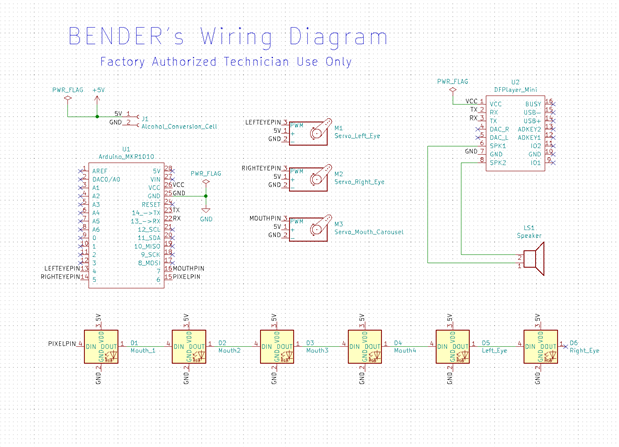

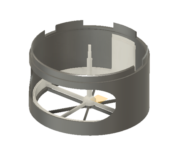

Bender is a 3d printed project with servos, WS2812b LEDs, and DFRobot sound module driven by an Arduino MKR1010.  He was designed in Fusion360 and printed on an Anycubic i3 Mega.  The exterior is "silky" silver PLA and unpainted.  There are 6 main structural parts:

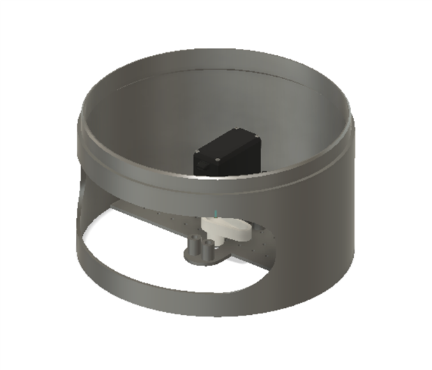

  • Lower head
  • Middle head
  • Mouth carousel

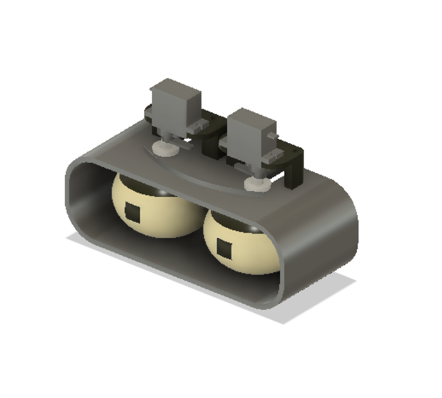

  • Eye box
  • Upper head
  • Antenna

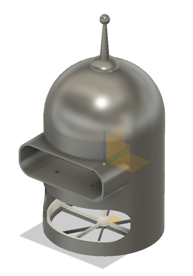

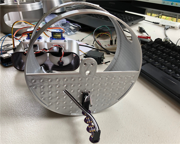

The lower head holds the mouth carousel in place and has a central pin that it rotates on.  The carousel design was inspired by a very interesting build by James Bruton.
The middle head holds the eye box in place and slips on with a friction fit to the lower head.  There is also a motor bracket and servo to rotate the mouth carousel.  Not shown are the 3D printed mounting attachments and brackets for the microcontroller, battery, speaker, and so on.

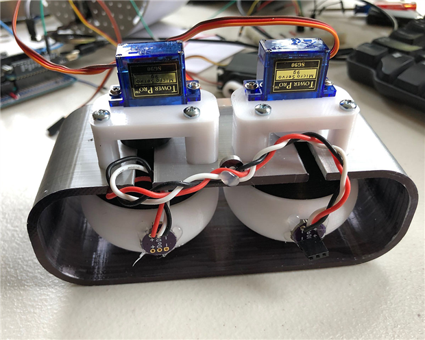

The eye box holds the 3d printed ovoid eyes (printed in two pieces and glued together), two servos, and associated motor mounting hardware.  It slides into the middle head and is held in place with a dab of hot glue.

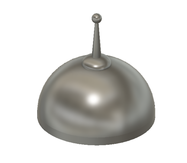

The upper head and antenna are printed in two pieces and slip over the middle head.
According to my research Bender's is 5 feet 6 inches (1.68 m) tall and a little over 6 feet (1.8 m) with the antenna.  This build is a 1:1 scale reproduction.  The lower head and middle head took about 8 hours to print and the upper head 16 hours.  The other pieces took between 15 minutes and 4 hours to print so the printer has been busy and was working around 35 hours total.
Electronics

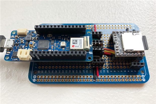

Bender runs on alcohol which he uses to produce electricity.  In this reproduction a 18650 battery is used to power the Arduino MKR1010 microcontroller, 3 servos, 5 WS2812b LEDs, and DFRobot DFMini Pro sound unit as shown in the schematic below.

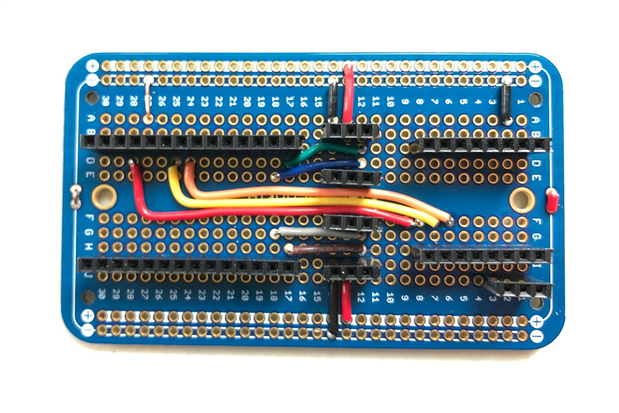

The Arduino and DFPlayer Mini are mounted on a prototyping board which also contains headers for the servos and LEDs for easy assembly and repair.  Not shown is a WeMos boost converter and charging PCB for a 18650 battery.  The servos and LEDs are powered directly off of the 5V supply of the boost converter.  The Arduino receives USB power from the boost converter and supplies 3V3 to the sound module.
Assembly

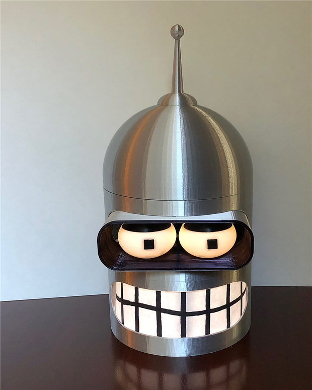

Below we see Bender on the factory floor in various stages of assembly and testing.  The WS2812b LEDs are mounted on PCB strips that were designed by me some time back for toys for the grandkids and can be snapped apart at mouse bites to the desired length.  The paper mouth inserts into a slot that can be seen in the mouth carousel.  Bender is fairly easily disassembled and reassembled for such things as parts replacements and repair when needed.
{gallery} Assembly on the Factory Floor
Ready for Assembly
Eye Box Assembly
Preparing for Brain Transplant
Brains
Assembly complete
