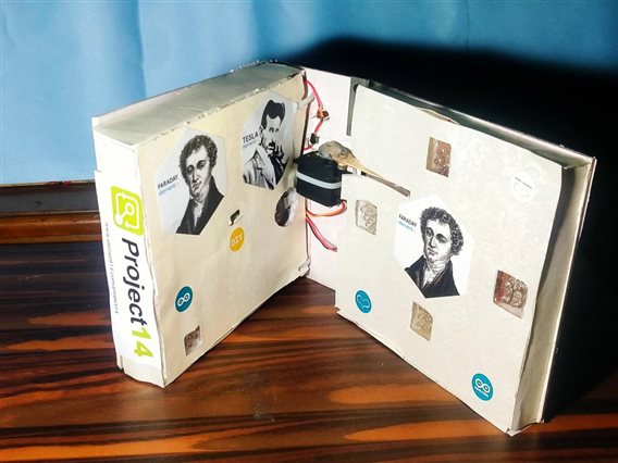

Hello Everyone, My name is Harji Nagi. I am currently a third year student studying electronics and communication engineering from Pranveer Singh Institute Of Technology, Kanpur(Uttar Pradesh, India).I have a keen interest in robotics, Arduino, Embedded system, internet of things, FPGA and Analog electronics.
Today I made a diy smart greeting card  for Element 14 which consist of three unique features in just one card .First feature is based on  ISD1820 a small Voice Recorder and Playback module that can do the multi-segment recording application with the adjustment of the on-board resistor. Second feature consist of MPU-6050MPU-6050 for controlling 4 LEDs on the card. The gyroscope is programmed to detect the tilt in the card and then turn on the respective tilted LED and third feature is based on a two clap servo control, whenever the user clap two times, sensor detect sound, it make the servo rotate at about an degree of 150. This in turns turn on a LED to make the user sure about the direction of the servo. When a similar sound is produced again, then, it brings the servo to its original place, turning the LED off.
These three features makes the card unique, the user will definitely have a fun smile on using this card.

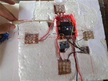

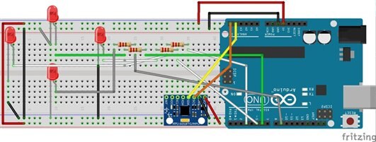

Connection Diagram for controlling Leds:
LEDs :-const int frontLed = 3;const int bottomLed = 5;const int rightLed = 6;const int leftLed = 9;
And for the https://www.element14.com/community/view-product.jspa?fsku=1864742&nsku=37T8113&COM=noscriptMPU-6050. The https://www.element14.com/community/view-product.jspa?fsku=1864742&nsku=37T8113&COM=noscriptMPU-6050 must be connected to ground and 5V+, after that connect SDA to A4 (analog 4), SCL to A5(analog 5).
You are done with the connections now.

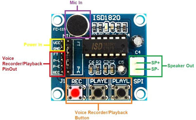

Connections for ISD1820:
ISD1820 must be connected to ground and its operating voltage is 2.2V to 5V.And connect the speaker at sp+ and sp- .
Press the red button(rec) to start recording the song, voice or any greeting message. It will record not more than 20 seconds.
After recording press Playback to play the recorded message.

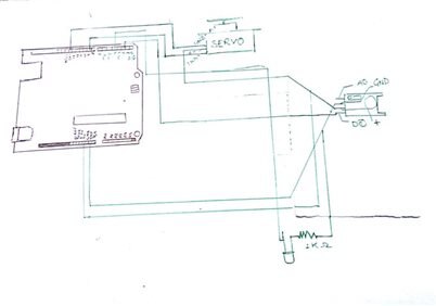

Circuit diagram for 2 Clap Servo Control:
Code for 2 Clap Servo Control:

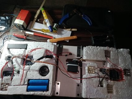

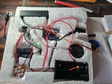

Now place all the electronic components and do the connection according to the schematic diagram. And apply cello tape so as the component remain fixed in their position

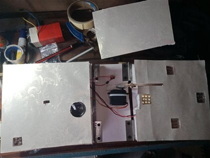

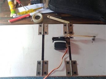

Now cut the perf board according to the size of the thermocol and mount  the servo motor on it with the help of plastic zip ties.
Make the movable joint with help of popsicle sticks and apply glue gun to stick it with servo horns.
After mounting servo motor and movable joints place the thermocol sheet as per the picture given below and cover it with chart papers.

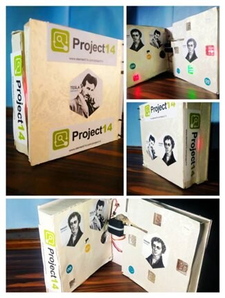

Now cover  these components with the help of colorful chart papers and  stickers to make it more attractive.
Now the card is ready .On switching on the power button the gyroscope detects the tilt in the card and then turn on the respective tilted LED Whenever the user the user clap two times, sensor hears any sound under its range, it make the servo rotate at about an degree of 150. This in turns turn on a LED to make the user sure about the direction of the servo. When a similar sound is produced again, then, it brings the servo to its original place, turning the LED off. and on pressing the playback button of ISD1820, it plays a melodious song. Please watch this video for more information. I hope you enjoyed this tutorial.
